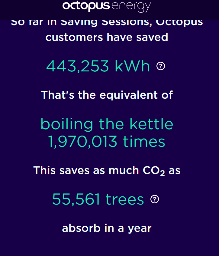

Ferdinand Posted December 18, 2022 Share Posted December 18, 2022 Octopussy has now published (on my account anyway) total amounts saved in Saving Sessions. That's 443 MWh, or the annual electricity (not all energy) demand of an average group of around 100 detached houses in the UK, saved by approx 250k customers over 4 sessions. Average electricity demand of detached house = approx 4 MWh. More relevantly, it knocked 108 MW off the peak of demand, by engaging just under 1% of electricity account holders. Gives an insight into potential flexibility. Ballpark that is a reduction of 1/4 to 1/3 in short term electricity demand, when you pay people far more than the cost of the electricity. Analysis: https://octopus.energy/press/believe-it-or-watt-octopus-energy-customers-provide-108mw-of-grid-flexibility-in-first-saving-session-equivalent-of-a-gas-power-station/ Link to comment Share on other sites More sharing options...
Ferdinand Posted December 18, 2022 Share Posted December 18, 2022 On 12/12/2022 at 09:01, Gone West said: I've had two cards in the post and a phone call in the last two weeks asking me to have a smart meter. Well - the posties are giving you a break ! 1 Link to comment Share on other sites More sharing options...
SteamyTea Posted December 18, 2022 Share Posted December 18, 2022 1 hour ago, Ferdinand said: saved by Displaced, not saved. 3 Link to comment Share on other sites More sharing options...
ProDave Posted December 18, 2022 Share Posted December 18, 2022 1 minute ago, SteamyTea said: Displaced, not saved. +1,more greenwash. Link to comment Share on other sites More sharing options...
Ferdinand Posted December 18, 2022 Share Posted December 18, 2022 26 minutes ago, ProDave said: +1,more greenwash. TBF - smoothing out usage reduces the need for backup infra. 1 Link to comment Share on other sites More sharing options...
SteamyTea Posted December 18, 2022 Share Posted December 18, 2022 15 minutes ago, Ferdinand said: TBF - smoothing out usage reduces the need for backup infra. That is the ultimate idea. Run the 'virtual' generator at fixed output and at best efficiency constantly. There may be better ways to do that than though variable pricing. If each house in this trial displaces say 0.5 kWh, that could easily be done with a very small battery system. Shift it up a layer, a larger battery at the local substation. There will be a point where the substation and recharge/discharge efficiency is optimal, and that should determine the best placement of a system. If course we could easily add in thermal storage, even if just a 50lt water pre heater, or even a cheap storage heater hanging in a wall. It is too easy to want the best system there can possibly be, rather than a cheap and easy one. 1 Link to comment Share on other sites More sharing options...
