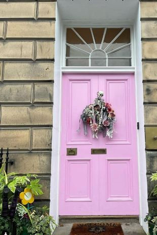

On 28/10/2022 at 23:49, Temp said:
https://www.mirror.co.uk/news/uk-news/furious-mum-faces-20000-fine-28346851
Enforcement issued for painting door of listed building bright pink..
Back of the envelope cals suggest this 3m2 door alone loses more heat than all 200m2 of our roof and floor combined.
People have no idea how wasteful old houses are.
Talk about fiddling whilst Rome burns.

Two different things. If you know this area of Edinburgh, these are classic Georgian buildings, relying on symmetry. She has had her moment of fame and can now repaint appropriately, as she could have done when first instructed.
Then can add draightstrip etc. Prob has an inner lobby anyway.

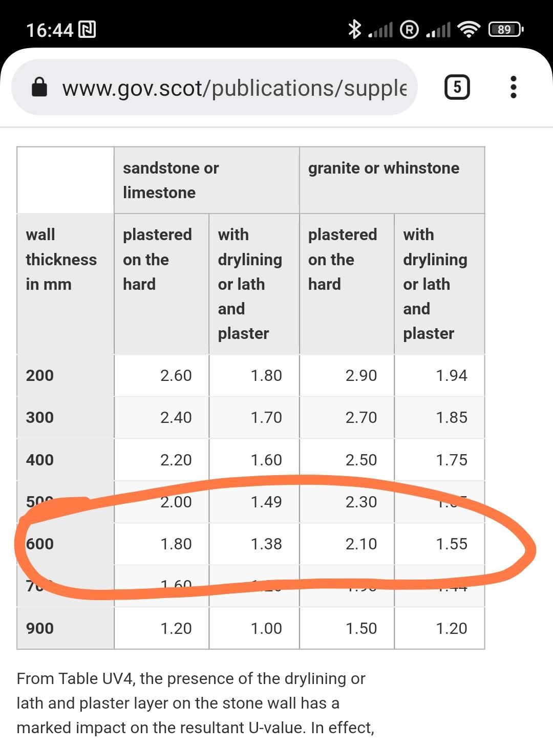

Actually, 600 masonry then lath and plaster won't be that bad for heat loss.

It depends on what you consider "that bad"
It's 12 times worse than our house's wall.
Its like me swapping my 55mpg Skoda Octavia for a 4.6mpg family car, if such a thing even exists. Even a 1600hp Bugatti Chiron manages double that.
