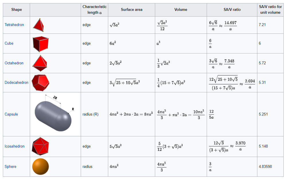

jack Posted October 24, 2022 Posted October 24, 2022 The relative impact of air tightness rises as the internal volume of the building increases. It's to do with the relationship between wall/ceiling/floor areas and internal volume. That's why you'll sometimes hear it said that poor insulation on very large buildings (think warehouses) is far less an issue than getting them airtight, whereas the opposite applies for, say, a small bungalow.
jack Posted October 24, 2022 Posted October 24, 2022 Never thought of it that way - interesting. Must be more to it than that then (assuming the principle is even correct).
