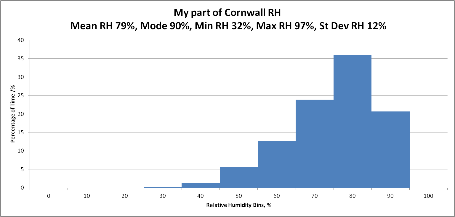

SteamyTea Posted October 1, 2022 Share Posted October 1, 2022 18 minutes ago, zoothorn said: You cannot replace the inside air, of a house, feasably or affordably. You may be able to in a normal area (by spending hundreds on multiple dehumidifiers & running them incessantly you might be able to). But NOT here. Proven. Here is my external RH profile so far this year, it will only have more damp from now on. I don't use anything other than natural ventilation. I doubt your RH profile is any worse than mine. So not proven at all. Link to comment Share on other sites More sharing options...

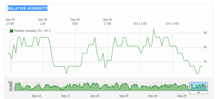

ProDave Posted October 1, 2022 Share Posted October 1, 2022 I regularly look at the local weather station, mostly for the wind and temperature but also look at RH and that is often up around 70 to 90% e.g here is last day or so with a longer time in the little graph at the bottom. This is not an unusual location so I would assume RH here is much the same. RH inside the house barely changes from about 50% Link to comment Share on other sites More sharing options...
