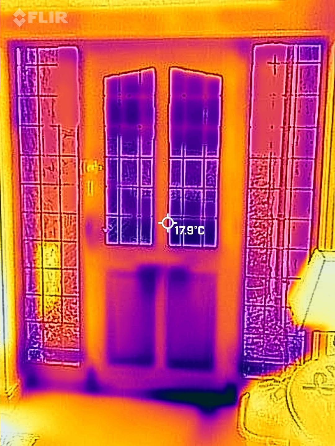

Radian Posted September 29, 2022 Share Posted September 29, 2022 2 minutes ago, zoothorn said: If for eg this is "cold bridging".. would you know why does it only or rather the vast majority of it, appear at the lowest possible areas on the frame/ reveal general area? IE & not uniformly over all the frame edges. It may not be cold bridging in those areas per se. Cold air tends to pool and accumulate low down in corners where airflow is at a minimum. See a thermal image I took of our front door while looking for drafts: The bottom left corner of the image matches one of your photos. The other dark blue (coldest) areas are the drafts I was looking for coming from poor sealing around the door and letterbox. Link to comment Share on other sites More sharing options...
zoothorn Posted September 29, 2022 Author Share Posted September 29, 2022 Regarding redoing these lower cill areas: I just thought would the vertical corners be well served by adding strips of white plastic trim stuff? Like my DG window job here; i saw it's made of a kind of firm foam inside: is this maybe designed with a little insulation in mind maybe? Perhaps this extra 1cmx 4.5cm, glued on like this on my french door edges.. might minimise this awful black goings on. Just thinking on my feet tbh. Surely worth a go as it's a cheap addition Iknow how to do. Link to comment Share on other sites More sharing options...
zoothorn Posted September 29, 2022 Author Share Posted September 29, 2022 5 minutes ago, Radian said: It may not be cold bridging in those areas per se. Cold air tends to pool and accumulate low down in corners where airflow is at a minimum. See a thermal image I took of our front door while looking for drafts: The bottom left corner of the image matches one of your photos. The other dark blue (coldest) areas are the drafts I was looking for coming from poor sealing around the door and letterbox. Useful eg thanks Radian. Looks pretty similar; in fact I'm surprised you didn't say "it may well be cold bridging in those areas".. I"m not quite understanding why you'd say it might -not- be with such a similar-fit eg. But I'm v.much a newbie at all this build xyz you see- so many times I cannot fathom things, in fact I bet if I had a penny for every time I said "I cannot understand" summink... I'd have £5.63. zoot Link to comment Share on other sites More sharing options...

Radian Posted September 30, 2022 Share Posted September 30, 2022 13 hours ago, zoothorn said: I'm surprised you didn't say "it may well be cold bridging in those areas".. I"m not quite understanding why you'd say it might -not- be with such a similar-fit eg. Your attention is inevitably drawn to those areas that show mould growth. But the entire reveal, all the way to the top, may be a cold bridge and it's only the nature of cold dense air that causes it to sink down low, and pool there in the corners where it's less disturbed by general air movements in the room. Think of it like a gloop that runs down the walls and is hard to scrub out from the corners. The analogy I'm thinking of is that it's like you're trying to get tea stains out of the corners of a square cup. It may be the head of the reveal that's got the bridge (i.e. treatment of the lintel) and the cold air falls evenly to the floor but is only showing up at the edges. You need a way of visualising the invisible. Do you have a non-contact IR thermometer? e.g. £13.99 on Amazon Link to comment Share on other sites More sharing options...

zoothorn Posted September 30, 2022 Author Share Posted September 30, 2022 1 hour ago, Radian said: Your attention is inevitably drawn to those areas that show mould growth. But the entire reveal, all the way to the top, may be a cold bridge and it's only the nature of cold dense air that causes it to sink down low, and pool there in the corners where it's less disturbed by general air movements in the room. Think of it like a gloop that runs down the walls and is hard to scrub out from the corners. The analogy I'm thinking of is that it's like you're trying to get tea stains out of the corners of a square cup. It may be the head of the reveal that's got the bridge (i.e. treatment of the lintel) and the cold air falls evenly to the floor but is only showing up at the edges. You need a way of visualising the invisible. Do you have a non-contact IR thermometer? e.g. £13.99 on Amazon Hi Radian, that clarifies things/ great info. Tbh if I can keep on top of it, continual wiping & redoing the silicone ( even Forever White, going on tmrw/ redoing it, I just know will innevitably become blackened with mould) say every 2 years.. I'll just have to lump it. I guess even if i found a cold 'source', with a gadget, the lintel area perhaps.. I can't do anything about it, I can't rebuild it, I have to live with it. It's just having put so much work in, it's pretty dissapointing. And not understanding how this is so much worse (I mean honestly by a factor of 20x) than my poorly insulated majority of the house, having used all up to date materials. The rest of the house's extentions are poorly built, freezing cold (unlike this modern addition) falling -far- short of B.Regs, but minimal frame mould. Maybe this is something just 'expected' with 'problematic french doors'; I just don't know what to expect you see/ I have no prior experience or reference points ( apart from Onoff's SWMBO who wipes moisture regularly from their french doors, much older tho, but an interesting bit of info). Thanks, zoot Link to comment Share on other sites More sharing options...

Radian Posted September 30, 2022 Share Posted September 30, 2022 (edited) If your house is nominally at 20oC with an RH of 73% then the dew point is 15oC. At 50% RH, the dew point drops to 9oC which is much less likely to occur indoors. Even though your room thermostat might be giving you 20oC, 15oC is the sort of temperature that you would find low down around doors and skirtings, and also on poorly insulated walls and... ...Draining boards often sit atop kitchen cupboards, the insides of which don't benefit from the general air circulation outside. They also sit on outside walls where the drainage outlets are located. Even if these are well sealed around wall penetrations, the air inside the pipe can be the same temperature as the outside air and similar in the case of the cold water pipes. Lots going on under sinks. But draining boards (especially stainless steel ones) are a great place to mirror the thermal goings on. For sure, yours and you neighbours are all developing a thin layer of condensation and feeding your localities special fungi. Edited September 30, 2022 by Radian Link to comment Share on other sites More sharing options...
