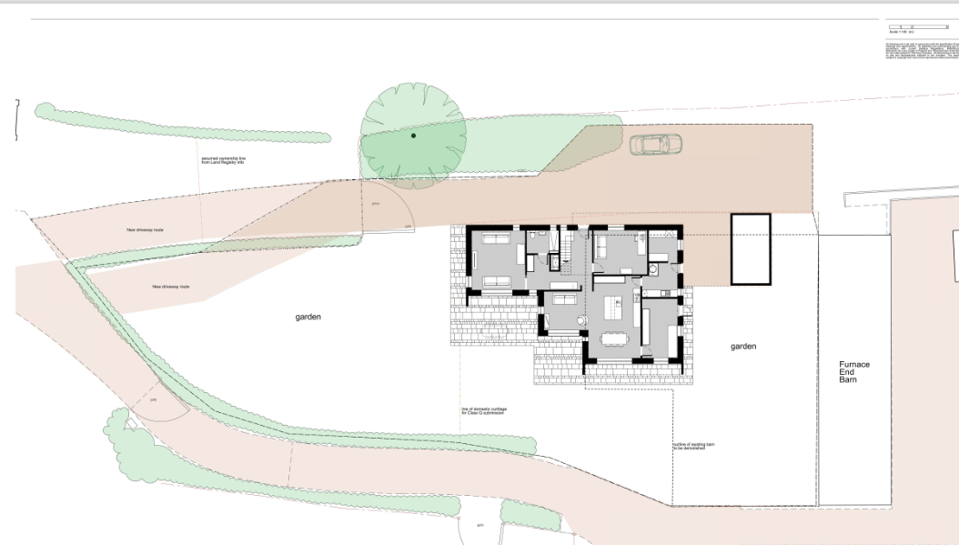

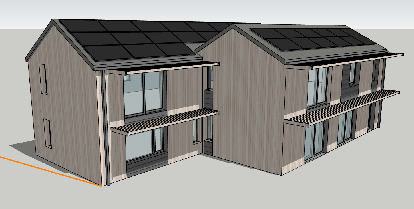

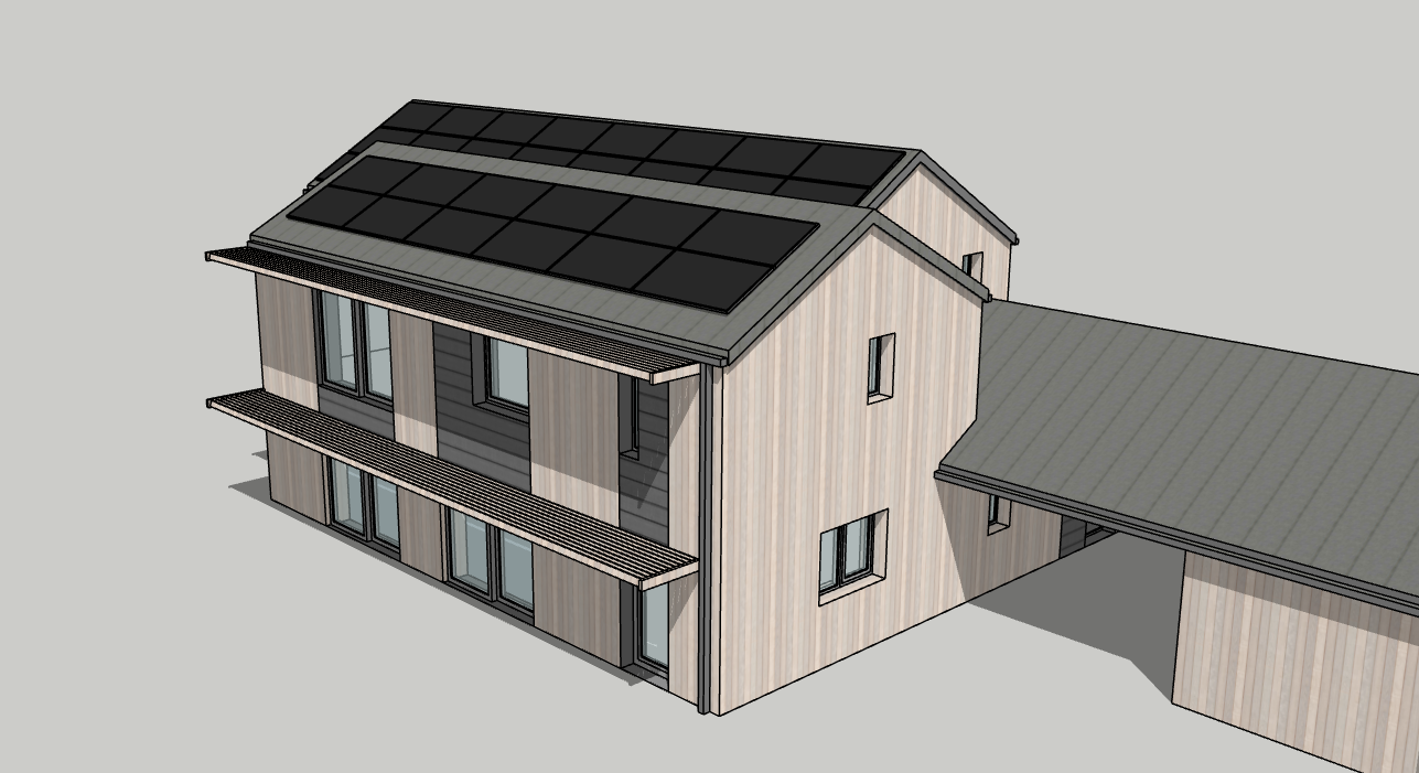

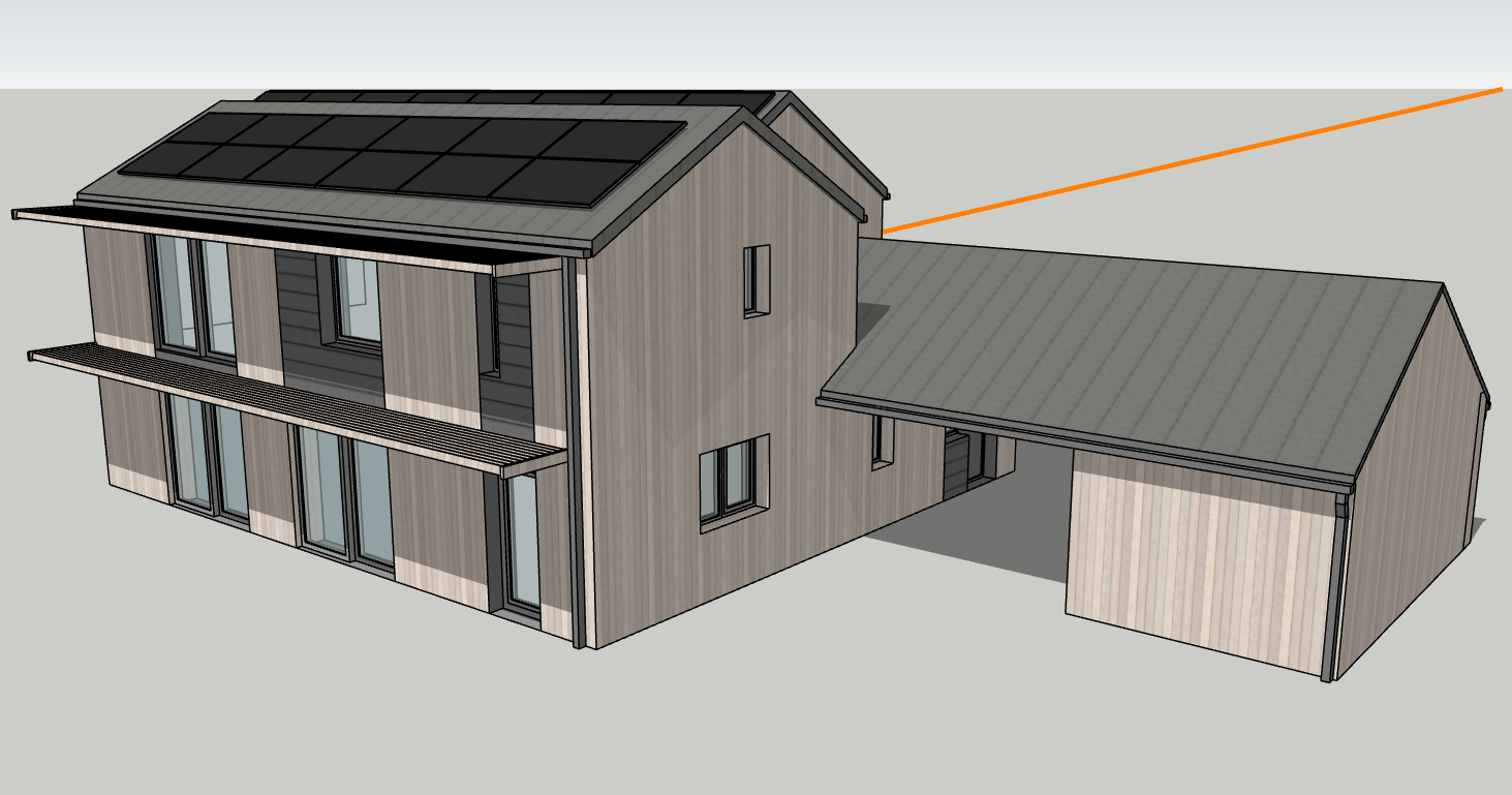

Furnace Posted February 13, 2023 Author Share Posted February 13, 2023 Progress is being made on the project and the planning application is due to be submitted in the next week or so. The only thing left to finalise is the shading requirement to avoid excessive solar gain, and I soon should have those details back from the PHPP consultant. 3d.pdfelevations.pdfplan.pdf Next major step I'm researching is build system, although I'm already pretty sure it will be timber framed due to low embedded energy and speed of erection. I'm attracted to factory built panels that are craned into position, although since there may be some issue with artic access down a 1/2 mile drive with overhanging trees I'm also open to a more labour intensive system of a kit comprising precut plates and studs that are assembled on site, but delivered on smaller vehicles. Companies I have in mind for prefab are MBC and Eden Insulation? Anyone have experience of Eden? I understand they're used by Justin Bere and Ecoarc. For "stick kit", has anyone any recommendations? All comments welcome Link to comment Share on other sites More sharing options...
IanR Posted February 13, 2023 Share Posted February 13, 2023 26 minutes ago, Furnace said: I spoke with Rob Cullen today. He explained that they design timber frames and have a preferred timber mill in Gloucester that machines and prepares the parts to his design. These parts are then shipped to the site and erected by the customer's choice of builder. Is that the route you followed? Mine came as a frame package with Touchwood Homes, so Touchwood "introduced" CTD to me and I worked with them and Touchwood to develop the Frame. Touchwood then took delivery of the frame at my site and erected it on the insulated raft I'd contracted separately with AFT. CTD, Touchwood and AFT were all first class. There's a few image of my frame in the following thread. 32 minutes ago, Furnace said: may have site access issues depending on panel size since I'm at the end of a half mile drive with overhanging trees and some 90deg bends, so the smaller vehicles possible with the "stick construction" approach may be better. I believe there was an option to pay a bit more for delivery on smaller vehicles, but my frame was delivered on a couple of artics. I knew they wouldn't be able to get up my track, so they parked in a layby opposite and we unloaded with a loadall. Link to comment Share on other sites More sharing options...
IanR Posted February 13, 2023 Share Posted February 13, 2023 24 minutes ago, Furnace said: Progress is being made on the project and the planning application is due to be submitted in the next week or so. The only thing left to finalise is the shading requirement to avoid excessive solar gain, and I soon should have those details back from the PHPP consultant. Looks very nice. But that South facing glazing is going to be an issue. I'm assuming there are good views, so you're going to want to keep the glass and mitigate it as best you can. Link to comment Share on other sites More sharing options...
Russdl Posted February 13, 2023 Share Posted February 13, 2023 (edited) @Furnace Indeed it looks very nice but I’m surprised at the form factor if a Passivhaus consultant was involved and as @IanR says you’ll need to watch out for that south facing glazing. Do you have shading/blinds planned for that? if not and it’s built to passive standards it’ll get mighty hot in there in the summer. Oh, and fill the whole south facing roof with PV whilst the scaffolding is up. Daft not to IMHO. Edited February 13, 2023 by Russdl Added the PV bit Link to comment Share on other sites More sharing options...
Nickfromwales Posted February 14, 2023 Share Posted February 14, 2023 Regarding 'unwanted' solar gain; You can do away with moving parts, such as blinds etc, simply by employing solar reflective glazing. This approach is embraced by the PHT and will be a far more sympathetic approach to a problem often inflated. Cooling in summer is far more costly to mitigate against, in a PH, than a resultant requirement for some mitigatory winter heating ( eg to combat the reduced solar gain ). I've consulted for clients, building their own homes, from PH to PH+ and above, and these issues can be easily resolved with some care, diligence, and an overall better understanding of "what can go wrong". Plenty of folk on here have also been kind enough to share their varying experiences, warts and all, so a good read up here can stand you in very good stead. Link to comment Share on other sites More sharing options...
Furnace Posted February 14, 2023 Author Share Posted February 14, 2023 Thanks @IanR @Russdl @Nickfromwales We'll definitely will need solar gain mitigation on the South elevation, but haven't yet shown it in the designs. The current view is to include brises soleils and don't yet know how much/many will be needed. @NickfromwalesReflective solar film is another route that could be used, although I'm uncertain about the "tint" when looking out from within? Any resources/recommendations to research this further? Thanks to all for helping on this rather daunting journey. Mark Link to comment Share on other sites More sharing options...
Iceverge Posted February 14, 2023 Share Posted February 14, 2023 hi @Furnace, a belated welcome. Really nail how much money you have to spend. Similar situation here. Passive house on a farm. Tricky access. Went through 3 sets of planning while dealing with some very slow and expensive land registry issues. in hindsight maybe 4 would have been even better! Spent the time getting to grips with PHPP, thermal bridging, airtightness, costings etc. I came to the conclusion a simple passive house was the cheapest to build so long as you avoided an expensive heating system. We went from a double house like yours to a simple square farmhouse shape, no valleys to leak, no difficult thermal bridges to deal with at single vs two story intersections. Cheaper to built and less costly to heat etc etc. It went from 200m2 to 225m2 to 185m2. The budget was fixed at €300k as the bank wouldn't give us a cent more. Had we tried to build one of the first designs we'd have run of cash or ended up super stressed and with a poor finish. As it was we ended up with everything spent but also with curtains hung and beds dressed. It's a nice design but I'm thinking £500k might not finish it out. Link to comment Share on other sites More sharing options...
Nickfromwales Posted February 14, 2023 Share Posted February 14, 2023 On 14/02/2023 at 10:21, Furnace said: @NickfromwalesReflective solar film is another route that could be used, although I'm uncertain about the "tint" when looking out from within? Any resources/recommendations to research this further? Sentinel by 3M is one, iirc. Try to get this factory applied to the glass vs retrofit. Apply the same tint to non-problematic glass on the same elevations, but use non solar-reflective 'tints' for those, eg so you can have mixed types but the solar reflective panes don’t stand out. Link to comment Share on other sites More sharing options...
Kelvin Posted February 14, 2023 Share Posted February 14, 2023 It looks nice but it’s not the cheapest build. The double roof adds complexity and therefore cost. Brise soleil can be very expensive to add to a building. It also looke pretty big. Does it need to be as large. Our house has ended up a bit bigger than we planned (202m2) but much smaller than a lot of self-builds. I was in a new barn style yesterday. Big south facing windows. No solar gain mitigation. The room was very warm. This was in Perthshire. They were saying it can get a bit unbearable in really hot summer days. The upside is their heating has hardly been on even through winter. Link to comment Share on other sites More sharing options...
Furnace Posted February 14, 2023 Author Share Posted February 14, 2023 On 14/02/2023 at 11:35, Kelvin said: t looks nice but it’s not the cheapest build. The double roof adds complexity and therefore cost. Brise soleil can be very expensive to add to a building. It also looke pretty big. Does it need to be as large. Our house has ended up a bit bigger than we planned (202m2) but much smaller than a lot of self-builds. You're absolutely right. The design is driven by the slightly triangular plot shape/size/orientation/views rather than optimum PHPP or build cost efficiency.(the design below is an earlier iteration) I've kept the size down to 250m2 which seems about right for both the plot and for the local market expectations for houses in this type of location. I experimented with making it a smaller and 3 beds, but it seemed to compromise too many other aspects and I think I'm OK with the size now. On 14/02/2023 at 11:17, Nickfromwales said: Sentinel by 3M is one, iirc. Apply the same tint to non-problematic glass on the same elevations, but use non solar-reflective 'tints' for those, eg so you can have mixed types but the solar reflective panes don’t stand out. Good idea. I'll see if I can get some samples. On 14/02/2023 at 10:58, Iceverge said: We went from a double house like yours to a simple square farmhouse shape, no valleys to leak, no difficult thermal bridges to deal with at single vs two story intersections. Cheaper to built and less costly to heat etc etc Yup, the valley is not my favourite feature but the architect is advising that it shouldn't be seen as a deal-breaker. As mentioned above, the shape is largely driven by the plot. However, all suggestions are welcome at this stage. It's far cheaper to make amendments on paper than when building!! This forum is so valuable for those who don't regularly build houses. Mark Link to comment Share on other sites More sharing options...
