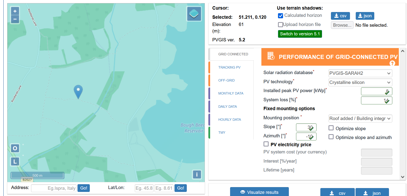

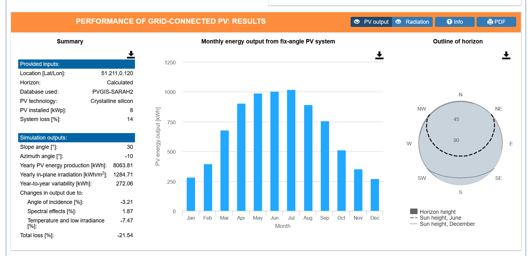

13 hours ago, SteamyTea said:
Did that take the shading into account, seems that the majority of the modules will be shaded for half the year.
Hi Steamy,
No shading was input on either of the calculators. Am I interpreting or inputting incorrectly?
Link to comment
Share on other sites
PVGIS allies you to add a local horizon. You will need to create a file and input that.
I have never done it, but others have, so probably not so hard.
Just looks to me as though the lower modules in the larger roof will be shaded a lot. Trouble with shading is that it can impact other modules if the installer does not use optimisers, which basically by pass the shaded module.
Then, if the unshaded modules do not create enough voltage, nothing is generated.
One way around this is micro inverters, so each module is, in effect, a stand alone system.
I suspect that the lower row of modules will have very low output, and probably not worth fitting.

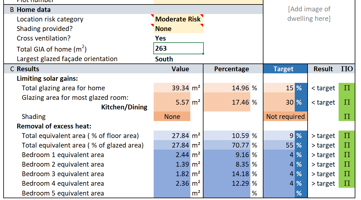

I know you’re doing PHPP but have you done your Part O modelling yet. You need to do that ideally before the planning.
Hi Susie,
We haven't done that. Is it a DIY job or need another consultant?

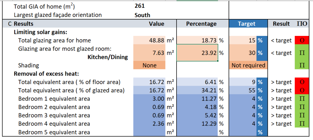

7 hours ago, Furnace said:
Hi Susie,
Best
Mark
There is a spreadsheet at https://www.futurehomes.org.uk/avoid-overheating
You can fill that in and if you get a pass you're done but it is very difficult to pass the spreadsheet method, this is supposed to be the simplified method but you will find it’s far from simple. It does not take into account MVHR, solar glass, shading.
For the dynamic modelling it’s buy the software or pay a consultant.
I had a simple single floor rectangle but still failed. We were not overglazed but did have a lot of non opening windows because we are having MVHR and I don’t want flies inside in summer.  Plus other reasons.
Have a look at the spreadsheet and if you need any help ask away I have learnt a lot.

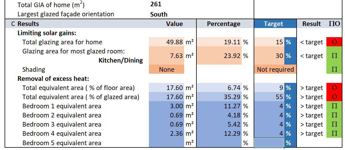

Yup, mine fails too. Sigh.....
PHPP returns a zero risk of overheating, but the Part O sheet suggests I need many more opening windows. That I won't open due to MVHR and insects.
I'll tinker with changing the fixed panes to opening and see if that might force a pass.
Sigh again
Link to comment
Sigh again
Can you put more windows on the North side that open?
I put opening roof windows on the North side. It made my North side the most glazed so my first two targets were easier to achieve.
I also have opening inward at 90 degrees and no arms length requirement.
you did well on the bedrooms.
Link to comment

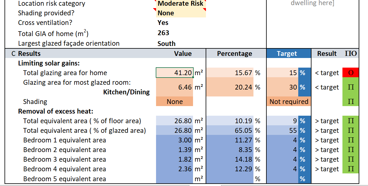

Your close to the target.
keep on tweaking sizes.
front door is probably not glazed only any side lights.
Where you ok with the open plan rules 4.5m depth restriction, if you have changed windows here check again it's still the same room.  We had open plan South, East and West it started 4.5m from South but after changing windows was 4.5m from East which meant most glazed room changed.
Link to comment

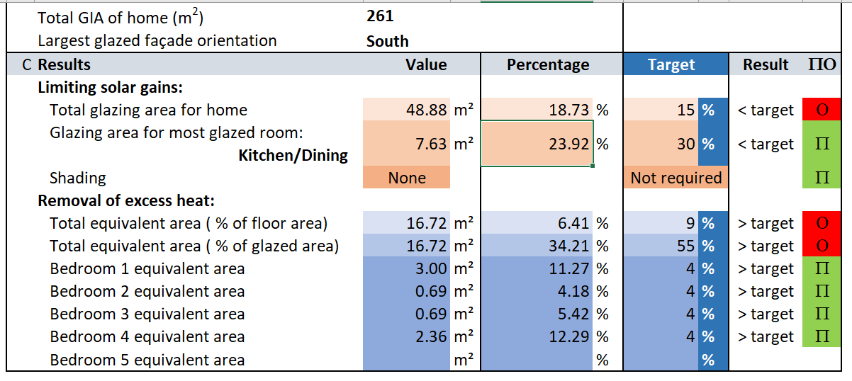

Squeaked in, but had to make a kitchen door unglazed and a utility room door half glazed. Not what I wanted.
I don't understand how shading is dealt with in Part O. My design has brises soleils on the southern aspect, yet I don't see how this is factored into the Simplified approach. Any thoughts?
Mark
Edited by Furnace
Resize image
Link to comment
Shading isn’t taken into account neither is MVHR or solar glazing.
You can take all of them into account if you do the Dynamic modelling.
So just two door changes and all windows open that’s not too bad.
Did you check the arms reach for opening windows or are they open inward?
You could put really cheap doors on and change them after completion.
I do wonder if it’s going to be checked.
Link to comment
Thanks Susie,
The spreadsheet looks like it calculates the effective opening angle based on the 650mm reach criterion and the 'distance of window from inside wall' cell that we need to input. This feeds through to the 'equivalent area' that modifies the total glazed area. I've converted one large-ish fixed pane to an inward opening window (that uses a 90deg effective opening angle) to benefit from its full area in the 'removal of excess heat' metric without negatively impacting the 'total glazing area' metric.
