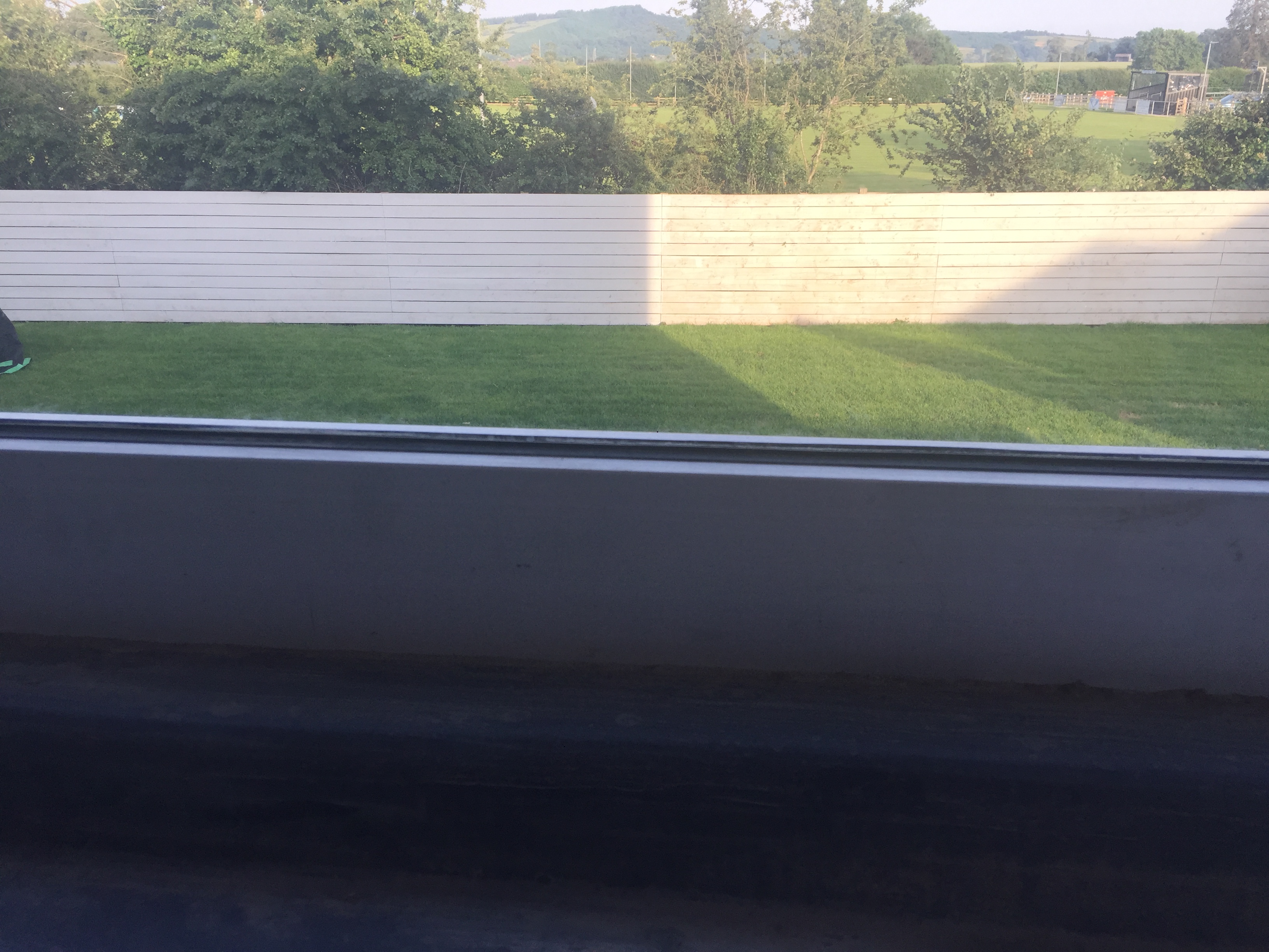

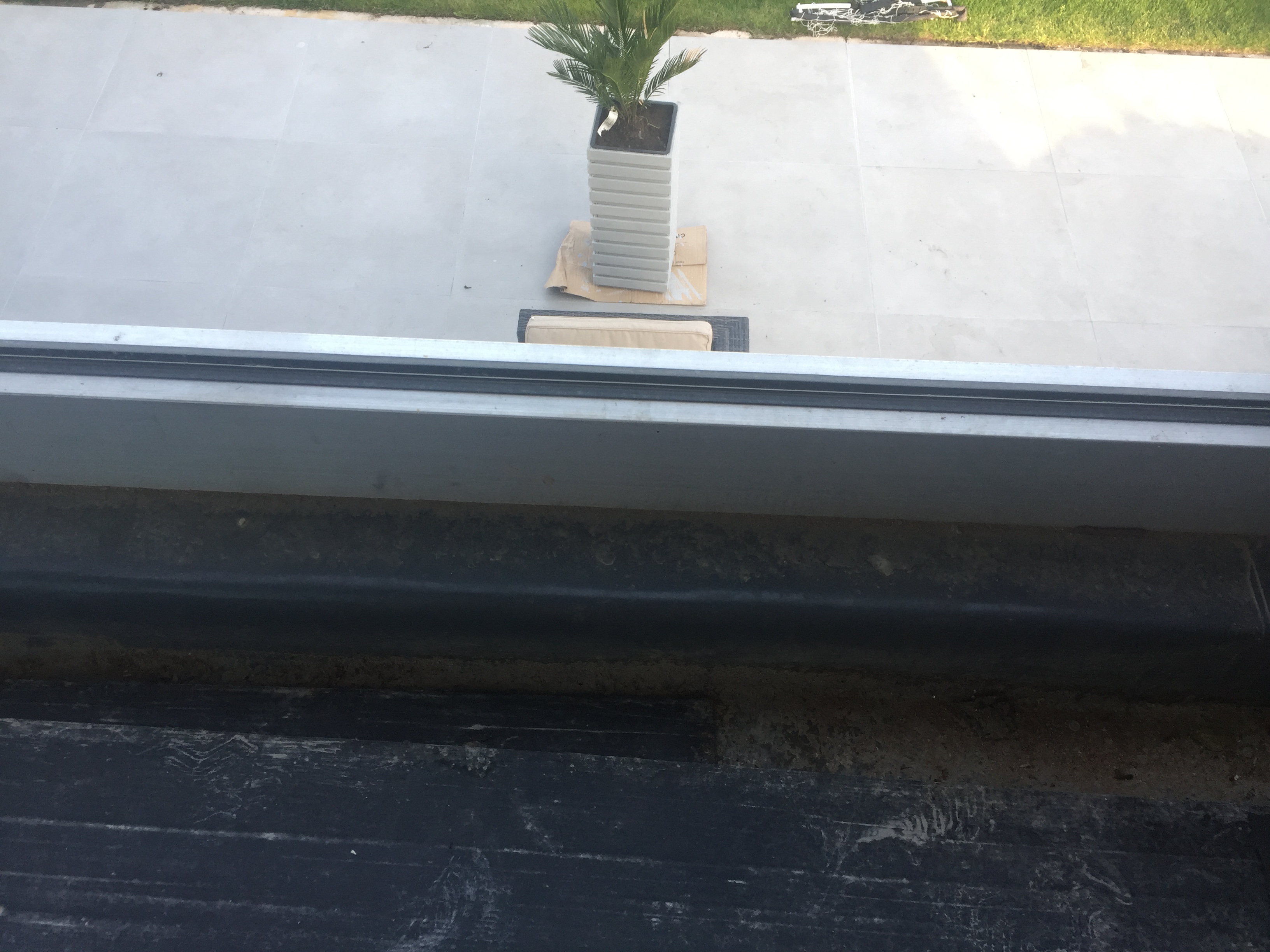

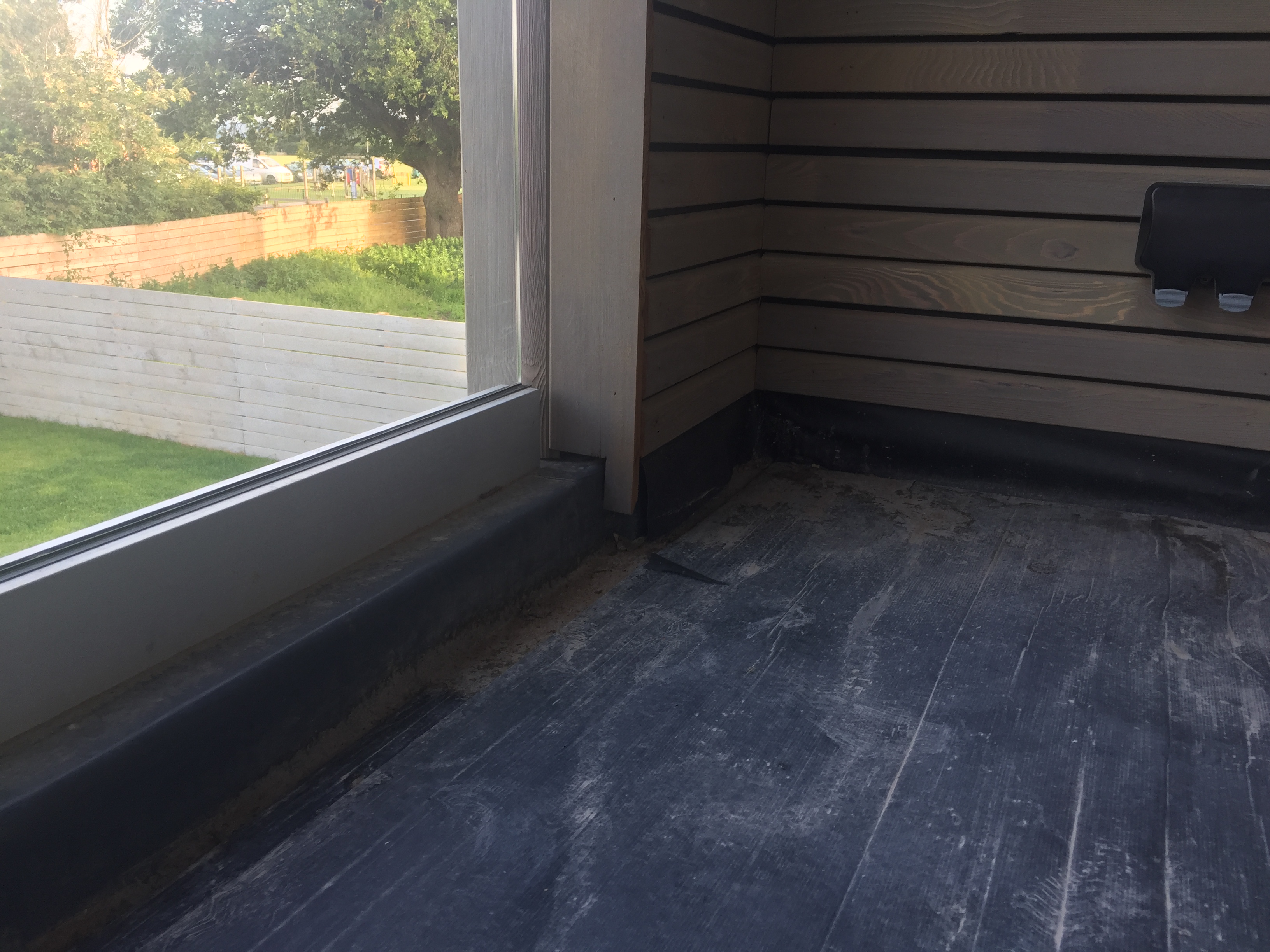

jack Posted June 19, 2017 Posted June 19, 2017 Lovely stuff. We have an almost identical balcony to our bedroom. On that point, any chance you might share details (particularly sections) of your balcony, especially the balustrade mounting and flooring detail? Your cladding looks a lot better than ours. We have Siberian larch. I've been interested to learn that weathering is at least, if not more, driven by exposure to rain than sun. This means that under every overhang we have a diagonal line where the rain gets to. I expected weathering gradients under the overhangs due to the sun, but thought they'd be a lot more of a transition than a messy line.

Trw144 Posted June 19, 2017 Author Posted June 19, 2017 (edited) 2 hours ago, jack said: Lovely stuff. We have any almost identical balcony to our bedroom. On that point, any chance you might share details (particularly sections) of your balcony, especially the balustrade mounting and flooring detail? Your cladding looks a lot better than ours. We have Siberian larch. I've been interested to learn that weathering is at least, if not more, driven by exposure to rain than sun. This means that under every overhang we have a diagonal line where the rain gets to. I expected weathering gradients under the overhangs due to the sun, but thought they'd be a lot more of a transition than a messy line. I ll have to try and find the final detail - essentially it's a flat roof with firrings to give it a fall either side (high point in the middle), and it has been built up with a couple of timbers on the outside edge which the Epdm membrane runs up, across and down. The balcony has then been screwed down with coach bolts through the timbers, and every other screw it is going past the timbers and into a steel section below. Edited June 19, 2017 by Trw144 1
jack Posted June 19, 2017 Posted June 19, 2017 Interesting, thanks. If you happen to come across it, that'd be great. I'm still puzzling over exactly how to handle mine, which is frameless glass like yours (into an extruded aluminium channel - is the grey strip along the bottom of yours a channel like that?)
Trw144 Posted June 19, 2017 Author Posted June 19, 2017 On 19/06/2017 at 19:48, jack said: Interesting, thanks. If you happen to come across it, that'd be great. I'm still puzzling over exactly how to handle mine, which is frameless glass like yours (into an extruded aluminium channel - is the grey strip along the bottom of yours a channel like that?) Here's some pics that hopefully help - the grey strip is a trim piece for the Epdm to give it a nice edge.... One of my final outstanding jobs is to put some composite decking down in the balcony. Need to measure up and work out what adjustable feet and frame I can use as the overall threshold needs to stay quite low. 1

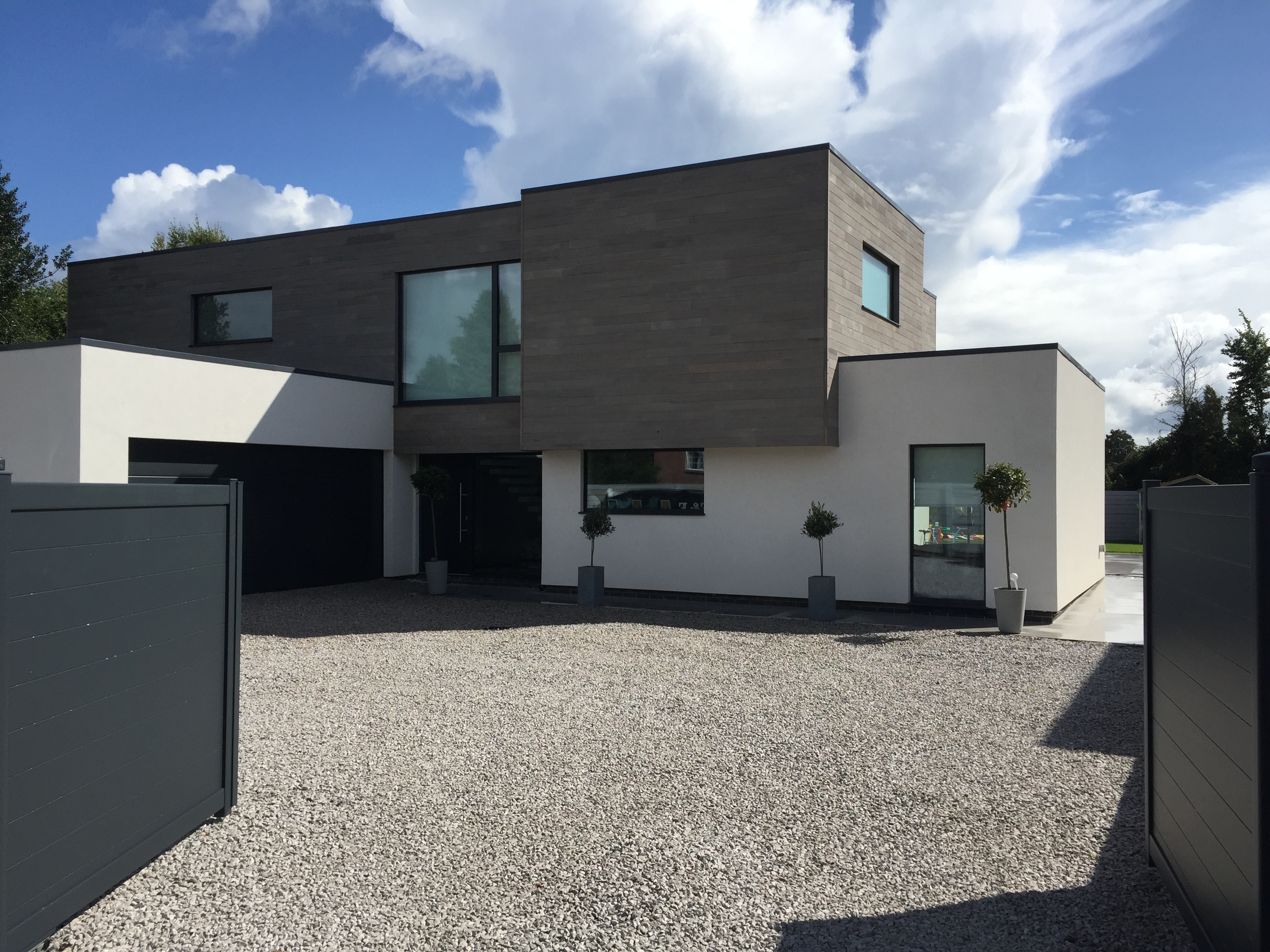

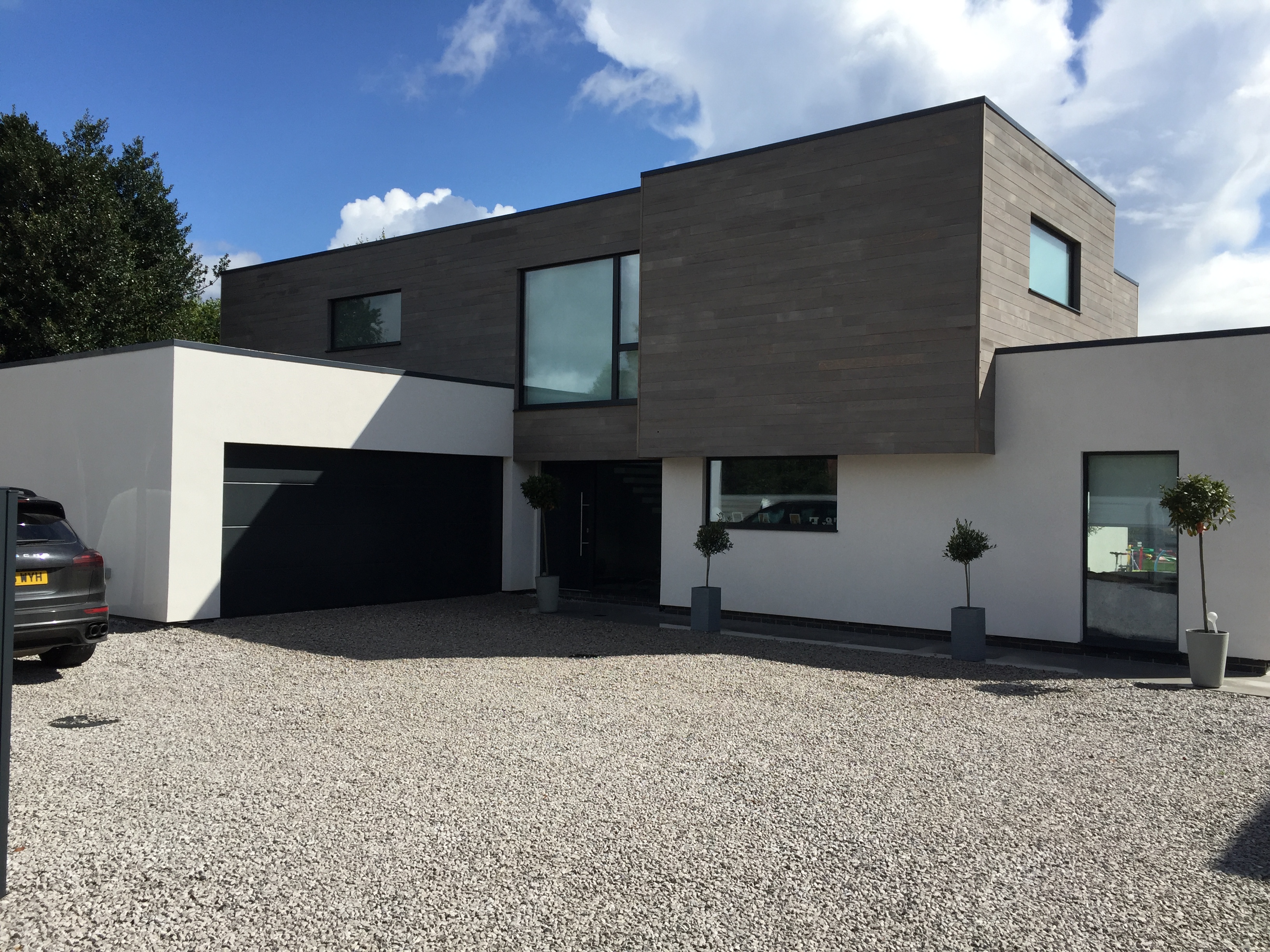

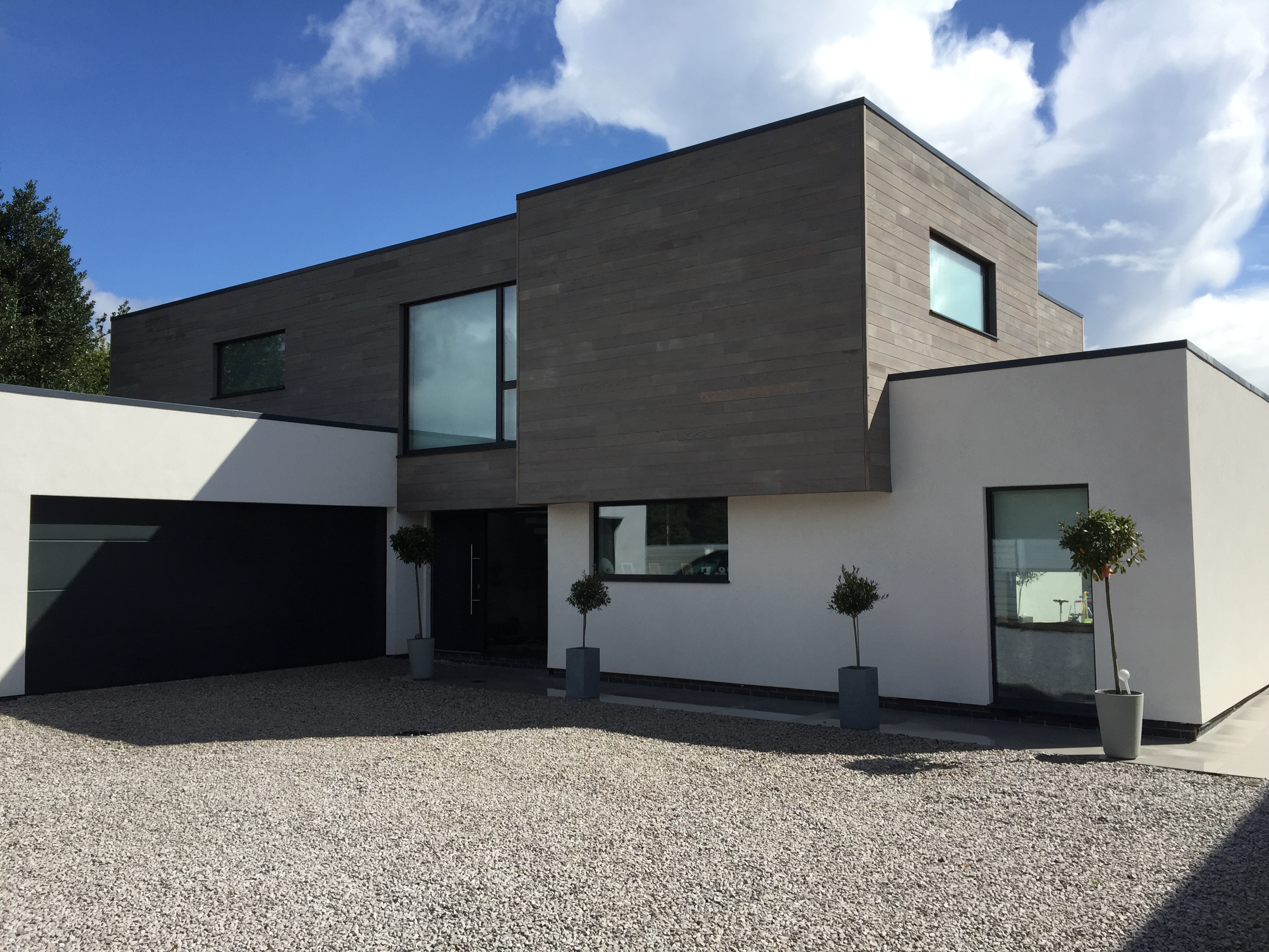

Trw144 Posted September 10, 2017 Author Posted September 10, 2017 Not the best pictures but eventually got round to taking a photo of the front .... 6
Trw144 Posted September 10, 2017 Author Posted September 10, 2017 Could do with some lighting ideas - was thinking of a uplighters on each of the four bay/olive trees and some floodlights/spotlights onto the walls by the garage and the single story on the other side. Will be building a matching tiled step by the front door with a recessed spot light shining up from either side
Nickfromwales Posted September 10, 2017 Posted September 10, 2017 Now your just showing off. I still chuckle when I read the title of this thread .
