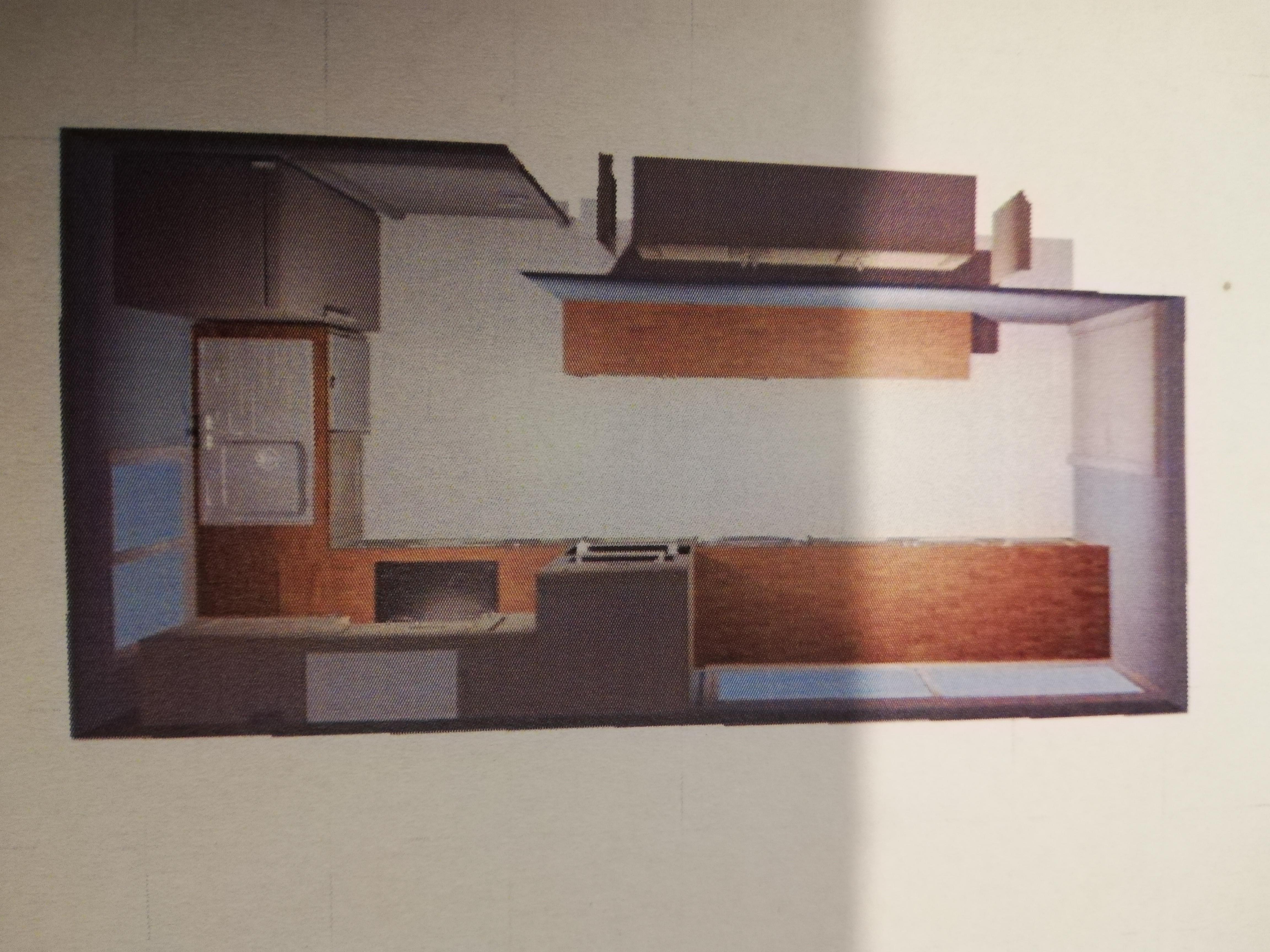

Rachelb94 Posted September 22, 2022 Share Posted September 22, 2022 Hello, Myself and my boyfriend have recently bought our first home and are looking at renovating the kitchen. Picture of the kitchen design we are thinking of is attached. However, it isn't the biggest kitchen. I'm worried that the breakfast bar surface on the opposite wall to all the main units will make it feel quite narrow when we are both trying to use the kitchen. What do you think? Our main reason for the bfast bar was additional work surface space, but maybe there is enough already. I know everyone's opinion is different but would be interested to know what others think-keep the bfast bar or take it out? Thank you Link to comment Share on other sites More sharing options...
ProDave Posted September 22, 2022 Share Posted September 22, 2022 What would the gap be between the run of units and the breakfast bar? I am not understanding the detail of what is behind the wall the breakfast bar is on? Link to comment Share on other sites More sharing options...
Rachelb94 Posted September 22, 2022 Author Share Posted September 22, 2022 Sorry yes I forgot to say ignore behind the wall... We were playing with the idea of cupboards high on the wall but then decided not to do that, so the designer man moved it out of view but should have deleted it really Link to comment Share on other sites More sharing options...

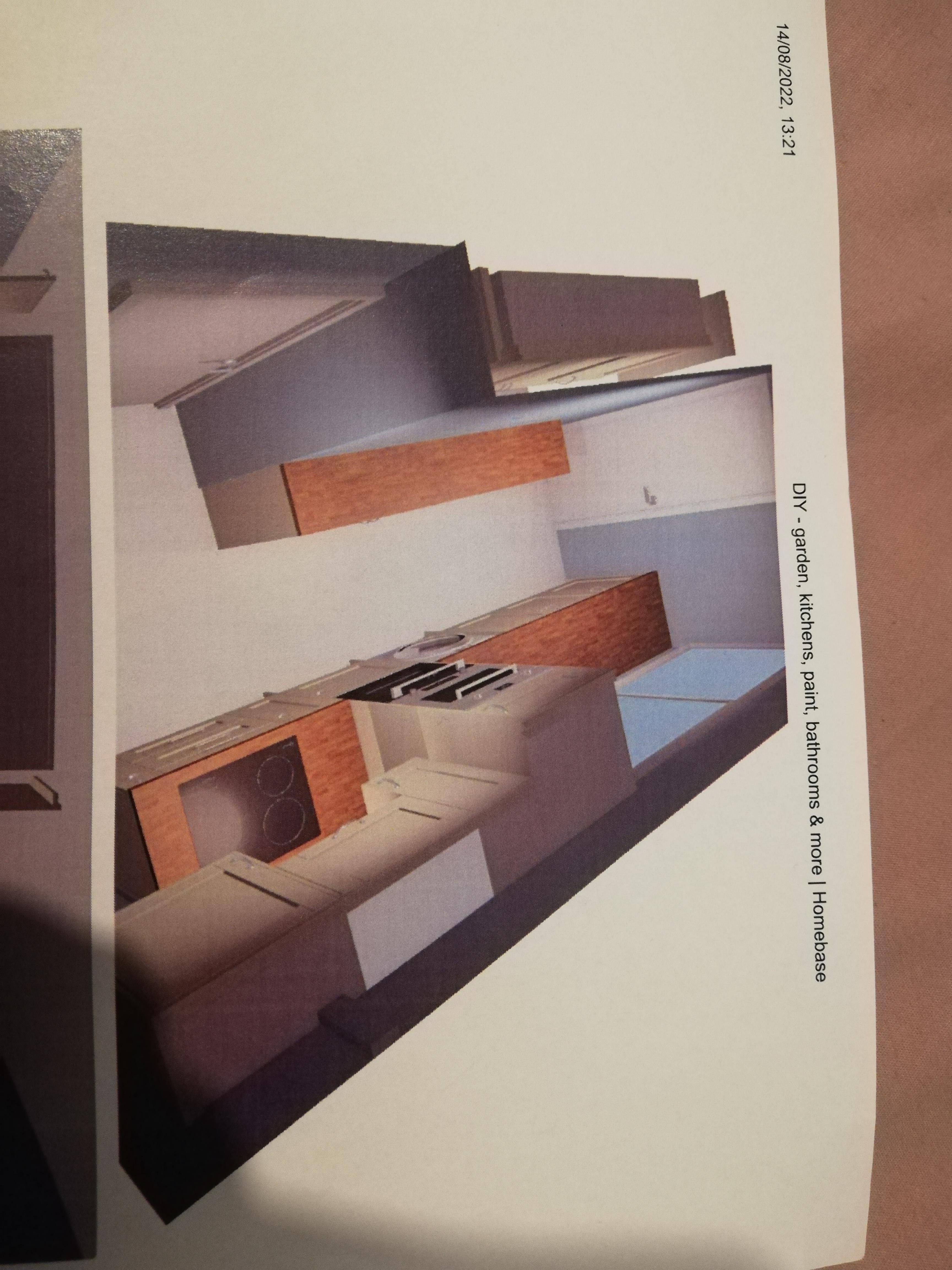

Rachelb94 Posted September 22, 2022 Author Share Posted September 22, 2022 Here's another view Link to comment Share on other sites More sharing options...
Marvin Posted September 22, 2022 Share Posted September 22, 2022 Looks like my mother's kitchen. About 1800mm across, so 600 counter and say 300 breakfast bar leaves what about a 900mm gap? If it was me I would do the kitchen without the breakfast bar and then see how it works out for you. Either way I think it's too long. Mum had a short draw under the bar for cutlery. Good luck M Link to comment Share on other sites More sharing options...
ProDave Posted September 22, 2022 Share Posted September 22, 2022 What is that big rectangular block behind the wall the breakfast bar joins onto? I would not to see something in the next room on the kitchen designers plan? We have a gap of 1200mm between the main units and the island, I would not want less. If the gap from the units to the wall is less than 1200 I would not want the breakfast bar. Link to comment Share on other sites More sharing options...
Rachelb94 Posted September 22, 2022 Author Share Posted September 22, 2022 Thanks yes don't think we will go with the breakfast bar then as the gap would only be around 900mm as Marvin said and think it would feel claustrophobic Link to comment Share on other sites More sharing options...
SimonD Posted September 22, 2022 Share Posted September 22, 2022 Hmmm, I think the layout is pretty poor. Is this designer actually a proper designer or someone who sits next to you at a diy store and plonks units into place on an app? Ditch the breakfast bar as I think you'll find it cramped. no way you want someone sitting there while you use the kitchen. But more to the point, the designer doesn't seem to have thought about how a kitchen works. There's very little usable worksurface next to the hob for prep etc. It'll be full when a kettle is there and there's some washing up on the side. You've got acres of worktop the other side of the oven which means you'll probably do all the food prep for cooking there and have to work round the oven - if you cook at all you'll hate this with a vengeance, even more if you use food processors etc.. The fridge is at the other end of the kitchen from this prep area too. The fridge opens out across what looks like a doorway and the other doorway opens virtually straight into the breakfast bar. Similarly it looks like the dishwasher opens out in the way of good access to and from the fridge and it would get in the way of the walkway to and from the door when open. I also think there are multiple issues with the high oven next to the window and the wall cupboards around the extractor that are next to the other window. I think this will create some weird light in the kitchen and maybe darken it. Tall oven cupboard in the middle of it all will make the space seem much smaller too. So for some constructive input, I'd suggest you play around with the layout by moving the sink and dishwasher (assuming it can be opened without getting in the way of the doorway) right across to the other side of the kitchen beneath the large indicated window. Then move the tall oven cupboard across next to the tall fridge. This way you'll have created yourself a load of space and a much better sense of space with good light. Also consider if you can live without the wall cabinets that are currently on the wall above the hob and just have a simple extractor. The other consideration is whether you could live with a simple one sided galley kitchen. Remove the tall oven cabinet and instead have the oven below the hob. Then you could turn the fridge 90 degrees around so that it opens towards the galley kitchen without getting in the way of the doorway. Sink and dishwasher again sit under the large window. I have worked in commercial kitchens, love cooking and so I spend a lot of time in my kitchen. Following the image you've shown, I would lean towards the galley kitchen. Clean, simple, functional, leaves space in the kitchen and it's cheaper. However, if you've just bought your first place, don't rush out to renovate the kitchen. Live with what you have for at least 6 months to get an idea of how the space works and how you use it - you'll be so much better and knowing what you want then. 3 Link to comment Share on other sites More sharing options...

Gone West Posted September 23, 2022 Share Posted September 23, 2022 10 hours ago, Rachelb94 said: Here's another view Without knowing the layout of the house it's difficult to say, but do you need two doors into the kitchen? Link to comment Share on other sites More sharing options...
