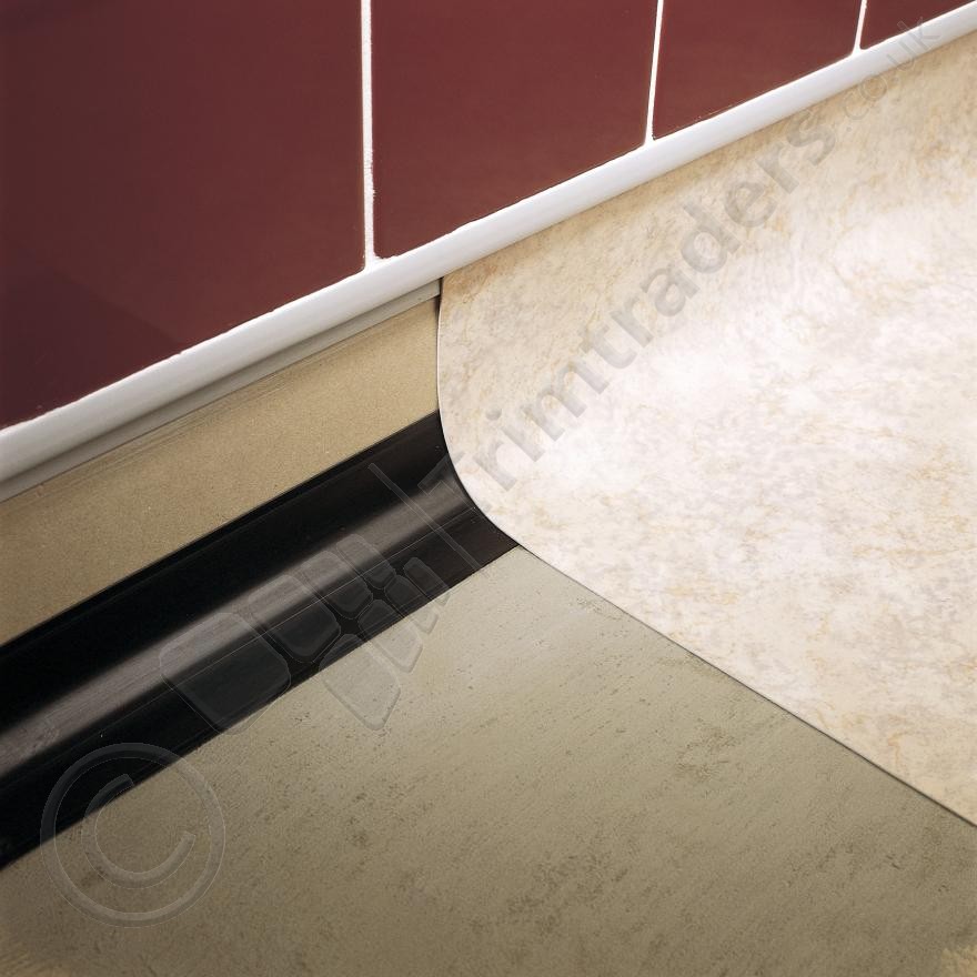

Guest Alphonsox Posted February 8, 2017 Posted February 8, 2017 Does anyone know a good place locally to source some trim to join vinyl to tile in a wetroom ? It seems to be known as "h" trim or "vinyl to tile capping" This type of stuff
