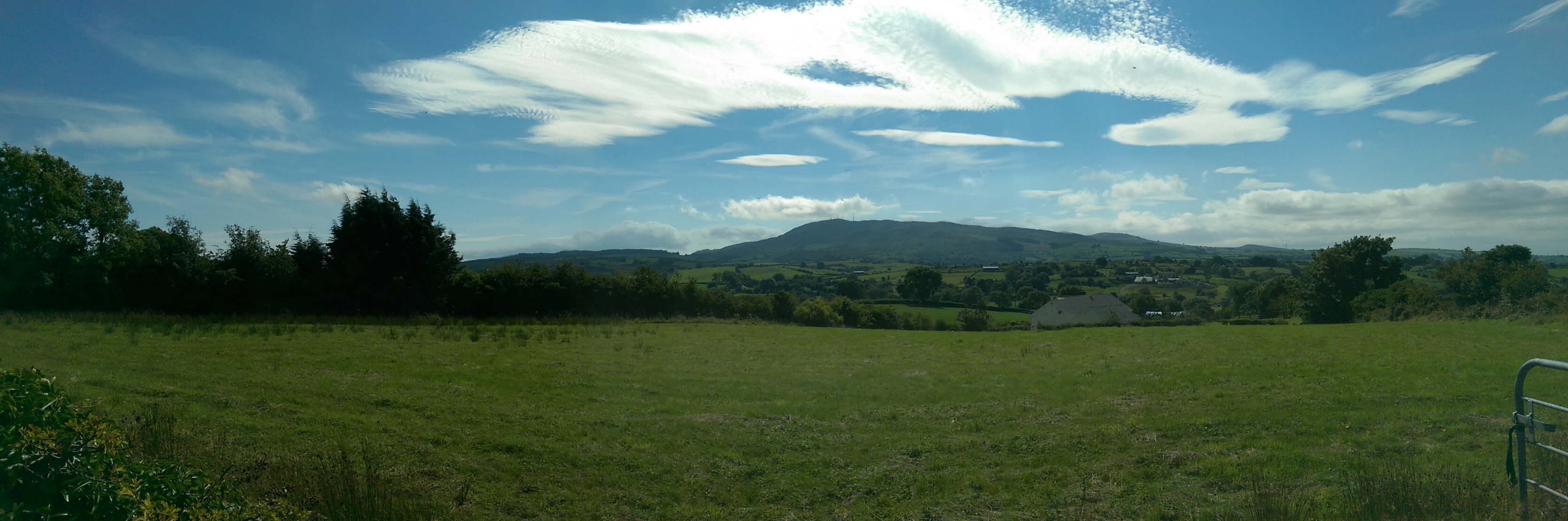

vfrdave Posted September 1, 2016 Share Posted September 1, 2016 A few questions for you good folk. Done some work on site clearing grass and cut a few trees down on Tues, boy was it warm. This a pic of site. Anyway I have to ditches sheughs on site both pretty much dry at the minute, was thinking of cleaning these out a bit and putting 150mm perforated twin wall in topped with clean stone. Is this a good idea? Or any other suggestions. Is BT pipe still 50/60mm grey and can blue water pipe just be buried without any other ducting? Thanks. Link to comment Share on other sites More sharing options...
Declan52 Posted September 1, 2016 Share Posted September 1, 2016 Lovely site. Are those the red hills in the distance??? For your ditch how much water flows through it in winter when it's at its worst. Is 150mm enough to take it away?? What's downstream of you as in if it blocks here where will the water go if it can't fill up the ditch?? Bt is grey duct. Water pipe can be laid in sand or dust with no duct. Link to comment Share on other sites More sharing options...
