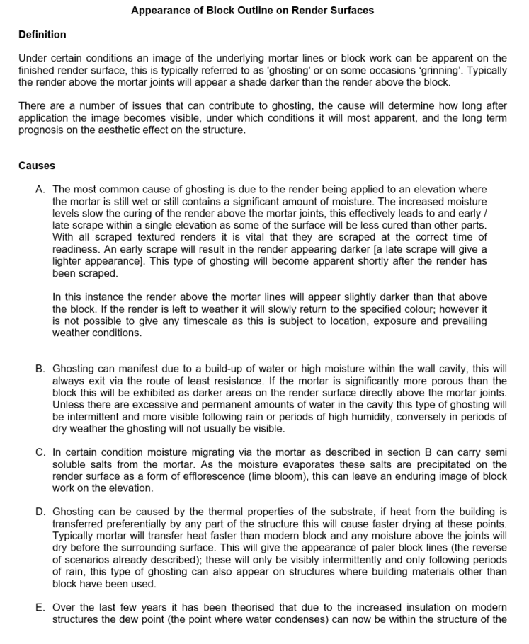

DeeJunFan Posted March 1, 2017 Share Posted March 1, 2017 Here is the document. Have a read and see which applies to you! D Link to comment Share on other sites More sharing options...
Declan52 Posted March 1, 2017 Share Posted March 1, 2017 Let it dry out fully as it's just usually the mortar getting wet that shows through. Not much drying this time of the year as well so the actual blockwork will still have a lot of water still in it before you started to plaster it. An old wives tale was that the mortar had too much cement mixed through it. Link to comment Share on other sites More sharing options...
