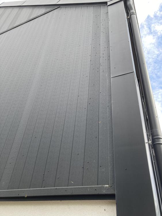

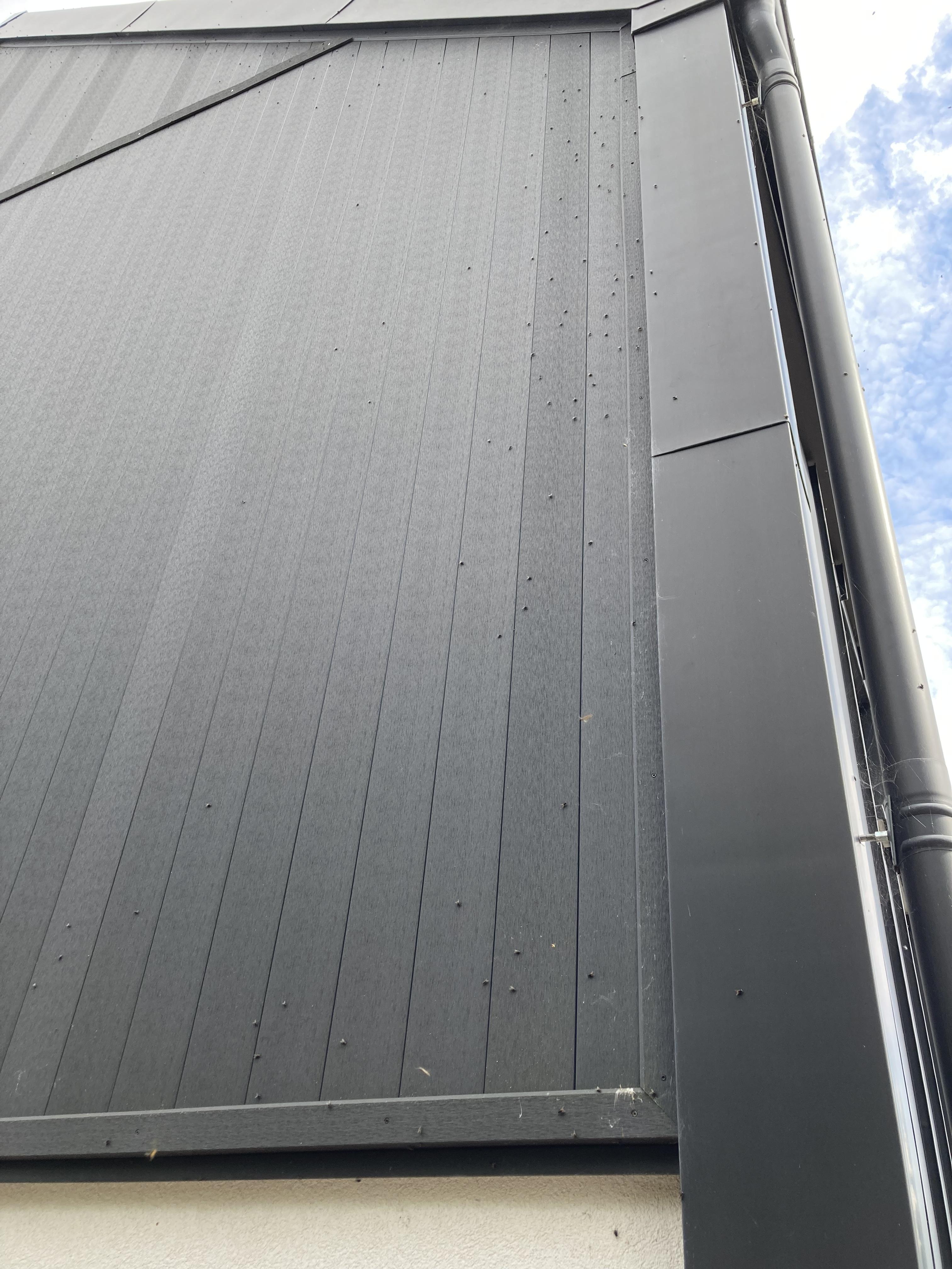

Russdl Posted September 11, 2022 Posted September 11, 2022 We had a fair few fly’s in yesterday, the sliders were open most of the day. I wonder if there is a ‘perfect storm’ for flies? We’ve just seen this on our cladding (zoom in, there’s lots there). Most of them are on the west facing cladding which hasn’t warmed up much yet. Any idea what’s going on?
Ralph Posted September 11, 2022 Posted September 11, 2022 20 minutes ago, Russdl said: We had a fair few fly’s in yesterday, the sliders were open most of the day. I wonder if there is a ‘perfect storm’ for flies? We’ve just seen this on our cladding (zoom in, there’s lots there). Most of them are on the west facing cladding which hasn’t warmed up much yet. Any idea what’s going on? We also have black cladding and it really seems to attract them. Being in the middle of trees and with a stream insects is a problem for as when we leave the sliders open, which I do all the time.
Radian Posted September 11, 2022 Posted September 11, 2022 2 hours ago, Russdl said: We had a fair few fly’s in yesterday, the sliders were open most of the day. I wonder if there is a ‘perfect storm’ for flies? We’ve just seen this on our cladding (zoom in, there’s lots there). Most of them are on the west facing cladding which hasn’t warmed up much yet. Any idea what’s going on? Have a search here and elsewhere for "cluster flies". They're looking for somewhere to over-winter and seem to understand that houses have warm spaces. Seriously.
ProDave Posted September 11, 2022 Posted September 11, 2022 6 minutes ago, Radian said: Have a search here and elsewhere for "cluster flies". They're looking for somewhere to over-winter and seem to understand that houses have warm spaces. Seriously. Yes, they have worked out they can get through the first outer seal on our windows but no further. So if you open a window in winter chances are a load of dozy sleeping cluster flies will fall out.
Russdl Posted September 11, 2022 Posted September 11, 2022 45 minutes ago, Radian said: Have a search here and elsewhere for "cluster flies". 37 minutes ago, ProDave said: Yes, they have worked out they can get through the first outer seal on our windows but no further. Ah yes. Thanks for the reminder. I do remember stuff about that now. They are squeezing between the WPC cladding and the zinc cladding but I’m quietly confident they won’t get any further as I still bare the scars of the ‘death by a thousand cuts’ from installing the acres of insect mesh, but I shall keep a beady eye on the little fockers.
