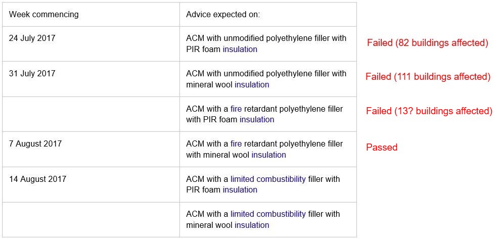

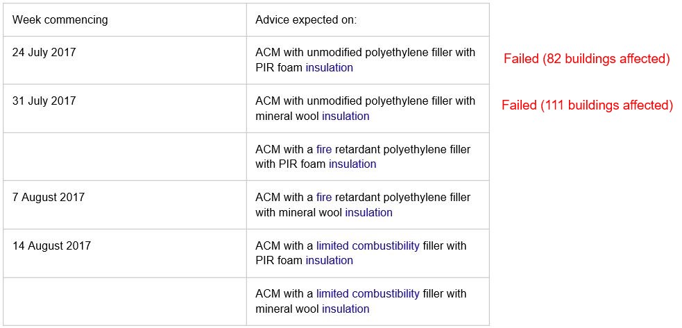

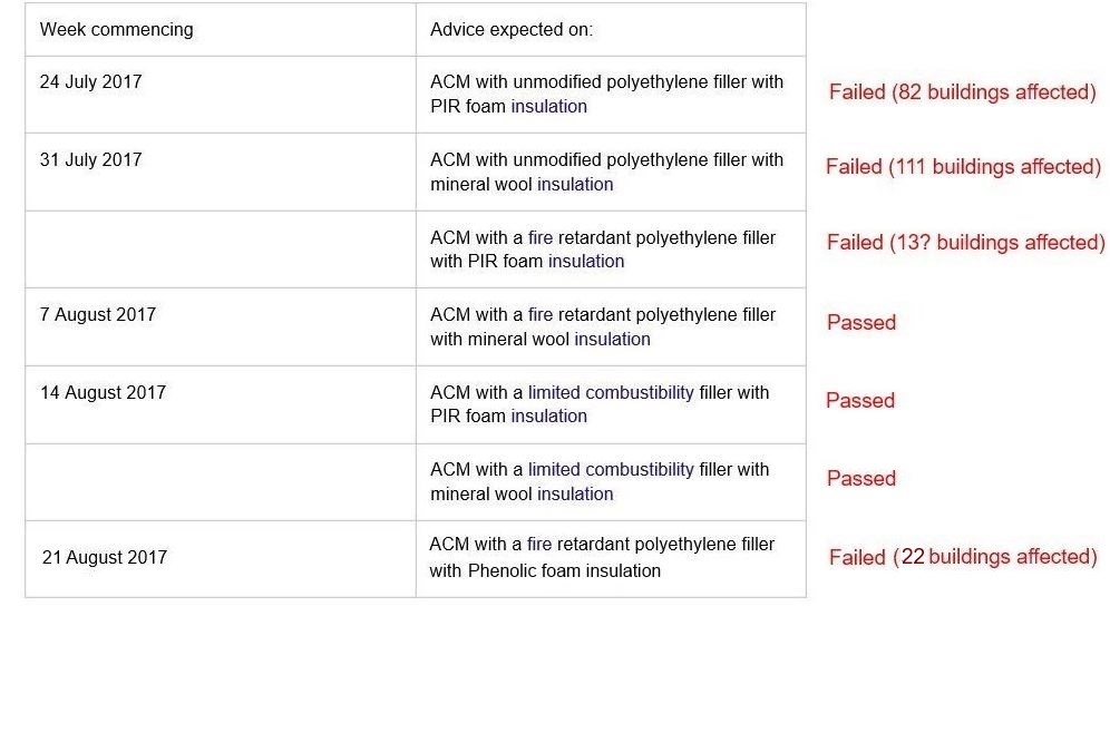

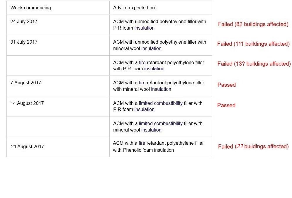

Temp Posted August 27, 2017 Posted August 27, 2017 The 6th combination (Rock wool and ACM with a limited combustibility filler) passed..https://www.gov.uk/government/publications/advice-for-building-owners-large-scale-wall-system-test-6https://www.gov.uk/government/publications/fire-test-report-dclg-bs-8414-test-no6 So overall its looking as expected. Rockwool is safer than PIR but some combinations of PIR and cladding are ok.
Jeremy Harris Posted August 27, 2017 Posted August 27, 2017 There are some unusual looking results in there, that make me curious as to the validity of the pass/fail criteria. For example, it seems reasonable to assume that in the test with the ACM with fire retardant PE filler and PIR foam, that the major fuel source was outgassing of the PIR, especially given that there is a significant body of evidence that shows that PIR does provide a fuel source for vertical surface fires, even though the body of the foam tends to char and degrade, rather than burn through. However, we then have a test with ACM with a limited combustibility filler and PIR foam that passed. On the face of it, these two test results look odd. If the major fuel source is not the PIR, but the ACM filler, then I would expect the limited combustibility filler to contribute more fuel than the fire retardant PE. From the tests with mineral wool (which we know is virtually non-combustible, it seems that neither the fire retardant PE, nor the limited combustibility filler, were significant fuel sources. These tests seem to raise more questions than they answer. They do, however, indicate that buildings with mineral wool insulation are OK, as long as the cladding is fire retardant.
Temp Posted August 28, 2017 Posted August 28, 2017 16 hours ago, JSHarris said: I would expect the limited combustibility filler to contribute more fuel than the fire retardant PE. I also thought that was odd but googling suggests "limited combustibility" materials are actually less flammable than "flame retardant" materials. For example the reports refer to.. "ACM with a limited combustibility filler (category 1 in screening tests)" "ACM with a fire retardant polyethylene filler (category 2 in screening tests)" The lower the category the less dangerous. Category 0 is non-combustible
