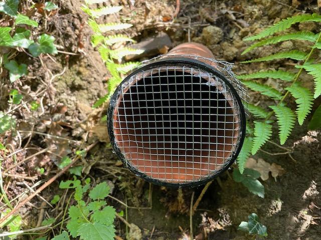

Thorfun Posted September 10, 2022 Share Posted September 10, 2022 greetings. we have 3 drainage outlets from our new build into a ditch running alongside our property, one from STP and RWH, one land drain from our green roofs and another 110mm pipe from other roofs not feeding our RWH tank. I'm thinking of adding something to the end of the pipe to protect from potential rodent incursion. firstly, is this paranoia gone too far? I see there are metal NRV for this but at £50 a pop seem a little excessive and we have NRV on the outlet pipes from our STP and RWH tanks anyway. so I was wondering if anyone had any other recommendations for this? I found these on Amazon which might do the trick although a determined rat could probably gnaw through the plastic. I've also though of 3D printing something like this but I'm not sure of the effectiveness of it. and a final thought is a simple 110mm vent like this from Screwfix but, again, don't know if it will work. anyone else paranoid enough to worry about rats in the drains and done anything about it? 1 Link to comment Share on other sites More sharing options...
markc Posted September 10, 2022 Share Posted September 10, 2022 Chicken wire or similar mesh, scrunch up into a ball shape and push into the pipe. Rat proof, easy to pull out and clean/check and no fixings to rust or seize. 2 Link to comment Share on other sites More sharing options...
joe90 Posted September 10, 2022 Share Posted September 10, 2022 19 minutes ago, Thorfun said: is this paranoia gone too far? NO, A rat got into my STP and blocked a pipe, smells alerted me and after “fishing” i got it out, I had no grill on the outlet pipe to a ditch which is where it must have got in, I simply used a grill fir the top of a vent stack. 1 1 Link to comment Share on other sites More sharing options...
Radian Posted September 10, 2022 Share Posted September 10, 2022 Forget using anything made from plastic. If it's in their way, they have all the time in the world to chew through it. And it doesn't take them all that long anyway. 2 Link to comment Share on other sites More sharing options...
Thorfun Posted September 10, 2022 Author Share Posted September 10, 2022 thanks all. sorry to hear about your issues @joe90 and glad my paranoia is justified. I will forget plastic as I know a determined rat will/can chew through it. we're leaning towards some kind of steel mesh fitted over the end of the pipe and held with adhesive of some kind. we walk up the road past the ditch most days taking the dog for a walk so we can always keep an eye on things to see if it's come lose or fallen off or something. Link to comment Share on other sites More sharing options...

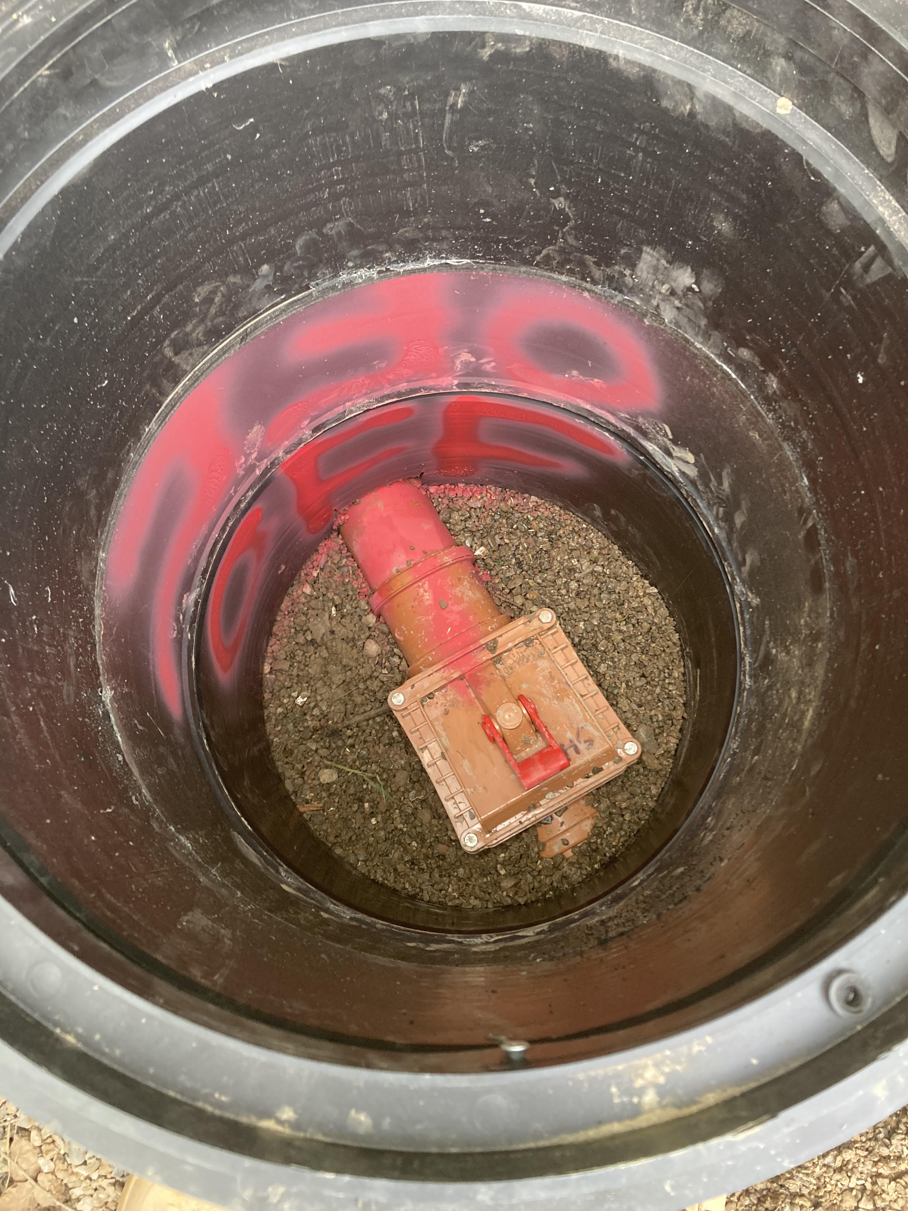

nod Posted September 10, 2022 Share Posted September 10, 2022 2 hours ago, Radian said: Forget using anything made from plastic. If it's in their way, they have all the time in the world to chew through it. And it doesn't take them all that long anyway. 2 hours ago, Radian said: Forget using anything made from plastic. If it's in their way, they have all the time in the world to chew through it. And it doesn't take them all that long anyway. Flood valve ideal Stainless steel plate in there way Link to comment Share on other sites More sharing options...

Thorfun Posted September 10, 2022 Author Share Posted September 10, 2022 we have those flood/NRVs between our STP and RWH and the ditch but I have another 2 pipes which don't have such a thing. plus I want to stop anything nesting in the pipes even if they can't get past the NRVs. I'm thinking mesh covering the outlet and then held on with a plastic sleeve/collar on the outside of the pipe which I can 3D print. will take a photo once the solution is in place for everyone to see my cowboy work. Link to comment Share on other sites More sharing options...

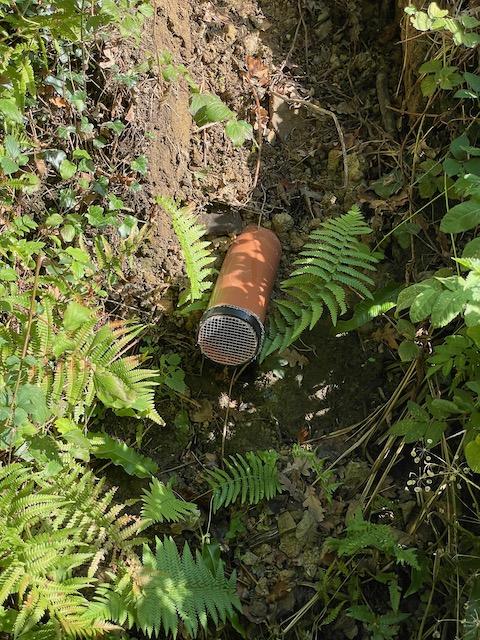

Thorfun Posted September 11, 2022 Author Share Posted September 11, 2022 (edited) first pipe done. should keep the little buggers out. 2 more to do once I've finished printing the collars Edited September 11, 2022 by Thorfun 1 1 Link to comment Share on other sites More sharing options...
Roundtuit Posted September 11, 2022 Share Posted September 11, 2022 Looking good. A cable tie and a couple of self tappers would be easier than printing perhaps. 1 Link to comment Share on other sites More sharing options...
Thorfun Posted September 11, 2022 Author Share Posted September 11, 2022 1 minute ago, Roundtuit said: Looking good. A cable tie and a couple of self tappers would be easier than printing perhaps. maybe and most definitely quicker! but why have a 3D printer if you're not going to use it? 😉 3 Link to comment Share on other sites More sharing options...
Roundtuit Posted September 11, 2022 Share Posted September 11, 2022 49 minutes ago, Thorfun said: maybe and most definitely quicker! but why have a 3D printer if you're not going to use it? 😉 Of course...🙂 Link to comment Share on other sites More sharing options...
