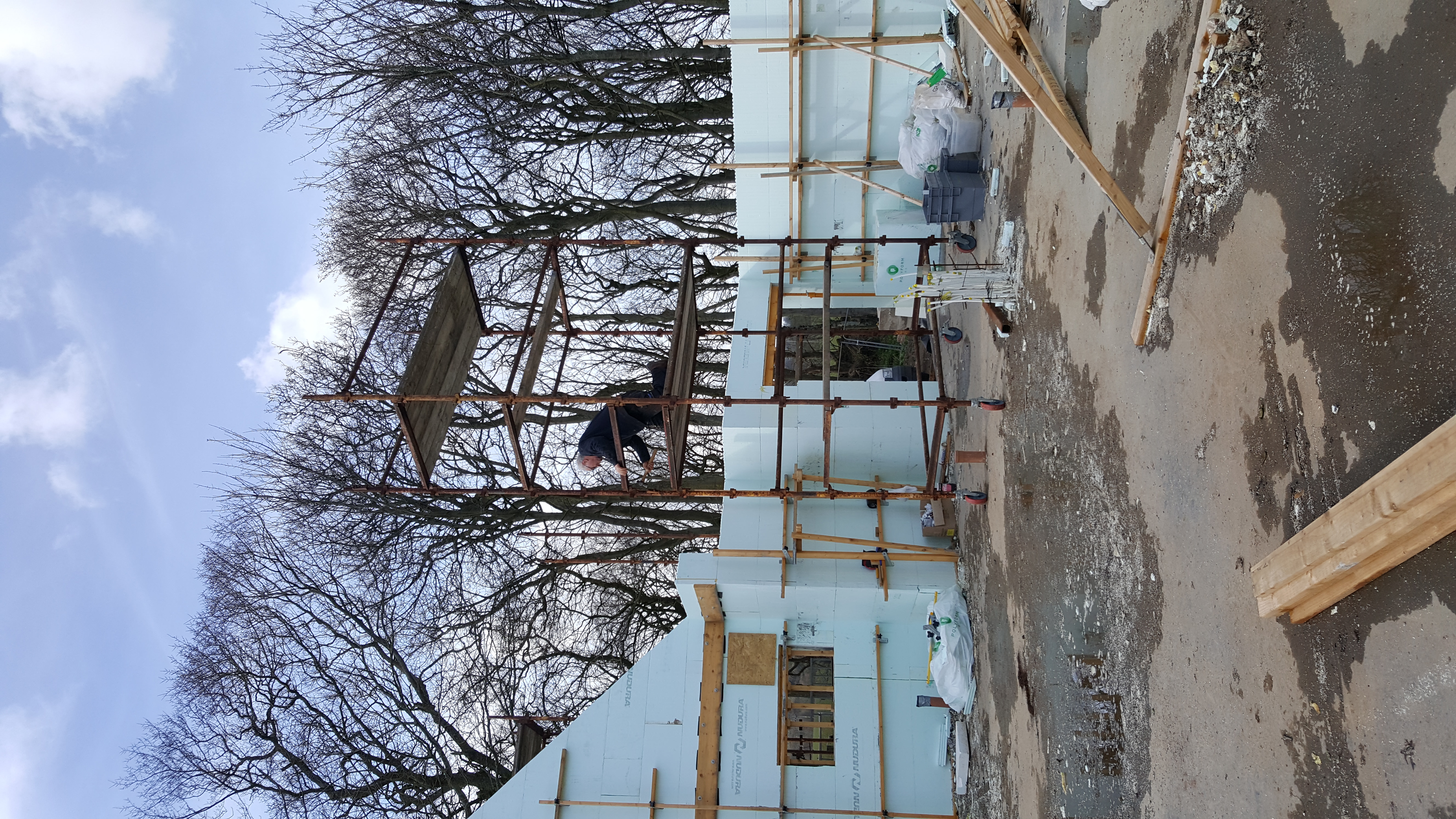

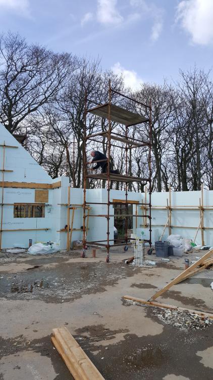

I've got Kwikstage and its brilliant ! We have 3 towers set up at the moment, one through a stair well too. I went for some options like the 2 board transoms and the hop up brackets and its been a godsend.
It will be for sale - but not until I've got the vaulted ceiling done !
