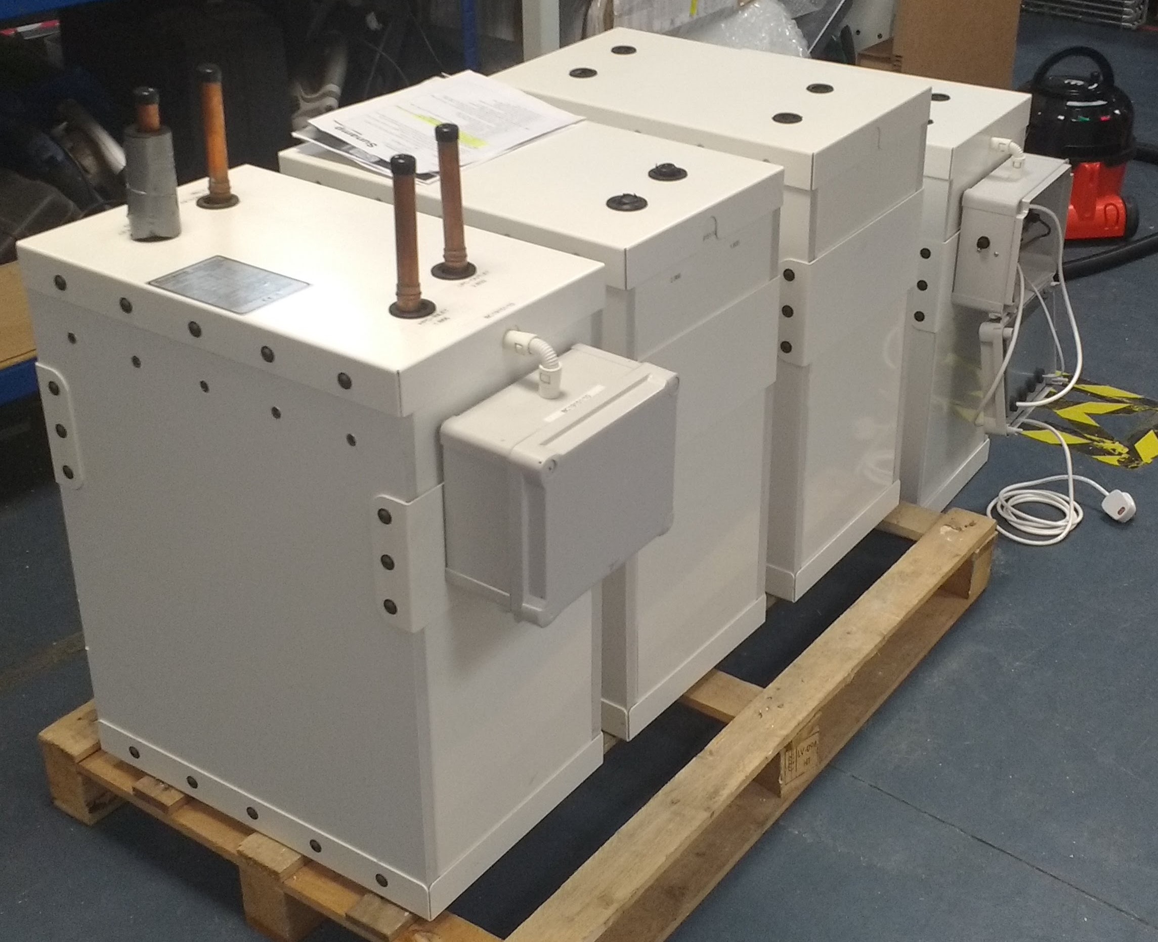

le-cerveau Posted February 24, 2018 Share Posted February 24, 2018 These are my units (Still at SunAmp) 2 dual port cells with PCM34 and 2 with PCM58. The one with the control box is the master the other the slave. Still awaiting wiring details but they will be going in in a few weeks. 4 Link to comment Share on other sites More sharing options...
AndyT Posted February 24, 2018 Share Posted February 24, 2018 3 minutes ago, le-cerveau said: These are my units (Still at SunAmp) 2 dual port cells with PCM34 and 2 with PCM58. The one with the control box is the master the other the slave. Still awaiting wiring details but they will be going in in a few weeks. Looking good you must be getting excited? 1 Link to comment Share on other sites More sharing options...
willbish Posted February 24, 2018 Share Posted February 24, 2018 I'm getting excited and they aren't even mine! 1 Link to comment Share on other sites More sharing options...
DenkiJidousha Posted February 24, 2018 Share Posted February 24, 2018 What does PCM34 and PCM58 mean? Is one handling your hot water and the other heating? Link to comment Share on other sites More sharing options...
Dreadnaught Posted February 24, 2018 Share Posted February 24, 2018 1 minute ago, DenkiJidousha said: What does PCM34 and PCM58 mean? As I learnt from this site myself, they are two different phase-change material compositions. And it relates to them being tuned to different input temperatures not output temperatures. For example input from an ASHP will be lower than that generated from PV electricity. 1 Link to comment Share on other sites More sharing options...
Onoff Posted February 24, 2018 Share Posted February 24, 2018 4 minutes ago, DenkiJidousha said: What does PCM34 and PCM58 mean? Is one handling your hot water and the other heating? Different composition phase change materials that change state at different temperatures as I understand it. To cope with different heat sources. 1 Link to comment Share on other sites More sharing options...
Nickfromwales Posted February 24, 2018 Share Posted February 24, 2018 Just now, DenkiJidousha said: What does PCM34 and PCM58 mean? Is one handling your hot water and the other heating? Im on the research, so will update again shortly as im due to do @AndyT's head in again on Monday with my 3rd round of "and what if I do it this way?" questionnaires. Link to comment Share on other sites More sharing options...
Jeremy Harris Posted February 24, 2018 Share Posted February 24, 2018 It's actually the phase change temperature, rather than the input temperature, in deg C. So PCM34 changes phase from liquid to solid, releasing heat at 34 deg C. Equally it changes phase from solid to liquid when heated to 34 deg C (actually a wee bit over). Same for PCM58, but at 58 deg C. The Sunamp PV uses PCM58, and the water temperature that comes out when it's running is pretty close to 58 deg C when it's got rid of it's residual stored heat. The heat batteries store heat in two ways in the Sunamp PV. One is by absorbing heat energy by changing the phase of the sodium acetate salt, the other is just heat stored conventionally by the heat capacity of the heat batteries. The total storage capacity initially, when the heat battery is still hot, is a bit higher than the phase change temperature. This means that when you draw hot water from one, initially the heat being drawn off is just that stored by the heat capacity of the heat batteries, then when it drops to 58 deg C, the salt starts to self-nucleate and change phase to a solid, releasing the heat from the phase change, plus a small amount of residual heat from the heat capacity of the material. This means there is a variation in heat storage capacity that is time dependent since the last charge for a few hours. 2 Link to comment Share on other sites More sharing options...
Dreadnaught Posted February 25, 2018 Share Posted February 25, 2018 (edited) For clarity, on the subject of maximum output temperature: if a SunAmp unit only has PCM34 cells then it can output any temperature up to about 34ºC (good for under-floor heating but inadequate for central heating with normally sized radiators or for domestic hot water) if a SunAmp unit has both PCM34 and PCM58 cells then it can output any temperature up to about 58ºC (good for domestic hot water) In each case, within the device the output can be blended down with cold water to any target output temperature below the limit. In a unit with both types of cell in series, PCM34 cells can be used to preheat water for PCM58 ones. (It is worthy of note that I have not heard of a SunAmp unit in the wild that has PCM34 cells alone). if you would like even more splendid @JSHarris-style detail, I found this re-post by @Alphonsox from another forum of an entry by Andrew Bissell (SunAmp CEO) from September 2015 instructive — look to the seventh comment: Edited February 25, 2018 by Dreadnaught Link to comment Share on other sites More sharing options...
le-cerveau Posted February 25, 2018 Share Posted February 25, 2018 7 hours ago, DenkiJidousha said: What does PCM34 and PCM58 mean? Is one handling your hot water and the other heating? The PCM34 batteries will be charged by my ASHP at around 40oC and the PCM58 batteries will be charged by the boiler at around 65oC. The UFH will take a feed from the PCM 34 batteries (same input as the ASHP). DHW will be pre-heated by the PCM34 Batteries then the PCM58 batteries. Effectively the PCM34 batteries are doing the same as @JSHarris buffer and the PCM58 batteries as is SunAmp PV. plumbing diagram below: Link to comment Share on other sites More sharing options...
