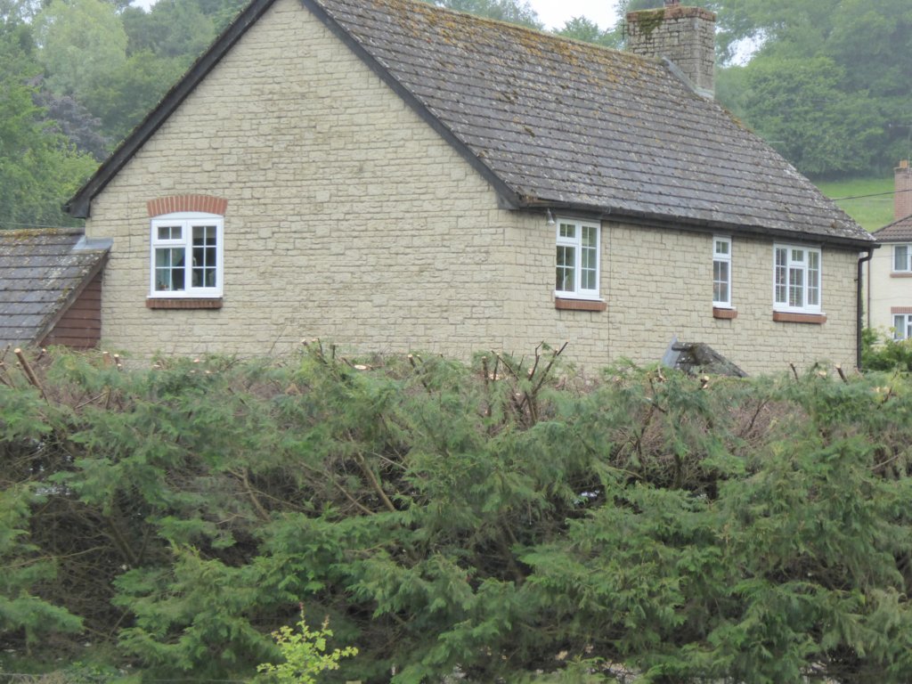

More of the hedge opposite has now come down, and it now looks pretty grim from our side (I'll try and post a photo of it later), and being Leylandii it almost certainly won't regenerate from low down, so it's always going to look dreadful.  Below is an older photo I've posted here before, showing the hedge as it was.  Now it has been cut to around the same apparent height as the roof of my car in that photo.  Before we couldn't see the house opposite at all, it was completely hidden by the hedge, now the first floor is completely visible:
The post and rail fence that's just visible in this photo is around 800mm high, and around 1.5m or so behind the boundary fence alongside the lane, which is 1.2m high, but its top is below the bottom of the nearest fence.  There's a steep bank between the two, with a young native hedge planted at the lower side of it.

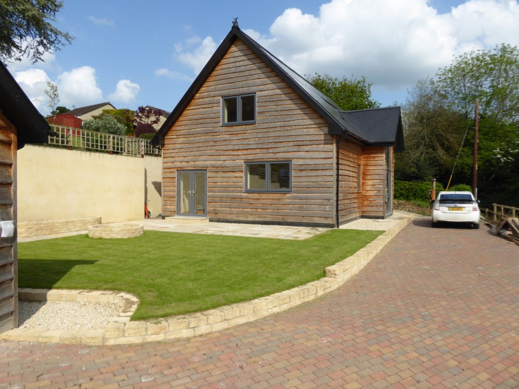

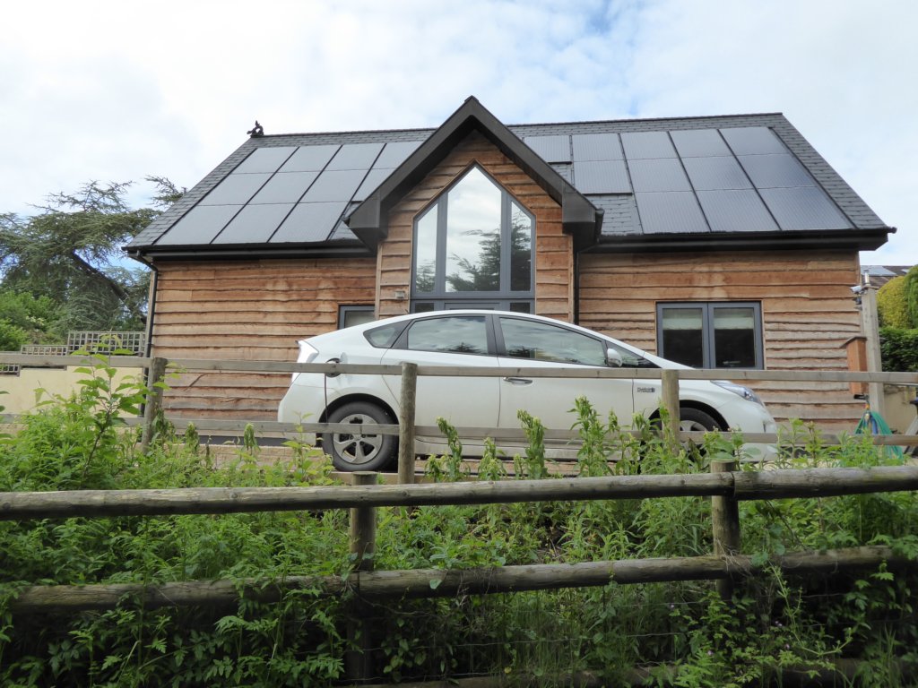

I've just managed to upload some photos, but only one of the hedge as it now is as the battery died in the camera.  Uploading on this slow connection isn't fun, either..........
This is what the front of the house looks like viewed from the level of the lane, which is around half a metre or so above the floor level of the house opposite:
The post and rail fence at the front is 1.2m high, but was included in our planning permission.  In amongst all the weeds there are some hedging plants.............  The post and rail fence behind is alongside a stone path that now runs next to the drive, and is about  800mm above the drive level at the top.
This is a photo taken some time ago, before the path was added along the side of the drive, but at the top right you can just see where the top of the hedge used to be, about level with the top of the power pole (in fact it was a metre or so above it, with the cable running through the hedge):
This is the view from the front now, taken from the centre of our house, by the front door.  The hedge used to hide the whole of this house, including the chimney:

Seeing the pictures the overlooking issue is not as bad as I thought, mainly due tot he angle of the house opposite. Do they actually use that bedroom with the window on the end?
I would probably just let your own hedge grow to the height you feel comfortable with.

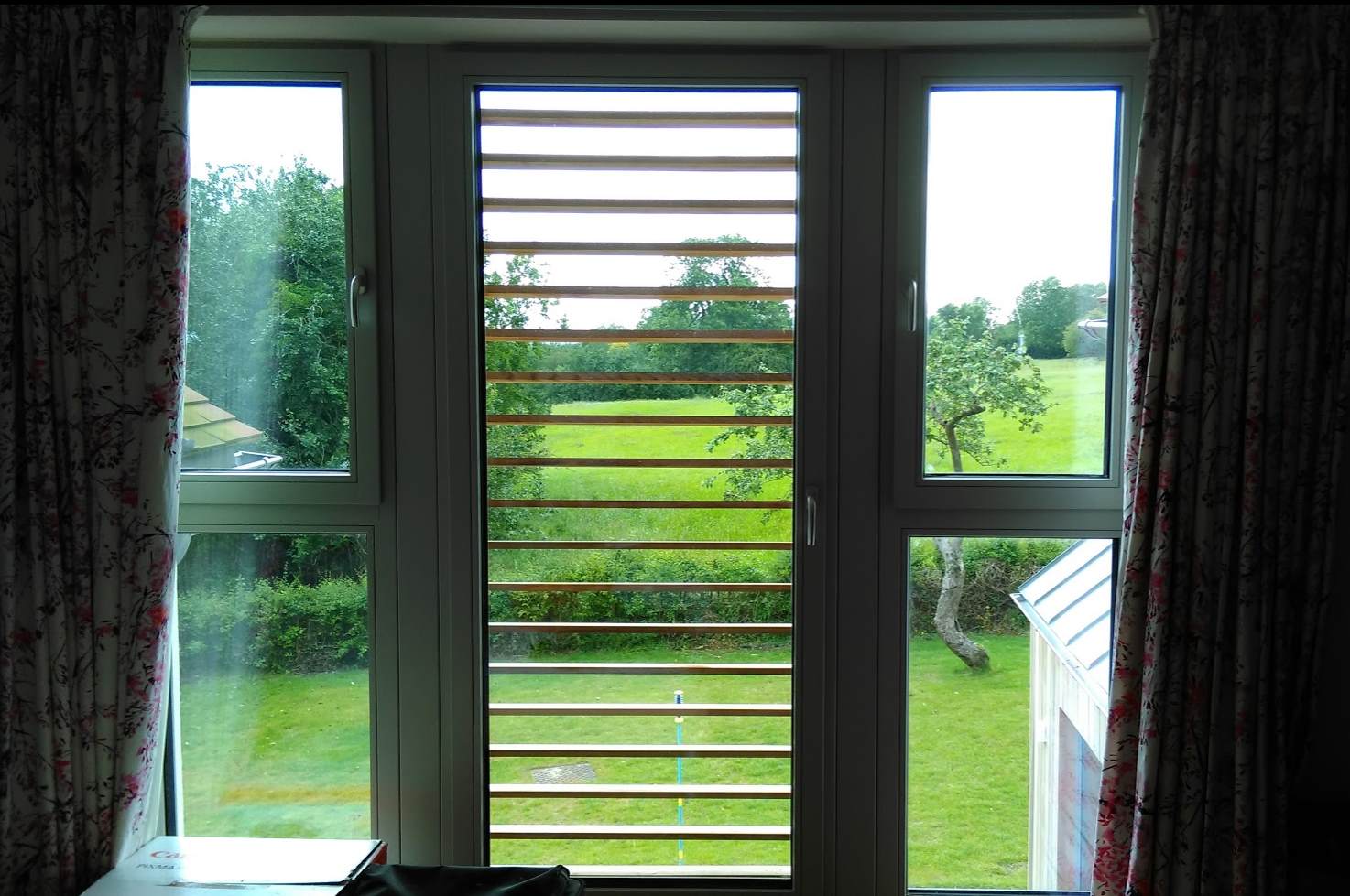

We have this. Stainless L-channel and plate knocked up by a local fabricator and off-the-shelf Canadian Western Red Cedar slats cut to size. I kept the downward angle of the slats small - about 10 deg - to permit water run-off without blocking the view and light.
In our case it has a practical purpose but is also an architectural feature.
Thanks very much @ragg987
I like the look of those slats, and it would solve both the overlooking and solar gain problems.  I could do something similar with some of the larch I have left over, I think.
Do you have a photo from inside looking out, by any chance?
Also, what are the dimensions of the slats?

These are the slats, 95mm x 20mm: https://www.vastern.co.uk/cladding/splayed-cladding/
Photo inside to out attached - this is my study and doubles as a spare bedroom (working from home today). A caution, this assembly is not light and you need to make sure you can anchor it well. We had 150mm x 150mm timbers behind the aluminium clad windows anchored top and bottom and the screws go about 120mm deep into that.
  • Like 1

Oh and I should mention that slat spacing had to comply with build regs for baby head gap - that middle window is actually a door the swings open completely. But that spacing with a 95mm extension works well for reducing solar gain.

@ragg987,
Thanks again, that's very helpful indeed.  I think we should be OK for fixings, as there are timber frame members either side of the window openings, with 50 x 25 battens on top, then the larch cladding, so I can screw right through the lot to give a secure fastening.  I may look at doing a sort of hybrid arrangement, with a fabricated stainless section to take the slats, but with larch cladding on the outer faces, to hide the stainless, only because that would blend in better with the house external finish.
I'm impressed with the visibility through 20mm thick slats, it's better than I thought it might be.  I'd want to angle the slats down much the same as you have, because the windows opposite are slightly higher than our ground floor windows, so a slight angle would not only help the rain run off but would also provide a bit more privacy.  I might also increase the spacing a bit, as we don't have a building regs issue, as both windows are too high from the floor level.  To compensate for this I think it would be OK to space the whole unit further off the wall, as this wouldn't cause a problem outside, at all.  The two windows I'd want to fit these two are the ones at either end of my car in one of the photos above.  The big glazed gable has external IR reflective film, that turns it into a one-way mirror most of the time.
