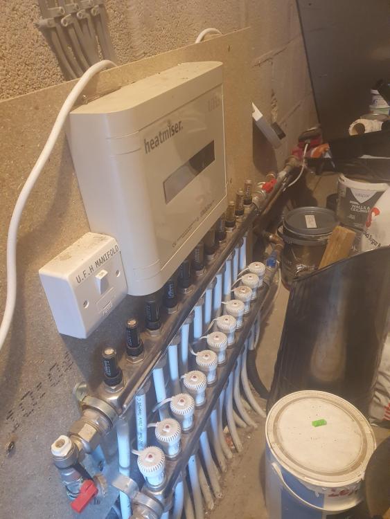

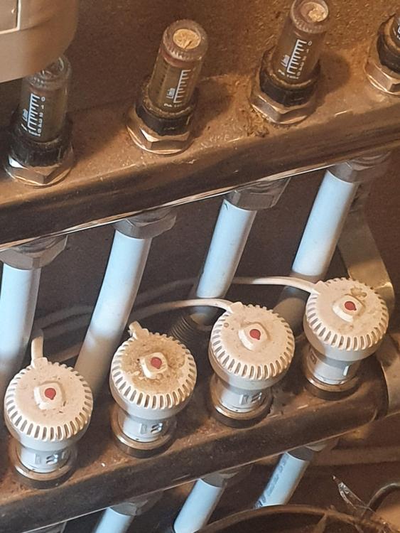

tommy12398 Posted August 8, 2022 Author Share Posted August 8, 2022 7 minutes ago, SteamyTea said: That it is the ASHP that is gobbling up all the electricity. You have been asked a few questions i.e. number of zones, flow temperature, running regimes, insulation under and over the UFH. Without knowing the answers to these, it is impossible to help you. 5 zones all set in winter at 19 through day. Drops to 17 through night 150mm insulation for ufh. I'm not what you mean by flow temp. The water in the system is at 45. Link to comment Share on other sites More sharing options...

SteamyTea Posted August 8, 2022 Share Posted August 8, 2022 Rather than have two threads on the same topic, shall answer here. The flow temperature is how hot the water is that runs though the pipes. 45°C is quite hot for UFH, expecially if you have 150mm of decent insulation under it. Is the floor covered. You also seem to have a number of seperate zones, though without seeing the manifold, it may be different. When your room temperature gets up to the 19°C, zones will start to close down (or the whole system my close down, hard to tell). What may happen is that if only one small zone is calling for heat, the ASHP starts up, heats it, then closes down, quickly. If it is doing this most of the day, then the system is short cycling, which is ineficient. Why buffer tanks are fitted, the allow the ASHP to run for a decent amount of time and temporarilly store some energy. Link to comment Share on other sites More sharing options...

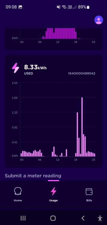

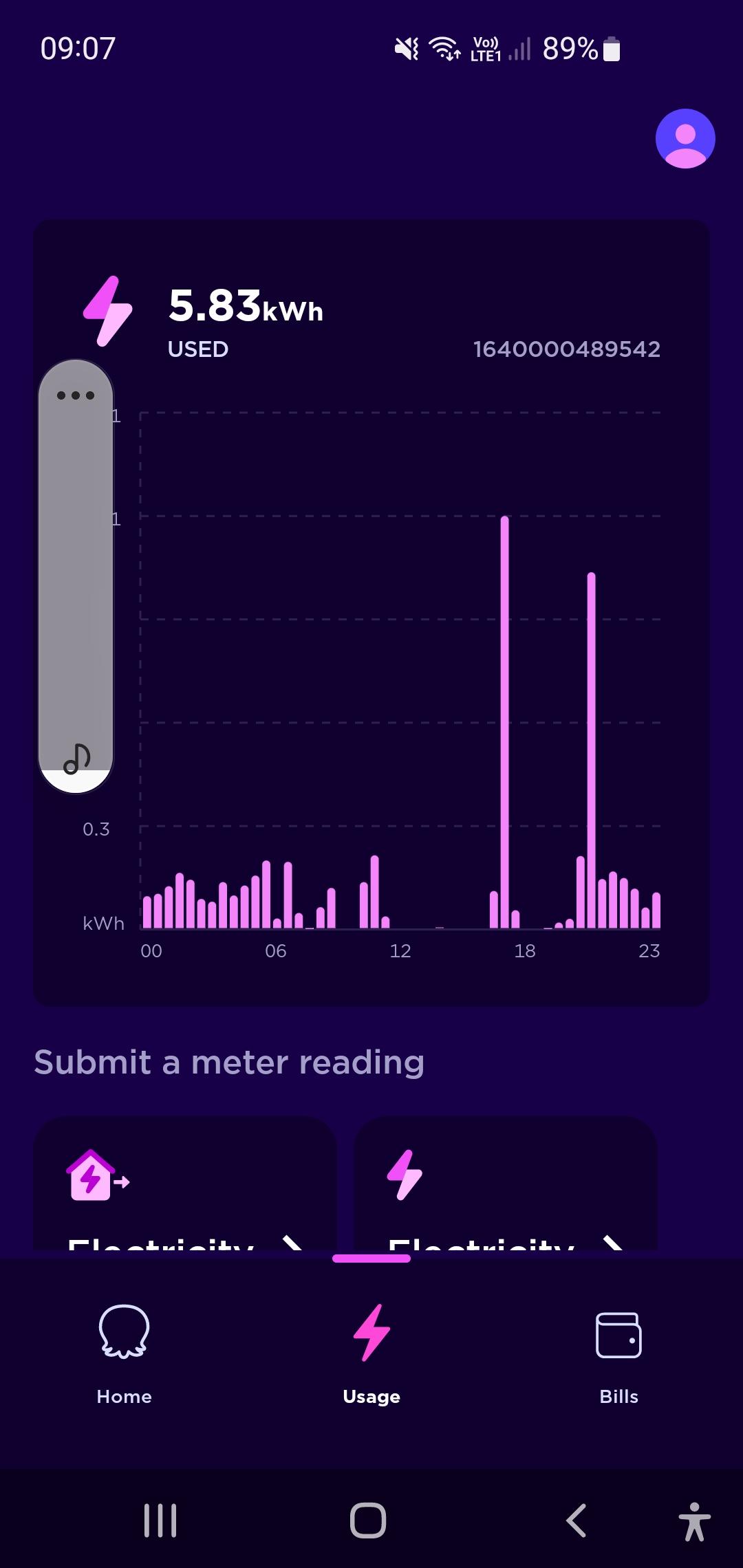

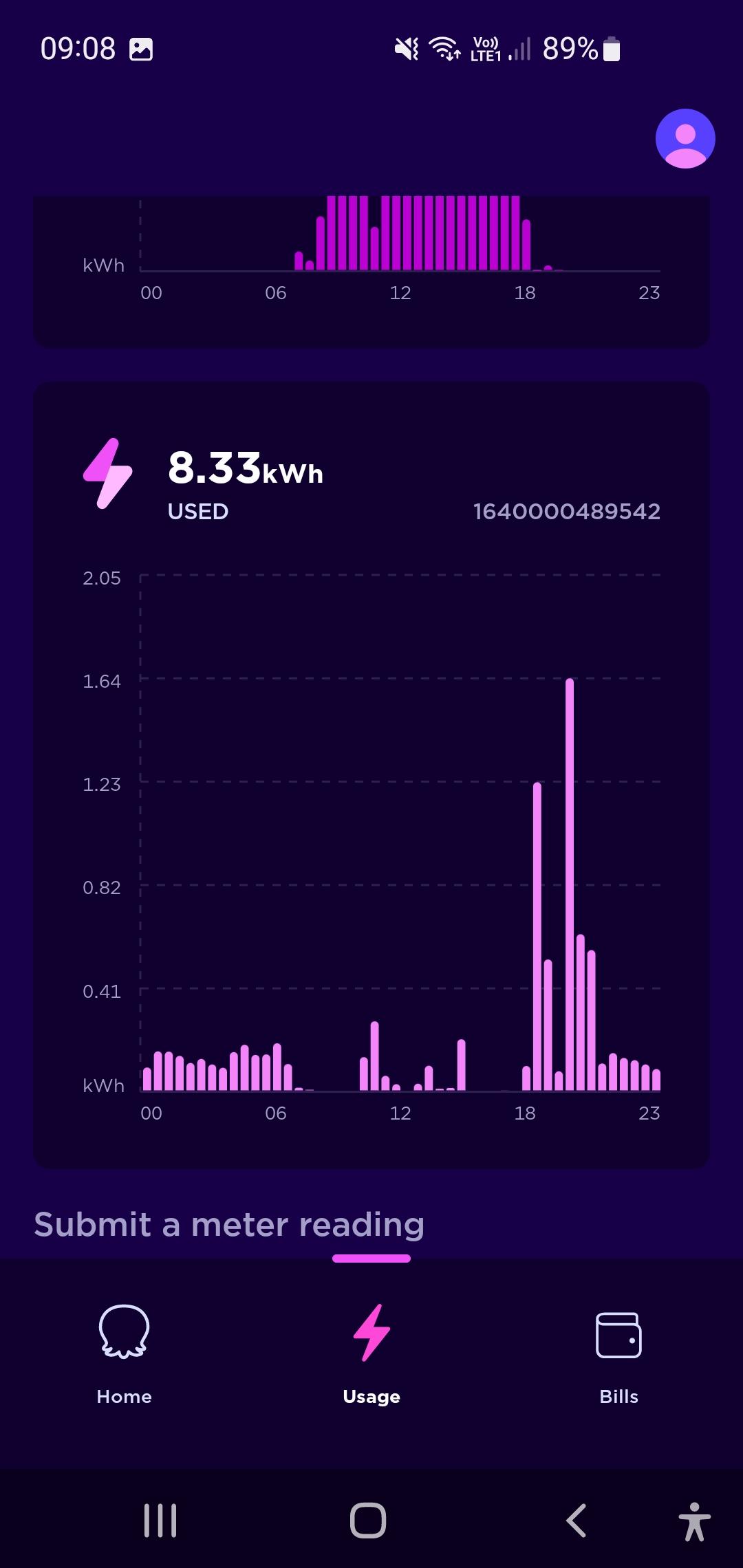

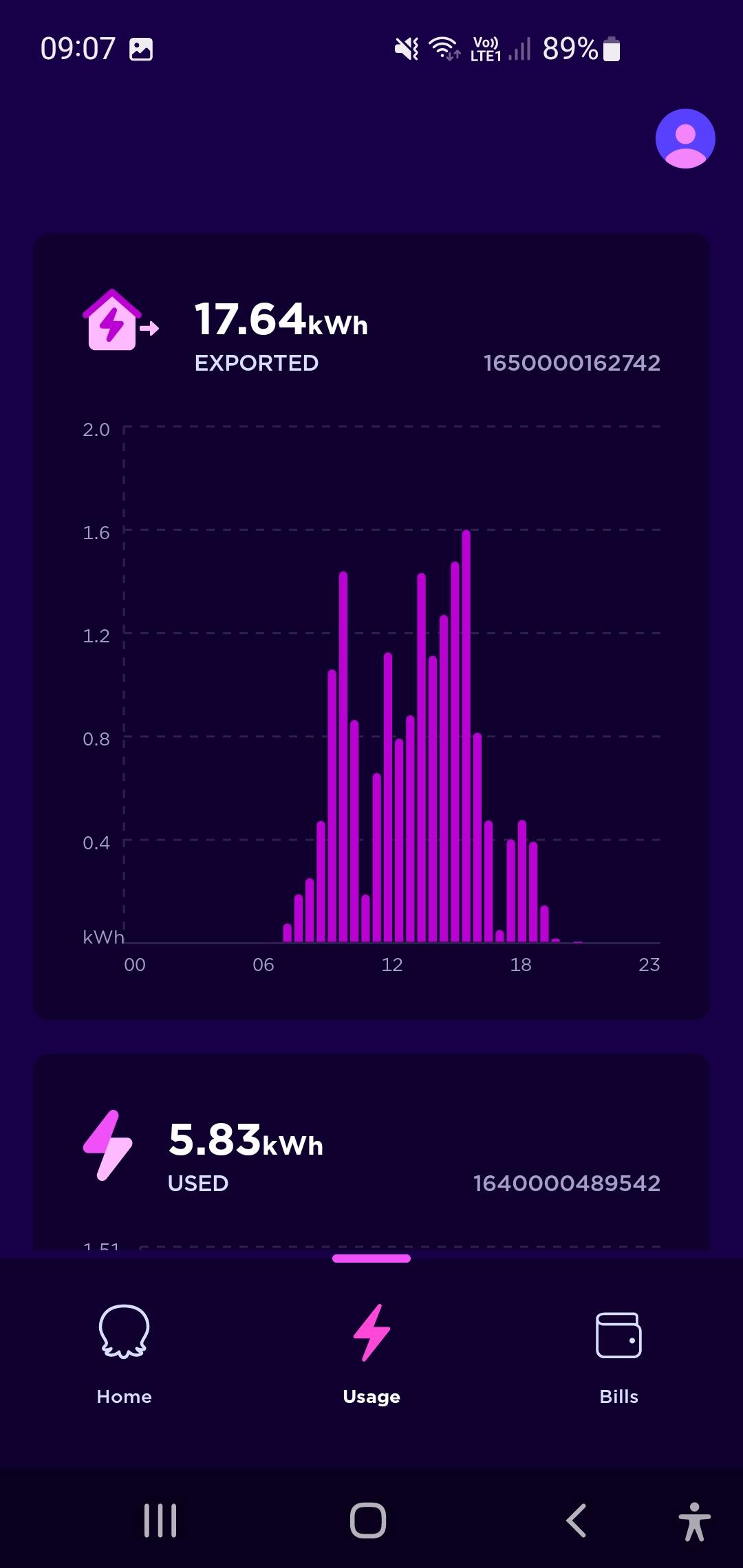

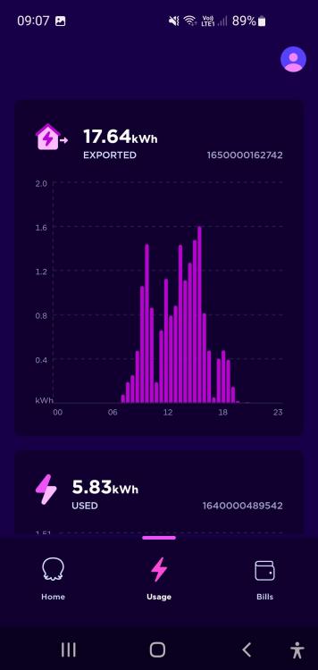

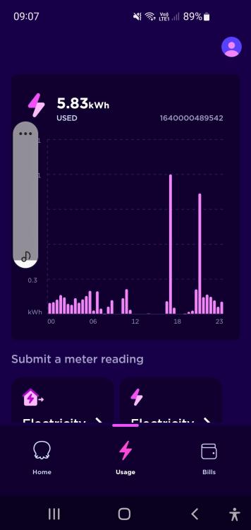

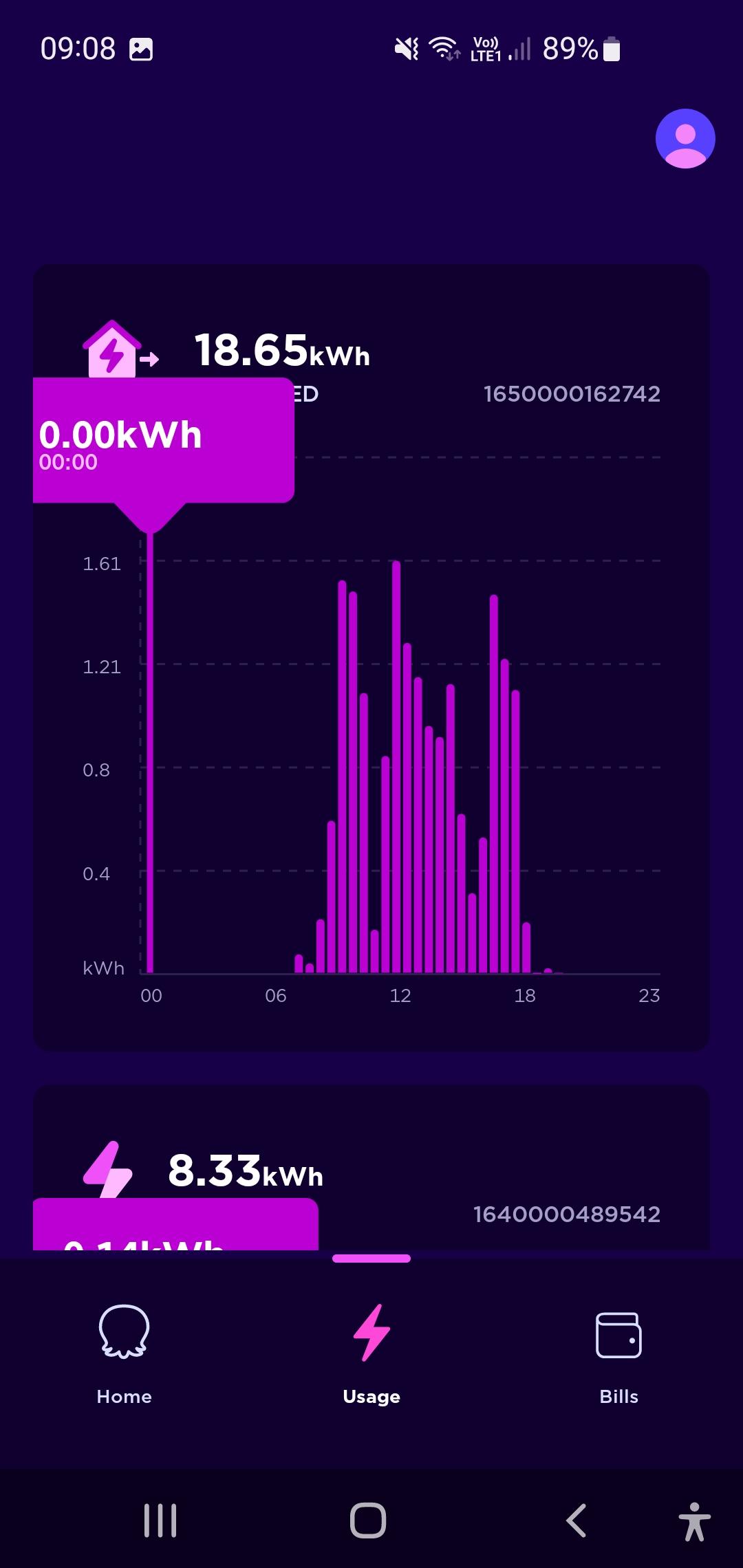

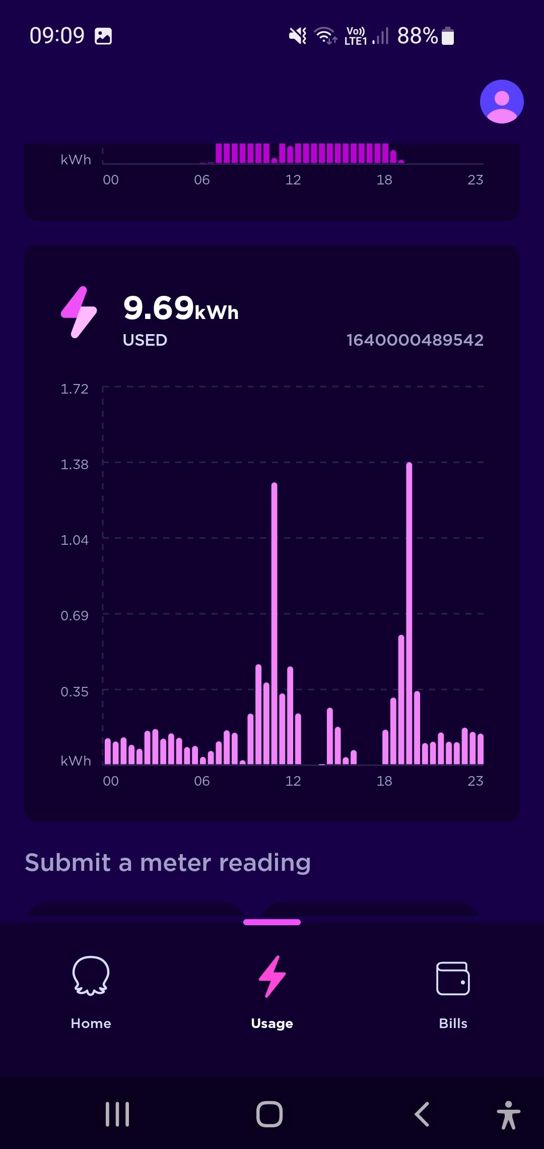

tommy12398 Posted August 8, 2022 Author Share Posted August 8, 2022 Just a few app meter reading Link to comment Share on other sites More sharing options...
tommy12398 Posted August 8, 2022 Author Share Posted August 8, 2022 Sorry let me do that again!! Link to comment Share on other sites More sharing options...
SteamyTea Posted August 8, 2022 Share Posted August 8, 2022 Are the days that show over 10 kWh, baking days? You have a consistant spikes at 11:30 and 20:30, is that the ASHP coming on to heat water. Link to comment Share on other sites More sharing options...
AliG Posted August 8, 2022 Share Posted August 8, 2022 Thanks, this helps. It seems that you are often using large amounts of electricity in the middle of the day when your PV should be generating. It may be that it was a cloudy day of course. It could be that the ovens are on or that the the heat pump is heating your water. The other useful thing to know, but you would have to gather this on a go forward basis, would be how much you generate on a given day versus how much you export. Then you can tell if you are always using a lot of electricity but it is covered by PV, or if your PV is covering a small amount of your electricity. If it is the former then you would expect your electricity usage to go up considerably in the winter. I suspect that is what is happening. It takes a lot of fiddling around to maximise the use of PV and heat pumps. This doesn't work for everyone, my wife doesn't like being told to use the washing machine at night when we have cheap electricity for example. If you are running UFH flow and hot water at 45C then you should have a decent COP and decent performance from the system. In fact I would expect a COP of 3.5-4 at this time of year. To maximise your use of PV you should try to not use the ovens and PV at the same time. The ovens use 1-1.5kWh per hour, but the elements come off and on, so at any one time they could be using 3kW each. Your heat pump has an input of around 3.5kW. Thus if they all fired up together you would be using around 10kW in the house and start to use a large amount of imported electricity. If there is a time during the day when your wife tends to cook, say 12-2. Then I would set the hot water heating on your heat pump to be 9-12 and 2-5. Thus it is much more likely that your PV covers your ovens and hot water use. If you cannot stick to a specific time for cooking then there is nothing you can do about this except buy an expensive battery. During the summer there is an argument that you should in fact heat the hot water to 50 or 55C during the day when you have PV and turn it off during the evening and night. Again ideally, everyone has showers in the morning and then the PV reheats the water during the day. A lot depends on the size of your hot water tank and the amount of hot water you sue though. During the winter though I would use 45C for the better COP and lack of PV. Ultimately there are many trade offs between cost and convenience. Looking at your usage charts you have quite spiky energy usage. You can try to smooth this out to use more PV which will help in the summer, hence my comment you could maybe save around 1000kWh but that won't help in winter. In winter the only thing that can help is reduced energy use through insulation, draught proofing etc. 1 Link to comment Share on other sites More sharing options...

SteamyTea Posted August 8, 2022 Share Posted August 8, 2022 (edited) You also have a baseload of between 100W and 200W. Do you have lots of entertainment stuff i.e. TV, Sky box, games consoles permanently on, or on standby? Edited August 8, 2022 by SteamyTea Link to comment Share on other sites More sharing options...
