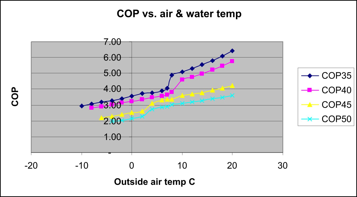

Does anyone have a rough idea what the ashp will use in winter just for the hot water.  I'm think of having central heating off or very low. And install multi fuel stove. Will the ashp use alot less just heating water tank upto say 45°c. I know we really need proper figures, but anyone a rough idea?

It uses roughly 5kWh of energy to heat 100 litres of water up from 3C to 45C
With a COP of 3, that is going to be 1.7kWh to your heat pump.
You are probably going to use roughly 1.7kWh per person per day, depending on how many baths, showers etc people have.
The COP will drop to around 2.5 if the temperature falls below 5C, so it also depends on the outside temperature.
This chart gives you an idea of COPs for different outside temperatures and water temperatures, it is not your specific ASHP, but they are normal quite similar.
The big improvement in COP is between 45 and 40, this is why running your UFH flow at a lower temperature helps. Realistically 40C would be too cold for your hot water.

For heating your COP should stay above 3 most of the time for heating as long as your flow temperature is below 40C. That is why people have been asking about the flow temperature. This is also why less well insulated houses become a problem as the heat loss is too high to be offset by a low flow temp and the COP starts to drop off as the flow temp increases.
For hot water at say 50C, then the COP will be above 3 for most of the year, unlike heating you need hot water at all outside temperatures, but fall into the low 2s when it is coldest in winter. For that small part of your demand, a gas boiler would probably be cheaper, but this is why they quote a seasonal COP that tries to average this out over the year.
