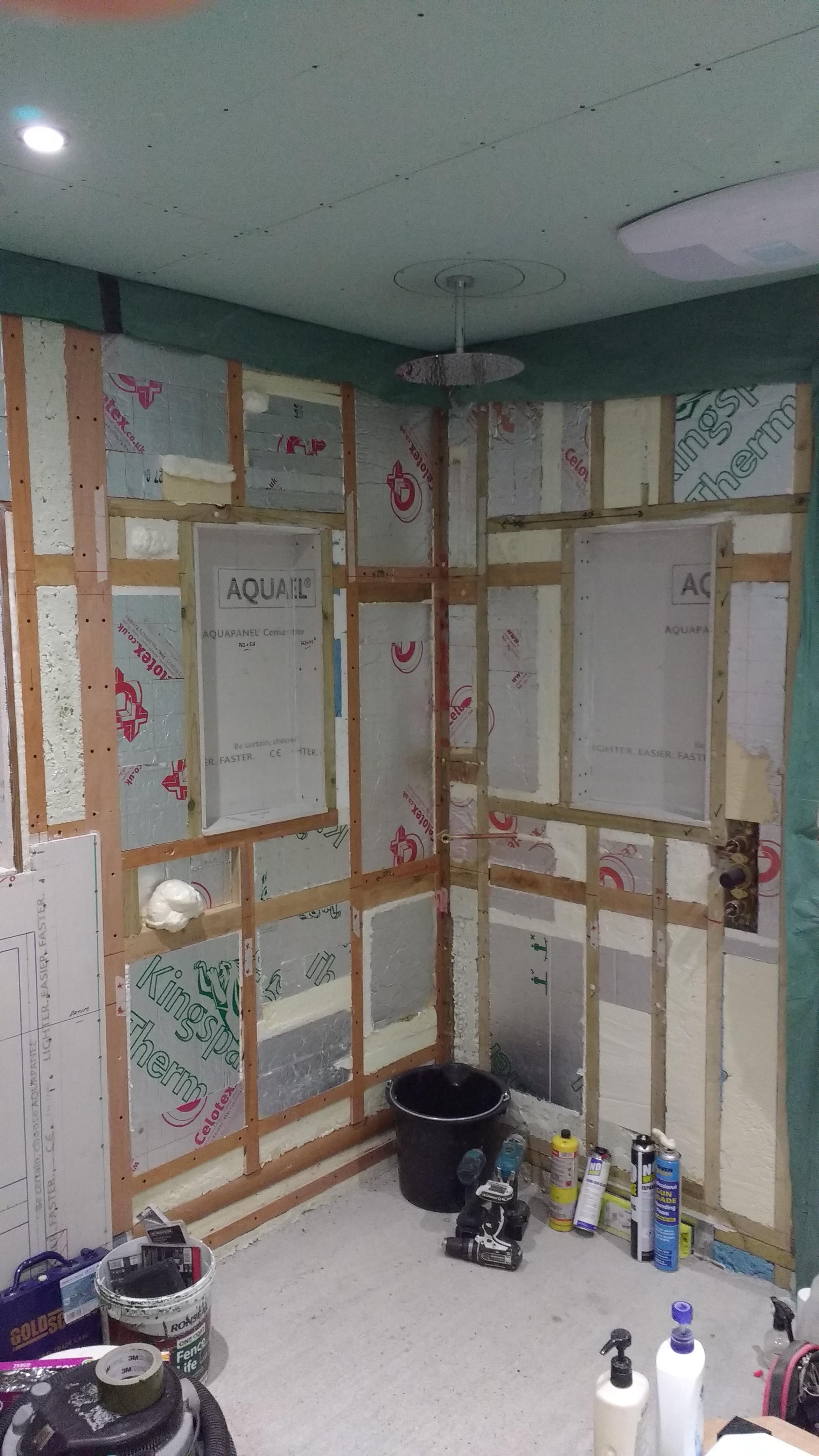

Figured the rainfall head arm needed a bit more than half inch of pb to attach to so I folded up a bit of st/st kick plate:
20180528_182511
20180528_190253
I just want to get water running through and the valves proved. The rainfall arm and head will need to come off again for plastering the ceiling anyway.
For now I'll connect in copper but I've a 500mm braided flexi with an elbow coming to allow for the rise and fall thing later.
2018-05-28_07-12-26
That's enough for tonight. Something like this. The far lhs one is all soldered in. The lot to the right and to the rainfall head are "loose":
2018-05-28_09-24-26
The pass over tbh is half an inch off though it clears the cold feed fine. Should have come towards the rainfall head (by half inch):
2018-05-28_09-25-04

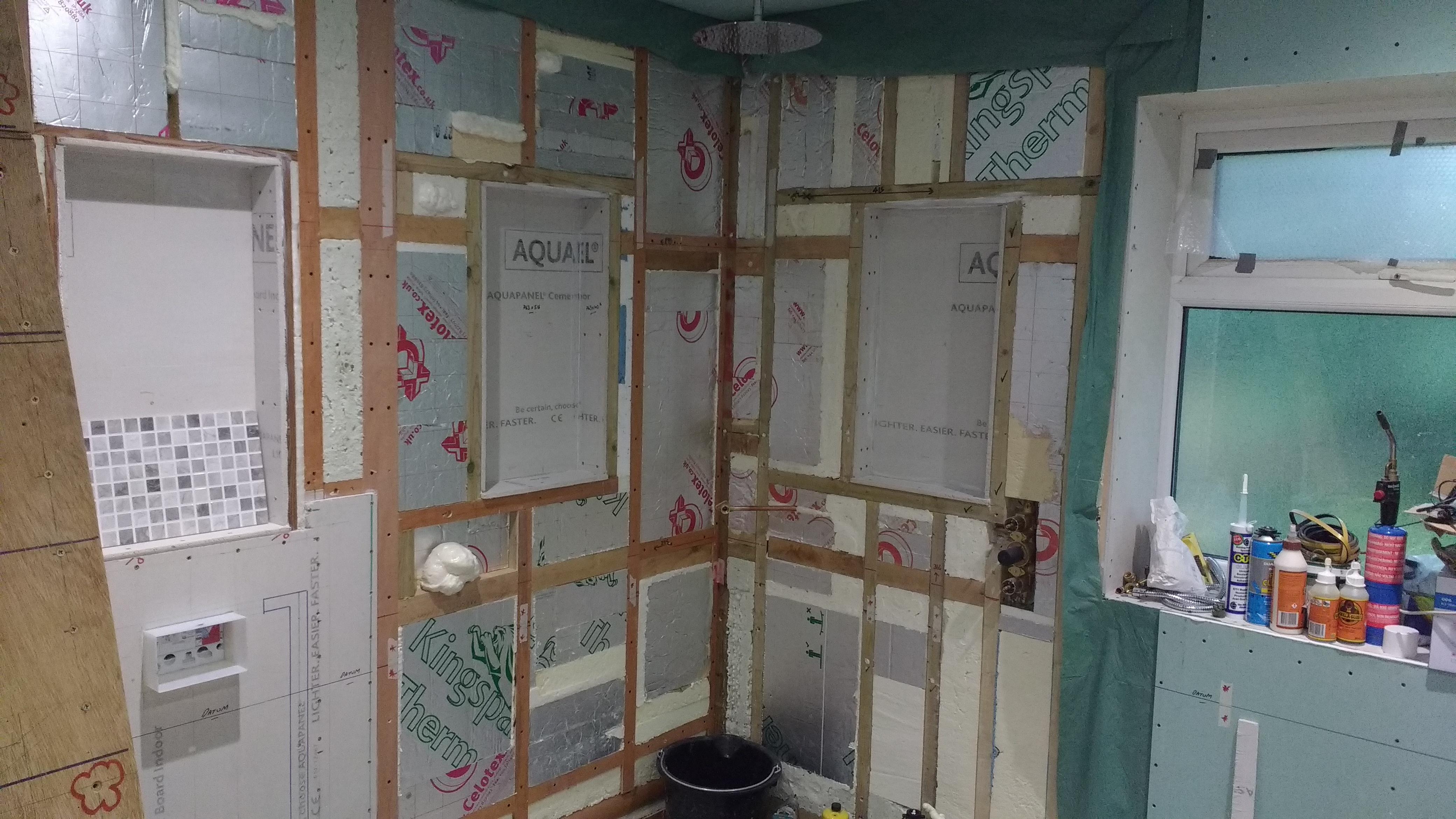

One little bit to infill when the foam "wasp's nest" goes off (long story). Then foil (baking) over the plain foam bits, vcl, Aqua Panel...I guess.
Edited by Onoff
Nope not required...
one less job to do ...
Why not?
Because it adds no value.
Its not a VCL as you’re adding a second one anyway.
Its benefit for being a reflective insulation (ie IR reflector) for heat is virtually zero as there is no air gap to the emitter so no reflection.
So it’s not adding anything ..... just time and expense .!
