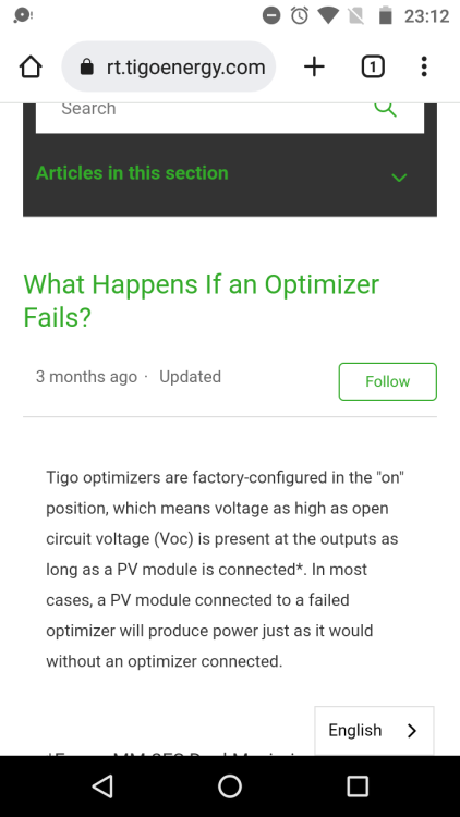

Radian Posted July 19, 2022 Share Posted July 19, 2022 3 hours ago, Onoff said: Why? Optimisers typically have a built-in safety function that reduces the output to 1 Volt DC when unloaded. So if disconnected or isolated or even if the AC is removed from the string inverter, the big scary DC voltage (should) drop to a few 10's of volts - depending on how many optimisers are in the string. 1 Link to comment Share on other sites More sharing options...
Dillsue Posted July 19, 2022 Share Posted July 19, 2022 3 hours ago, Radian said: Optimisers typically have a built-in safety function that reduces the output to 1 Volt DC when unloaded. Solaredge do as standard but I dont think Tigo do. The Solaredge safe 1 volt output can be overriden with a Solaredge tool and then give full output in the same way Tigo units do. Best to check with a meter if you dont know the spec of the optimised system youre working on. Link to comment Share on other sites More sharing options...
