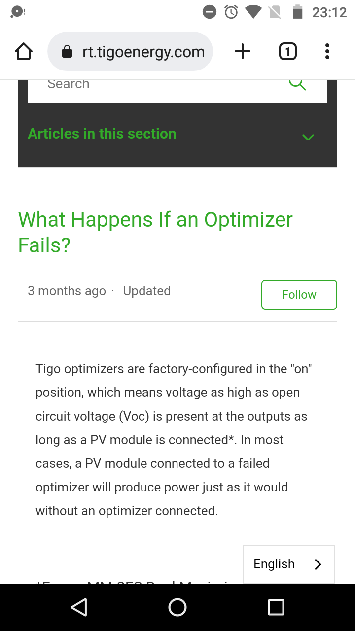

Nickfromwales Posted July 12, 2022 Share Posted July 12, 2022 Anybody know if the Tigo optimisers drop the open-circuit voltage to <1v ( like the Solaredge ones do? ). Apologies for the hijack, blame the beer. I am COMPLETELY innocent. Disclaimer: Innocent when sober = questionable at best. Link to comment Share on other sites More sharing options...
