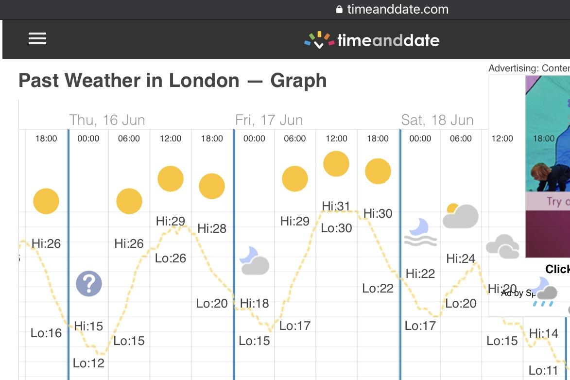

SteamyTea Posted June 19, 2022 Share Posted June 19, 2022 Just now, Adsibob said: Have a look at the graphs I just posted, tell me if that is the picture of success? Am I expecting too much? Well it is cooler than the outside air. Was your MVHR on summer bypass? Link to comment Share on other sites More sharing options...
Adsibob Posted June 19, 2022 Author Share Posted June 19, 2022 (edited) 12 minutes ago, SteamyTea said: Well it is cooler than the outside air. I don’t have an external thermometer to log that data, but I recall that on Friday the bbc was reporting that it was 31C in London, which is about the same as the max temp that was reached in my study. Looking at this in more detail, it seems I’m achieving a decrement delay of about 6hr, whereas I had designed for 10hr (more not being possible), but it’s not clear. I probably need to get an external thermometer and track my local weather the way Tado is tracking my internal “weather”. 12 minutes ago, SteamyTea said: Was your MVHR on summer bypass? I activated it on Tuesday. Maybe I should fiddle with the settings, but I didn’t think it could do much more than lower internal temp by a degree or so? Edited June 19, 2022 by Adsibob Link to comment Share on other sites More sharing options...
SteamyTea Posted June 19, 2022 Share Posted June 19, 2022 37 minutes ago, Adsibob said: Have a look at the graphs I just posted, tell me if that is the picture of success? Am I expecting too much? Got the laptop out so I can see the charts better. I am not sure which part of London you are in, though I don't think it will make much difference to OAT, so shall just pick a random station towards the centre, see what they were recording. Link to comment Share on other sites More sharing options...

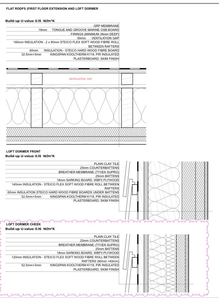

ProDave Posted June 19, 2022 Share Posted June 19, 2022 26 minutes ago, Adsibob said: Looking at this in more detail, it seems I’m achieving a decrement delay of about 6hr, whereas I had designed for 10hr (more not being possible), but it’s not clear What exactly is your wall make up? Our calculated decrement delay time was 13 hours and it certainly seems to be close to that, our house maintains a pretty constant temperature only warming up or cooling down slowly. You need to eliminate solar gain as the culprit so even if you can make temporary exterior blinds to prove a point e.g even something as simple (on a dry day) as cut a large piece of cardboard and tape that to the outside of the velux windows for a day to block the sun out completely. 1 Link to comment Share on other sites More sharing options...
SteamyTea Posted June 19, 2022 Share Posted June 19, 2022 Right, had a look at this WU station: https://www.wunderground.com/dashboard/pws/ILONDO480/table/2022-06-17/2022-06-17/daily Seems temperatures peaked at 33.7°C and had an average of 25.7°C, minimum was 16.7°C. You also had an hour, 12:09 to 13:04, when the solar radiation was over 900 W/m2. That is really quite impressive. So I think most houses would struggle with that. 1 Link to comment Share on other sites More sharing options...

ProDave Posted June 19, 2022 Share Posted June 19, 2022 30 minutes ago, Adsibob said: Here is the build up of the loft, although I don’t think the “dormer cheek” build up is relevant, because it is the other room in the loft which is bounded by the cheek. So peripherally relevant (as that room is also too warm), but not directly. Similar to us except we have 100mm wood fibre board on the outside of the rafters, making it a warm roof and no need for the ventilation , and 200mm between rafters. But no PIR layer. Link to comment Share on other sites More sharing options...
Radian Posted June 19, 2022 Share Posted June 19, 2022 On 18/06/2022 at 11:35, Adsibob said: SN70/30 glass From the spec "Ultraviolet Transmittance of UV 11 %" Peak Solar irradiance is around 1kW/m2 You say your roof windows are 134cm X 98cm (1.3m2) and 134cm x 160cm (2.1m2) or around 3.4m2 in total. At 11% transmission this would equate to a heat source of no more than 380 Watts. Of course it will depend on the area facing the Sun at any given time. It doesn't sound like much but I have roughly half that area in my worst hot spot and it does push the temperature up by a few degrees. This is when all your insulation starts working against you! 1 Link to comment Share on other sites More sharing options...

joth Posted June 20, 2022 Share Posted June 20, 2022 13 hours ago, Adsibob said: 14 hours ago, SteamyTea said: Was your MVHR on summer bypass? I activated it on Tuesday. Maybe I should fiddle with the settings, but I didn’t think it could do much more than lower internal temp by a degree or so? I forget what Tuesday was like, but if it's hotter outside than inside you want to turn OFF the summer bypass. This way the heat exchanger is activated "in reverse" to cool down incoming air by "recovering" coolness from the outgoing air. Summer bypass should only be active when the indoor temperature is above target AND the outdoor temperature is lower than indoors. Happily for me my MVHR handles all that automatically. Otherwise I'd have used Loxone to automate it (basically same algorithm as I already made for skylight automatic stack venting control) Link to comment Share on other sites More sharing options...

Adsibob Posted June 20, 2022 Author Share Posted June 20, 2022 5 hours ago, joth said: I forget what Tuesday was like, but if it's hotter outside than inside you want to turn OFF the summer bypass. This way the heat exchanger is activated "in reverse" to cool down incoming air by "recovering" coolness from the outgoing air. Summer bypass should only be active when the indoor temperature is above target AND the outdoor temperature is lower than indoors. Happily for me my MVHR handles all that automatically. Otherwise I'd have used Loxone to automate it (basically same algorithm as I already made for skylight automatic stack venting control) My summer bypass is also set to automatic. I had a quick look at the status and it says: Bypass State: OPEN Inlet temperature: 19.7C Outlet temperature: 22C Does the fact that the bypass is "open" mean it is bypassing the heat exchanger and working as expected? Link to comment Share on other sites More sharing options...
