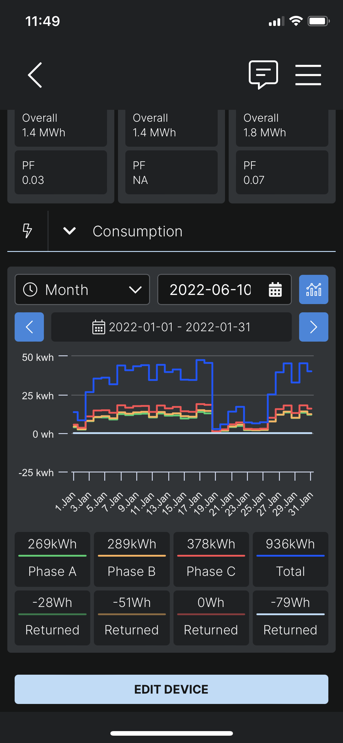

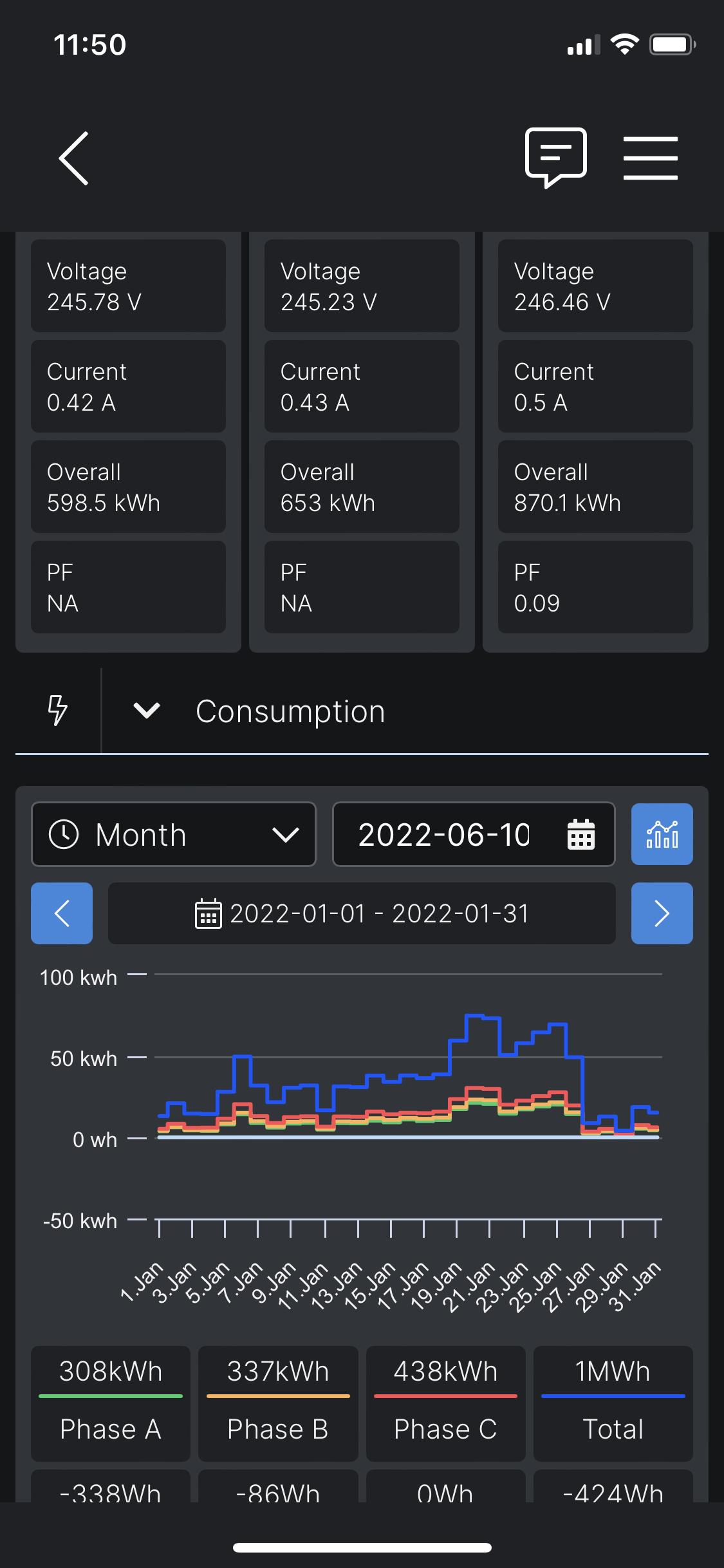

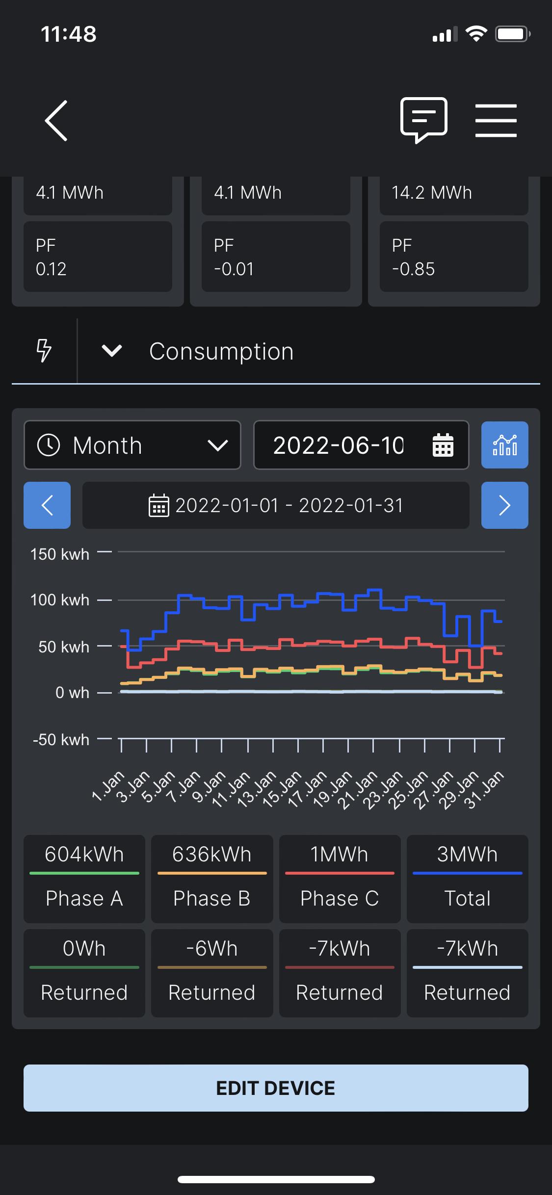

Wil Posted June 10, 2022 Share Posted June 10, 2022 (edited) Yup my heat pumps (mostly): 3MWh overall, 2MWh roughly on heating, 0.25MWh on car charging and .75MWh on the rest of life… Total above, HPs IVT18 Left IVT26 right. You can see where I experimented in late Jan with running the 26 as primary… Edited June 10, 2022 by Wil 1 Link to comment Share on other sites More sharing options...

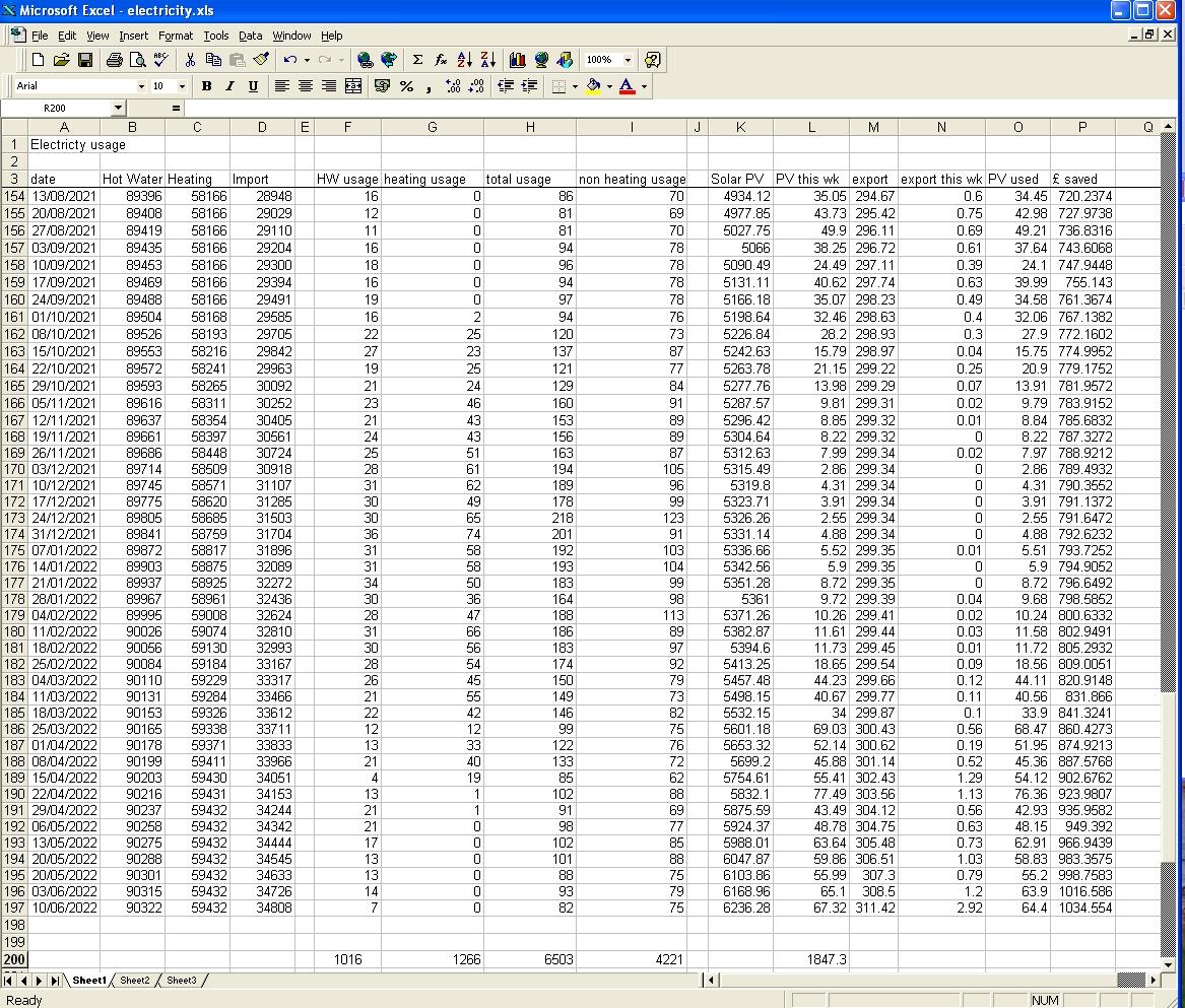

ProDave Posted June 10, 2022 Share Posted June 10, 2022 For those suffering insomnia and need something to send you to sleep, some of my figures: The readings I take each week go in columns B, C, D, K and M. The rest are calculated from those figures. The odd figures at the bottom in row 200 are the total of each of those columns for the last 12 months. It's that pesky stubborn 75kWh non heating use each week I need to work on, which goes up in winter probably because there's less PV to offset it. 1 Link to comment Share on other sites More sharing options...
SteamyTea Posted June 10, 2022 Share Posted June 10, 2022 5 hours ago, ProDave said: It's that pesky stubborn 75kWh non heating use each week I need to work on That does seem quite high. Do you use an electric oven a lot? Link to comment Share on other sites More sharing options...
Radian Posted June 10, 2022 Share Posted June 10, 2022 4 minutes ago, SteamyTea said: That does seem quite high. Do you use an electric oven a lot? My tall fridge + two vertically stacked under-counter sized freezers consume around 32kWh per week. Add in 3kWh per day for the oven and that's already 53kWh. Easy to push that to 70kWh with, say 100W 24/7 vampire load from WiFi, TV, Sat etc. Not much scope for reduction if you've got to cook for and feed a family. Link to comment Share on other sites More sharing options...
ProDave Posted June 10, 2022 Share Posted June 10, 2022 8 minutes ago, Radian said: My tall fridge + two vertically stacked under-counter sized freezers consume around 32kWh per week. Add in 3kWh per day for the oven and that's already 53kWh. Easy to push that to 70kWh with, say 100W 24/7 vampire load from WiFi, TV, Sat etc. Not much scope for reduction if you've got to cook for and feed a family. I suspect the FF might be a big part of that. About 2kWh per day for treatment plant and MVHR it soon adds up. I am guilty of leaving stuff on standby, e.g. televisions. The satellite box is on a timer so is off over night and part of the day. Yes electric oven used most days. Washing machine and tumble dryer used most days and dishwasher every other day, they are used in the daytime so solar PV should power some of that load depending on the weather. That is likely a major part of why the non heating use goes up in winter. Link to comment Share on other sites More sharing options...
