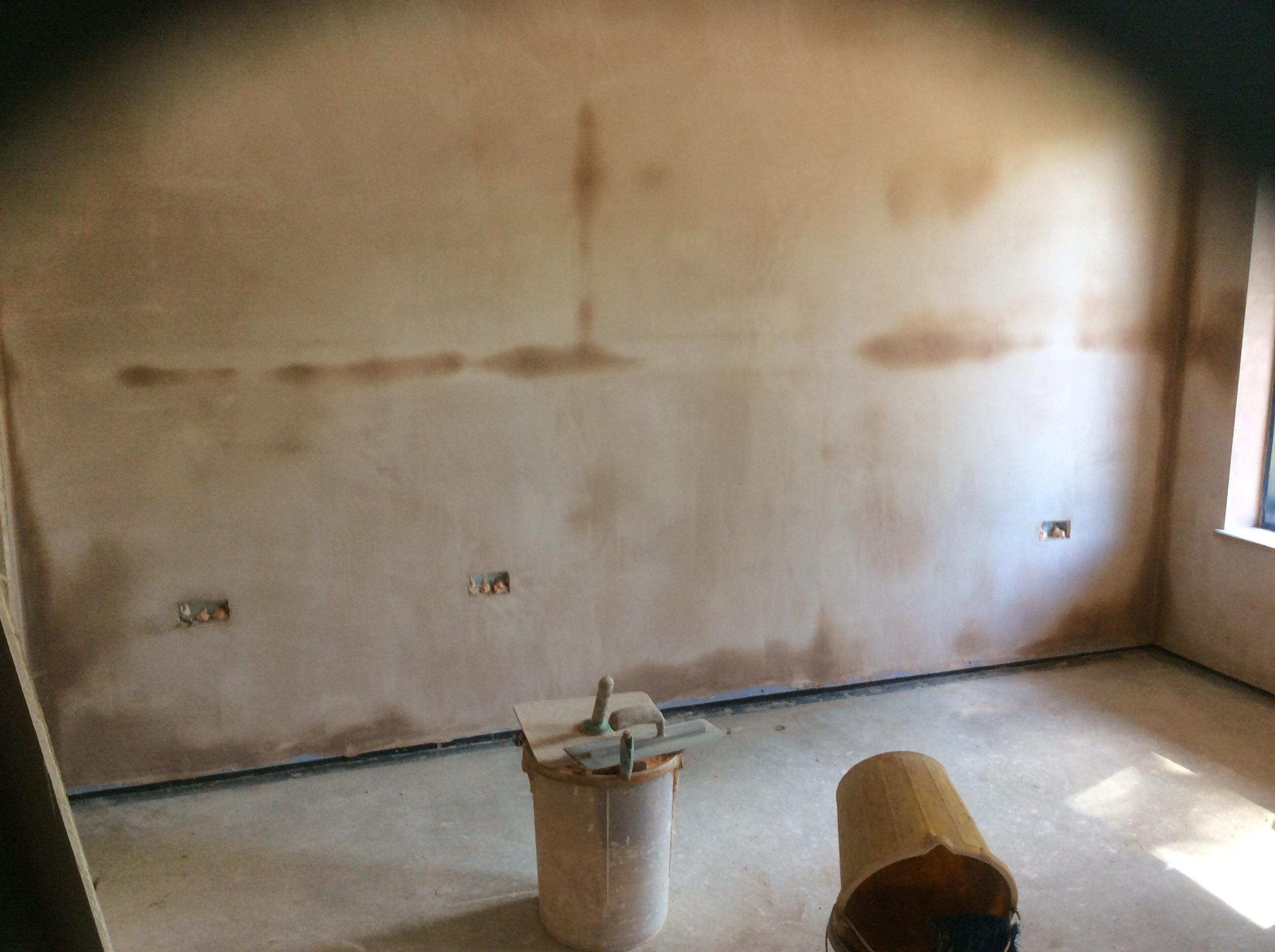

jfb Posted June 8, 2022 Share Posted June 8, 2022 I need to plan the position of sockets in the main bedroom. Not a huge room but there is an obvious place where a double bed goes and it would be useful to have sockets somewhere either side. A problem I have run into the last place I did was that if I put sockets say 500mm off floor and near the bed that side tables/cupboards can easily make it awkward to use these sockets. Any suggestions? Go above table top height? Go wider so avoiding any potential bedside furniture? Link to comment Share on other sites More sharing options...
Conor Posted June 8, 2022 Share Posted June 8, 2022 Put sockets and light /lamp switches about 200mm higher than the typical bed site unit height at either side of the beds. 1 Link to comment Share on other sites More sharing options...
jack Posted June 8, 2022 Share Posted June 8, 2022 28 minutes ago, jfb said: Any suggestions? Go above table top height? Go wider so avoiding any potential bedside furniture? We estimated what size of bed would be going in the space, then put double sockets just outside where the bed would finish. Even where the plug for, eg, an alarm clock or charger sticks out, it's hidden in the space between the bed and the bedside tables. The plugs are nearly invisible, but still quite accessible. Works well for us. Link to comment Share on other sites More sharing options...

Iceverge Posted June 9, 2022 Share Posted June 9, 2022 We put all the top of the sockets 750mm above the floor , no regrets apart from the bedside table which is 600mm so my phone charger with bottom exit leads snag . In fact I would probably put sockets higher. Completely by accident we positioned other sockets beside windows and the socket gets completely hidden by the curtains. Link to comment Share on other sites More sharing options...
Carrerahill Posted June 9, 2022 Share Posted June 9, 2022 (edited) On 08/06/2022 at 14:42, jfb said: I need to plan the position of sockets in the main bedroom. Not a huge room but there is an obvious place where a double bed goes and it would be useful to have sockets somewhere either side. A problem I have run into the last place I did was that if I put sockets say 500mm off floor and near the bed that side tables/cupboards can easily make it awkward to use these sockets. Any suggestions? Go above table top height? Go wider so avoiding any potential bedside furniture? I always show socket positions either side of the bed and at about 800mm AFFL - in the notes I sometimes put, "Bedside sockets to suit bedside furniture height, min 150mm above table/cabinet top" - but that is generally in hotels or care homes where the spec of the bedside table will be known. In residential jobs I usually just say 800mm unless the bed position is not absolute or there is some other reason. I placed bedside sockets in my own house and stupidly put them at at circa 300mm, so now the bedside cabinets need to sit much further forward than I'd usually like to be able to get in a use them. We don't have table lamps, we have wall lamps with dedicated switches in the spares and in the master we have bedside pendants, so the sockets are only for plugging things like chargers, laptop power supplies etc. Edited June 9, 2022 by Carrerahill Link to comment Share on other sites More sharing options...
