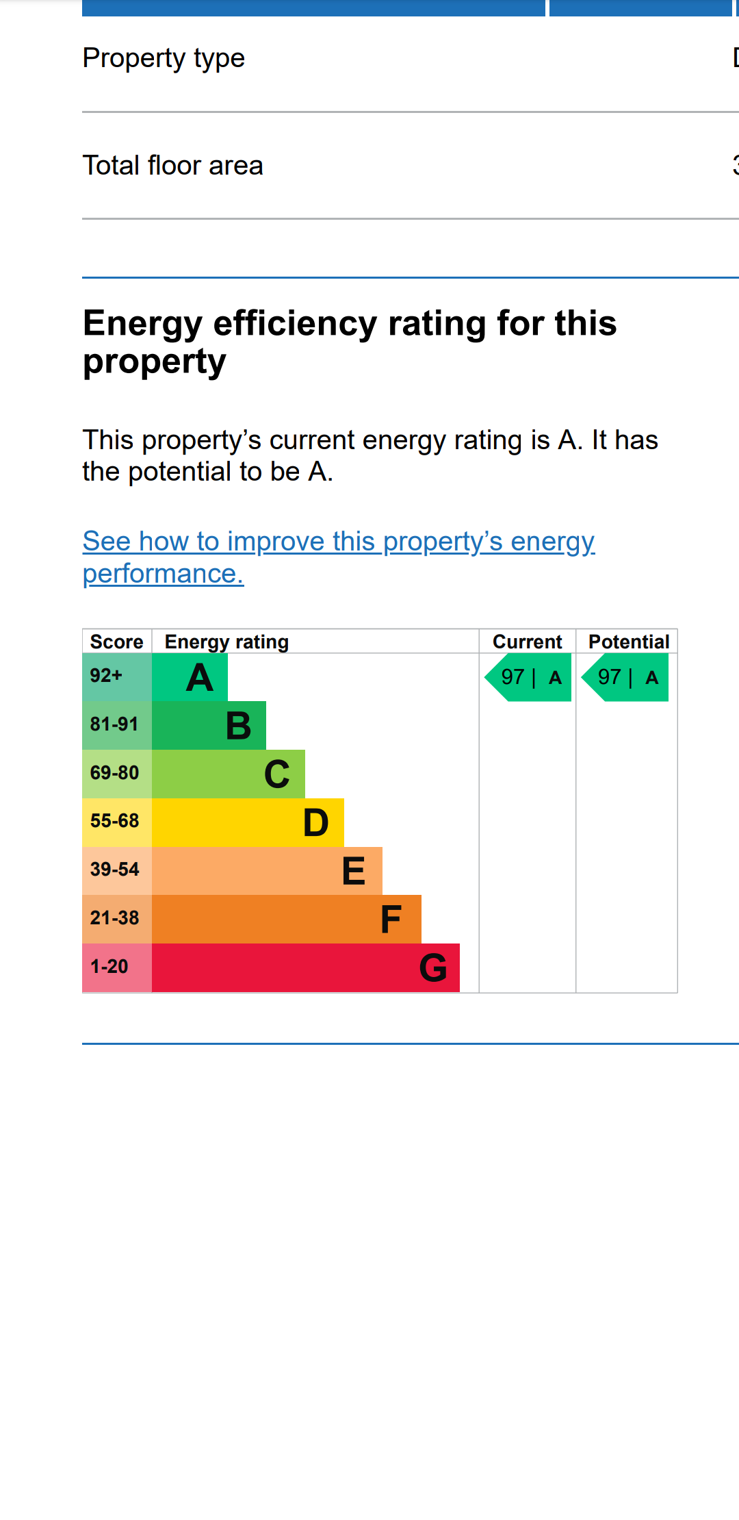

Conor Posted June 7, 2022 Share Posted June 7, 2022 Even though I'm disappointed in the airtest result of 1.8 (the thermohouse roof panel system is NOT airtight, despite what they say!), I'm happy enough. First time seeing an EPC with no potential improvements! We hit the passive House heat requirement target but not the airtightness so certification not an option. 8 Link to comment Share on other sites More sharing options...
Thorfun Posted June 7, 2022 Share Posted June 7, 2022 well done. shame about the airtightness though as you say. did you tape the **** out of it? 😉 Link to comment Share on other sites More sharing options...
Bitpipe Posted June 7, 2022 Share Posted June 7, 2022 Congrats, I briefly contemplated getting my SAP A EPC printed out mega big and stuck to the side of the house like a new fridge. 6 Link to comment Share on other sites More sharing options...
ProDave Posted June 7, 2022 Share Posted June 7, 2022 Well done. Much the same for us, our air tightness was 1.4 though we could find no particular leak. I was disappointed but the tester was nearly wetting himself with excitement at how good it was. We achieved an A94 so you beat us. But it is a smug feeling having an EPC A and no improvements suggested. In spite of SAP supposed to be accurate, it still managed to estimate out heating load as way more than practice actually says, and in fact in that respect Jeremy's simple heat loss spreadsheet was more accurate. Our EPC A is printed and on the wall next to the consumer unit. I think our BC inspector at completion remarked it was the first EPC A he had seen. Link to comment Share on other sites More sharing options...
JohnMo Posted June 7, 2022 Share Posted June 7, 2022 We also managed an A, but was suggested I install a wind turbine at an estimate cost of £15 to 25k to give an A104. No! Loads more solar would be better. 2 Link to comment Share on other sites More sharing options...

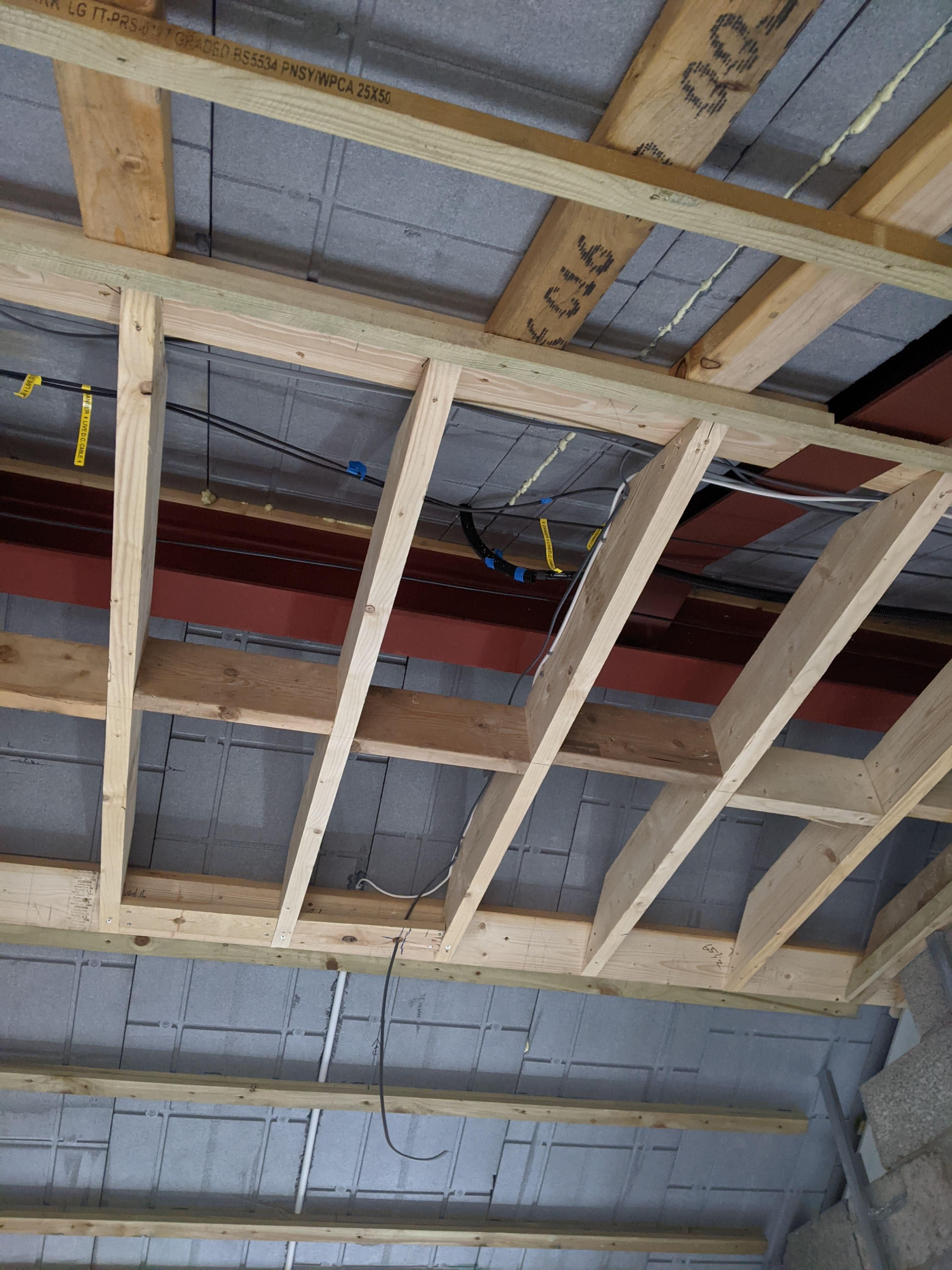

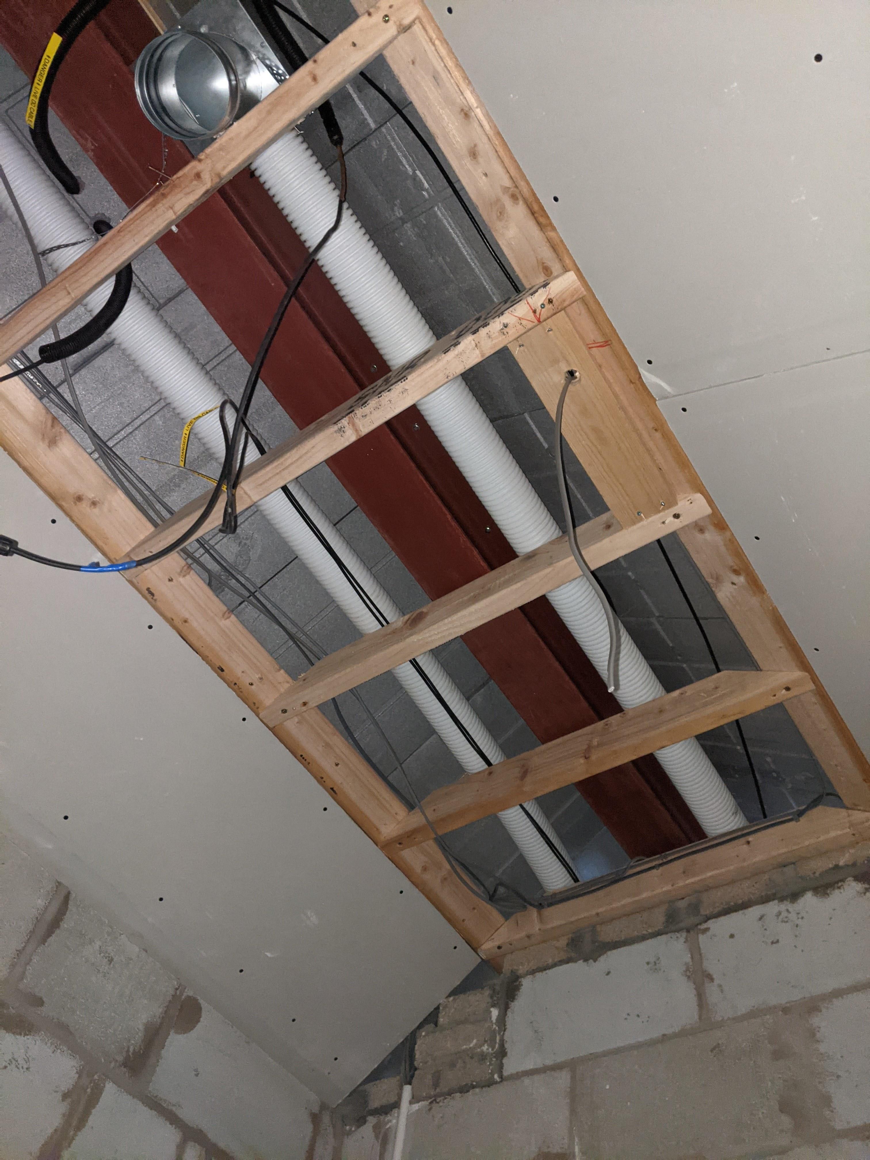

Conor Posted August 21, 2023 Author Share Posted August 21, 2023 Might add, ceilings below are vaulted and we have counterbattened the underside - 25x50mm running across the panels, then 50x50mm running over to give the service void. 5hink this goes someway to dampening sounds as forms partial airgap. You'll need at least one batten if you are boarding to corm a finished ceiling. Also be mindful of max span, something like 3.6m. We were about 4.2m span so had to build in a "collar ladder" for strength. Detailed in the documents. Link to comment Share on other sites More sharing options...
Lee33 Posted August 21, 2023 Share Posted August 21, 2023 (edited) 2 hours ago, Conor said: Might add, ceilings below are vaulted and we have counterbattened the underside - 25x50mm running across the panels, then 50x50mm running over to give the service void. 5hink this goes someway to dampening sounds as forms partial airgap. You'll need at least one batten if you are boarding to corm a finished ceiling. Also be mindful of max span, something like 3.6m. We were about 4.2m span so had to build in a "collar ladder" for strength. Detailed in the documents. Did you create a void at the apex to run the lighting, mvhr (assuming you have it) etc through? So there’s no need for ridge beams etc with this system? (if it falls under certain spans) Edited August 21, 2023 by Lee33 Link to comment Share on other sites More sharing options...
Conor Posted August 21, 2023 Author Share Posted August 21, 2023 48 minutes ago, Lee33 said: Did you create a void at the apex to run the lighting, mvhr (assuming you have it) etc through? So there’s no need for ridge beams etc with this system? (if it falls under certain spans) We had ridge beams. The collar ladder formed our drop ceiling which took all our services. Link to comment Share on other sites More sharing options...

Lee33 Posted August 22, 2023 Share Posted August 22, 2023 On 21/08/2023 at 18:16, Conor said: We had ridge beams. The collar ladder formed our drop ceiling which took all our services. Ahh I see now, looks good, from what I’ve seen I’m impressed with the whole Thermohouse system Link to comment Share on other sites More sharing options...
