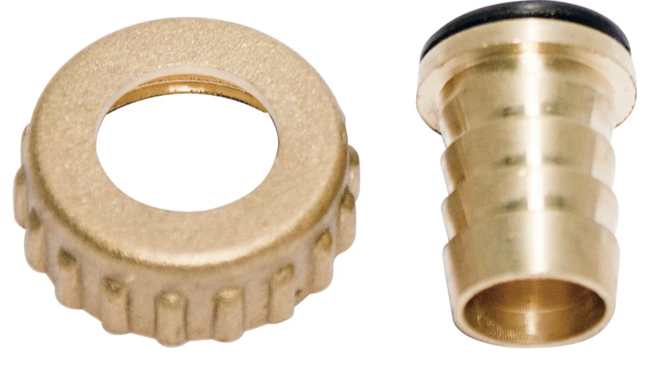

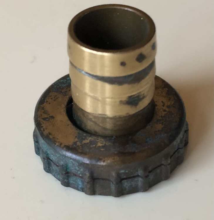

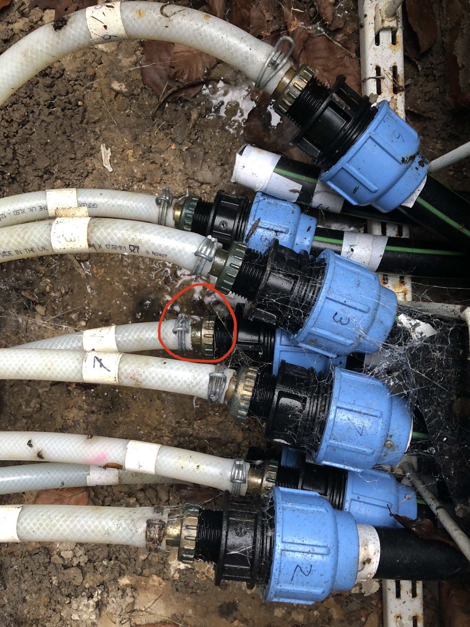

RobLe Posted June 6, 2022 Author Share Posted June 6, 2022 @Marcocosic Some insightful points there, I think you know a lot more about this than I do! There's many things that I did wrong in retrospect, down to basic not knowing how to use a water:water compression joint. Only after making 12 or so of them for the groundloop distribution manifold, did I realise that I needed jointing compound for a leak free fit. And you shouldn't fit the pipe all the way in, or you can't keep tightening the nut later. It's like I'm making it up as I go along...Gah. Anyway - yes, please come and visit, cast an eye over it sometime! address pm-ed. Yes, it was great fun to do! So many new things to learn how to do... it's hard to find technically interesting and useful projects, and this ticked both boxes. Raw water worked a lot better than the glycol, I wish it didn't need the glycol. After you mentioned alcohol, I looked it up - you can buy denatured(undrinkable) alcohol a lot cheaper than the glycol I got. Hmm, maybe I should've done that. If it has a major overhaul one day I will replace the heat exchangers with bigger ones, I think I can scrape back ~4C between them if I increased from the current 24plate to 60 plate. The ones I got allegedly are working pressure 16bar, I've seen some that say 30bar. They're £30-£70 each, for basic ones. I followed that link for the swep throttle connection thank you! - I think the suggestion is that the tiny cap tube to BPHE joint is critical, and the internal shape should be always increasing in volume. Hmm, you may be right, I'd not heard about that, but it makes sense. Doubt mine is perfect there:-(. I don't know how much a better throttle(EEV/PRV) would improve things - I don't think they're common for low power compressors, but maybe it's a future improvement? I did see that mcs doc, it was very helpful. I sized our system from it, so it should be no surprise we need glycol I guess. Somewhere I saw a paper on water v glycol in gshp systems - I think the conclusion was that in countries with higher mean temps than the UK it was worth adding a bit extra groundloop pipe so that water could be used. In colder climates there's hardly any headroom before freezing, so the extra pipe length needed becomes longer and longer and so uneconomic. Our rads are certainly not perfect - I know the system works better if I increase the internal pump speed to full, but I've not characterised "better". Most of the rads are in a 1-pipe arrangement, some in a 2, bit of a hodge podge really. The 1-pipe means that they will never have been usefully flushed since being fitted in 1963 (1 pipe means every rad has a permanent bypass pipe, and the flow is only convection in the rad). I could probably improve them quite a bit by doing that one day - simplest I think would be to add 22mm wide bore valves to every bypass pipe, then I can do a conventional powerflush one rad at a time. We have powerflush fittings already I think - I remember it being done 10+ years ago by a plumber, but I know now it cannot have done much due to the 1-pipe. It all "just works", so not a lot of incentive to rip it out and replace with 2 pipe everywhere, mess and pipes chased all over, no ta. Our heat measurement system uses a flow meter, which I think is accurate, and two temp sensors on the water pipes inside the house. The temp sensors seem significantly better than the spec.... but the spec is +/-2C over their range! I've ordered some significantly better ones, and that should help enormously when they arrive - when being the operative word, as I ordered 4 months back, and they're still waiting - so many IC's are late/unavailable these days. If I can measure the COP accurately, then I can see exactly what improvement changing pump speed has, or insulating the pipes in the HP itself (not yet done all), etc. And what improvement flushing rads has too. It's satisfying to have verifyable improvements. From memory the superheat was always in the 4-10C range, the 4 times I measured it, but I am at the mercy of the accuracy of my gauge set, and how well the temp probe is connected. If I get better COP measurements going, another technique is to slowly increase charge until the COP stops improving at the operating point? Below is a graph (random googled graph) - I've seen this sort of thing before. The graph does seem to imply that as the cold side gets colder, the optimum charge is lower - I should bear that in mind. Would a TXV/EEV avoid this optimal charge varying? Link to comment Share on other sites More sharing options...

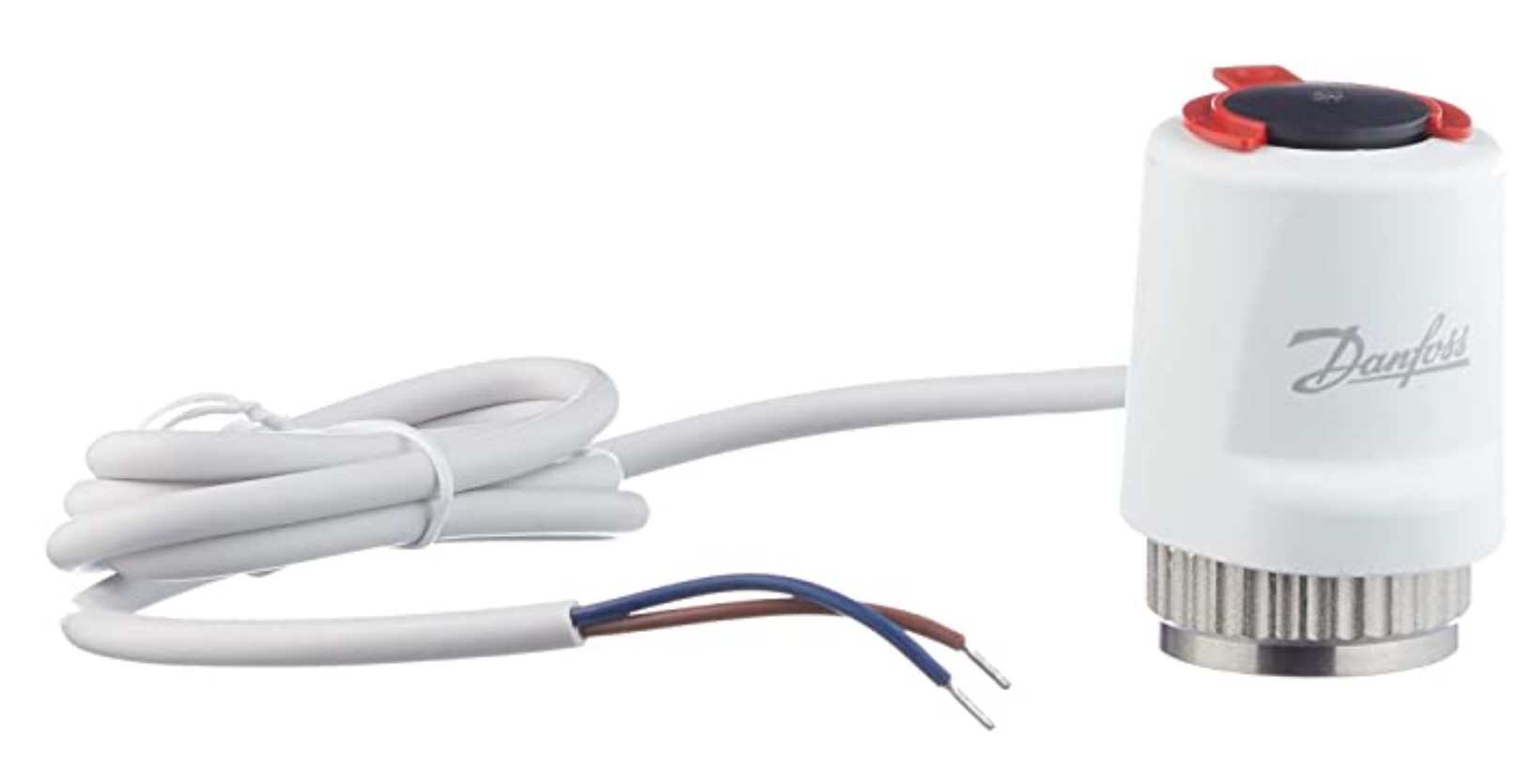

RobLe Posted October 10, 2022 Author Share Posted October 10, 2022 Updates - the heatpumps on again, as it's getting colder! I added a bypass heat exchanger to the heatpump, which could allow some summer cooling - ie. groundloop bypassed via the extra heatexchanger to radiators. TBH it's a bit rubbish, it can pull out 500W average over a 48 hour period when I tried - barely worth the complexity. The issues I had with it are that by the time it's needed the ground has heated up quite a bit as my coils aren't that deep. Also our radiators are 1-pipe so only any good at convecting hot water, not cold, from the supply pipe that runs around beneath them. Not that we are really in need of summer cooling, it just seemed like a freebie. It uses the same thermostat, inverted to NC rather than NO as a control for the system. I guess the "COP" is good, it's 60W of pumps and controls, extracting 500W out, cooling COP of 8. I improved the heatpump startup considerably - originally as a simple on/off unit it used an internal NTC element to give it a soft start, now it has a step-start with a relay instead. I had my 5A heatpump fuse "wear out" after ~2000 startups previously, and I hope that dropping the startup current will prevent this occurring again. The I2T drops from 60A^2s down to 20A^2s with this change, it makes a huge difference. Both the NTC and step-start are options for the compressor - I'm not inventing stuff, just reading the datasheet! Increased the maximum run temperature, needed for DHW. It was 50C, now it's 55C, and slowly gets the top of our tank to 46C. The 200litre tank isn't "heatpump ready", and only has a 0.42m^2 coil - I think this is just about ok as the heatpump is only 2.5kW - if it was more powerful, this small coil would be a significant issue. There's an immersion to get it to 65C once a week, timed just after the heatpump has finished. Added a run cap to the startup coil, in addition to the normal run coil. The compressor datasheet says this improves COP by 5%. It's a bit marginal a difference to be sure if it's true of not, but I'm a believer! Total electrical energy for heating+DHW our 4 bed home 6Dec2021-10Oct2022 is 970kWh, which I'm very pleased with. Added some silent 2W danfoss valves to stop a few rads heating up when the DHW is being heated: Link to comment Share on other sites More sharing options...

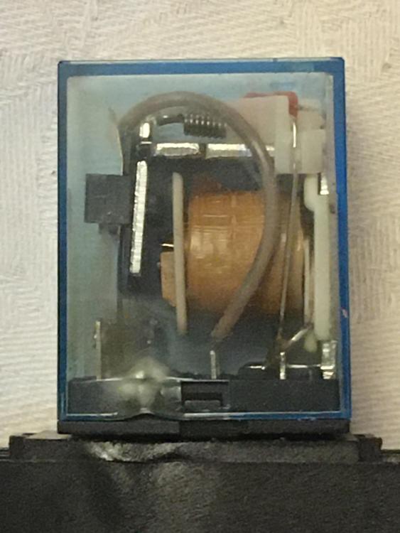

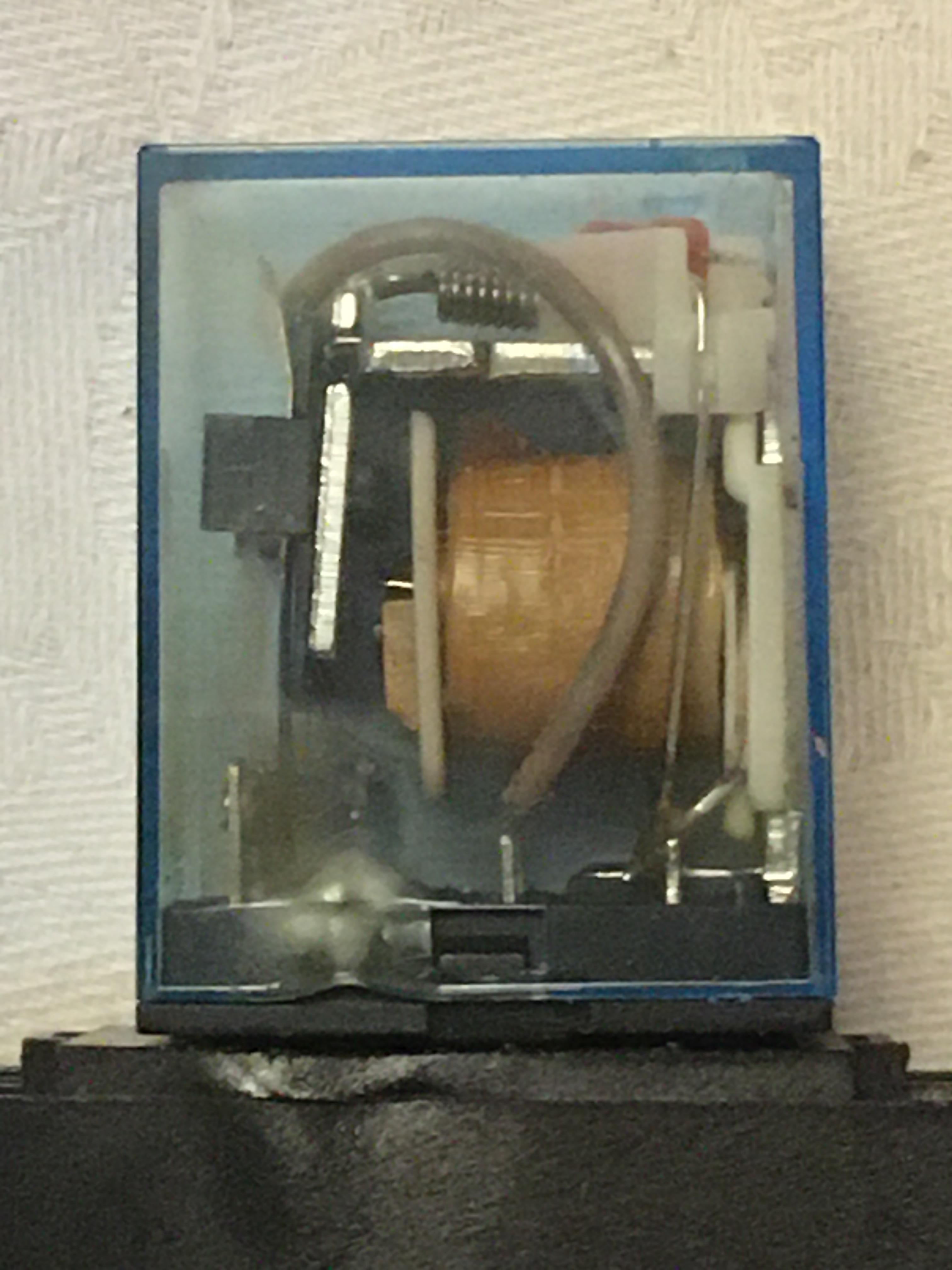

RobLe Posted January 22, 2023 Author Share Posted January 22, 2023 The compressor didn’t turn on a few times recently - everything else worked, the relays clicked, but no compressor, COP=0.0 reported, system power draw of 60W - just pumps. Gahhhhhh. The compressor is powered via the contacts of 3 relays in series - call4heat, pumps, and compressor itself. It’s done like that to be sure the pump must be on if the compressor is, even if the controls go wrong - it’s all controlled by my rubbish software after all. Anyway, after about a year of switching, the call4heat one had failed - that’s the one that usually does the turning off and gets the spark. Turns out I should have fitted an RC series snubber around the contacts to save them from the spark every time the relay switched off. Here’s a pic of the old one. It still works 50% of the time in that state! I replaced relay+socket, and put a series combination of 47ohms+100nF across the compressor and a MOV across it too. It seems to work, I can’t see a spark now when it switches off. I’m glad I caught it early, the house temperature didn’t really suffer. Obsessively looking at the COP is helpful after all 🙂 Link to comment Share on other sites More sharing options...
Radian Posted January 22, 2023 Share Posted January 22, 2023 3 minutes ago, RobLe said: Turns out I should have fitted an RC series snubber around the contacts to save them from the spark every time the relay switched off. Yes, any inductive load will just want to keep the current flowing and generate a huge back EMF in an attempt to do so. Perhaps you could use a SSR with built-in snubber for higher reliability? Link to comment Share on other sites More sharing options...
RobLe Posted January 22, 2023 Author Share Posted January 22, 2023 Yes, maybe a good idea. That relay serves two purposes: one pair of contacts is used at low voltage, it tells the software ‘Call4heat’, the software checks there’s flow, nothings too hot or cold, confirms it’s not short cycling. The other contact has the compressor routed through it. I could just omit routing power through it, use an ssd to switch the compressor on/off directly via software….rely on my software being ok 🤣 It lasted a year sparking, I reckon it’s fine now there’s no spark. Link to comment Share on other sites More sharing options...
