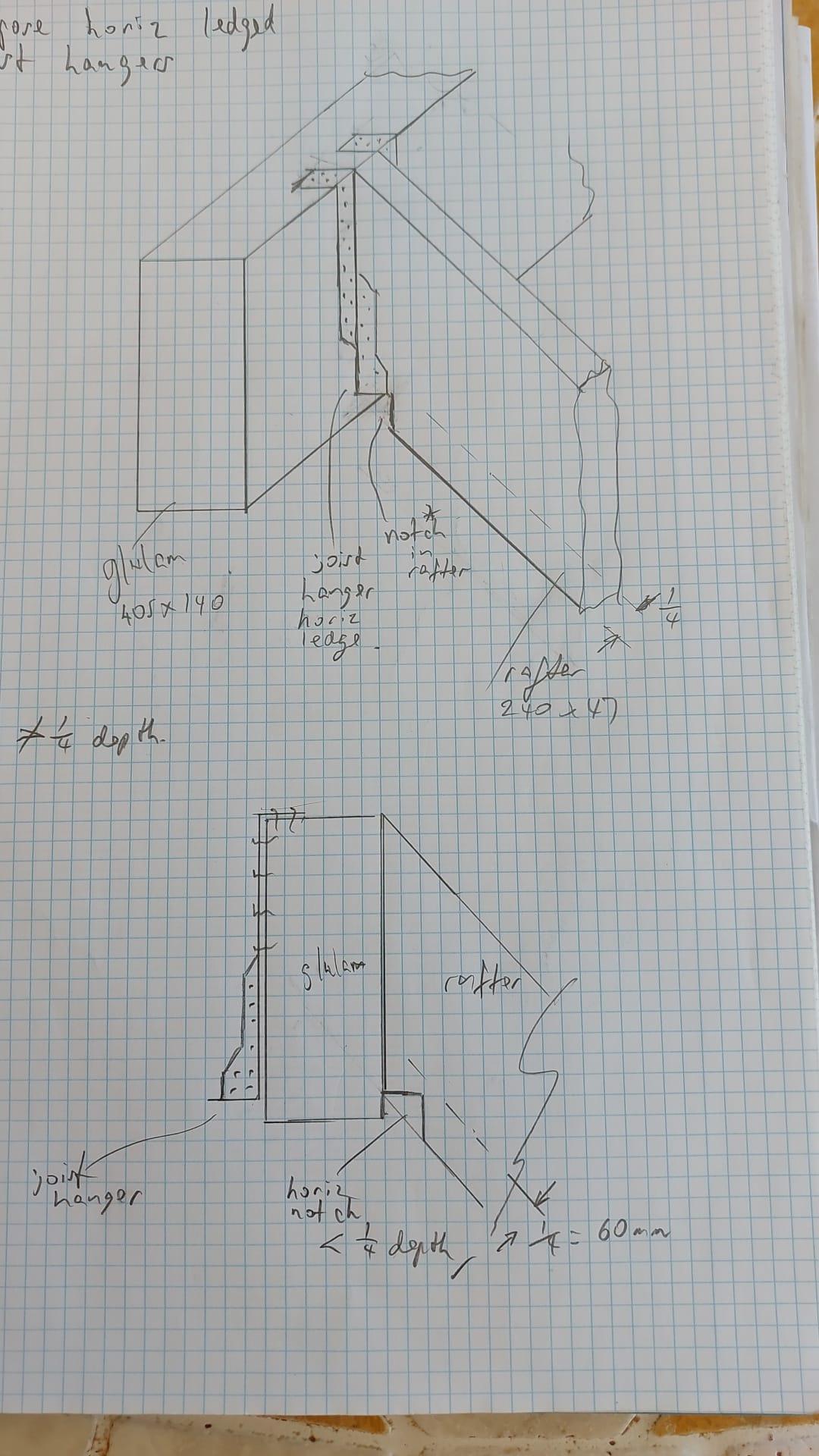

saveasteading Posted May 22, 2022 Posted May 22, 2022 About to order the timber for the stick build section of new build (replacing demolished section.) 1. I am trying obviously to get the most efficient design to save timber and labour. I can see that a kit build company brings in whole wall panels, places them on a sole plate, then straps a top wall plate on to hold it together. But with stick built, can we not build the studs straight onto the sole plate, and then a single top timber (except where doubled/trebled as lintels etc)? Saves wood, saves labour, reduces cold bridge, increases insulation area. I think this may just be a standard detail that is not questioned. 2. Any idea why there should be a dpc under the sole plate of Internal Walls? Architect and Engineer dont have it but a potential joiner's QS has included it. The wall will be on a concrete slab with dpm below it.......just checking I am not missing something. 3. Simpson rafter hangers with adjustable sloping foot.....cost about £18 each. !!. x 50. I cant see any competition to this supplier. Know any alternative or something cheaper. 4, Inverness area only....where is the best timber price at the moment? The prices seem to have eased, and are about £550/m3 for big timbers. That is list price and should come way down for a big order. Do John James sell direct? Loads of mills doing C16, but is it treated? One local mill said they can't beat the merchants and only do special commissions.

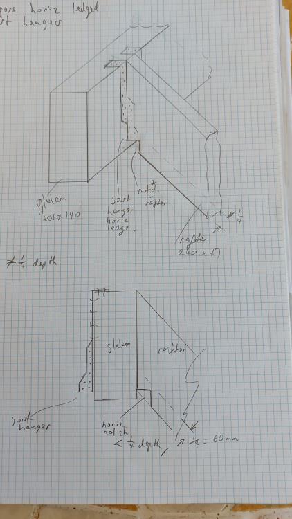

saveasteading Posted May 24, 2022 Author Posted May 24, 2022 The prices really have fallen. Not great, but not as bad as it was looking for a while. OSB about 40% off list. Timber ditto from a BM. That is still more than the ex-mill price quoted above but getting closer. Next question. These sloping bottomed rafter hangers.... (£17 each probably) Any reason we can't use normal joist hangers with horizontal bottoms (£4), and notch the rafter into it? I am assuming that rafters into glulam ridges are treated as pinned joints, and so this would be a tidy and economical solution. (The Engineer doesn't issue any calculations without a lot more payment so there is no proof. By inspection 225 x 45 over 2.5m horizontally looks plenty for simply supported). Also, as the rafters become shorter in the triangles of the valleys and hips, is there a stage at which we just bang in 4 nails?

MikeSharp01 Posted May 29, 2022 Posted May 29, 2022 On 24/05/2022 at 18:05, saveasteading said: Any reason we can't use normal joist hangers with horizontal bottoms (£4), and notch the rafter into it? Yes - think about it, you are reducing the effective depth at the point where you want the max strength. You might discuss using a deeper flat hanger and putting a sloping wooden insert in the bottom to rest the rafter on with your SE.
saveasteading Posted May 29, 2022 Author Posted May 29, 2022 5 hours ago, MikeSharp01 said: at the point where you want the max strength. Is it though? If the rafter is designed as simply supported then bending is nil here., and we are looking at shear and uplift. As the rafter is 225 x 47 there is a lot of shear resistance, and the rafter has been chosen with limiting deflection, before structural failure is involved. The massive glulam beam will just about hold it all down without the rest of the structure. These are hunches though as we have no numbers. Yes we may have to ask the SE but the answers here provide us with more context from people who have done this before. It would be nice to present a solution and make it easy for them. As you may have read, we have already suggested several improvements to their design, and I wonder if at some stage they get the huff and say no. I am probably being unfair saying that, and they will take it on its merits. Gus thinks a notch will be ok. I have sketched it and , because the rafter is so deep, 25% notch out should be feasible. I was rather hoping that someone who has done a stick build or bought a kit with a ridge beam will know how their ridge was built.

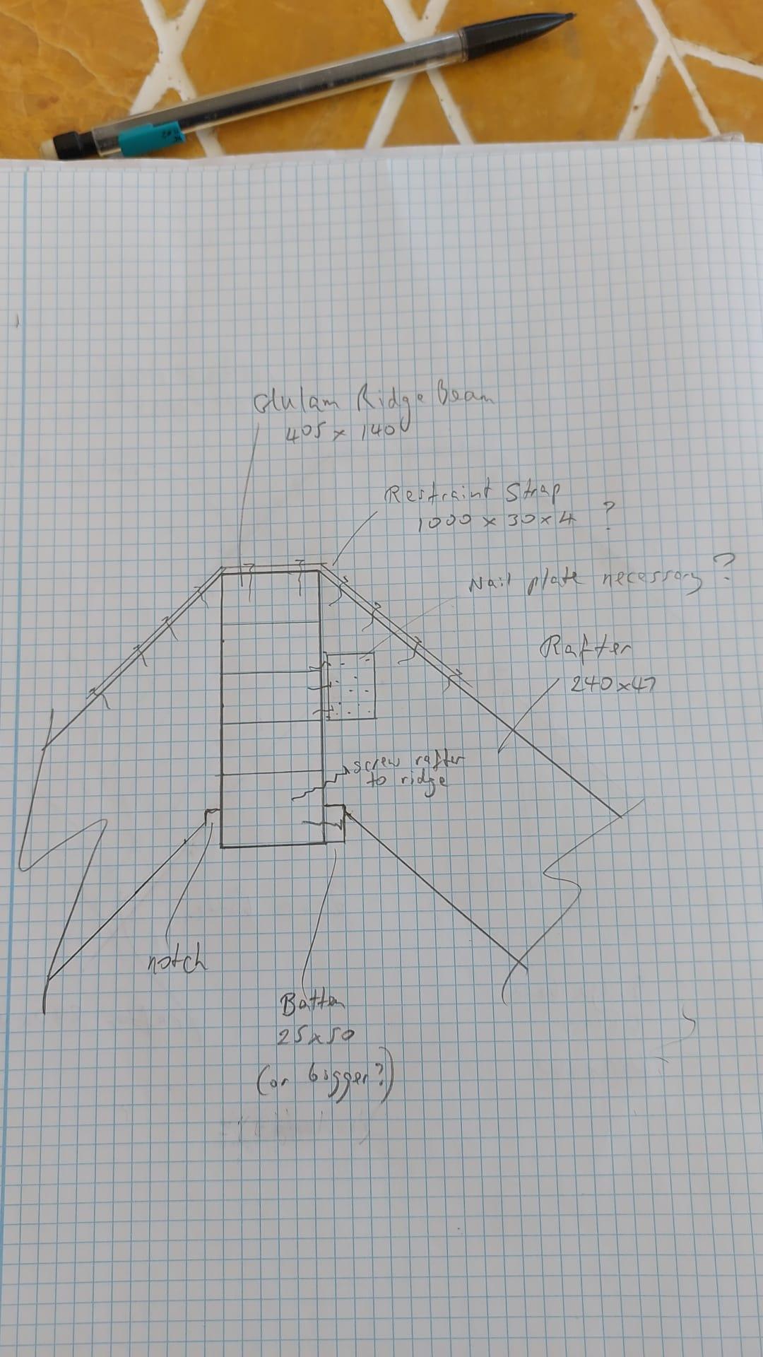

Russell griffiths Posted May 29, 2022 Posted May 29, 2022 No hangers needed for uplift or downward movement IMHO fit a 25x 50 batten the full length of your ridge, do a plumb cut on the rafter end including a notch for the batten. Fit rafter and secure with a 125-150x8 timber fixing. All you need then is restraint straps, these will go over the top of the ridge and fit to the top or side of the opposite rafter. 1
saveasteading Posted May 30, 2022 Author Posted May 30, 2022 So Russell, is this second sketch in line with your suggestion? It is certainly very neat with the tiny cut-out. Joiner friendly, and avoids the expensive Simpson brackets. I wonder if 25mm as a ledge is secure enough during construction. so perhaps a 2 x 1? Also I guessed where the screw that holds it in place goes. with a wider batten it could go up from the bottom. And cold feet: I have also added an angle bracket...perhaps unnecessarily. The first sketch is my original idea of using a standard joist bracket, with a notch which is less than 1/4 as instructed by Gus. Sorry about the hybrid 3d, the sloping rafter makes it tricky.
Russell griffiths Posted May 30, 2022 Posted May 30, 2022 Many ways to skin this cat. If going with a hanger, no notch needed, just a saw cut for hanger to slot into. If going with a batten I would add a 150-175?? Construction screw through each rafter into the ridge. Restraint strap does not need to be thick. The thinner the better as it can play havoc with your roof tiling. Its in tension so doesn’t need to be thick, I think mine are only 1.5 —2mm.
saveasteading Posted May 30, 2022 Author Posted May 30, 2022 38 minutes ago, Russell griffiths said: Many ways to skin this cat. Thanks. You think the angle plate is unnecessary then? 39 minutes ago, Russell griffiths said: 150-175?? Construction screw Angled through the side of the rafter and into the ridge? I was thinking of that as a temporary fixing, not the finished article. So downwards load is onto the batten, upwards load resistance is only rafter weight plus from the screws....doesn't seem enough, but 8mmand a screw each side, yes that is a lot of shear.. and the timber at the screws is the likeliest failure point., so position half way or above. Held tight against splaying by the band and the screws. 40 minutes ago, Russell griffiths said: If going with a hanger, no notch needed, just a saw cut for hanger to slot into. How clever. Won't help the strength but is a cut less. I will change the sketch to notch to sit in the hanger or cut to slide onto hanger base.. 57 minutes ago, Russell griffiths said: Restraint strap does not need to be thick So use a roll of banding? 20 gauge (= 0.91mm). and lots of nails. Costs will be similar for either method I think, around £4 per rafter for materials as opposed to the sloping strongtie at £17. Labour very slightly more? We will have to put this past the SE who did the warrant, so will ask the joiner if he has thoughts then plump for one. Assuming the SE isn't familiar with traditional construction, the joist hanger is prob easier to 'sell'. But then again...local joiner says this is how to do it.....and a bloke I don't know off the internet.

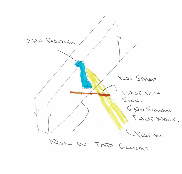

Gus Potter Posted May 30, 2022 Posted May 30, 2022 (edited) What about this? Have attached a very rough sketch. Notch bottom of rafter< 25% Use JHA Simpson hangers wrapped over as you have shown. These take the shear loads. Buy some flat galvanised restaint straps 2.5mm thick or round about. Get a vice and a spanner and gently put the 90 deg twist at each end where you need them to be or if you want the full bunnah get Simpson to make them for you. Try if you can to get at least 6 no square twist 30 x 3.75mm into the rafters maintaining a 20mm edge distance to the timber. Much will depend on the rafter angle, the shallower the more meat of timber you have to play with. The twist strap will sit flush with the bottom of the Glulam and tie them together at this level. Get 3 - 4 sq twist nails nails up through the strap into the underside of the Glulam. If you put the strap over the top of the timber you'll need to scab extra timber to the side to fix the sarking as the strap will foul the sarking nails. Food for thought? Edited May 30, 2022 by Gus Potter Typo - a left handed one
markocosic Posted May 30, 2022 Posted May 30, 2022 I typed something long. Short version is I like the "Gus strap" idea for spread. You might want truss hangars rather than joist hangars though; or you might want the joist hangars upside down if the uplift loads are higher than the down loads. Glulam is 140 mm wide and 405 mm high Rafters are 47 mm wide and 240 mm high (more than 240 mm because angles) Compression stops them spreading into the glulam "horizontally" - cut nicely and you're done What stops them spreading away from the glulam "horizontally" - (more traditional?) roof tie between the rafters just under the ridge beam or - Gus strap; which is the metal equivalent of the above or - nail a thin strap across the top What carries vertical loads? - (more traditional?) sit the rafters on top of the ridge beam and carry down loads in compression / use a ruddy heavy roof covering for uplift (this is not the case with a metal roof!!!) or - (more traditional?) sit the rafters on top of the ridge beam and carry down loads in compression / use a roof tie jammed up hard against the bottom of the ridge beam to for uplift or - truss hangars are in 47x97 and carry 5-6 kN each in the "wrong" direction (uplift) which ought to be plenty; all they can't do is carry the "spreading" load but you have the strap for that https://www.bpcfixings.com/downloads/datasheets-new/BPC Data Sheet - MTH-240.pdf ~£1.50 ea in volume https://www.leofixings.com/product-p/lfprodpar00140.htm vs ~£0.50 for joist hangars? https://www.leofixings.com/product-p/lfprodpar00211.htm The truss hangars are stronger than joist hangars in the uplift. The ledger is fine for initial assembly and fine for tile load / snow load but it don't do anything useful for you in wind load. I think that the latter will be what keeps the SE up at night I imagine. He / she might even want the joist hangars to be upside down if they were used! Notching the tops of the rafters flat... 2.5 metre span though? Can't be much uplift on that! 1
