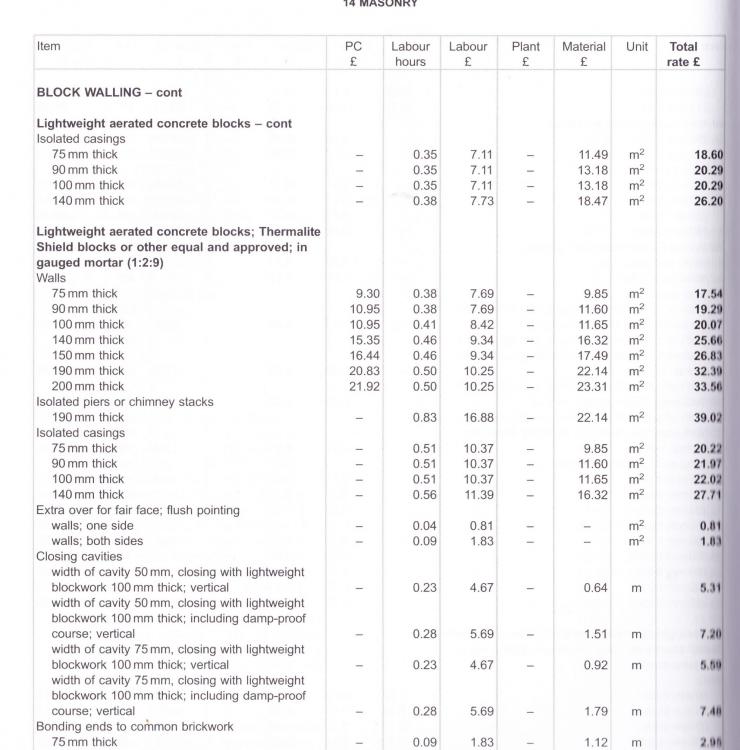

Construction Channel Posted May 19, 2017 Share Posted May 19, 2017 2 hours ago, recoveringacademic said: Hi folks, This is what I mean looks fairly all encompassing. couple of Q's what is the PC column for? and how do you incorporate the cavity closing? or are those per linear meter? edit : it quite clearly says m in the unit column and you say those are london prices so i would only get half of the end column, or do i only half the labour cost? Link to comment Share on other sites More sharing options...
PeterW Posted May 19, 2017 Share Posted May 19, 2017 29 minutes ago, Construction Channel said: looks fairly all encompassing. couple of Q's what is the PC column for? and how do you incorporate the cavity closing? or are those per linear meter? and you say those are london prices so i would only get half of end column, or do i only half the labour cost? PC is the value of the blocks in there - if you wanted to use a different manufacturer block you add or subtract the difference in cost per square metre to the material price. Rates are covered in detail in the rates tables - it's SE rates I think and you factor a percentage on the labour based upon your locality. I'm not sure if the electronic version allows you to do this for all rates. I've built a version of this from both SPON and a QS sheet I have to validate costs - downside is that you have to take an daily rate and then make it into a per item/m etc rate. 1 Link to comment Share on other sites More sharing options...

ToughButterCup Posted May 20, 2017 Share Posted May 20, 2017 14 hours ago, Construction Channel said: looks fairly all encompassing. couple of Q's what is the PC column for? and how do you incorporate the cavity closing? or are those per linear meter? edit : it quite clearly says m in the unit column and you say those are london prices so i would only get half of the end column, or do i only half the labour cost? Buy the book Ed ..... It only costs as much as a good night in the pub Link to comment Share on other sites More sharing options...

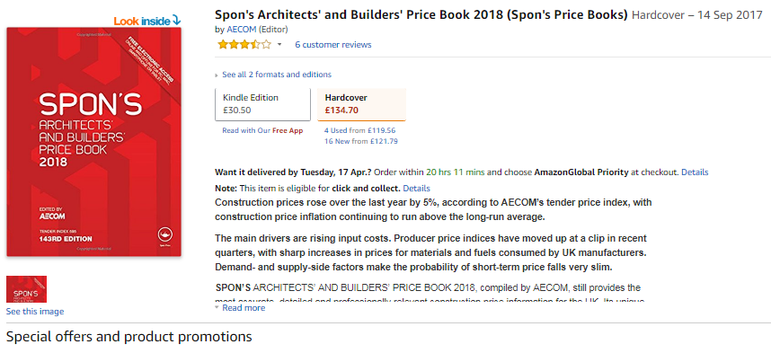

Youngredders Posted April 12, 2018 Share Posted April 12, 2018 On 5/18/2017 at 21:17, recoveringacademic said: But the task is of a known size. That - in conjunction with SPONS - makes it possible to make a judgement on whether the day rate is reasonable. SPONS has saved me about as much money as buildhub. For the idiots in the room; what's SPONS? Link to comment Share on other sites More sharing options...
PeterW Posted April 12, 2018 Share Posted April 12, 2018 10 minutes ago, Youngredders said: For the idiots in the room; what's SPONS? SPONS price guide... Issued and updated every year, covers all works for construction from hanging a door to building a multi storey car park, broken into materials and labour If you don’t have a QS or estimator involved then it may be the best £160 you spend .... Link to comment Share on other sites More sharing options...
