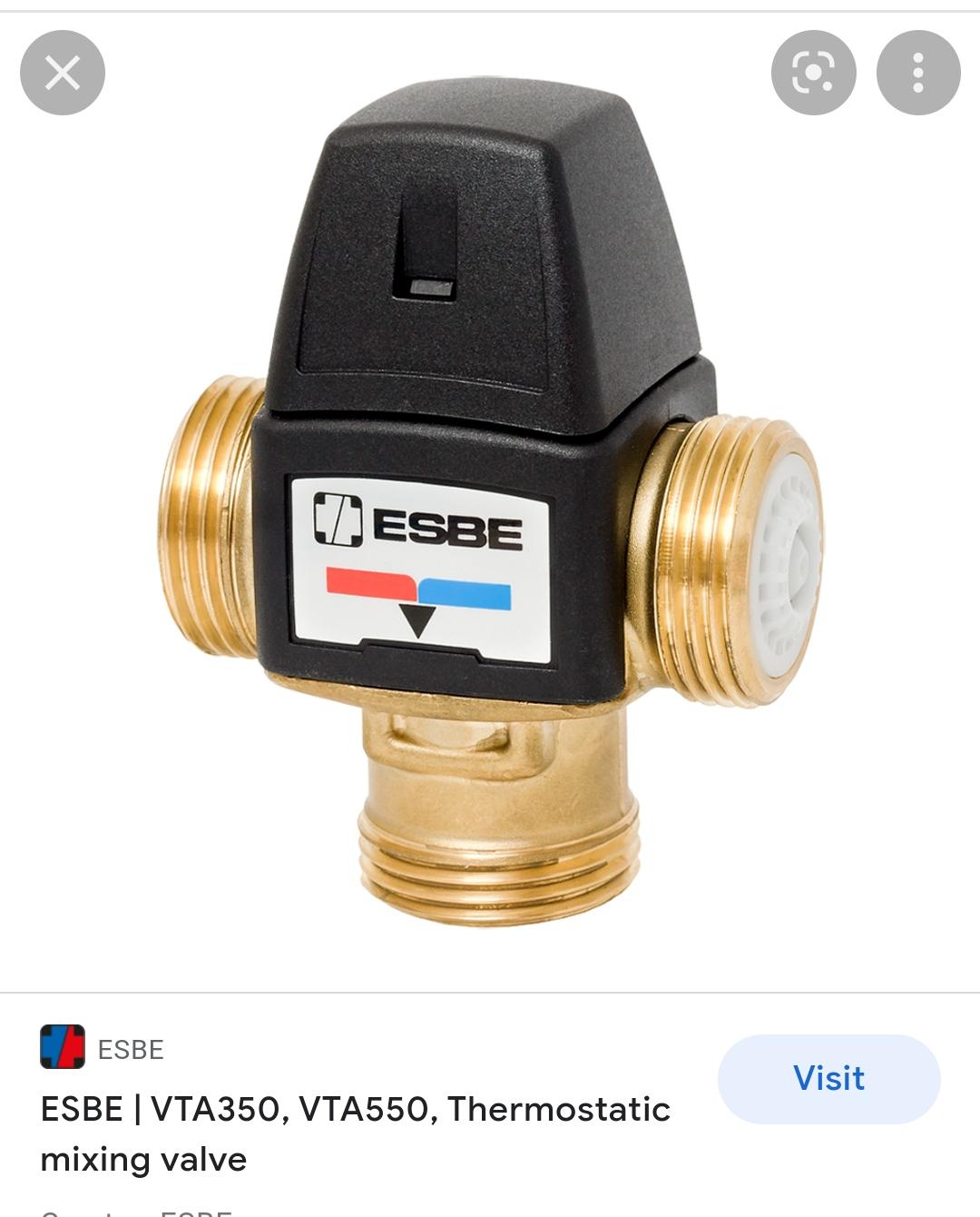

Higher temp in water cylinder, as energy store. With mixer to give sensible hot water temp @ taps?
We've been doing endless calculations as part of our design for an off-grid home we are hoping to build.
Energy storage is key to smoothing out the erratic energy produced from the large PV array, and it seems wise to try and use a large water cylinder as a secondary energy storage system as well batteries.
Now this may well have been done before, but I had the idea of increasing the max allowable temp of the water in the hot water cylinder as a means of storing more energy when it's available.
I have seen these clever little mixer valve things for public hot water taps. They have a hot water and cold water input, and they automatically mix the two to ensure that the output temp is never over 40 degrees C. Anti-scald valves I think they are called.
Now we usually limit the temp of the water in the cylinder to about 60 degrees C, presumably to stop us burning the skin off our hands, and because we never need anything hotter than this coming out of the taps?
If we allowed the water in the tank to be heated to, say 80 degrees... Could we then add a mixer valve on the hot water output of the cylinder, and mix to give the desired hot water output temp, say 60 degrees?
This would allow a greater storage of energy in a given volume of water cylinder. Or maybe I am missing something, and it would be a foolish thing to do.
Feedback appreciated.

Yes, you can get a mixer valve. I have one included in my thermal store and you just set the flow temp to whatever you want. The store also has an immersion heater that heats to approx 80 deg C. Once budget permits this will be used with PV. The TS is designed for 80 degrees.
Do you remember what model mixer you have?

Anti-scald mitigation is a core safety remit, and BRegs requirement, so how do you tick that box with <46oC at the bath when turned to max hot temp?

If you want an optimum design for off-griddyness then I would suggest a dual cylinder arrangement. A 500L TS ( thermal store ) with 2x 3kW immersions, and a 300L UVC ( unvented hot water cylinder ) also with 2 immersions, with the TS preheating the cold feed to the UVC. This will massively increase your potential to store energy as heat, plus the TS can be depleted ( for heating ) without sapping all of your DHW for bathing.
All excess electrical energy into the UVC first, then cascading to the TS. Batteries and PV can dump into either on demand, whichever needs a nudge.
Another advantage is, if you have a diesel genny which is water-cooled you can divert the heated water from that into a low mounted coil in the TS to absorb every ounce of energy you create, wherever it gets created. When you have the least solar revenue it will be the winter, and you'll be needing heating, plus the batteries will need topping up via the genny, so, one problem gets solved and the bi-product ( wasted heat from the genny running ) helps to solve another by using even low grade heat at start up to the high grade heat after it's been running for a while. Zero is wasted.

Reliance Heatguard Tempering Valve

Reliance are very good bits of kit.
Good to know, ta 🙂
We have one of these. It works fine.
We heat our 300l to about 70deg and blend everything to "hottish" at the taps.
