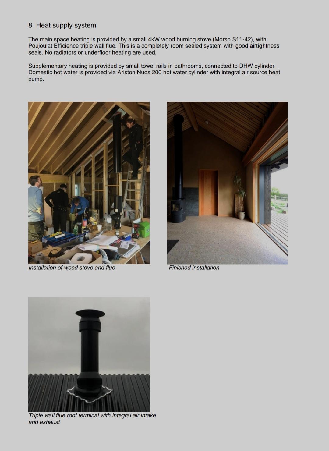

Thedreamer Posted May 11 Share Posted May 11 @davidc Similar to your circumstances I have a lot of free wood. My space heating comes from a centrally place wood stove (mine is surrounded by dense concrete blocks). This goes on from October to March. The rest of the year I rely on solar gains and waste heat from appliances and us. Having access to free wood has resulted in the space heating bills being no more than £5-£10 since we moved into the house in July 20. My hot water comes from an exhaust air source heat pump which sits on a good quality hot water cylinder. My approach is not for everybody but I feel in the right location it could work for others. Link to comment Share on other sites More sharing options...

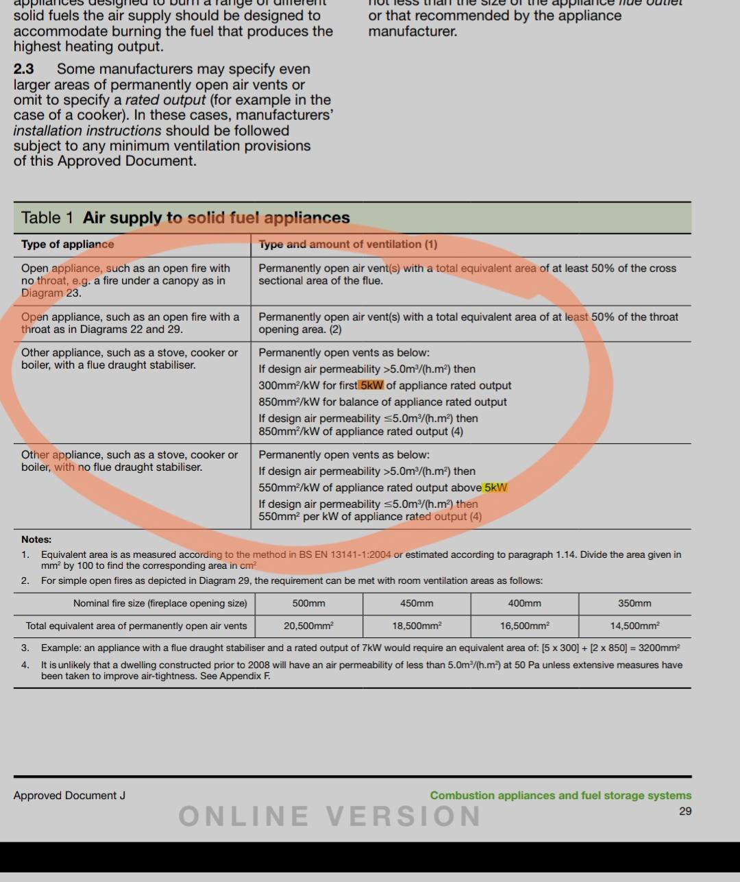

Iceverge Posted May 12 Share Posted May 12 (edited) Here is a link to a German retailer that with a bit of Google translate help you can filter by Dibt compliant stoves. https://www.kamdi24.de/kaminoefen-bis-5-kw/FILTER_VERBRENNUNGSLUFT:FILTER_VERBRENNUNGSLUFT_RUU_DIBT However I came to the conclusion an external air supply wasn't as important or useful as it first appears, although it is required by Bregs. Bregs require 550mm2/kW of permanent ventilation for stoves. At 0.31ACH our airtightness result still left 5000mm2 of equivalent leakage in the envelope. In theory enough for a 9kW stove. I'm pretty sure you'd have a tough time arguing that with building control but practically with a balanced MVHR system I can't see a small stove ever struggling for air. If the MVHR is highly biased towards extract you risk pulling fumes out of the stove. Not ideal. I have seen 2 examples of passivhaus with stoves that have good airtightness results. 0.59ACH with a boiler stove. https://mollyglass2012.tumblr.com/page/9 An extract from "Old Holloway" passivhaus. (one of my faves) 0.39ACH. Interesting both use poujoulet flues of different flavours. Maybe no more than coincidence. Edited May 12 by Iceverge Link to comment Share on other sites More sharing options...
