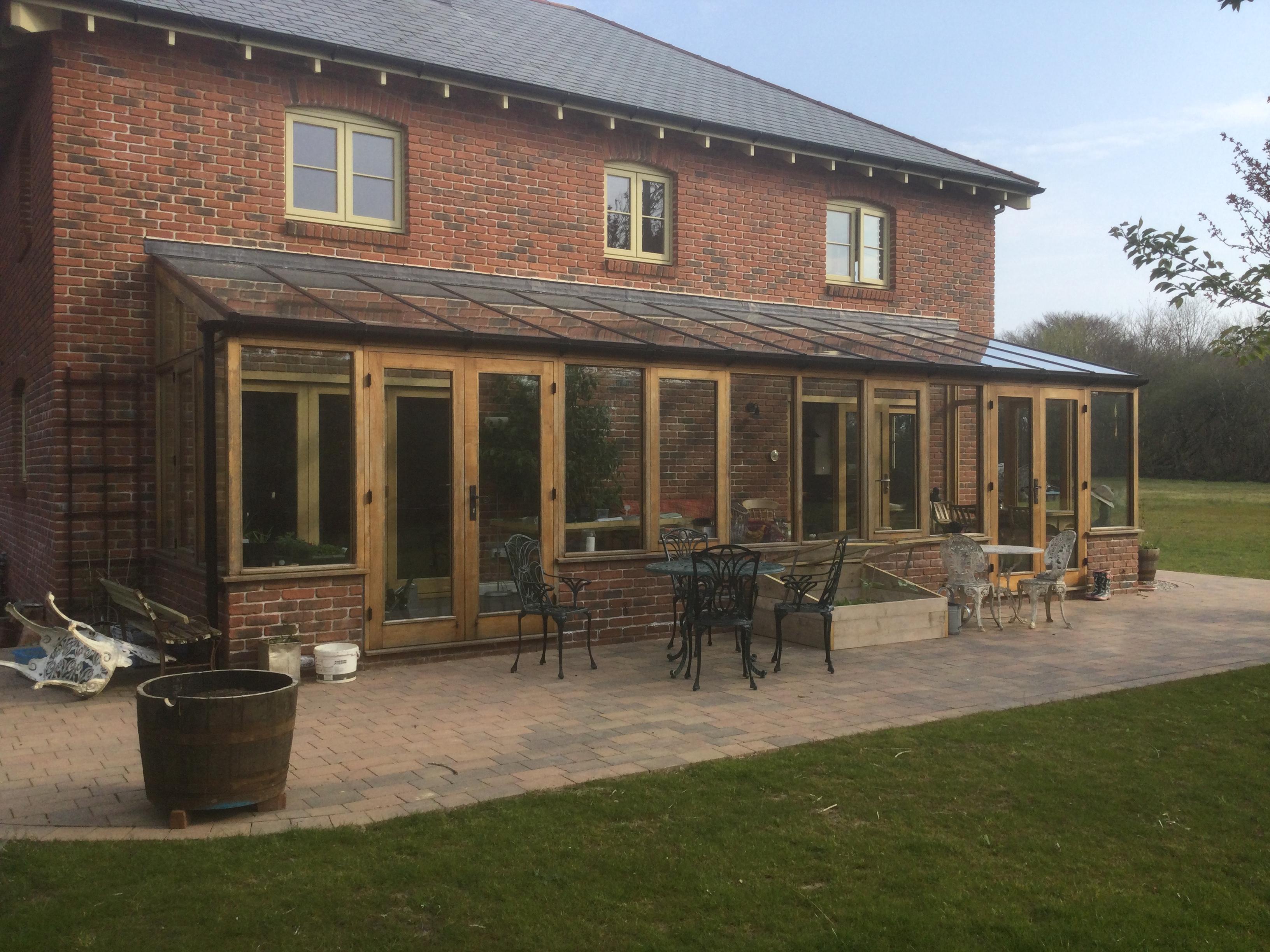

joe90 Posted May 7, 2022 Share Posted May 7, 2022 Well I have just finished my build in North Devon, not passive but not far off, a 5kW ASHP with UFH , heating required only a couple of months a year, plenty of hot water all year. (And I very rarely wear a jumper indoors). Orientation is key IMO I have a south facing conservatory and that heats the house in the shoulder months. Having MVHR means no trickle vents (draughts) and heat recovery. I was told my house would overheat with South facing and a conservatory but as yet I have not needed cooling (which the ASHP can do with a bit of work). 1 1 Link to comment Share on other sites More sharing options...

joe90 Posted May 7, 2022 Share Posted May 7, 2022 2 hours ago, DevonKim said: Part of me thinks that I'm being unimaginative with my designs, as it is a fairly square box, Similar to mine, oblong box with longest wall facing south, small windows to the North 👍 3 Link to comment Share on other sites More sharing options...

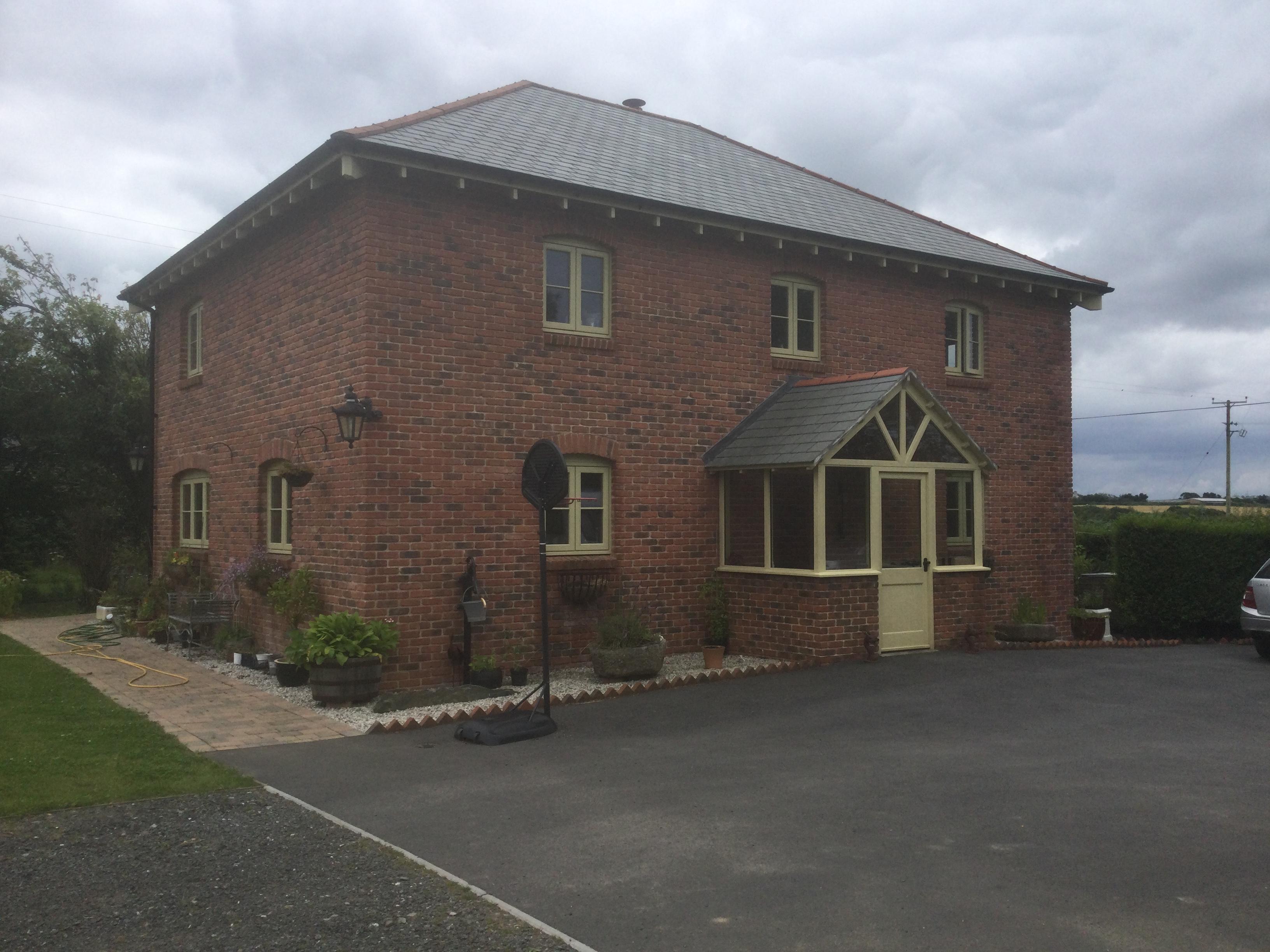

Iceverge Posted May 12, 2022 Share Posted May 12, 2022 (edited) I can't see that small unit being a problem. I was thinking you might be planning on putting one of these in your kitchen. Worse case it only gets used infrequently but I do enjoy occasionally shutting our sitting room door and getting it up to 25 deg+ with our convection rad. On 07/05/2022 at 13:58, DevonKim said: Part of me thinks that I'm being unimaginative with my designs, as it is a fairly square box, but I wanted something simple to construct and not too many fiddle details to sort, so it is nice to hear that the box shape is also going to pay dividends on the heating front Another square box here with much the same thinking. No regrets with the shape of the shell but maybe we should have altered the layout a little inside. Edited May 12, 2022 by Iceverge Link to comment Share on other sites More sharing options...

DevonKim Posted May 12, 2022 Author Share Posted May 12, 2022 2 hours ago, Iceverge said: Another square box here with much the same thinking. No regrets with the shape of the shell but maybe we should have altered the layout a little inside. Gosh that big stove / range is pretty, isn't it? What would you alter about your internal layout, and why? Link to comment Share on other sites More sharing options...
DevonKim Posted May 12, 2022 Author Share Posted May 12, 2022 (edited) 3 hours ago, ToughButterCup said: Know why you are choosing the heating design that you want : and - more importantly - why you are not choosing any other from all the designs available. I'm choosing underfloor heating as a distribution method because I have too many books, and radiators get in the way of bookshelves 🙂 . More seriously, it does sound as though an ASHP in a new build with underfloor pipes is an effective and cosy way of heating for me. And it may be different for other people. I think it is very easy to spend ages agonising over the choice, when each will have advantages and disadvantages, just different advantages and disadvantages, so there is no "right" choice. It can be easy to become paralysed by indecision, when sometimes just making a decision, and accepting that there will be some disadvantages associated with that decision can get a project moving. Edited May 12, 2022 by DevonKim 1 Link to comment Share on other sites More sharing options...
Iceverge Posted May 12, 2022 Share Posted May 12, 2022 3 hours ago, ToughButterCup said: be pulled this way that way (... over the Irish sea ...) by one charlatan after the other I think I just heard an arrow fly past my ear !!? 13 minutes ago, DevonKim said: Gosh that big stove / range is pretty, isn't it? Yup, I was dead set on a range cooker too but logic (and cost) beat me down. 14 minutes ago, DevonKim said: What would you alter about your internal layout, and why? We ended up with big rooms and not much built in storage. We had a hot press with the water cylinder upstairs ( a hangover from an earlier design with a boiler stove) and there was no need for it. A walk in wardrobe would have been better use of the same space. 1 Link to comment Share on other sites More sharing options...
