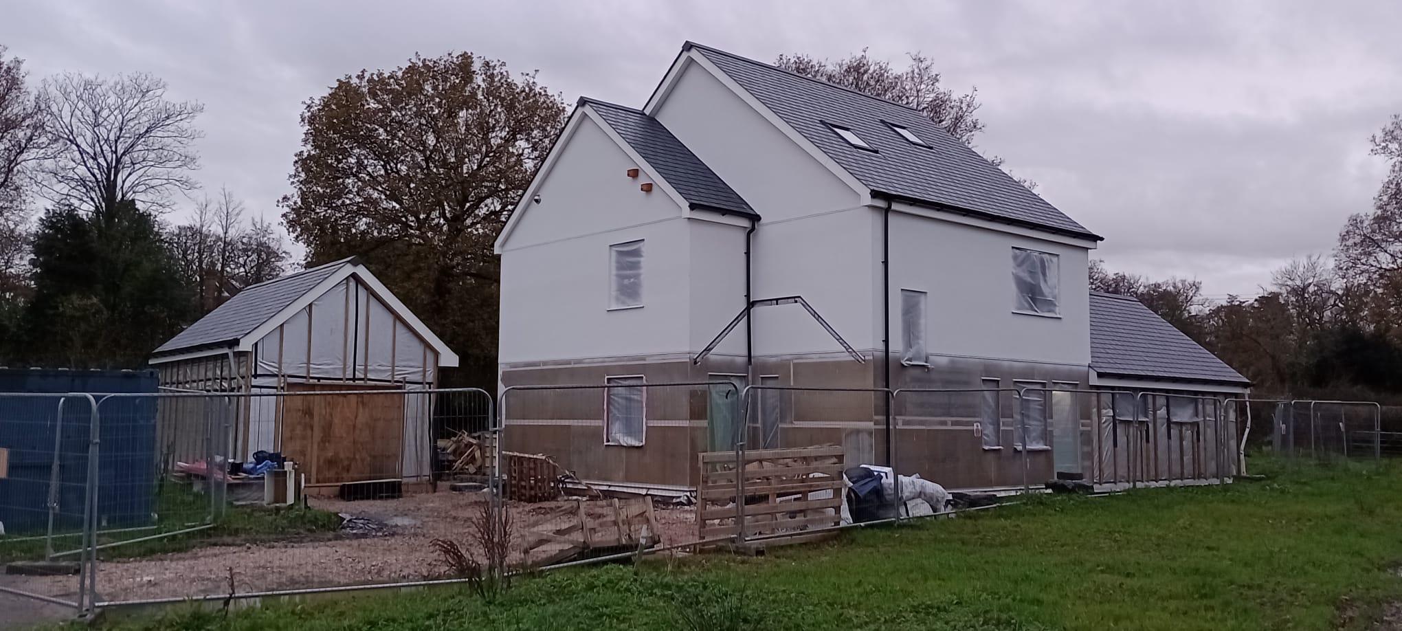

  2. It is now looking something like a house. There is still some way to go, particularly internally, but Building Control are happy so far.

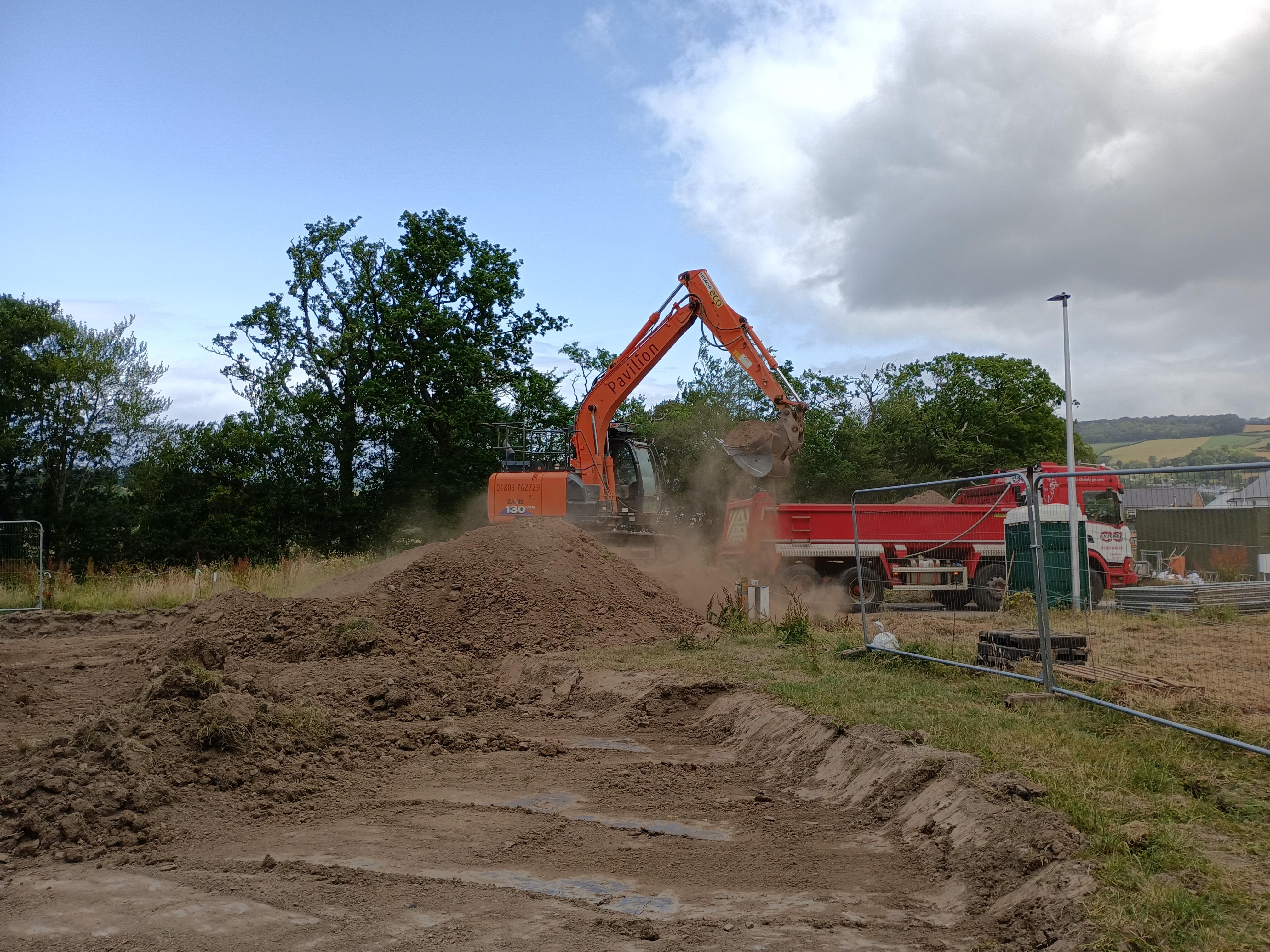

  3. Like many other people, I have had slow progress getting started, but I now finally have the diggers on site.

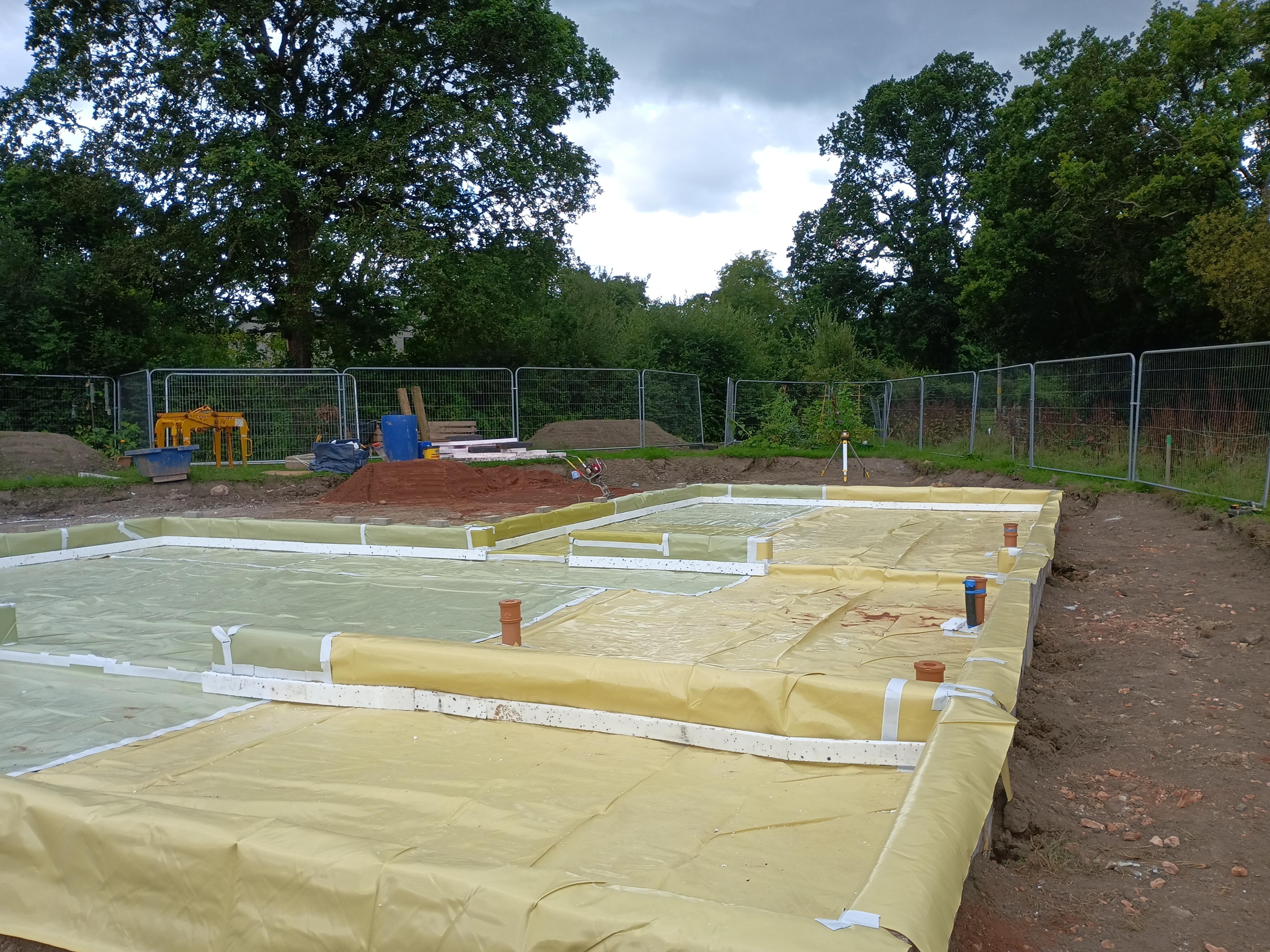

  4. Yes @saveasteading and @ETC, thank you for your comments. It isn't quite correct for my timber frame, but I have not got enough info to sketch up a detail myself which will give me something that I can use to discuss with Building Control. @Jenki I'm right on the edge of Dartmoor, so I will definitely need the radon protection sadly.
  5. Thank you folks, That is really helpful, as it looks as though the consensus is that it is not a great detail. @saveasteading no, not my own detail, which is why I am querying it! @ETC really helpful, thank you.
  6. Good afternoon, I am after some advice on radon protection. The current proposal for my radon barrier is that I should have an edge bearing slab, as shown in the snip below. I would prefer a floating slab (easier and cheaper to construct). My BC seem to prefer an edge bearing slab too. Has anyone got a foundation detail for a radon barrier floating slab foundation? My house is going to be timber frame, so it is lightweight. The ground is reasonably firm clay, so there should be no problem with narrow trench foundations. Any advice would be gratefully received. Kim
  7. Thank you very much @Gus Potter Lots to think about there

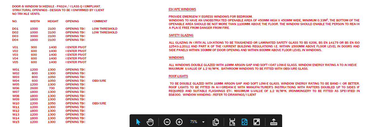

  11. I am getting closer to planning permission being granted, and have been starting to get quotes in for my windows. The two that I am most likely to go with are NorDan and Rationel windows, aluminium clad timber, triple glazed. The quotes are looking fairly similar, around 30k for the windows and installation. My first question is whether that seems reasonable for a smallish house worth of windows, as per the schedule below. My second question is whether there would be scope for haggling here, and if so, how should I go about it? What reductions have other people achieved by haggling? Any advice would be appreciated 🙂
