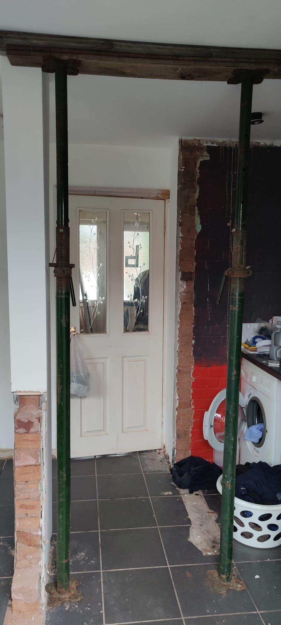

I moved into my house coming up to 4 years ago, there was a wall in the kitchen that didn't make much sense in being there so I spoke with a (former) friend who I knew as a builder, he came round and had a look and noticed that above one of the walls I wanted to remove, there had been 3 (partly) replaced joists that were held together with a few wood screws, he advised me that I needed to put 2 x 12mm coach bolts through each them and then I'll be ok to remove the wall below.
So that's what me and my old man did one weekend, there was a pillar which was part of an old wall which I left in as I liked it as a feature, (this was 3 years ago) the wall got removed bit by bit with no issues.
Fast forward to last week (W/B 25/04/22), I want to remove the pillar now to fully open up the kitchen and the remaining wall that formed a breakfast bar.
I wanted to get a builder in to confirm that I was able to remove the pillar with no issues and that's when everything seemed to snowball!
I spoke to one builder (Monday, last week) and he asked me to send over some pictures and he'll let me know when he would be able to get out to have a look.
Tuesday afternoon rolls around and I get a phone call saying he thinks I'll need a structural engineer, he gave me the number of a mate of his, I then spoke with him, he thinks I'll need an RSJ, I want to avoid this where possible as it'll have to be a 7m to reach side to side of my kitchen.
I've been Googling (as you do to try and learn about the issue) and found that I might be able to replace the joists as the span is 3200mm (ish) using C24 47x175mm timber, I spoke to the structural engineer and he seems adamant that I'll need an RSJ (he hasn't been around to look yet)
I looked at the average price of a 5m RSJ supplied and fitted and it seems to be just over £1k, not something I was expecting and not something I can “just pay for” either.
So, after all that, my question is, can I not just replace the joists so that they sit wall to wall? I understand it’s a floor boards up, wiring out and ceiling down etc but I’d prefer to do that than have a 7m RSJ in my kitchen.
I put the acro's in as a "just in case" it's been fine for the last 3 years.
Any advice is much appreciated

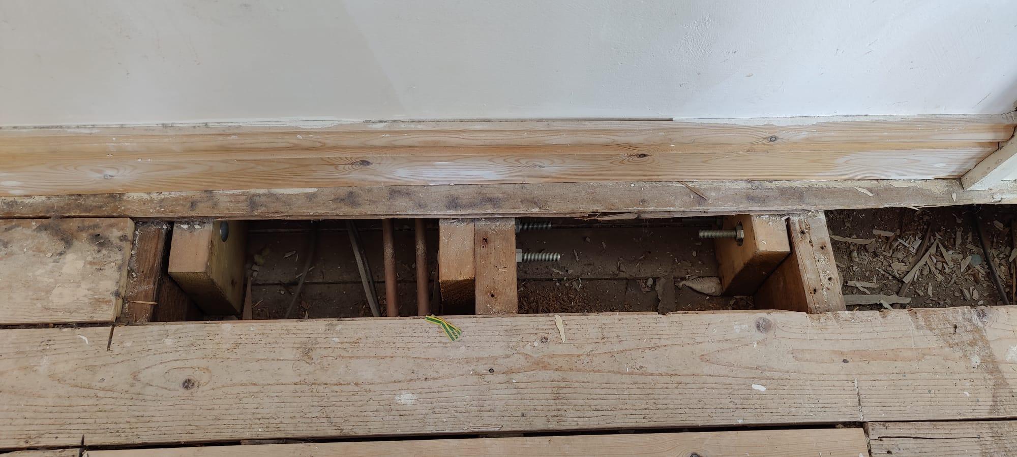

It is unclear where the upstairs floorboard up picture relates to the downstairs pictures, but the upstairs picture shows the ends of 2 separate joists bolted together.  That MUST be supported below that bolted joint either by a wall or an RSJ

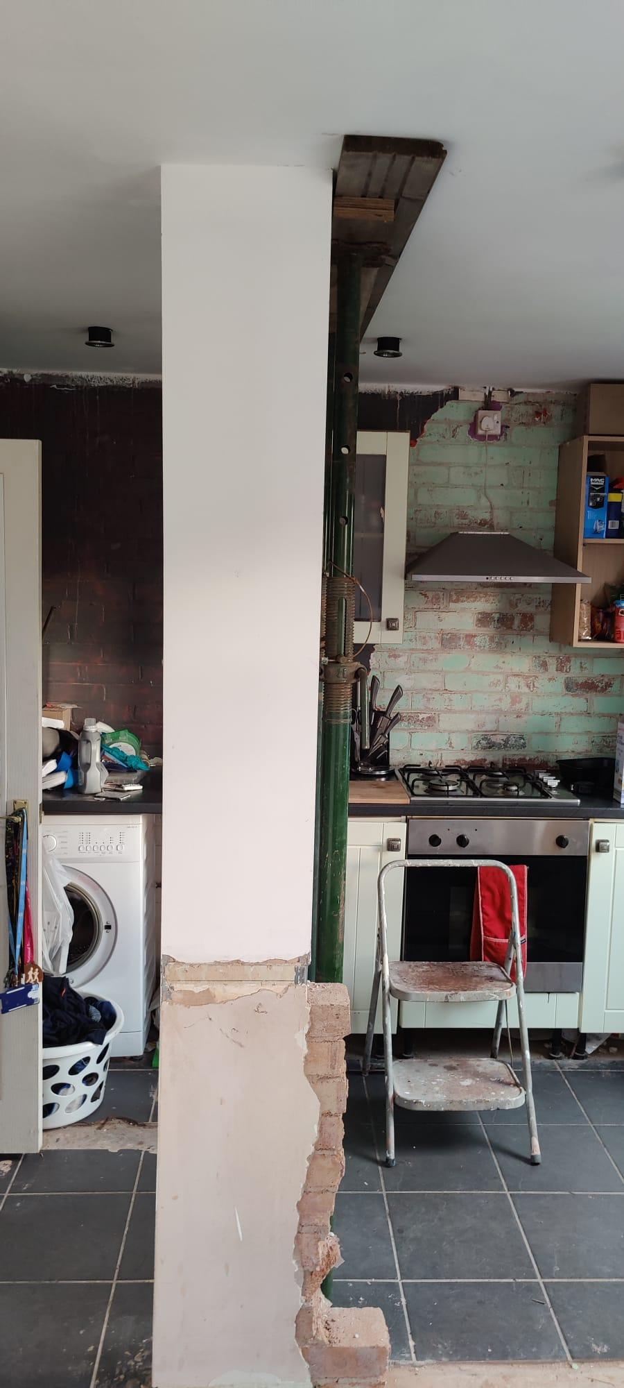

In regards the the floor joists, the "new" sections are 1900mm in lenth, they are supporting a false wall (I can't think of the proper name).
Where the pillar is in the kitchen, the last joist on one of the pictures is sat on there and the others are to the left, if the makes sense? I've attached a picture which would hopefully make more sense.

As I feared, the two "used to be sat on a wall" are now effectively one joist, spanning a longer distance than they did originally, and with the added complication that there is a joint in that now effectively longer joist.
Definitely need a SE to first tell you if that joist section can actually span the longer distance now the intermediate wall has gone, and if so is that joint adequate to do so or does it need some reinforcement.

- a single coach bolt just makes a hinge
