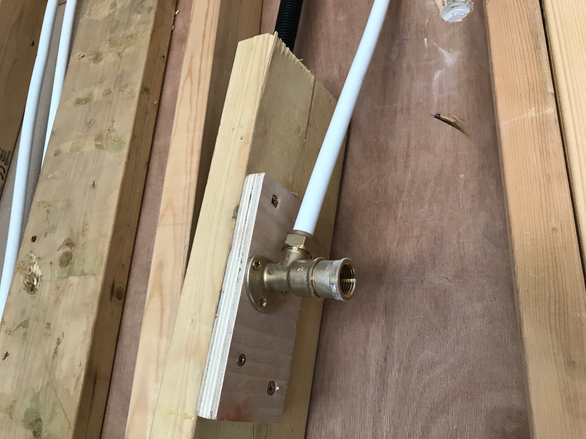

jamiehamy Posted May 16, 2017 Author Posted May 16, 2017 (edited) So to be a bit more helpful, looking for thoughts on following on the shower first as that seems the most straight forward having looked at it. I have access to the rear of the stud wall (it's a column) and the sides of the studs on either side, so my thinking is that I can do all this 'from behind'. PLanning putting a 150mm dwang across screwed on either side to mount the valve (screwed rather than nailed to ensure no movement). I will mark and cut the holes on the tiled side first, fit the valve to the dwang and position in, then afix the dwang at the appropriate depth. I can then do the plumbing 'in situ' fro behind, test then fit the gyproc. For the connections, there are two 1/2" female and 3/4" females, so will these be appropriate to transition to 15mm (plastic) supply pipe work?http://www.screwfix.com/p/pegler-male-taper-15mm-x/7866g Finally, for the run up to the shower head and the hand held, is there any reason I can't do plastic for these? Thank you kindly! Jamie Edited May 16, 2017 by jamiehamy

RandAbuild Posted May 16, 2017 Posted May 16, 2017 Funnily enough, I've just done this last week - added 2 dwangs from the other side of a stud wall to provide a hand shower attachment and rain head to the shower. On the shower side, I added a sheet of ply before the blue plasterboard (we needed to pack out this wall to avoid a floor joist fouling the shower drain; it's also better for hanging a wall-hung double sink from!). This extra depth meant the usual wall plate elbow ( http://www.screwfix.com/p/p803wp-2-wall-plate-elbow-15mm-x/92934 ) wouldn't be long enough, so I added a female coupler ( http://www.screwfix.com/p/female-coupler-15mm-x/93992 ). All this was done from the other side of the wall, and I screwed the assembly to a piece of ply before adding the dwang so it would all line up:
PeterW Posted May 16, 2017 Posted May 16, 2017 Make your life easy... https://www.plumbnation.co.uk/site/hep2o-male-adaptors/?gclid=CjwKEAjwxurIBRDnt7P7rODiq0USJADwjt5Dzd74qVsfugO8BwtyxI7Qkj7_rsSfRlHQ-6nGj87-sRoCLULw_wcB Hep2O HX29 in various sizes, screws straight into the brassware and makes it push fit. 2

jamiehamy Posted May 16, 2017 Author Posted May 16, 2017 6 hours ago, PeterW said: Make your life easy... https://www.plumbnation.co.uk/site/hep2o-male-adaptors/?gclid=CjwKEAjwxurIBRDnt7P7rODiq0USJADwjt5Dzd74qVsfugO8BwtyxI7Qkj7_rsSfRlHQ-6nGj87-sRoCLULw_wcB Hep2O HX29 in various sizes, screws straight into the brassware and makes it push fit. Perfect - thanks!

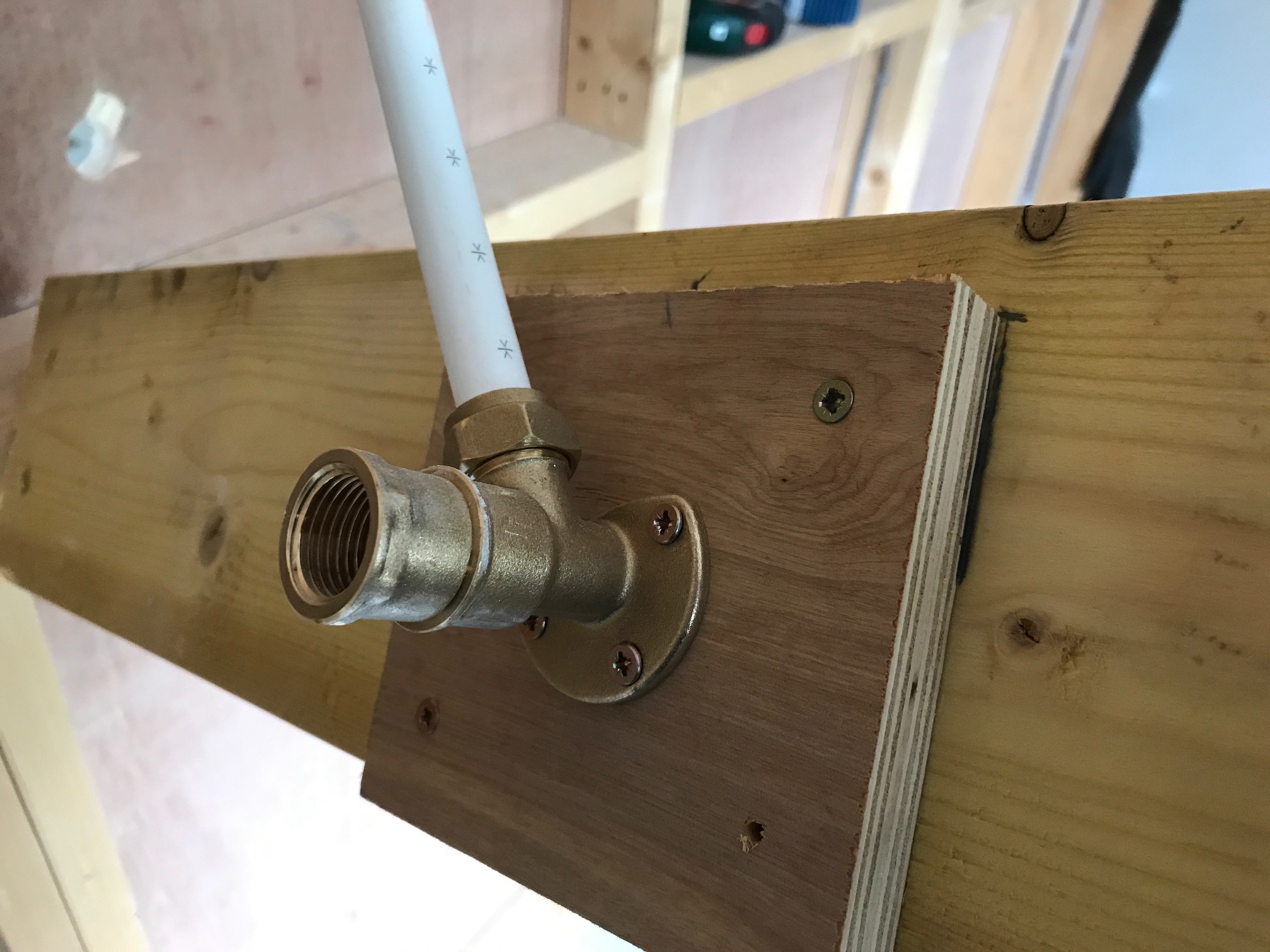

Temp Posted May 17, 2017 Posted May 17, 2017 One problem seems to be fitting the bright work (eg spouts) to elbows. There seems to be no certain way to end up with the connection tight and pointing in the right direction. When we did ours up they sometimes went 45 degrees past the right position before I felt they were tight enough. Solution seems to be to undo it, add even more PTFE tape and try again. Hate bodges like that.
jamiehamy Posted May 17, 2017 Author Posted May 17, 2017 1 hour ago, Temp said: One problem seems to be fitting the bright work (eg spouts) to elbows. There seems to be no certain way to end up with the connection tight and pointing in the right direction. When we did ours up they sometimes went 45 degrees past the right position before I felt they were tight enough. Solution seems to be to undo it, add even more PTFE tape and try again. Hate bodges like that. Funny you say that I was going to post the exact same conundrum! I agree, seems like a bodge but I can't think of anything else!
Crofter Posted May 17, 2017 Posted May 17, 2017 1 hour ago, Temp said: One problem seems to be fitting the bright work (eg spouts) to elbows. There seems to be no certain way to end up with the connection tight and pointing in the right direction. When we did ours up they sometimes went 45 degrees past the right position before I felt they were tight enough. Solution seems to be to undo it, add even more PTFE tape and try again. Hate bodges like that. I don't know if it would be applicable, but when I faced this issue installing valves on a boat, the advice was to use liquid PTFE and a backnut, allowing you to lock the fitting in place at whichiever orientation you needed. Requires sufficient threaded length to fit the extra nut, though.
PeterW Posted May 17, 2017 Posted May 17, 2017 1 hour ago, jamiehamy said: Funny you say that I was going to post the exact same conundrum! I agree, seems like a bodge but I can't think of anything else! Use plastic ..! Doesn't need to be tightened up then ...
jamiehamy Posted May 17, 2017 Author Posted May 17, 2017 3 hours ago, PeterW said: Use plastic ..! Doesn't need to be tightened up then ... I'm down south without proper computer access - for some other the other bathrooms I might be easier with a 90degree elbow coming out but I suppose I can use this then a 90 or 45 degree elbow. Will be the same difference. Hugely helpful responses from everyone, thank you!
Temp Posted May 17, 2017 Posted May 17, 2017 4 hours ago, Crofter said: I don't know if it would be applicable, but when I faced this issue installing valves on a boat, the advice was to use liquid PTFE and a backnut, allowing you to lock the fitting in place at whichiever orientation you needed. Requires sufficient threaded length to fit the extra nut, though. Ours had to be fitted after tiling so no access to the nut.
jamiehamy Posted June 22, 2017 Author Posted June 22, 2017 On 17/05/2017 at 18:35, Crofter said: I don't know if it would be applicable, but when I faced this issue installing valves on a boat, the advice was to use liquid PTFE and a backnut, allowing you to lock the fitting in place at whichiever orientation you needed. Requires sufficient threaded length to fit the extra nut, though. I'm suffering this issue with one elbow - just can't seem to get a seal. Might need to try the liquid pfte . This is on the manifold tho so committed to a compression elbow with male connector. Everything else is perfect just this one.
Barney12 Posted June 23, 2017 Posted June 23, 2017 9 hours ago, jamiehamy said: I'm suffering this issue with one elbow - just can't seem to get a seal. Might need to try the liquid pfte . This is on the manifold tho so committed to a compression elbow with male connector. Everything else is perfect just this one. Have you tried Loctite Cord? It has never ever let me down with a difficult joint: http://www.loctite.co.uk/pipe-sealing-9886.htm
PeterW Posted June 23, 2017 Posted June 23, 2017 1 hour ago, Barney12 said: Have you tried Loctite Cord? It has never ever let me down with a difficult joint: http://www.loctite.co.uk/pipe-sealing-9886.htm Tbh I would try a new fitting first ..! If it's the BSP male fitting that is loose then buy a decent U.K. branded one such as Pegler and see if that has any less slop. If there is still slop then consider sending the shower valve back as it's out of tolerance. The other choice is to go for a plastic elbow such as a Hep2O one as I've found they tend to seal a bit better than brass on brass
jamiehamy Posted June 23, 2017 Author Posted June 23, 2017 So this is for the manifold (I'm using the connector posted above for the shower valve). The manifold ports are pointing down which means the male elbow still has around half a turn left to tight - which would have it pointing the wrong way. I'll try more tape first, I've probably been a bit sparing and the Loctite stuff if that fails. The other two are fine, just this one weeps slightly.
Russell griffiths Posted June 23, 2017 Posted June 23, 2017 On 17/05/2017 at 17:08, Temp said: One problem seems to be fitting the bright work (eg spouts) to elbows. There seems to be no certain way to end up with the connection tight and pointing in the right direction. When we did ours up they sometimes went 45 degrees past the right position before I felt they were tight enough. Solution seems to be to undo it, add even more PTFE tape and try again. Hate bodges like that. This is exactly how I had to do ours on our last house, square tap spout, asked the plumber who did the first fix and he said that is just how they are, take it off add a new piece of tape and re instal, I agree I doesn't seem right I even split a tap spout as I forced it around into the right position.
Russell griffiths Posted June 23, 2017 Posted June 23, 2017 On a hotel water system we did every threaded joint had a liquid thread lock compound on it, after hundreds of joints I don't remember having 1 single weap anywhere could be worth having a hunt around for a liquid sealer.
Jeremy Harris Posted June 23, 2017 Posted June 23, 2017 9 minutes ago, Russell griffiths said: On a hotel water system we did every threaded joint had a liquid thread lock compound on it, after hundreds of joints I don't remember having 1 single weap anywhere could be worth having a hunt around for a liquid sealer. I've used Screwfix Liquid PTFE a lot, and it's never yet failed. The dispenser bottle is a really bad design, making it frustrating to get the stuff out, but it works really well. If a joint needs to be undone, then gently warming it up will soften the sealant and allow it to unscrew fairly easily.
