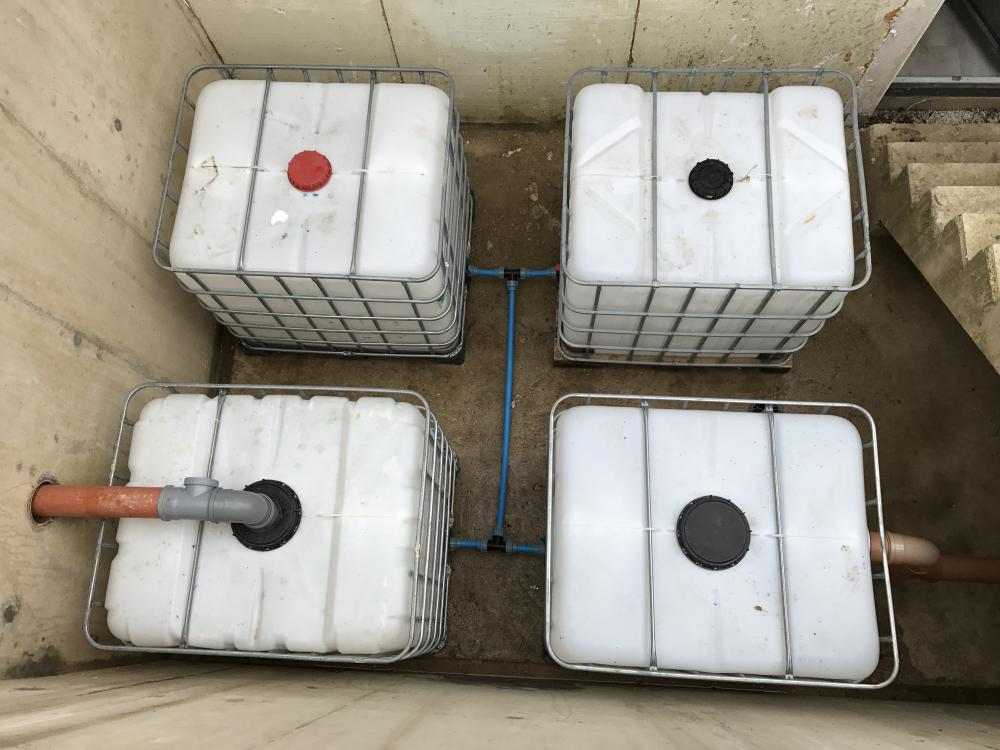

Bitpipe Posted February 10, 2018 Share Posted February 10, 2018 I did a DIY system for under £200 (excluding pump) using IBCs, however these are not suitable for burying underground. Its' surprising how quickly a 4000l system will fill in heavy rain and how quickly you can deplete it. Average hosepipe will use 1000 l per hour. Link to comment Share on other sites More sharing options...

vivienz Posted February 11, 2018 Share Posted February 11, 2018 I've been looking at @Bitpipe homebrew rainwater harvesting using IBCs that he put into a concrete box. Lovely idea. I'm not having a basement in the new house, though, and wonder how difficult/expensive would it be to dig a nice big hole and then shore it up so that I can replicate @Bitpipe's system. Is there a cost effective way of doing this, given that we'll have a digger on site and will be getting foundations and drains dug. I'm a position of complete ignorance about this, but would really like to see if it's a practical proposition as we'll have a big garden and it seems a shame to waste all that rain water. Link to comment Share on other sites More sharing options...
Bitpipe Posted February 11, 2018 Share Posted February 11, 2018 2 hours ago, vivienz said: I've been looking at @Bitpipe homebrew rainwater harvesting using IBCs that he put into a concrete box. Lovely idea. I'm not having a basement in the new house, though, and wonder how difficult/expensive would it be to dig a nice big hole and then shore it up so that I can replicate @Bitpipe's system. Is there a cost effective way of doing this, given that we'll have a digger on site and will be getting foundations and drains dug. I'm a position of complete ignorance about this, but would really like to see if it's a practical proposition as we'll have a big garden and it seems a shame to waste all that rain water. The RC concrete box was something of accident as we needed egress from basement to meet regs, could have made it smaller (it's decoupled from the basement itself) but thought it would have looked a bit odd. We decided to make a feature of it with a sunken deck and then the penny dropped that we could put RWH under that. I'd guess that by the time you've excavated the hole, got rid of the muck, poured a slab, designed (SE) & built walls capable of withstanding the pressure exerted by the ground etc, you'll have paid for a 4000 underground tank many times over. If you're not connecting to the house then you can forget much of the expensive gubbins. Get one of these and a submersible pump. You'll need to ensure that all your roof drainage meets at a single point to feed your tank through a suitable filter to screen out gunk. Your tank will also need to overflow to a soakaway (where your rain water would have gone anyway). You'll want surface water, from aco drains, to go straight to the soakaway. Allow for power to the tank for the pump. Once hooked up, our 4 1000l IBC tanks filled in a single day of heavy rain... 1 1 Link to comment Share on other sites More sharing options...
vivienz Posted February 11, 2018 Share Posted February 11, 2018 Thanks, @Bitpipe, that's much better value than what I had been looking at. For some reason, I could only find systems that produced potable water. Just the ticket - ta very much. Link to comment Share on other sites More sharing options...

Bitpipe Posted February 12, 2018 Share Posted February 12, 2018 I get the feeling that when you search on 'rainwater harvesting' you instantly add a premium to whatever you're looking at. Give some thought to your pre-filter system. I've gone for a fine mesh sock inline with the 110mm pipe that all the rainwater runs through before entering the tank., needs quite regular cleaning as it can gunk up fast. I have hedgehogs in the guttering to stop leaves etc getting in in the first place. Link to comment Share on other sites More sharing options...
