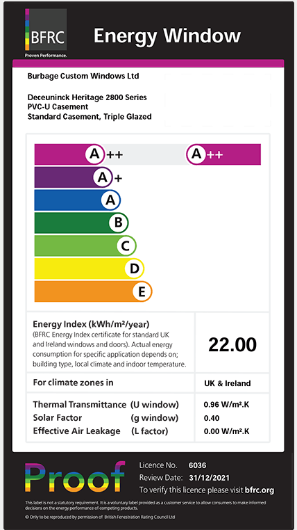

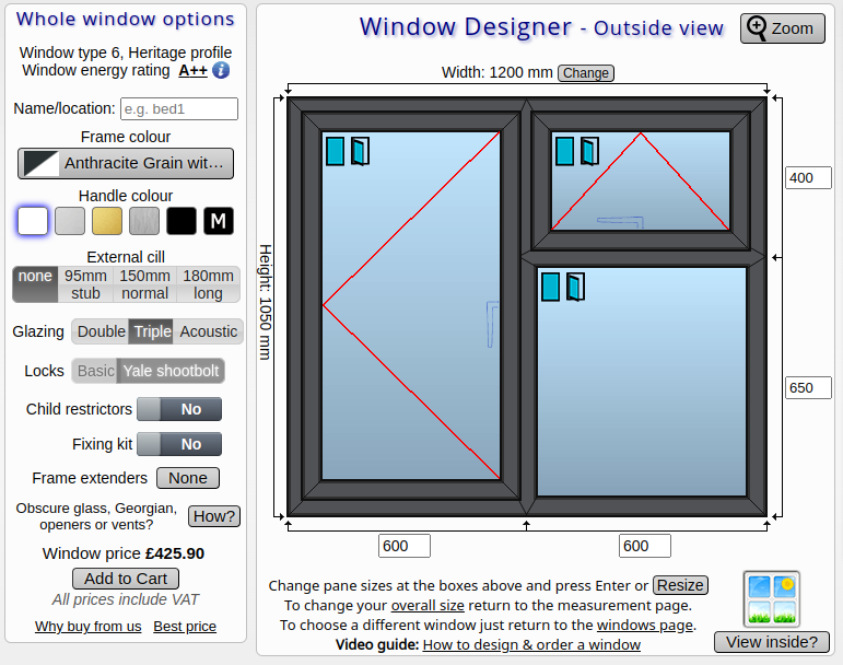

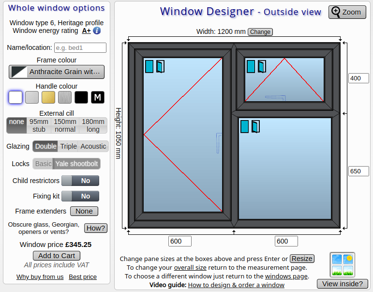

HughF Posted April 21, 2022 Posted April 21, 2022 Simple question really, looking at changing out all the windows around the place, mainly because the current ones are badly fitted (now there’s a surprise) and we don’t like the colour. It looks like I can get triple glazed for the same price, is that a worthwhile upgrade over standard double? I assume so. Looking at standard upvc from my usual, online only, supplier.
Thorfun Posted April 21, 2022 Posted April 21, 2022 if it's the same price then it seems logical to get triple glazing! there might be some considerations that other more knowledgable folk will be able to tell you about though but if the window supplier says it's fine to put in triple glazing and they're willing to warranty it then I'd say go for it!
JohnMo Posted April 21, 2022 Posted April 21, 2022 Look at whole window U value, not at the headline you get triple glazing. Have seen triple glazed advertised as 1.4, because the frames are cr*p. Insist on getting the whole window U value, they will want to give you the Ug valve which is only the glazed part of it. We have some double glazed doors and the whole U value, frames and glazing is 1.1, but they are Krypton filled. Our triple glazed are 0.74 and 0.82. A normal ok/good quality double glazed window is 1.4, triple glazed less than 1.0 for the whole window U value. 4
Thorfun Posted April 21, 2022 Posted April 21, 2022 Just now, JohnMo said: Look at whole window U value, not at the headline you get triple glazing. Have seen triple glazed advertised as 1.4, because the frames are cr*p. Insist on getting the whole window U value, they will want to give you the Ug valve which is only the glazed part of it. We have some double glazed doors and the whole U value, frames and glazing is 1.1, but they are Krypton filled. Our triple glazed are 0.74 and 0.82. A normal ok/good quality double glazed window is 1.4, triple glazed less than 1.0 for the whole window U value. see....I said more knowledgable folk would be along soon.
craig Posted April 21, 2022 Posted April 21, 2022 If it’s the same price as double, then go for it. As has been mentioned check frame values, glass value and glass thickness. Some will supply 36mm or 44mm glass units, which is Krypton filled on poor frame values to achieve the A rated window. Which is complete and utter bollocks tbh. but somehow allowed. A frame value of around 1.2W/m2K will be a decent enough window, 1.4/1.6W/m2K is likely what will be offered.

bassanclan Posted April 21, 2022 Posted April 21, 2022 Not sure how you are getting triple glazed at the same price as double glazed. I went to get a quote on the back of this discussion and its about 50% more for triple glazed using their website
HughF Posted April 22, 2022 Author Posted April 22, 2022 7 hours ago, bassanclan said: Not sure how you are getting triple glazed at the same price as double glazed. I went to get a quote on the back of this discussion and its about 50% more for triple glazed using their website Sorry, you’re correct. It was website/browser (probably the latter) troubles not updating the price shown as I toggled the glass type.
MikeGrahamT21 Posted April 22, 2022 Posted April 22, 2022 11 hours ago, bassanclan said: Not sure how you are getting triple glazed at the same price as double glazed. I went to get a quote on the back of this discussion and its about 50% more for triple glazed using their website Yeah its definitely not a free upgrade!
Thorfun Posted April 22, 2022 Posted April 22, 2022 1 hour ago, MikeGrahamT21 said: Yeah its definitely not a free upgrade! in our research for windows we found that triple glazing was around 15% more expensive than double so if their prices are 50% more then I would suggest shopping around. sounds like they're taking those wanting triple glazing for a ride.
HughF Posted April 22, 2022 Author Posted April 22, 2022 39 minutes ago, Thorfun said: in our research for windows we found that triple glazing was around 15% more expensive than double so if their prices are 50% more then I would suggest shopping around. sounds like they're taking those wanting triple glazing for a ride. 23% uplift in cost with my supplier on a 3 pane window with 1 side and 1 top opener.
CotswoldDoItUpper Posted April 22, 2022 Posted April 22, 2022 I guess the question is will they loose 23% less heat? What are the corresponding U values for the whole unit? Not just Ug.
SuperPav Posted April 22, 2022 Posted April 22, 2022 Triple glazed makes sense if one or both of the following are true: 1) They are deeper frames (at least 40mm preferably) than the usual 24-28mm double glazed 2) You need additional noise protection There are 2G systems with a lower U-Value than some headline 3G offerings. I do think we're slowly getting to the point now though where by 2030, 3G will be expected by a big enough chunk of housebuyers that if you're replacing/buying windows now anyway and the uplift from 2G is <50%, it's probably a sensible investment almost regardless of the performance benefits.
HughF Posted April 22, 2022 Author Posted April 22, 2022 1 hour ago, CotswoldDoItUpper said: I guess the question is will they loose 23% less heat? What are the corresponding U values for the whole unit? Not just Ug. 0.96 Uw
