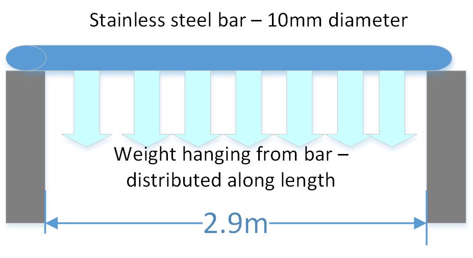

reddal Posted May 14, 2017 Share Posted May 14, 2017 (edited) Hi, I have a wine cellar about 2.9m wide - which I want to also use as a drying room for cured meats. I want to install several rods spanning the width of the room - which I'd hang all kinds of chorizo etc whilst its curing. The question is what to use for these rods - given they will only be supported at the ends - and there might be quite a bit of weight distributed along them (each needs to support at least 20kg - of distributed weight - maybe 50kg if I go mental). Something like this looks like it might do the job - but is 10mm diameter steel bar strong enough to hold the weight without deforming? If not what diameter would do the job, or is there a better solution altogether? Summary of problem : If I have to I'll work out a way to also support the bar in the middle - but it would be nicer if it didn't need that. thanks - reddal Edited May 14, 2017 by reddal Link to comment Share on other sites More sharing options...

daiking Posted May 14, 2017 Share Posted May 14, 2017 (edited) 59 minutes ago, daiking said: http://www.efunda.com/formulae/solid_mechanics/beams/casestudy_display.cfm?case=simple_uniformload#target Ok so I've even checked it by hand as I didn't believe I'd done the calculator correctly. The deflection would be so great it breaks the formula - for a 50kg load, the deflection works out as over 1.5m. A 20kg load, 0.63m. These are nonsense figures so I'm afraid you need something much better - akin to a scaffold tube over that span. That supplier does a tube, 30mm dia, 1.5mm wall thickness, which even then would have a deflection of 57mm. So, bigger tube and/or thicker wall again or build in the beam to control the ends and reduce the deflection by 80% - but then you might need to look at the stress as well as the deflection. Edited May 14, 2017 by daiking Link to comment Share on other sites More sharing options...

Jeremy Harris Posted May 14, 2017 Share Posted May 14, 2017 (edited) The thing here is to increase the area moment of inertia. Forget about the tensile or shear strength, it's irrelevant in this application. Choose a material with a high Young's Modulus (i.e. any type of steel over aluminium, or better still carbon fibre) and then choose a section with a high area moment of inertia in the axis of the applied distributed load. Hollow sections or I beams are far stiffer than solid rod for a given mass. I can run something through BeamCalc as soon as I'm back on my Windows machine if you want (BeamCalc doesn't work well on Linux/Wine). Edited May 14, 2017 by JSHarris Link to comment Share on other sites More sharing options...

Jeremy Harris Posted May 15, 2017 Share Posted May 15, 2017 (edited) OK, I'm on a machine with BeamCalc running now. Starting with the 10mm solid stainless steel bar mentioned, assuming 316 ("marine grade" stainless steel), an evenly distributed load of 196 N (20kg mass at 1g) over a length of 2.9m, with simply supported ends, then we get the following figures: Average shear stress = 1% Peak bending stress = FAIL (exceeds allowable material bending stress with no margin or SF) Maximum centre deflection = -1.871m (this is how far down the centre would bend if loaded like this and if it hadn't failed under the bending stress). Lets try the same bar but with a centre support, so we now have two simply supported beams with the load evenly distributed on both. Only one half needs to be analysed: Average shear stress = 0% (it's too small for BeamCalc to worry about) Peak bending stress = 51% (still too high, there needs to be a margin of at least 2, preferably 3 or 4 for something like this) Maximum deflection at the centre of each side = -0.0585m (each side will bend down by around 58.5mm at its centre) For sake of another example, say a length of standard 15mm stainless water pipe was used, with a centre support: Average shear stress = 0% (it's still too small for BeamCalc to worry about) Peak bending stress = 29% (acceptable, the margin is a bit over 3) Maximum deflection at the centre of each side = -0.0223m (each side will bend down by around 22.3mm at its centre) So, I reckon that a bit of 15mm stainless water pipe would be just about OK if supported in the centre. If you wanted to have a bit less deflection and a better margin, then you could look at using 22mm stainless water pipe. I'll leave BeamCalc open, just yell if you want me to run any different section through it, it only takes a few seconds. Edited May 15, 2017 by JSHarris typo - misspelt "there" Link to comment Share on other sites More sharing options...

Jeremy Harris Posted May 15, 2017 Share Posted May 15, 2017 As I had the programme open, I've just run the numbers for 22mm stainless steel water pipe, both with and without a centre support. First, with a centre support: Average shear stress = 0% Peak bending stress = 11% Maximum deflection at the centre of each side = -0.0056m (each side will bend down by around 5.6mm at its centre) Next, with a centre support but with the load increased to an evenly distributed 490 N (50kg at 1g): Average shear stress = 0% Peak bending stress = 27% (OK, the margin is over 3) Maximum deflection at the centre of each side = -0.0141m (each side will bend down by around 14.1mm at its centre) Finally, a single 2.9m length of 22mm stainless water pipe, with a 196 N (20kg at 1g) evenly distributed load: Average shear stress = 0% Peak bending stress = 86% (unacceptably high) Maximum deflection at the centre of each side = -0.18m (the centre will bend down by around 180mm under load) My view is that using 22mm stainless water pipe, with a centre support, would be best. It's readily available in 3m lengths, you can adapt stainless pipe clamps as supports, and it would be OK even with the worst case of a 50kg distributed mass hanging from it, with a reasonable margin and acceptably low deflection. Link to comment Share on other sites More sharing options...
reddal Posted May 15, 2017 Author Share Posted May 15, 2017 1 hour ago, JSHarris said: My view is that using 22mm stainless water pipe, with a centre support, would be best. It's readily available in 3m lengths, you can adapt stainless pipe clamps as supports, and it would be OK even with the worst case of a 50kg distributed mass hanging from it, with a reasonable margin and acceptably low deflection. Many thanks for your advice - that sounds ideal. Would this do the job? Thats a 21.34mm Outside Diametre x 2.11mm wall grade 304 Welded Stainless Steel Pipe - for £38 ex vat. Not cheap - but not as much as some of the options were looking like. 10 hours ago, Nickfromwales said: ? Sorted ? True - but buying nice chorizo can be expensive - look at this I saw in my local M&S recently : Thats £20 for 120g - or £167/kg! If all goes to plan I will be selling some of mine - but not for that much! 2 hours ago, PeterW said: I may have to look at this a bit more as my drying / conditioning unit is a converted wine chiller ..! Humidity is the issue and I was wondering how to get the air in and out as mine is a "proper" cellar - basically it's the old garage pit converted with with a concrete capping before having the insulation and floor cast over it...! I should get some residual heat from the ufh downwards and then the ground temps from around the sides. Have you tried home smoking too ..?? (I can see this heading OT...!) The biggest issue might be it getting too hot. The ground temps might be close to what you need (12c - or thereabouts) but if the ufh + heat given off by humidity equipment heats it a way beyond that it could be too hot. Putting cooling into that underground space might be hard... To control humidity, first you need a controller - something like this, which measures humidity and gives power to devices you attach to lower or raise the humidity. Adding humidity is easy - a small ultrasonic humidifier is fine - however you probably only need that to get initial levels up - after that the meat gives off a lot of humidity and your problem is to keep it down. Two ways to lower humidity - a small dehumidifier, or exchange some air with the outside (lower humidity space). The tricky part is anything you do to control one variable tends to muck up the other so it takes a bit of fettling to get it balanced. Happy to start a new thread on this stuff if there is interest in discussing it? I'm not an expert by any means - but I spent a year or so experimenting - so its just about possible (for once) I might not be the most clueless person here on this subject :). - reddal Link to comment Share on other sites More sharing options...
Jeremy Harris Posted May 15, 2017 Share Posted May 15, 2017 12 minutes ago, reddal said: Many thanks for your advice - that sounds ideal. Would this do the job? Thats a 21.34mm Outside Diametre x 2.11mm wall grade 304 Welded Stainless Steel Pipe - for £38 ex vat. Not cheap - but not as much as some of the options were looking like. As a single 2.9m length, with no centre support, then it's not really up to it. The numbers (for 20kg distributed evenly) are: Average shear stress = 0% Peak bending stress = 71% (not OK, as there's not a big enough margin) Maximum deflection at the centre of each side = -0.154m (the centre will bend down by around 154mm under this load) Adding a centre support makes it OK though: Average shear stress = 0% Peak bending stress = 9% (OK, the margin is over 10) Maximum deflection at the centre of each side = -0.0048m (each side will bend down by around 4.8mm at its centre) with a centre support and 50kg distributed evenly: Average shear stress = 0% Peak bending stress = 22% (OK, the margin is over 3) Maximum deflection at the centre of each side = -0.012m (each side will bend down by around 12mm at its centre) Link to comment Share on other sites More sharing options...
reddal Posted May 15, 2017 Author Share Posted May 15, 2017 1 minute ago, JSHarris said: Adding a centre support makes it OK though: Average shear stress = 0% Peak bending stress = 9% (OK, the margin is over 10) Maximum deflection at the centre of each side = -0.0048m (each side will bend down by around 4.8mm at its centre) with a centre support and 50kg distributed evenly: Average shear stress = 0% Peak bending stress = 22% (OK, the margin is over 3) Maximum deflection at the centre of each side = -0.012m (each side will bend down by around 12mm at its centre) Perfect - thanks a lot. Link to comment Share on other sites More sharing options...
