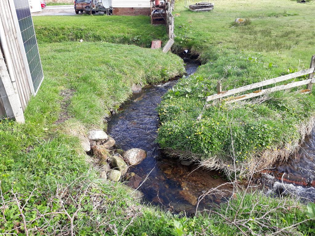

ProDave Posted April 16, 2022 Posted April 16, 2022 This is going to be a long / slow thread as it's not an imminent project but one that is on the "to do" list but I have been encouraged to start the thread anyway to get some thoughts and ideas. As many of you know a small burn runs through our garden. The plan is to experiment with small scale hydro power generation. This is more of a project / fun thing as it won't be generating significant power to make any real impact on our energy use. 2 pictures: the first has been posted before, the more or less straight run the burn takes through the garden. And the second one that has not been posted before, where the burn enters our garden As the burn enters our garden from next door, it makes a rapid S bend, briefly forming the boundary between us and next door. The fence line in the middle of the picture is the boundary, left of the fence is our garden, right of the fence is next door. Initial thoughts are to experiment with an undershot water wheel in this section of the burn for the following reasons: This is probably the fastest flowing section of the burn as it runs down a slope. The rocks in the foreground under normal flow create a constriction concentrating the flow in a narrow space. So a waterwheel just a little narrower than that gap between the rocks and the right hand bank would get the best flow. It is close to the shed for power connection for batteries / inverters or whatever stuff needed to make it work (solar PV inverter is already in that shed) It is upstream of next doors septic tank discharge that you can just see as the burn turns left as the fence starts. This burn comes up drastically when in spate, so the plan would be to mount the waterwheel essentially on a float pivoted upstream, so as the water level rises the whole waterwheel would float up.

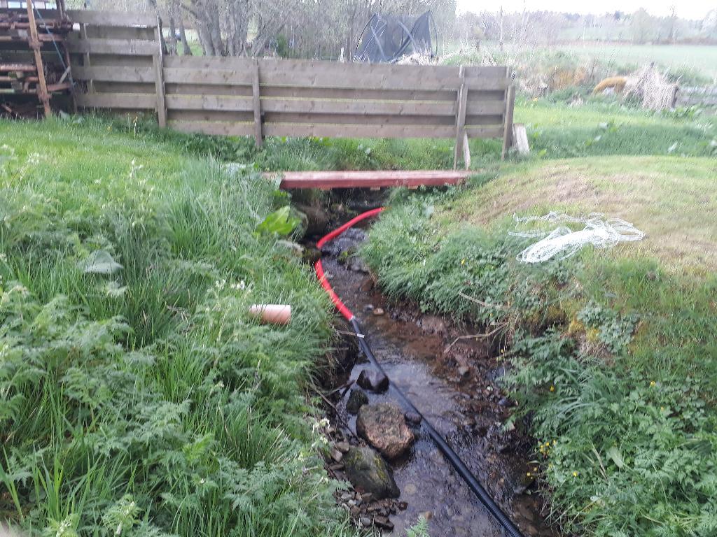

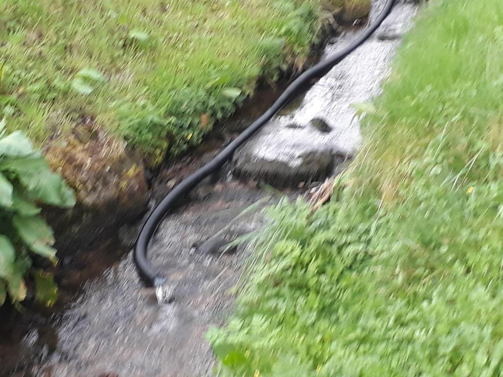

ProDave Posted May 5, 2022 Author Posted May 5, 2022 So i had some time on my hands this morning. Time for a paddle around in my wellies. The only bit of "hose" of any size I have is a left over length of mvhr ducting, about 70mm diameter from memory. So I drop that into the burn at a high point, finding a good place that is a natural bit of a "header" and roll it out down the burn. The bit of pipe I have is nowhere near long enough. So at it's lower end the water I have collected has a head of about 0.5 metre. If I extrapolate that to the full length of the burn (assuming the fall is constant, it's not far off) I would get to a little over 1m head, perhaps 1.5 if I get creative with where I take the water at the upper end. The flow rate coming out of my pipe at 0.5m head is 2 litres per second (it takes 6 seconds to fill a 12L bucket) So if I plug those optomistic figures of 1.5m head and flow of 0.002 m3/s into here https://www.engineeringtoolbox.com/hydropower-d_1359.html I get 29 watts. That's before you even think about generator efficiency. Now obviously if i could find a nice long length of some form of hose that was a much larger diameter, I might get better flow rate, or even 2 lengths of this pipe might bet me up to just over 50 watts. Clearly this is never going to be a serious amount of power and is in the "fun" category if ever I actually do anything with it. About the only thing I could say is perhaps catching and piping water like that might work with a breastshot water wheel at the bottom.
SteamyTea Posted May 5, 2022 Posted May 5, 2022 On 05/05/2022 at 11:08, ProDave said: Now obviously if i could find a nice long length of some form of hose that was a much larger diameter, I might get better flow rate, or even 2 lengths of this pipe might bet me up to just over 50 watts. Expand A constant 50W could be useful. But 100W would be very useful. 2 kWh a day is my non E7 usage.

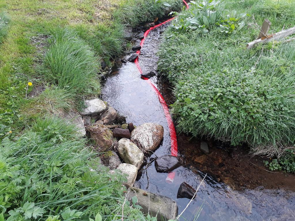

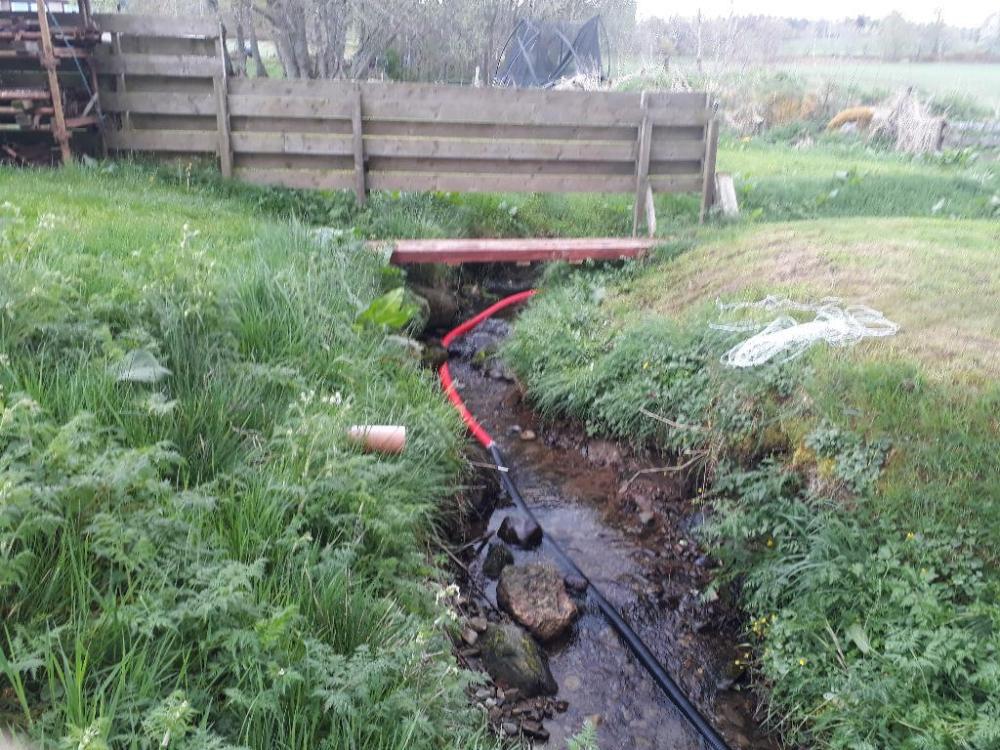

ProDave Posted May 6, 2022 Author Posted May 6, 2022 So I have done some more. I remembered where there was a spare coil of black electrical ducting, not ideal but good for my test work. So we have: Spare length of mvhr ducting collecting the water at a bit of a natural header pond right where the burn enters my land. that goes round the S bend in the burn. Where that runs out, it joins to the black electrical duct, a bit smaller and a tight fit inside the mvhr duct That black duct then runs as far as it reaches which is only a couple of metres short of where the burn departs our land At the end of that we still get most of the flow I had before, perhaps 6.5 seconds to fill the 12L bucket so say 1.8 litres per second. The head is now 1.4 metres So putting that into the page linked before gives a grand total of 24 watts I bet you would be lucky to actually get 15 watts of electricity from that. The only way to do this I think is is to treat is as a fun project and make a large water wheel for the water to run over as a garden feature and any power you get from it is purely a bonus. Or find a cheap / free very much larger length of pipe to increase the flow rate. 1

ProDave Posted May 6, 2022 Author Posted May 6, 2022 I think what this has done is show how much water you need and how much head to get a useful amount of power. My initial thought was just an undershot water wheel at pretty much that constriction in picture 1 above where the red pipe presently starts from. Although the flow is fast there, the same equations apply and the power you get out is proportional to the flow in litres and the head it falls. An undershot water wheel at that point would deliver in minute amount of power because the head is only what it self creates to turn it.. But yes you could put a whole load of them along the burn. I won't just leave the pipe like that, it will be buried somehow. I have one low power candidate motor so I might just rig up a "Blue Peter" water wheel and try flow I have from that pipe and see what I actually get. It seems odd that 2L per second at 1.3m head only generates about 30W. Why do I feel if I was asking the question, what power of pump do I need to pump water uphill by 1.3m at a flow rate of 2L per second, the answer would probably be a lot more than 30W?
