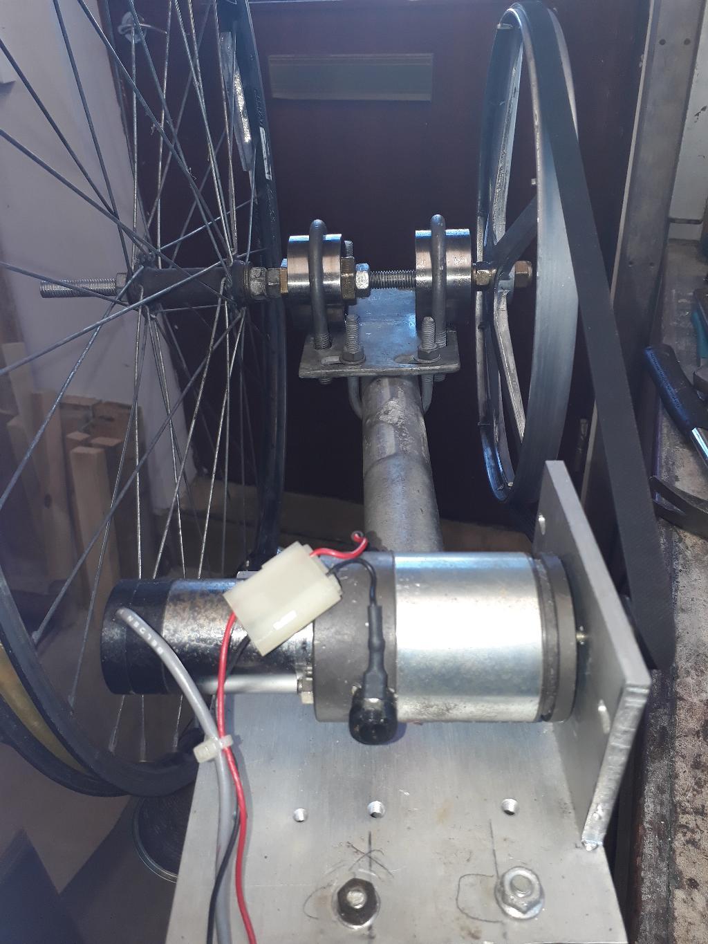

So I have been tinkering with my collection of "stuff that will come in handy one day"
Anyone reading beyond this point has to make a promise not to laugh, at least not out load.

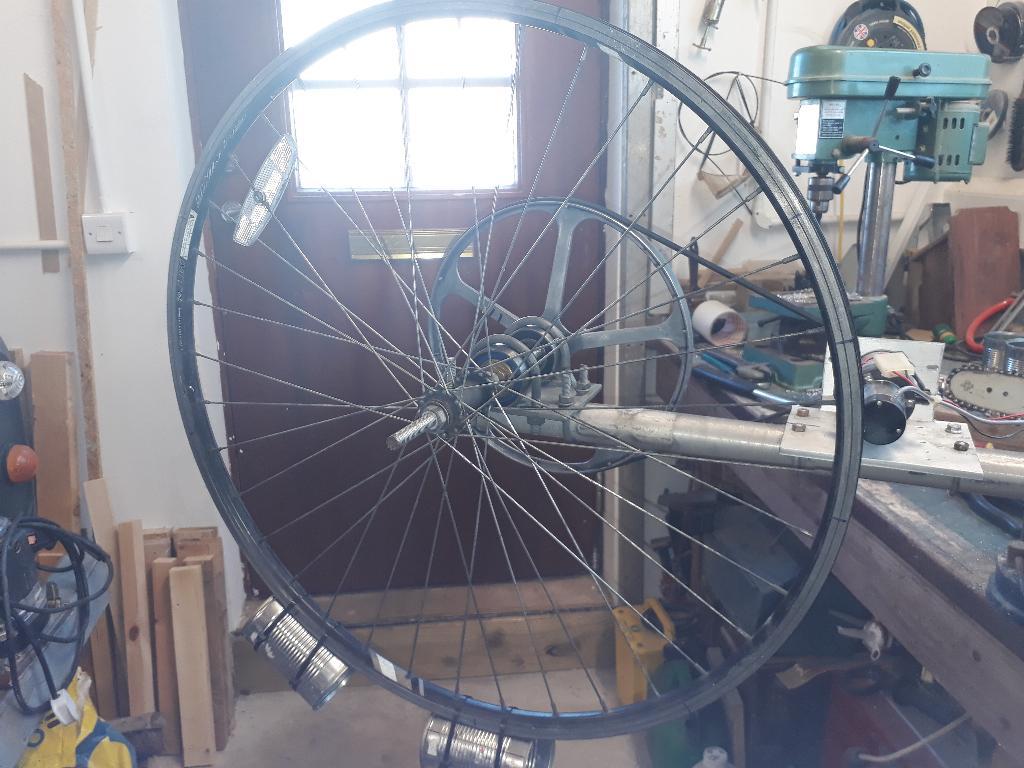

So put together a test water wheel entirely from bits you have to hand:

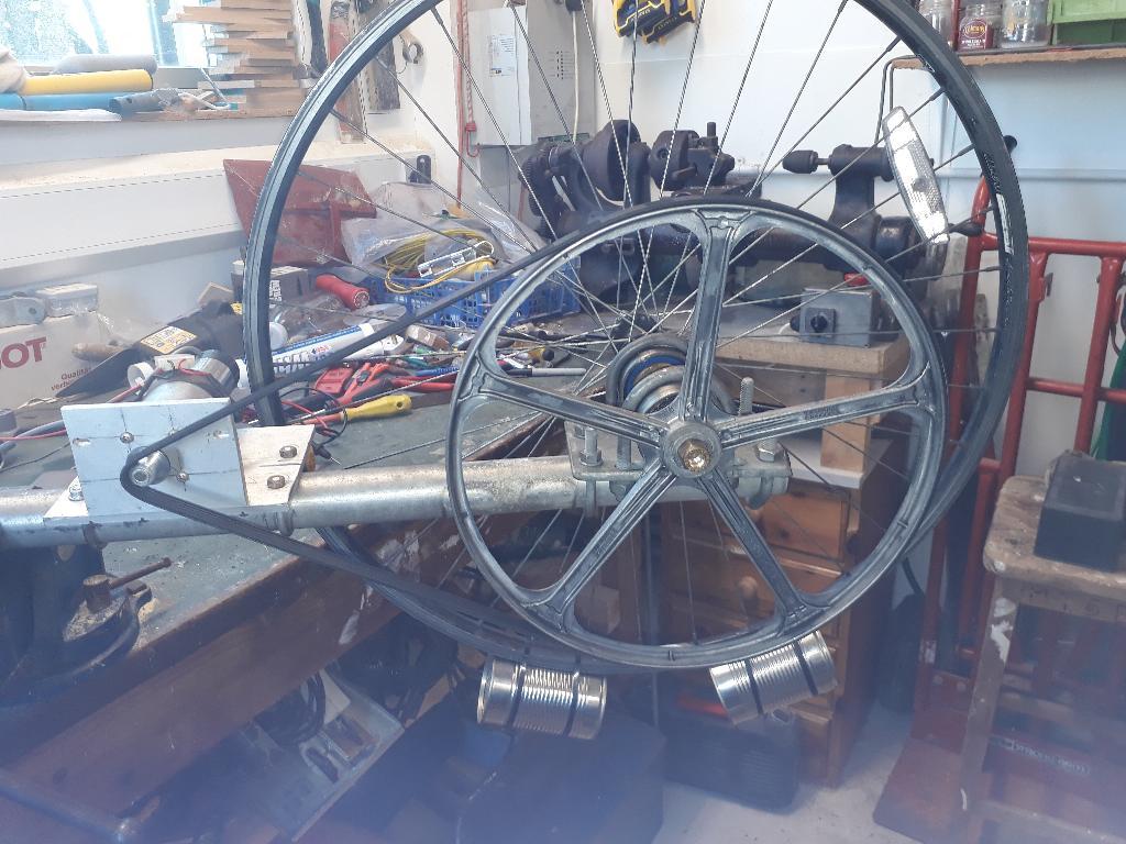

The business side, that will collect the water.  Yes that is a bicycle wheel, and the trial set of "buckets" that will go around the outside to collect the water and so cause it to rotate, are indeed baked bean cans.
Looking at the other side, that is the pulley and belt from a dead washing machine.  It is driving a little DC servo motor as my trial generator candidate.  Initially I tried the pulley from the washing machine motor, but that only gave a 9:1 ratio, I felt it wanted more, so I made a very much smaller pulley for the servo motor and I have got to about a 17:1 ratio.
The whole lot is mounted to the end of a length of aerial pole.  The shaft is a length of M12 threaded rod and the bearings are old idler bearings left over from a previous cam belt change on my car.  They mount to the aerial pole with a heavy duty aerial pole clamp set.
The proposal is to mount the aerial pole pivoted about it's mid position giving somewhere for a counter weight and easy height adjustment.

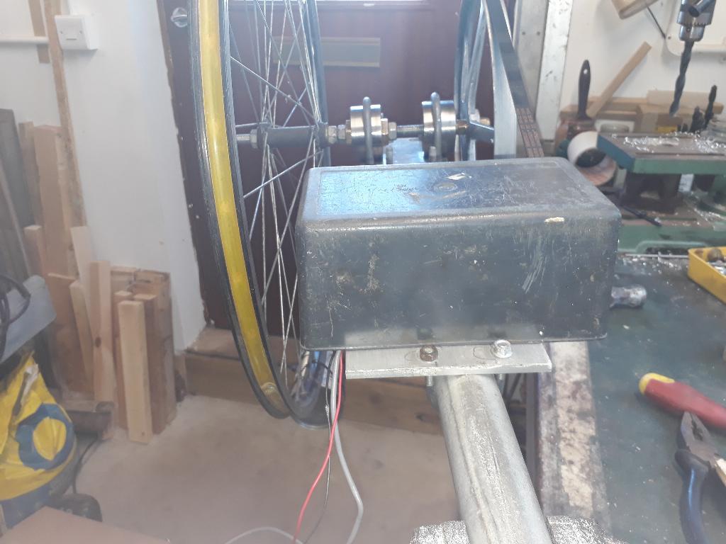

And since the motor is right in the "splash zone" it will have a plastic cover to keep it a bit dry
A similar one will will also be fitted over the bearings
We need to eat some more baked beans before there are enough cans to give it a water trial.

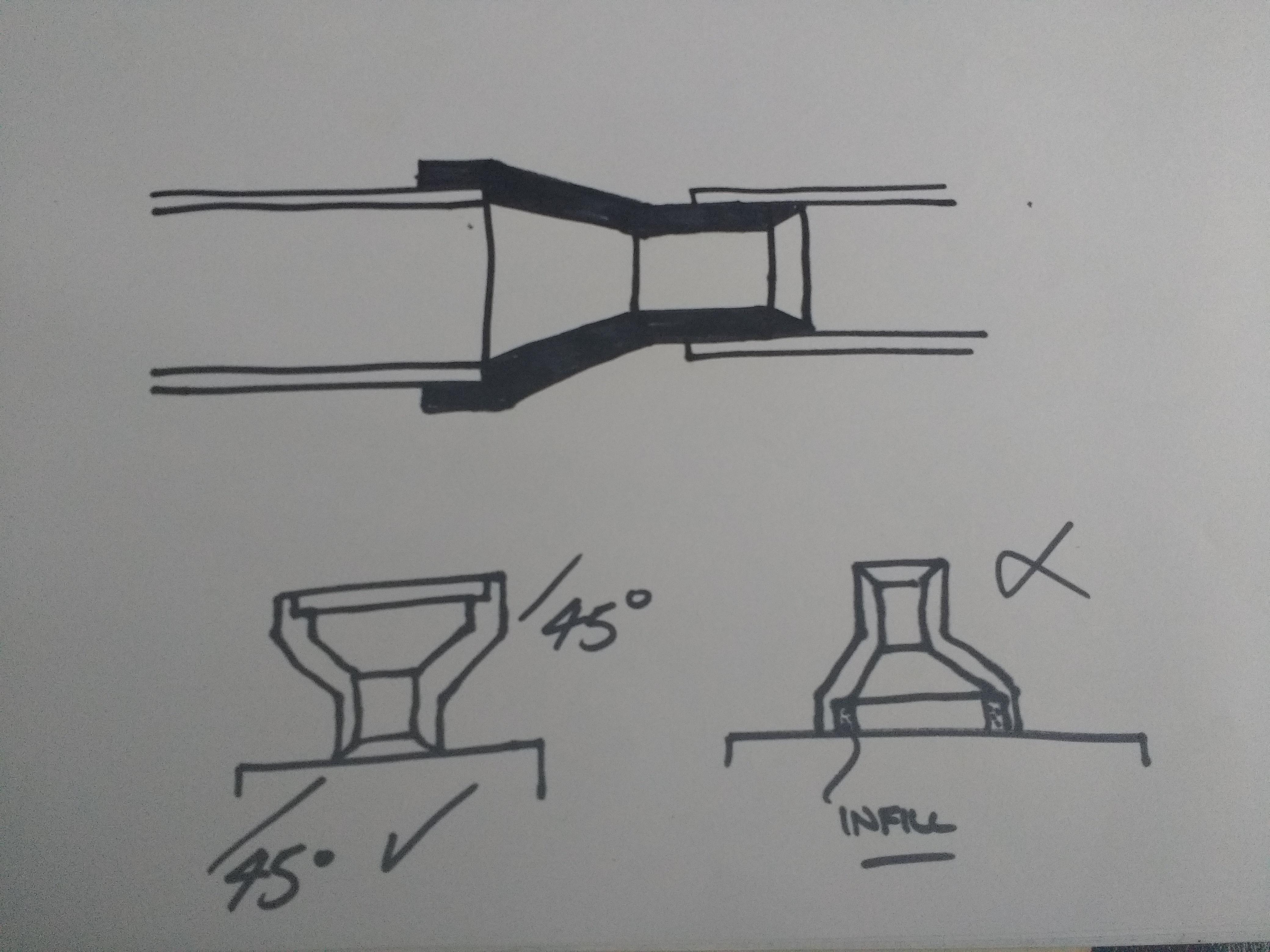

Interesting stuff, no idea how to do it but I guess what’s really needed is a smooth  reduction in diameter to stop turbulence at the “steps” 🤷‍♂️.
Go out and nick a traffic cone.
...may have had a little drinky but you get the drift. 45deg or larger is good.
Could print it standing up with no supports and no sharp corners to create turbulence...
