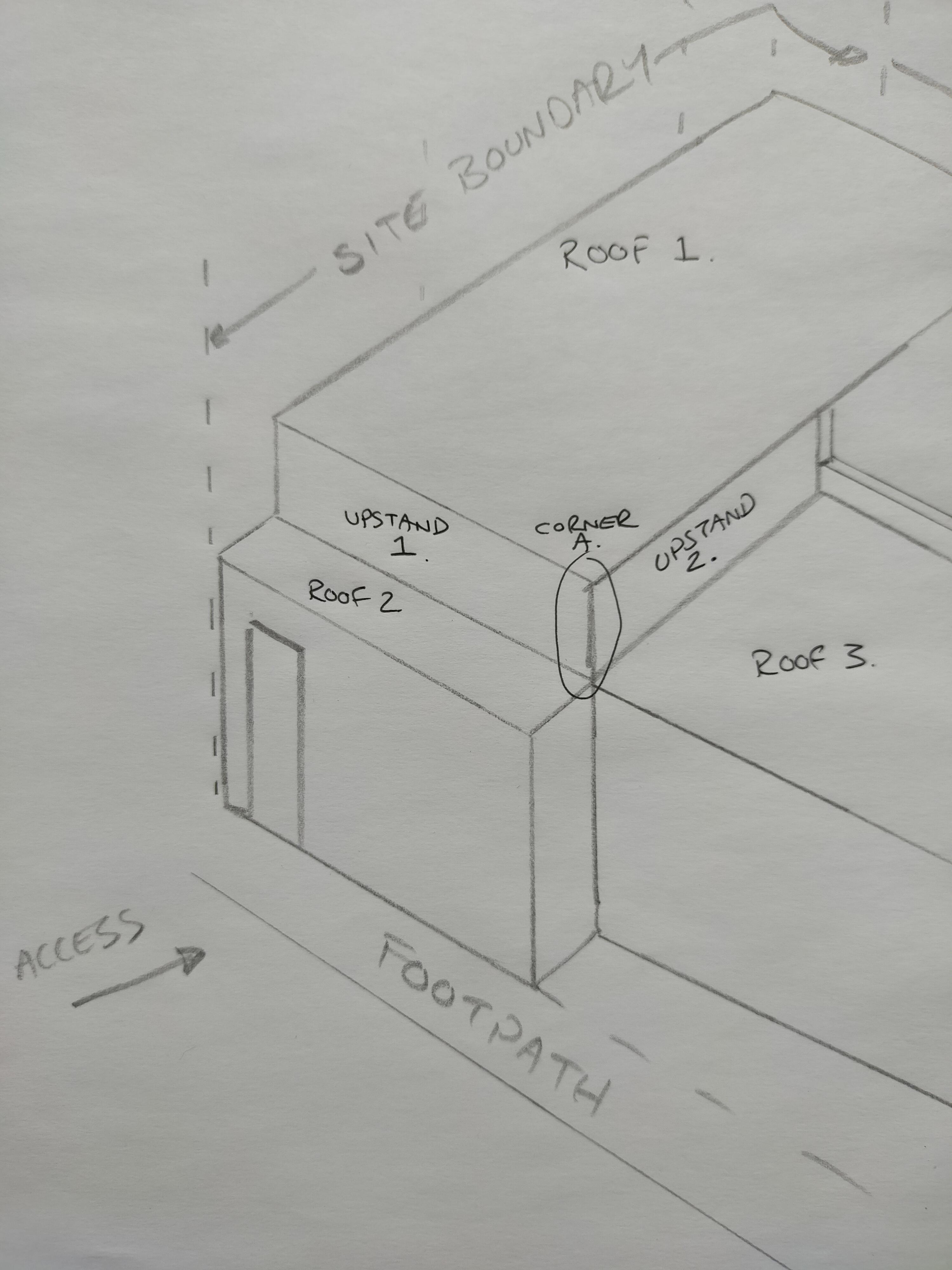

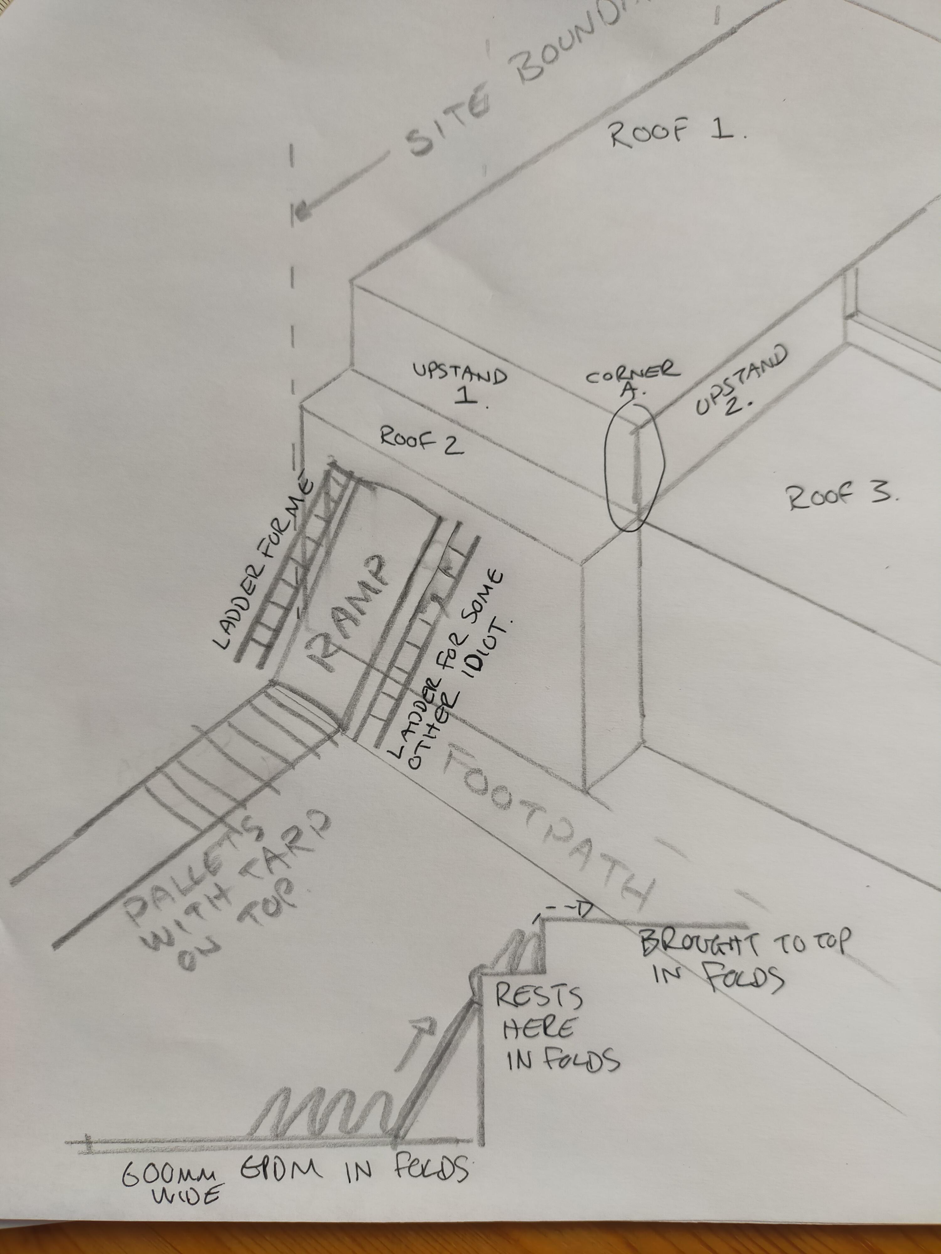

Tony K Posted April 14, 2022 Share Posted April 14, 2022 Afternoon all. I will need to move 2x 100kg rolls of epdm up on to the roof areas of my SB. The set up is as per the sketch. Roof 2 and 3 are approx 2.5m from ground level, roof 1 another 710mm more. I have seen folk run a pole through the roll, and carry it up using ladders, but not for rolls of this size and weight. A genie lift could be an option, but only in getting the roll up, not over and across into position. Any tips?! I have considered unrolling the rubber on the ground so it can be fed upwards gradually, but haven't seen this done before. Thanks Link to comment Share on other sites More sharing options...
Conor Posted April 14, 2022 Share Posted April 14, 2022 Telehandler is the obvious one. Either that or precut the rolls in to roughly the lengths they need to be. What's your existing scaffolding / access setup? Photos? Link to comment Share on other sites More sharing options...

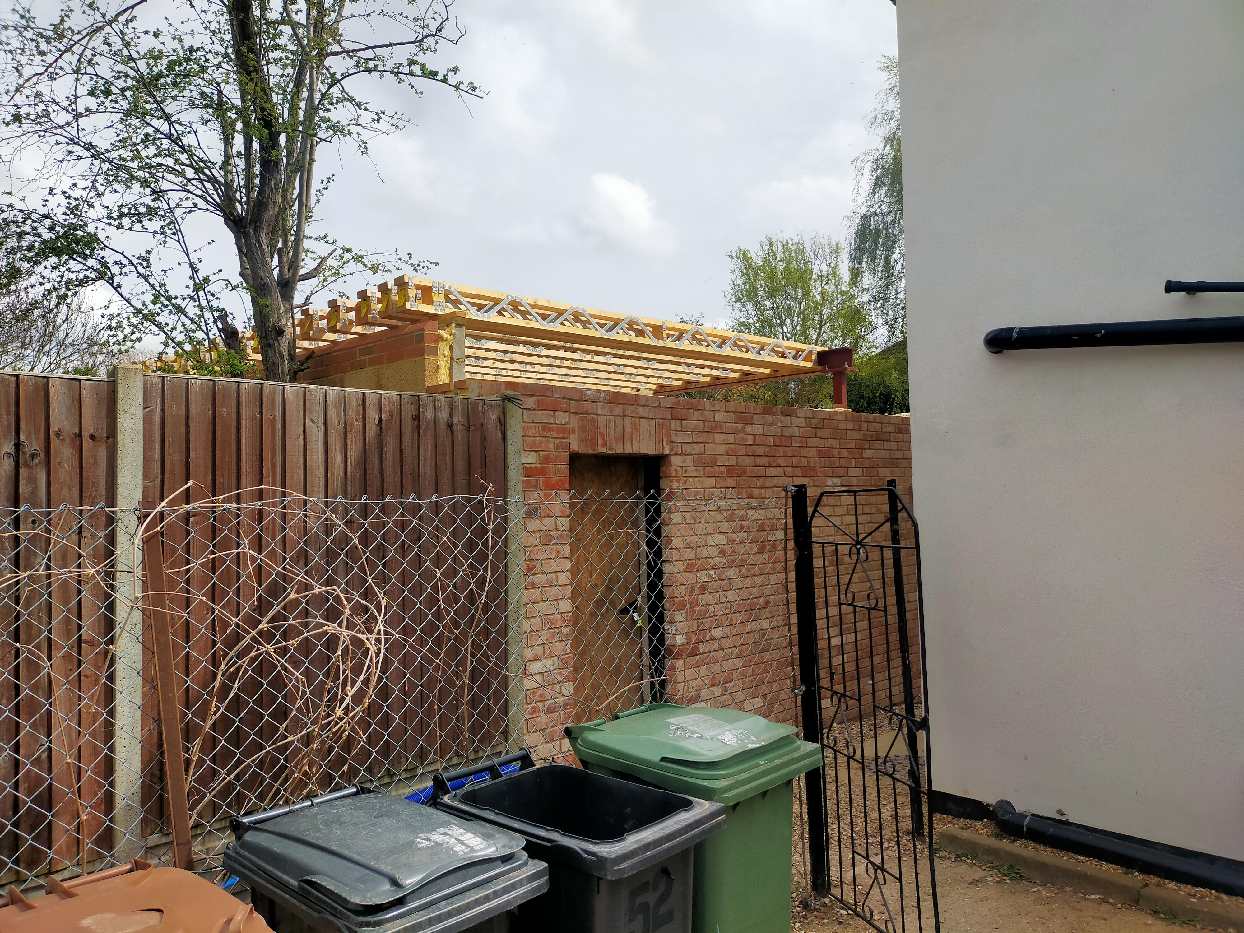

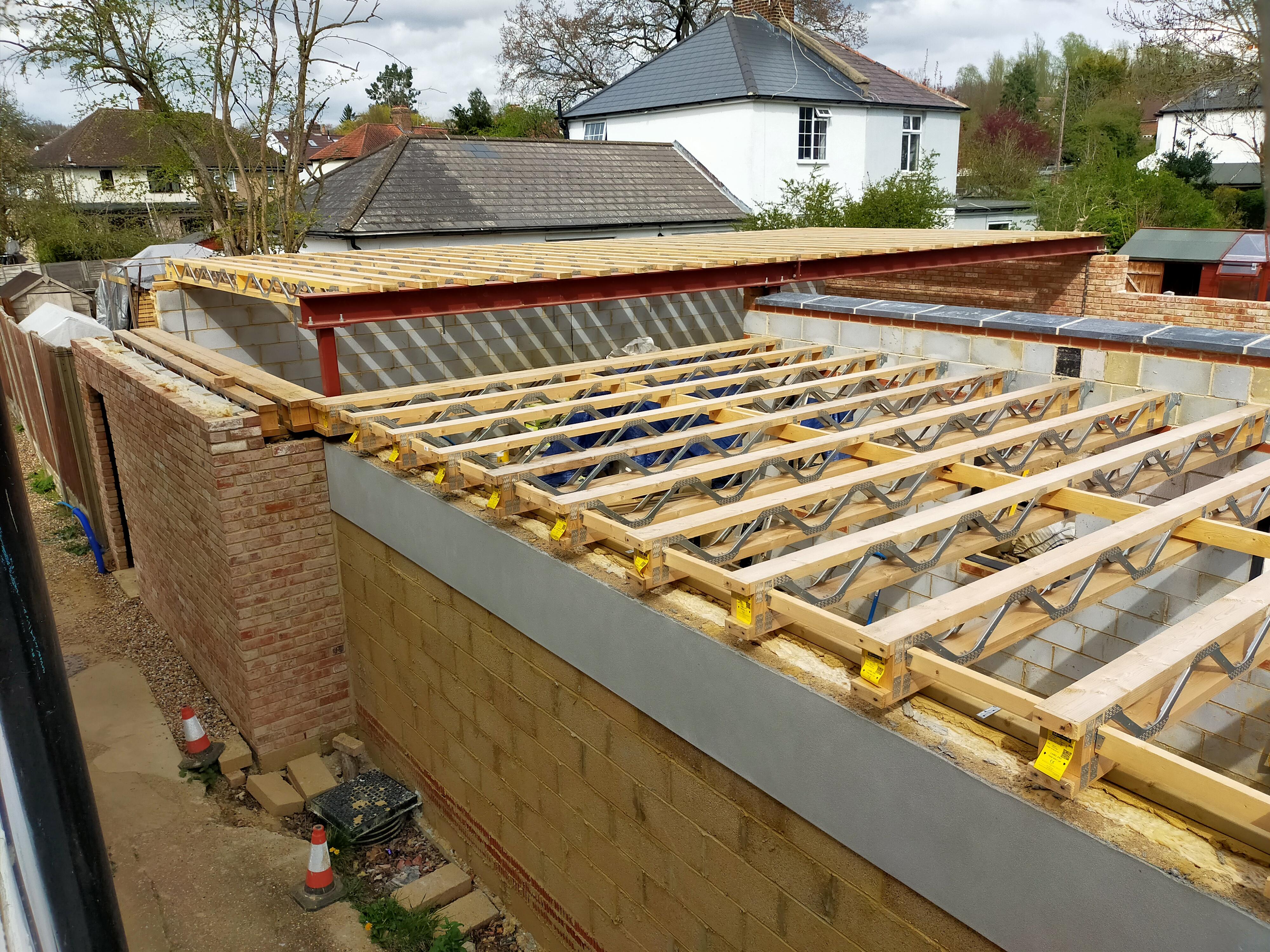

Tony K Posted April 14, 2022 Author Share Posted April 14, 2022 Hi @Conor The rubber is coming pre-cut to size already, and is still 100kg. Photo below... Link to comment Share on other sites More sharing options...

Tony K Posted April 14, 2022 Author Share Posted April 14, 2022 11 minutes ago, markc said: Genie hoist or similar to get onto the roof then roll them into place. if you have a local tree surgeon who has a spider cherry picker (with hoist attachment wink wink) get them to lift them into place I could get a genie placed parallel alongside roof 2 and 3 (in my sketch above), then possibly lift the roll up so that it sits on the genie arms, and is level with the roof area, but then I've got to get the roll across from the genie to the roof somehow, as a genie doesn't swing round. Link to comment Share on other sites More sharing options...
Tony K Posted April 14, 2022 Author Share Posted April 14, 2022 The biggest roll (for roof 1) is about 12m long and 5.5m wide. Perhaps I could unroll it on the ground, then fold it over so that it is 12m long and about 60cm wide, then feed it up into position bit at a time? Anyone ever tried this? Link to comment Share on other sites More sharing options...
Bitpipe Posted April 14, 2022 Share Posted April 14, 2022 2 minutes ago, Tony K said: The biggest roll (for roof 1) is about 12m long and 5.5m wide. Perhaps I could unroll it on the ground, then fold it over so that it is 12m long and about 60cm wide, then feed it up into position bit at a time? Anyone ever tried this? I'd be very wary of unrolling on ground incase it got damaged. While 100kg is heavy, it's liftable with the right equipment and help. An effective way of moving a load horizontally is to use two layers of material that can slip over each other. Ply might work but would be limited to 2.4m length - would probably be suitable for the base layer. Maybe use an unrolled length of strong PVC membrane or geo-textile fabric for the top layer? I can envision a ply ramp with a lip (to stop the EPDM rolling off) and then drape the top drag layer over it. Tele handle the EPDM onto it, secure the top layer around it and heave it up into position. Does that make sense? Link to comment Share on other sites More sharing options...
Onoff Posted April 14, 2022 Share Posted April 14, 2022 26 minutes ago, Tony K said: I could get a genie placed parallel alongside roof 2 and 3 (in my sketch above), then possibly lift the roll up so that it sits on the genie arms, and is level with the roof area, but then I've got to get the roll across from the genie to the roof somehow, as a genie doesn't swing round. Something like..... .....strap a couple of 4.8m scaffold boards atop the Genie arms, parallel to the roofs. You need to get the load dead centre. Lay 3 decent ratchet straps across the boards. Handball the roll onto the boards so if 5.5m you'll only have 350mm overhanging each end. The ratchet straps will be under the roll. Lift to height. Ideally a tad higher than the roof. Next strap 3 more boards from the "Genie" boards, to the roof. Ladder job to get up there. Roll off down the slope and watch it go straight across the roof and off the opposite edge! 😂 1 Link to comment Share on other sites More sharing options...
Tony K Posted April 14, 2022 Author Share Posted April 14, 2022 27 minutes ago, Bitpipe said: I'd be very wary of unrolling on ground incase it got damaged. While 100kg is heavy, it's liftable with the right equipment and help. An effective way of moving a load horizontally is to use two layers of material that can slip over each other. Ply might work but would be limited to 2.4m length - would probably be suitable for the base layer. Maybe use an unrolled length of strong PVC membrane or geo-textile fabric for the top layer? I can envision a ply ramp with a lip (to stop the EPDM rolling off) and then drape the top drag layer over it. Tele handle the EPDM onto it, secure the top layer around it and heave it up into position. Does that make sense? I think I understand. You are proposing dragging the rubber up a ramp, but designing that ramp so as to make that dragging easier, as the top layer of the ramp will move with the rubber roll as it is dragged up. I don't think this is so far removed from my idea, if I expand my proposal to include something protective for the rolled out rubber to rest on. I could set out a series of pallets with tarp or something on top, lay the rolled out rubber on them, have a ply sheet ramp leading up from the ground to the smallest roof section, and ruffle the rolled out rubber up so that it is not a dead weight when pulled from one end. Then two of us carry either end of the 600mm wide rubber up onto the first roof in sections. Hang on, I'll do a crap drawing. Link to comment Share on other sites More sharing options...
Tony K Posted April 14, 2022 Author Share Posted April 14, 2022 Here is my revised idea! Link to comment Share on other sites More sharing options...
Tony K Posted April 14, 2022 Author Share Posted April 14, 2022 24 minutes ago, Onoff said: Something like..... .....strap a couple of 4.8m scaffold boards atop the Genie arms, parallel to the roofs. You need to get the load dead centre. Lay 3 decent ratchet straps across the boards. Handball the roll onto the boards so if 5.5m you'll only have 350mm overhanging each end. The ratchet straps will be under the roll. Lift to height. Ideally a tad higher than the roof. Next strap 3 more boards from the "Genie" boards, to the roof. Ladder job to get up there. Roll off down the slope and watch it go straight across the roof and off the opposite edge! 😂 There does seem a relatively high level of potential comedy here! If I follow my sketch above, I am only lifting the weight of the section between the ground and the roof at any one time, rather than the whole weight. I think. Link to comment Share on other sites More sharing options...

Tony K Posted April 14, 2022 Author Share Posted April 14, 2022 If the EPDM comes on a central cardboard roll, I could run a scaffold pole through the centre of the roll, then (having placed the roll adjacent to the wall) place something under each end of the pole, allowing it to rotate. I then take the end of the rubber and feed it up onto the roof (as per my sketch), like unrolling a giant toilet roll, except upwards. That could work? Link to comment Share on other sites More sharing options...

Bitpipe Posted April 14, 2022 Share Posted April 14, 2022 30 minutes ago, Tony K said: Here is my revised idea! Would work but you risk damaging it as it gets pulled up and snagging on something. I'd wrap the roll in a protective cover and haul it up the ramp you've made. Two people should easily be able to lug 50kg each. Link to comment Share on other sites More sharing options...

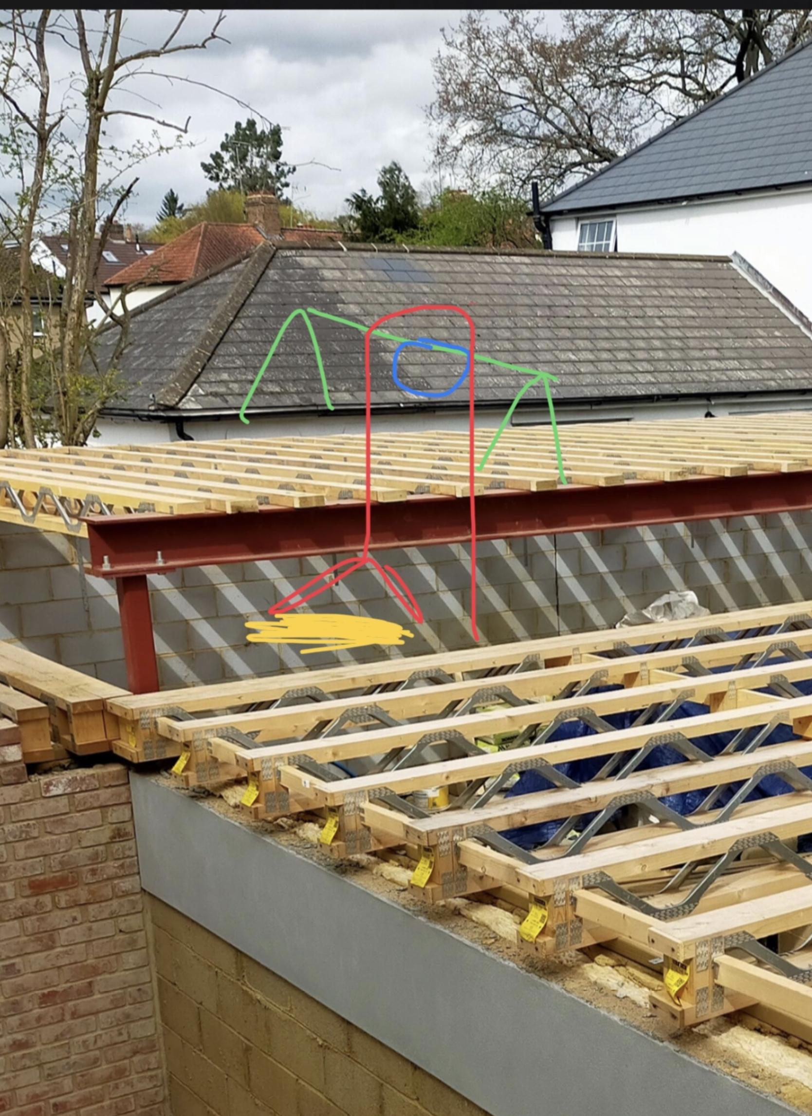

Iceverge Posted April 14, 2022 Share Posted April 14, 2022 Assuming you can get the EDPM roll into the space below the joist... I would make up a simple beam above the joists supported at both ends. (green) Then using your builders block ( blue) hoist the edpm (yellow) through the beams turn it through 90 degrees and land it on the joists. To do the lifting merely attach a counterweight to the other end of the lifting rope. Ideally maybe 4*25l drums. Stick the hose pipe in and watch the lifting happen all by itself. No lugging required! Link to comment Share on other sites More sharing options...
markocosic Posted April 14, 2022 Share Posted April 14, 2022 Getting these up to the low level roof (roof 3) looks easy. - Put them on the floor under the high roof - Straps on the ends of the roll (good bit of wood through it; straps secured to the wood) - Straps over the joists - Pull 50 kg each end of the strap (one end at a time and secure it if billy no mates) - Swing it through the gap under the RSJ onto roof 3 when it's high enough Do that for both rolls. - Fashion ramp from roof 3 to roof 1 - Drag it up the ramp from roof 3 to roof 1 using straps What am I missing here? Link to comment Share on other sites More sharing options...
Tony K Posted April 14, 2022 Author Share Posted April 14, 2022 Leaving aside whether the joist can take being used in the ways suggested above, the ply boards that will sit under the rubber need to be installed to some extent or I'll have nothing to rest the rubber on when I get it up to roof height. The normal way is to have all the boards fixed in place before getting the rubber up there, but I can look into winching or pulleying it up. Thanks Link to comment Share on other sites More sharing options...
