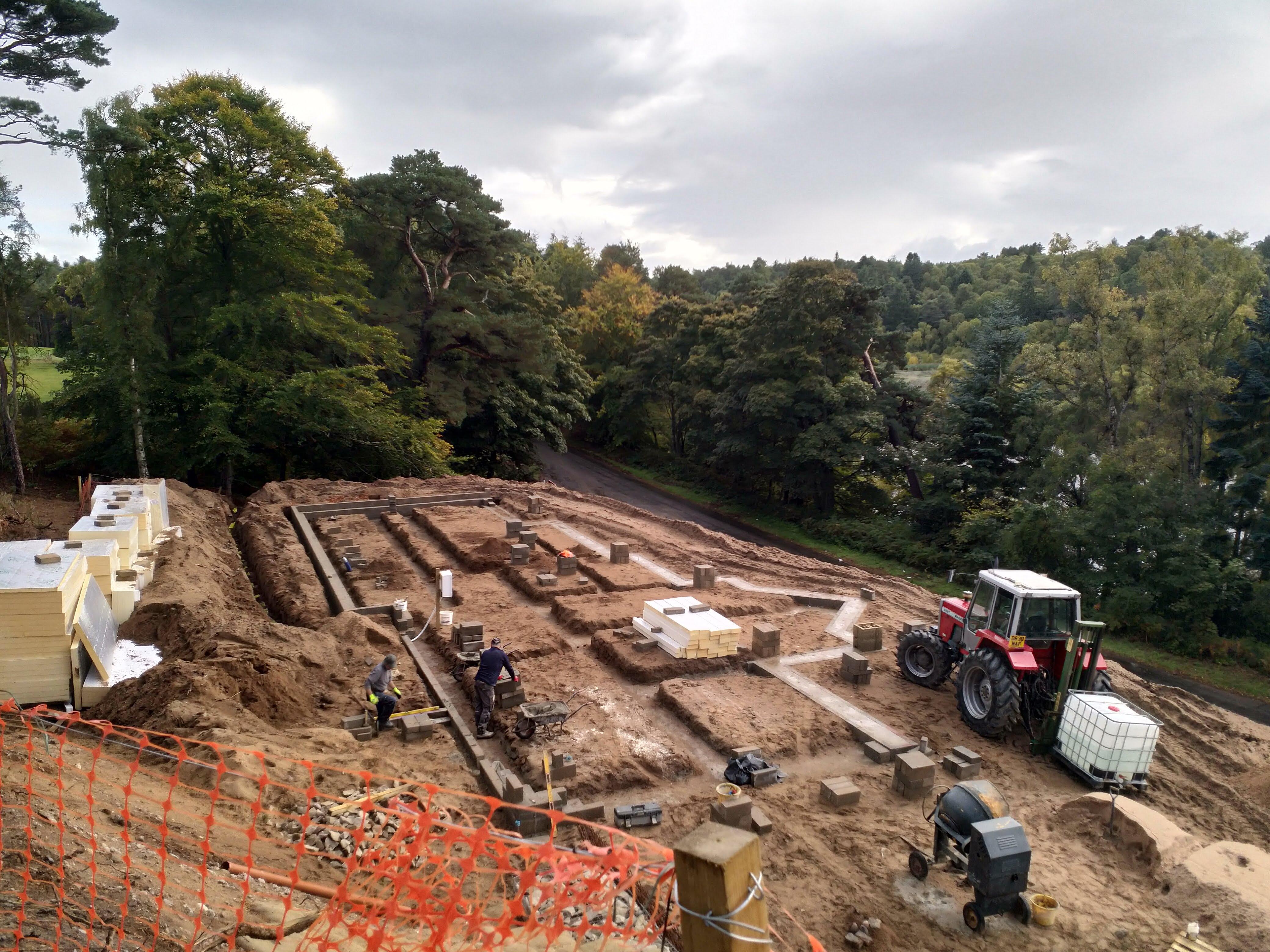

JohnMo Posted April 9, 2022 Posted April 9, 2022 I stored our floor installation in the open weighted down with concrete blocks, spent around 2/3 months like that. Was more worried about it be stolen, but two piece were blown into the trees one windy night and wrecked. Cement get it in plastic bags.
BadgerBadger Posted April 10, 2022 Author Posted April 10, 2022 10 hours ago, JohnMo said: I stored our floor installation in the open weighted down with concrete blocks, spent around 2/3 months like that. Was more worried about it be stolen, but two piece were blown into the trees one windy night and wrecked. Nice looking site! That's just what I'm thinking - did you keep it dry? I'm hoping it's bulky enough to not be too nickable. We're using a pre-mixed lime mortar for part of the build, which is giving me the most worry as its expensive and only comes in paper bags!
