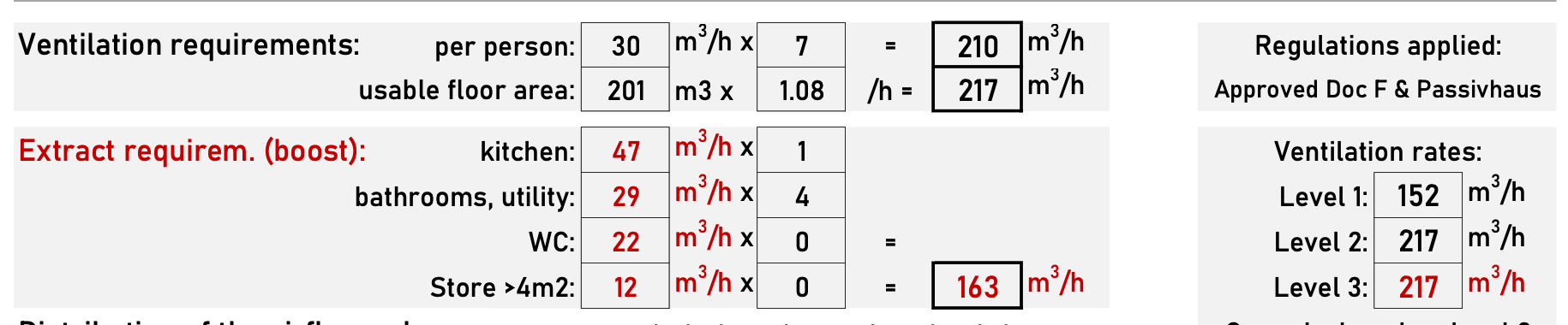

One company suggested Zehnder Q350.
Their calculations, and how they arrive at it below:
1836785638_Screenshot2022-04-09at14_03_52.thumb.png.2b1e7c8075b3310f1b162e2ba44c04d4.png
Funnily enough, another supplier suggested Q450, and yet another Q600! That is pretty much full spectrum of ranges. One could almost guess that any unit "will be ok"...

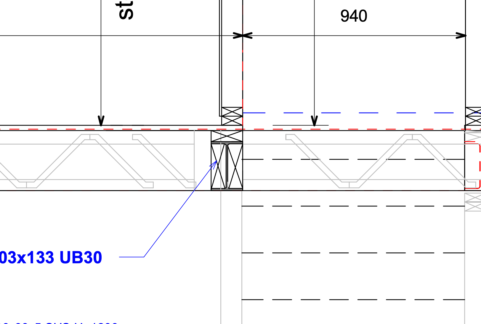

A brief idea of our plans and steels:
Removal of packing above steel as seen below?
1931072193_Screenshot2022-04-09at13_45_35.thumb.png.b8783ac5a72135a095be959ed74b7b02.png

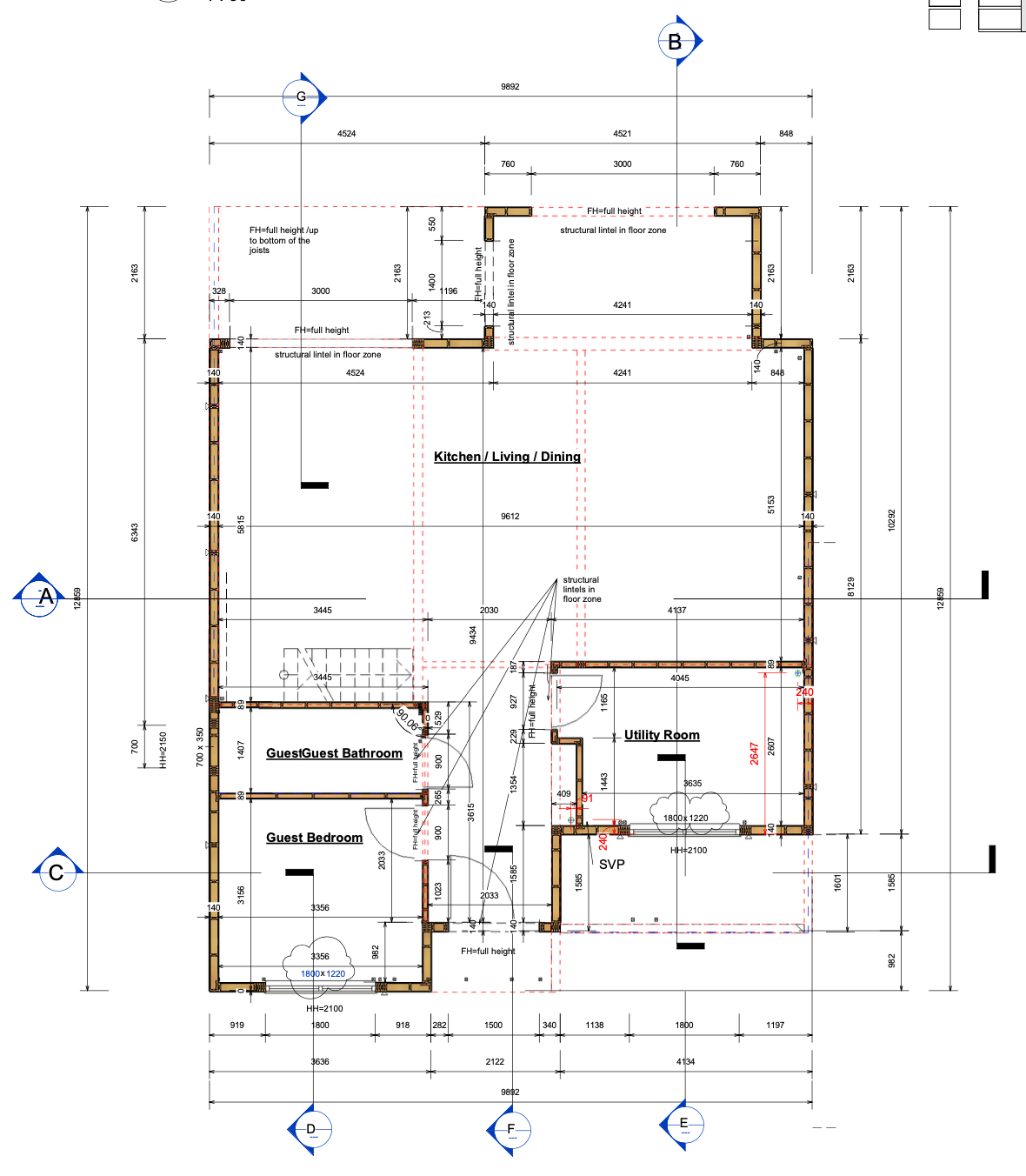

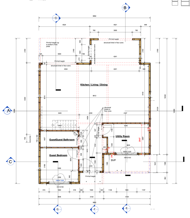

Plans:
Showing ground floor, with double dotted line where steels in the floor zone above:
742357220_Screenshot2022-04-09at13_48_41.thumb.png.61dcc889db5e7df3796bad7e7ec9c2be.png

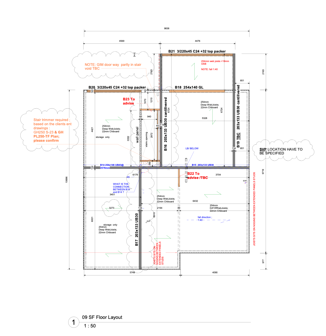

First floor plan (with steels clearly shown on the floor level of this floor, in the floor zone):
2066255298_Screenshot2022-04-09at13_49_45.thumb.png.73bbf12351d6faaffe5ded9e95442daf.png

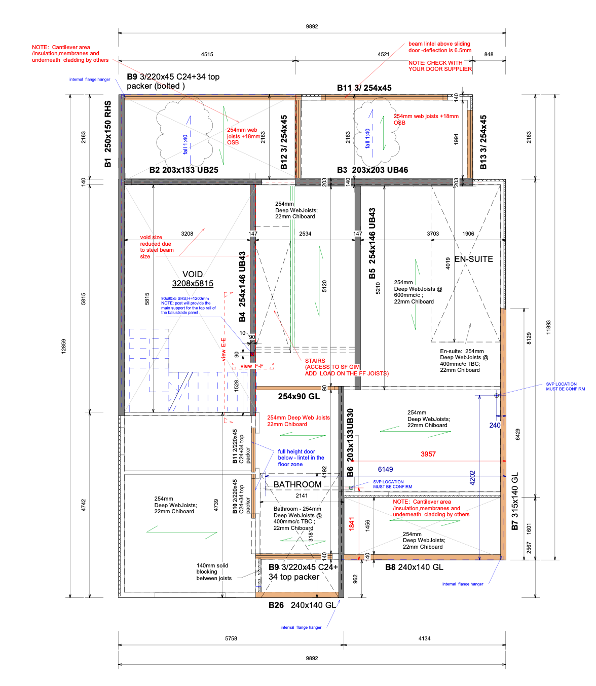

Second floor plan (with steels clearly shown on the floor level of this floor, in the floor zone):
1485386586_Screenshot2022-04-09at13_50_24.thumb.png.c236e15b111d1143532e0c5944546a5a.png

Definitely try and plan this before construction. Even if changes are needed onsite it's much better to have a scheme in mind before everything goes up.
Do you know where the MVHR itself will go?
Try and think about the problem in 3D. Steels block horizontal runs, but you can get a long way by running ducts horizontally on floor 2 and then dropping down a floor where needed (maybe running horizontally on floor 1 before dropping down again.) A loft installed MVHR has several downsides, but can make this sort of vertical access into very large open plan areas much more convenient.
If you have ComfoCool it requires the higher boost mode of the Q600 so that maybe why some installers upsized it

An option could be to put in a suspended ceiling up to 100mm below the metal web joists to take services. Depends on your ceiling heights and whether you can afford the space.
Have the posijoists been designed yet? You may need to go larger for the spans, perhaps 253mm, and then there might be space above or below the steel, between the webs.

I have only done one of these.  It was a small house but still on the limit of what the unit (Vent Axia Sentinel Kinetic) could manage.  Maybe your place would work well with 2 units and fewer steelwork clashes?
Obviously the more restricted the ducting, the higher the pressure needed to push the air through, the harder the units need to work and the noisier the system.
You will need to agree any steel necessary penetrations with the SE and get these made during fabrication, rather than on site.
+1 to this. You cannot afford to delay this preparatory design work work....
It must be possible for you to make a preliminary plan of the ducting lay-out and this will highlight the locations clashes where ducting clashes with your steel work.  I specified 100mm penetrations for ducts and 50mm penetrations for cables and pipes - see photo
In practice, there will not be that many penetrations required. Penetrations in steelwork need a SE review and may need stiffening detail, so it is important to have this work completed in the fabrication shop. It is not something that can be easily done at site!!
Use this information to instruct your TF/steelwork supplier to provide penetrations at these locations.
Do the same thing for cable and plumbing layouts and arrange for penetrations for these services as well.

- how do I calculate the unit size? If Q350 flows 350m3, supposedly that is at a certain pressure? What pressure to aim for? And how do I calculate those?

Generally the bigger the unit, the less it has to do, so is used at the low end of its performance curve, so for a given duty will be more quite.

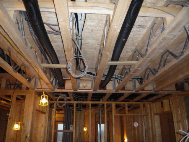

Listen to @HerbJ. We built our houses at the same time with the same TF and many of the same trades.
I did not specify steel penetrations and only managed to get my MVHR ducts routed by the skin of my teeth and pure luck that a few gaps were available - even I needed to go the long way round for a few routes which was less than optimal.
Also had to use some very creative thinking on 110mm fouls and bath/shower wastes. Wider bore water pipes, especially insulated runs will need similar consideration.
Cables should be fine as you will likely have a small service void between the steel and plasterboard beneath.

...and remember that holes in steels need to be positioned wrt the pozijoists too so there could be a to-and-fro between the pozi designer and the SE (if they're different people)
I just asked our TF guys to design in a couple of holes in each steel and had no problems routing the services from that point on.

Designing 2 such projects atm, so have specified the steel penetrations centres to be at 400mm recurring so the posi joists can drop in retrospectively, manipulated to avoid these locations. The joists will be wiggled about to suit during installation, so best to discuss this with the joist designer as well. Remember that posi joists will be in joist hangers in most instances ( not all ) so you will lose 70mm of each 400mm centre void with the wing of the hangers, so that can mean only 2 ducts per joist void.
Can be done with most at 400mm c’s and one or two strategic 600mm ‘service sections’ that has beefier joists allowed either side to compensate.
I never spec posis at 600mm centres tbh as most designers will fall to the default deflection allowances and beam count to give the best quote, often leaving deflection factored in at north of 12mm of movement allowed. NO THANKS! 👎. I like a structural floor not a reasonably priced trampoline.

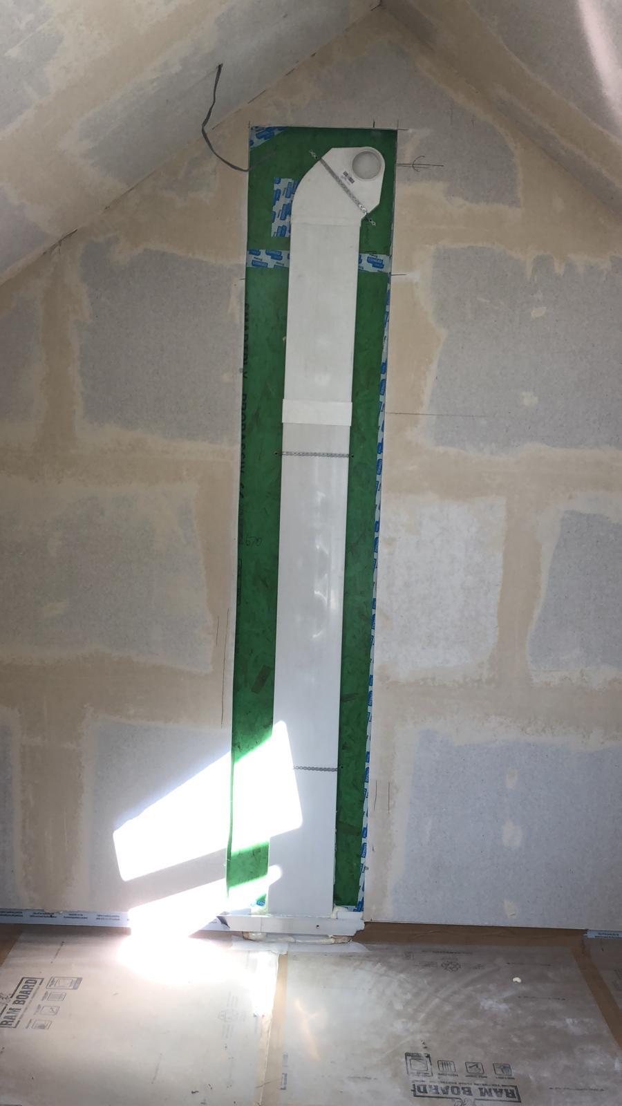

Also good to remember that rectangular aka oval ducting is available too, so on one current MBC TF I’m bringing fresh for a bedroom and extract for that en-suite up in a ‘4x2’ stud wall with ‘oval’ ( which is rectangular-ish but what the hell ) to allow those two ducts to rise without boxing in in either of the rooms.
Also(!) remember that you can get 225x25mm ducting, which can allow you to hide your MVHR ‘duct’ in a 35mm service batten space. Very handy when you have OCD like me lol. I cannot tolerate boxing in, and many of my clients marvel at the solutions I come up with to get away from that requirement.

It’s not the depth of the ducting that’s the issue hiding stuff in tiny spaces, but more the depth necessary to fit the terminal on that takes the ( adjustable flow rate ) air valve, so as per the pics, if you go that route then you will need to take a multi tool to a regular 100mm vent cover and fix it on DIY style, plus you need to attenuate elsewhere for balance and commission.

One thing you have to consider when specifying an MVHR unit is the pressure drop from the duct runs and the outlet nozzles etc.  You need to see the MVHR fan curves (supply and extract) that way you can see exactly at what point on the flow/pressure curve you are at, when at normal speed and boost.  The higher the pressure drops the system causes the harder the fans have to work to overcome the system resistance.
Once you know the above, you should be able to see where you sit on the noise curve for the MVHR fans.
Also you need to consider duct noise generated by flow velocity, and the attenuation given by supply or extract nozzle and plenum chamber (distribution box).
All in all lots to consider, but generally oversizing MVHR units is the way to go, but not so big that min speed is over the duty point of the system.  Also ducts are better larger, as the longer the run the higher the resistance to flow (pressure drop).
So one reason you may have been specified different units, could be duct size and duct length, as shorter bigger ducts (or double/triple ducts) have less flow resistance and a smaller unit can more easily cope.

In other areas, we widened stud walls slightly to take the duct. I don’t think we drilled any steels.
