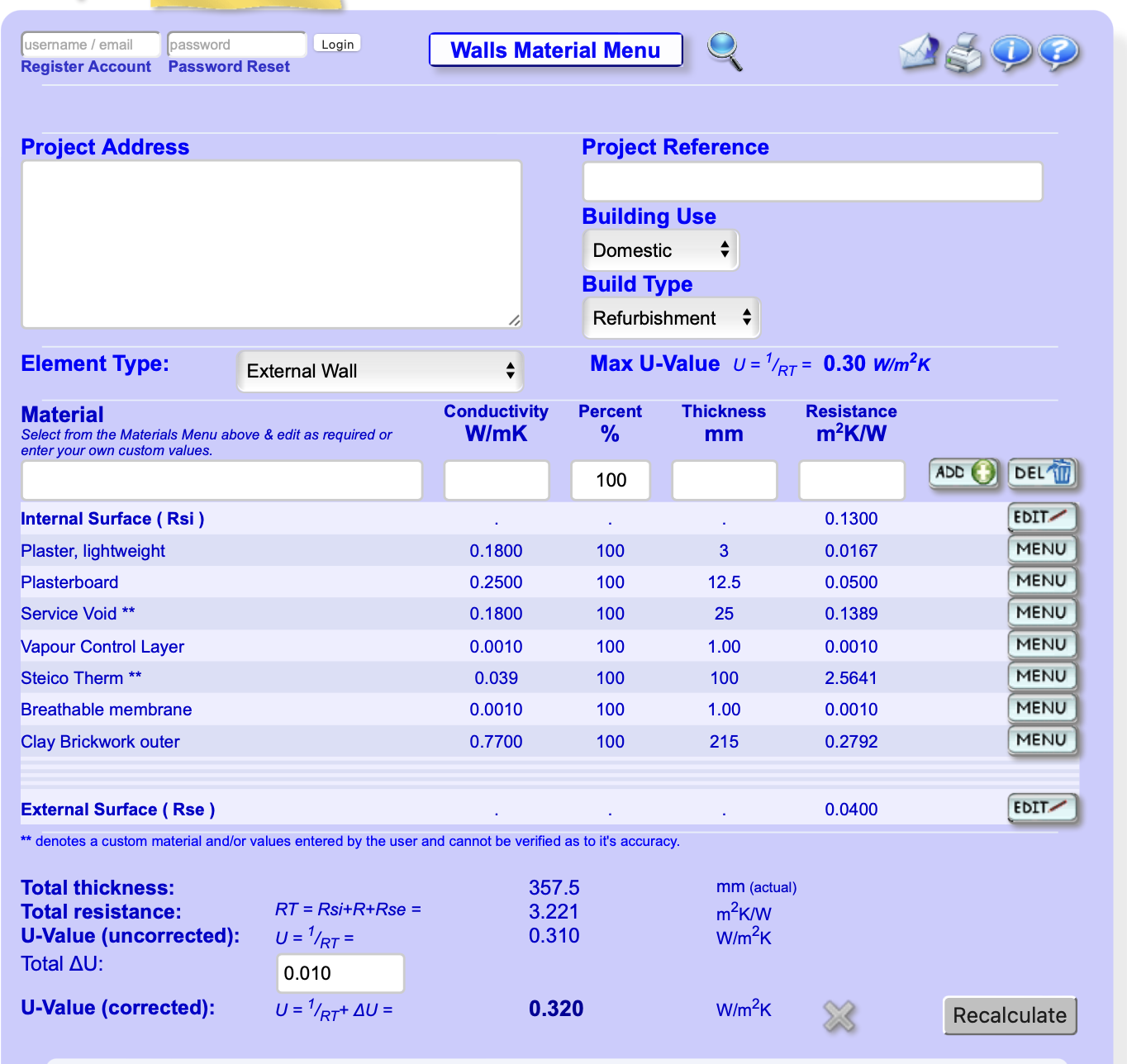

@jc89, I could not get my head round 100mm of WF giving 0.247, as usually it gives somewhere around 0.3+ on a 225 brick wall. I realise that the figure for Intello seems wrong. The Pro Clima datasheet gives a lambda of 0.04, giving an R value for the 1mm thick sheet of 0.025, not 1.0 as per your U value calc. Think I have got that right....
You're right, not sure how that happened. Updated figures;
1050588788_Screenshot2022-06-07at21_14_12.thumb.png.8e53195f2f0c27ccdeb89c6d82809176.png
My question really is whether that service void is suitable to separate the breathable from non-breathable materials.
Steico suggest something similar here - https://www.steico.com/en/solutions/renovation/internal-wall-insulation - under "Renovation type: Multi layer internal insulation" although that seems to suggest attaching the plasterboard directly to the VCL, which I don't understand - surely by doing so that would make the entire buildup less breathable. I expected a cavity/service void there to mitigate that.

If you look at the steico buildups there is one key difference. In the first example, the woodfibre is bonded directly to bare solid brickwork and therefore it doesn't require breather membrane or vcl. In the second example a vcl is used because there is an existing internal render on the masonry wall. Because this internal render is not likely to be very vapour permeable or hygroscopic, the vcl is used. Otherwise you end up with a risk of interstitial condensation at the face of the internal render.

So these are your risk points. The lime on its own should be fine for woodfibre but the risk is what paints have been used on the lime that might render it unbreathable. It's not unknown to find some so-called breathable paints that actually have an sd value equal to a 10 meter thick wall!
