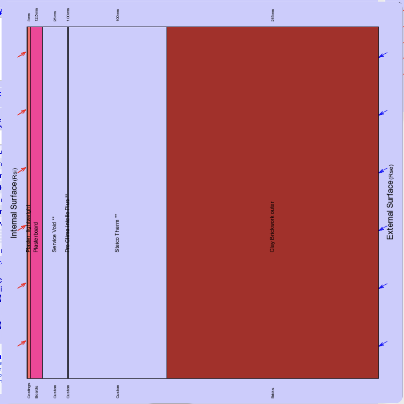

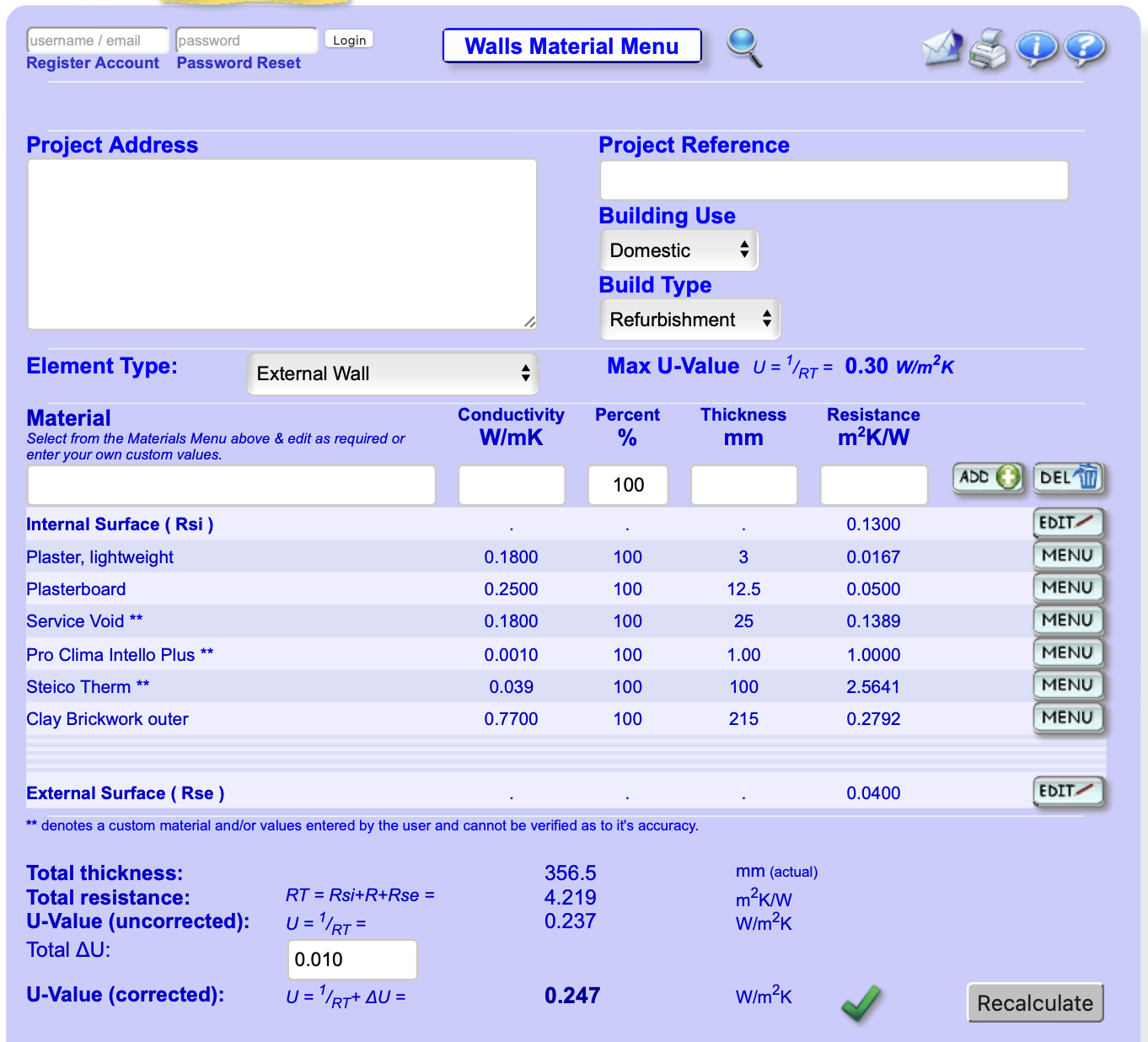

  • 4 weeks later...
This is the make up I'm considering, from outside to in;
- Solid Brick Wall
- 25mm PIR, taped
- Overlapping 25mm PIR, taped
- Airtight Membrane/Vapour Check
- 25mm Service Void
- 12mm OSB (not necessary but will makes the walls feel more substantial)
- 12.5mm Plasterboard
- Skim
632214374_Screenshot2022-05-07at11_01_27.thumb.png.192f042524819f22a5aa40dda8b0c5f5.png

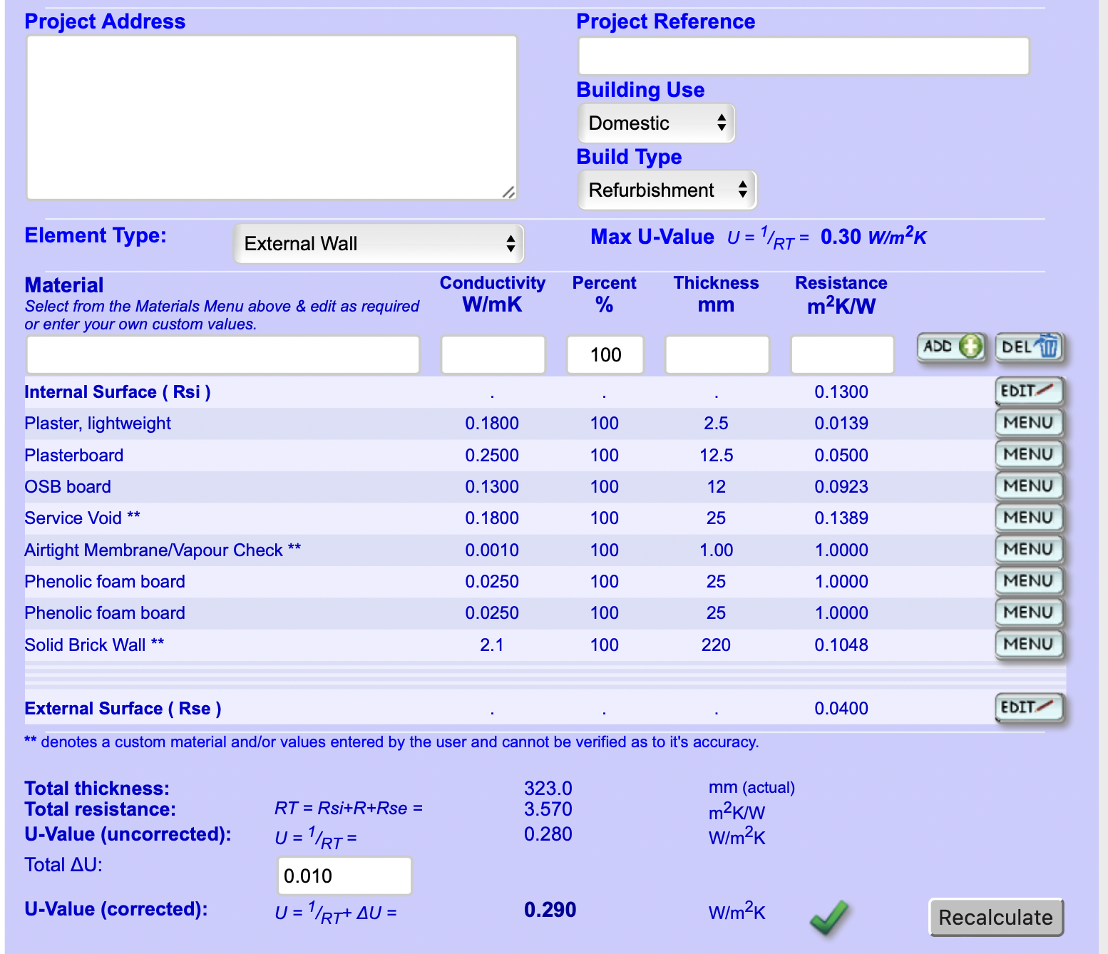

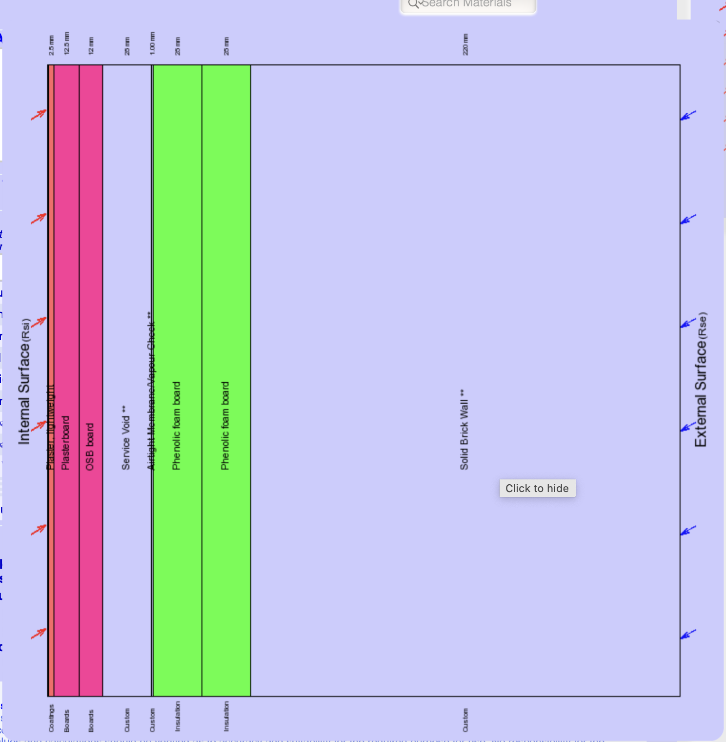

According to my calcs this would achieve a u-value of 0.29, which is arguably too good for IWI (with the assumption that some heat should be allowed to escape to aid in keeping the wall dry)
1174536899_Screenshot2022-05-07at11_05_49.thumb.png.b86ef6b2b943fb796ccf6ef613e60fe7.png
I toyed with the idea of having a separate airtight membrane on the cold side and using the one on the warm side just as an additional vapour check (as the 2x layers of taped PIR should also do this) - would that be overkill?
I like the idea of keeping the service void on the warm-side as it means we won't have to punch holes through the PIR, or airtight barrier, but I'd be keen to hear other opinions on not having a cavity between the wall and PIR. I'm still not entirely sure what an unventilated cavity on the cold side would achieve.

Another option I thought of;
- Woodfibre direct to the wall
- AVCL over
- Batten over to act as a service void (no services penetrating the airtight layer)
- PB + skim
280656959_Screenshot2022-06-07at15_44_31.thumb.png.fa2de56ba938a56c0c763d373758f925.png
1466390232_Screenshot2022-06-07at15_44_38.thumb.png.8f7098b44d97197fde80724badb68e1e.png
The wood fibre providing the breathable insulation and the service void acting as a cavity to decouple the breathable materials from the non-breathable ones.
It adds approx. 50mm to the depth, which is a shame, but probably worth it...
Thoughts?

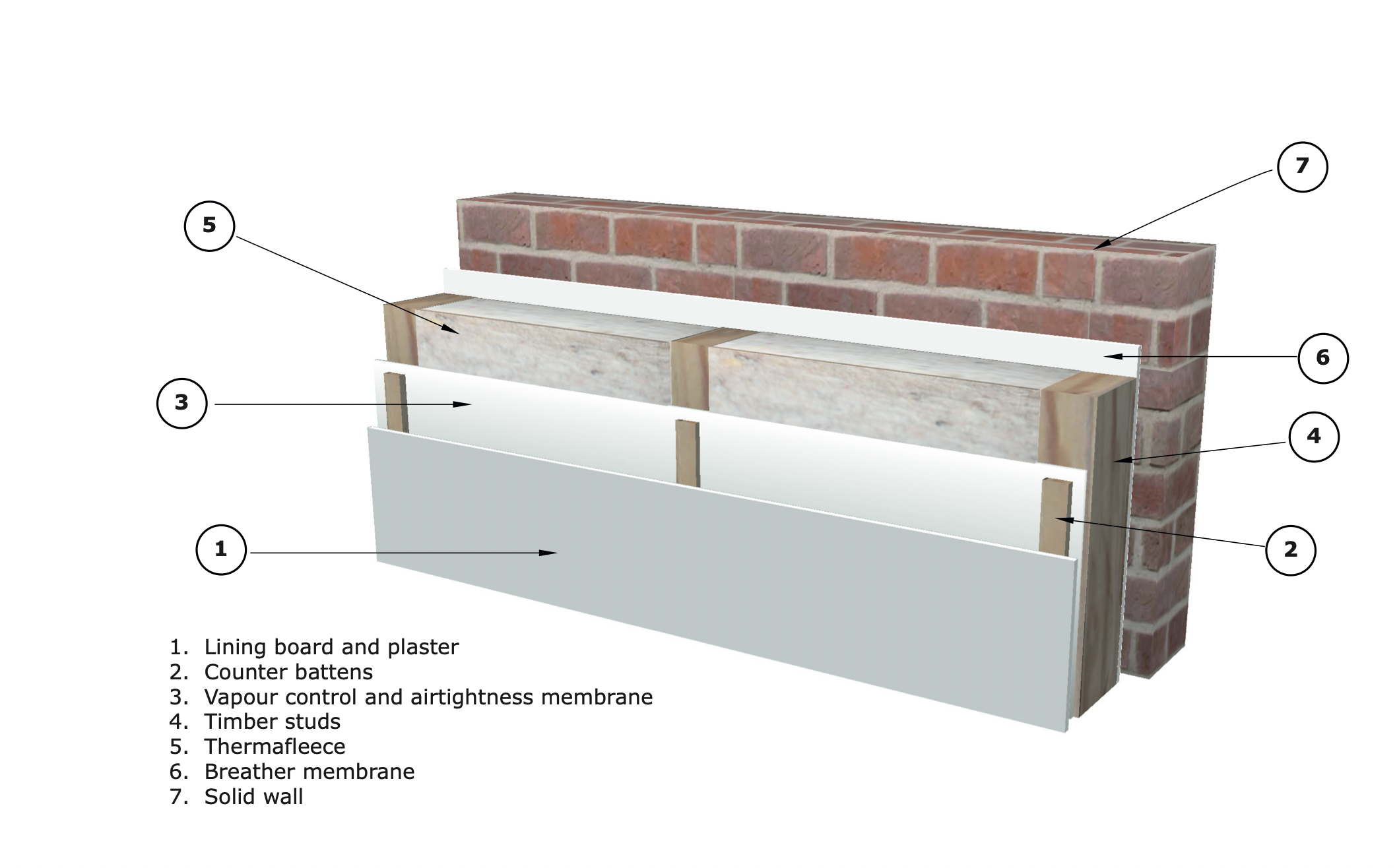

Similar to this, albeit the diagram is using sheep's wool not wood fibre...
534900921_Screenshot2022-06-07at19_37_18.thumb.png.d4f5ae23420cee4f335728cc3af8ba77.png
