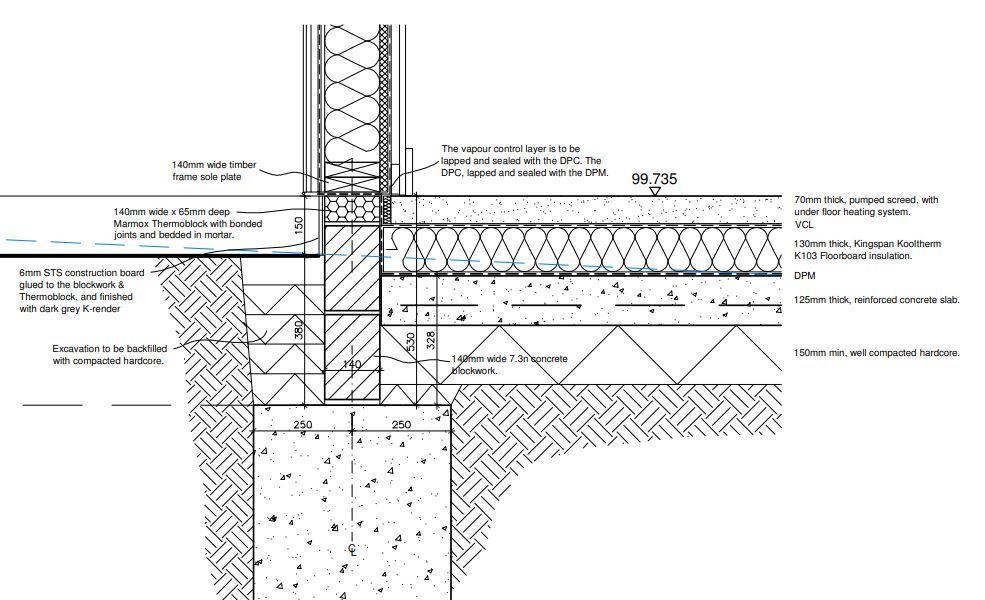

maxdavie Posted March 28, 2022 Posted March 28, 2022 Hello, Does anyone know what is typically used for the element highlighted in red in the detail below? Pretty much all the details I've found online just say 'protective board'. Whatever it is it will have to be able to accept paint as it will be visible beneath the timber cladding. The detail shows: - a plywood timber 'cassette' - non-combustible Muliti-pro exterior lining - a timber rainscreen (battens, counter battens and Larch board-on-board cladding) There is a breather membrane over the Muilti-pro board and a DPM but I'm not showing it for drawing legibility. I imagine what I'm looking for is some sort of waterproof render carrier board that I can adhere to the slab edge and the 'cassette'. Then I'd apply sand/cement render to the small section of exposed surface and paint it. But, if anyone with experience/knowledge can steer me toward a particular product or key words/phrases to aid my google search or even correct my faulty assumptions that would be very helpful! Thanks
ProDave Posted March 28, 2022 Posted March 28, 2022 Who designed that? It just looks wrong to me, you are effectively putting a timber cassette down into a trench below ground level, relying entirely on that red board to keep water out, and no way for it to drain if any does get in? 1
maxdavie Posted March 28, 2022 Author Posted March 28, 2022 Sorry! I designed it, but I'm not showing all the info in the detail, ie, its cropped and I've removed annotations. So your suspicion is totally understandable. For various reasons on this project I have to have a level threshold, hence the timber frame sitting below the ground level. The rectangle to the left of the red board is a french drain and runs the perimeter of the building.

Mr Punter Posted March 28, 2022 Posted March 28, 2022 18 minutes ago, maxdavie said: the timber frame sitting below the ground level That is not acceptable. You cannot have the timber below ground. Why not raise it up on blockwork? You can still achieve a level threshold at the entrance(s). 1

Temp Posted March 29, 2022 Posted March 29, 2022 Fills me with horror but if you are determined... This "red board" really needs to be some form of "basement tanking system" suitable for both concrete and wood (and bridging a joint between concrete and wood). Get one with a long warranty. It looks like after fitting the "red board" you plan to do another concrete pour outside that? Why do that outer concrete pour? It strikes me it will just trap water. Wouldn't it be better just to back fill with free draining material and a drain pipe? I would see what the basement tanking company recommend.
MikeSharp01 Posted March 29, 2022 Posted March 29, 2022 I think I get what you are trying to do can I ask a couple of questions. Do you have any housewrap type building paper on the outside of the timber cassette that can lap over the top of the red board to stop and water running behind the red board? (There will be a serious dew point issue behind the gladding anyway.) The red board will need to be impervious and very robust, so plastic come to mind and and joins will need careful attention. Have you considered wrapping the base, up both sides, of the cassette in some sort of membrane although this will be a moisture trap you might be able make it breath upwards?
PeterW Posted March 29, 2022 Posted March 29, 2022 14 hours ago, maxdavie said: For various reasons on this project I have to have a level threshold, hence the timber frame sitting below the ground level. You don’t need your panel to be below ground level though to achieve that. 13 hours ago, maxdavie said: The building inspector and I thought that if you had a continuous drain around the perimeter of the slab to remove any water before it accumulated and had a DPM and second robust impermeable layer over this then we should be fine. that won’t work. And I don’t think you should be trusting the BCO on this ..! 13 hours ago, maxdavie said: One of the purposes of this small building is to test a kit-of-parts I've been developing I’m going to guess you have limited building experience but come from an engineering background ..? Have you looked at product liability insurance …??
maxdavie Posted March 29, 2022 Author Posted March 29, 2022 Thanks for the comments everyone - very helpful. But, has also filled me with a deep sense of dread about this sunken timber cassette! (prob a good thing) 6 hours ago, Temp said: It looks like after fitting the "red board" you plan to do another concrete pour outside that? Why do that outer concrete pour? I think the partial detail hasn't helped the discussion. So, see the full annotated detail below. You can see now that the hatched block to the left of the red board is a french drain (not more concrete). 12 minutes ago, PeterW said: I’m going to guess you have limited building experience but come from an engineering background ..? I'm an architect, but quite right Peter, I've not had a great deal of building experience (mostly large projects at pre-planning stages) 1 hour ago, MikeSharp01 said: (There will be a serious dew point issue behind the gladding anyway.) I haven't carried condensation risk analysis yet, but may use the BuildDesk software to do so. I'm relying on 3 things in this respect : 1. the building isn't in constant use, any build up of condensation when the heating goes on, should have more than enough time to dry out when it goes off. 2. I'm using sheep's wool insulation which is hygroscopic, ie, it will absorb excess moisture and release it when humidity/temperature conditions allow 3. there is a 36mm ventilated cavity behind the rainscreen, the free flowing air should help carry moisture away. 9 minutes ago, PeterW said: You don’t need your panel to be below ground level though to achieve that. Problem I have with raising it up on something (upstand/blockwork etc) is maintaining the insulation thickness. Can't see a way around that. I have to say this decision is now harder to justify in the face of so much doubt! ........I may have to re-think....

TonyT Posted March 29, 2022 Posted March 29, 2022 Plywood will be rotten in 10 years…. build an upstand in concrete as part of the foundation or block to raise it off the floor and alter the internal wall to allow for insulation
MikeSharp01 Posted March 29, 2022 Posted March 29, 2022 Excellent to see the drawing with its annotation. You probably need to get a big washer (maybe 80-100mm dia) under the cap of the M16 resin anchor to avoid it just pulling through if it ever gets under load and if the timber has weakened as @TonyT points out it will very easily.

CharlieKLP Posted March 29, 2022 Posted March 29, 2022 (edited) What did you use as inspiration for your detail there? Is that recommended by the people providing your wall cassette (what even is that). I assume you’re using a timber frame. Just make sure you’re using enough insulation to fulfil the new part L. I also think you might have a warranty problem. Shouldn’t it look something like this: Edited March 29, 2022 by CharlieKLP 1

CharlieKLP Posted March 29, 2022 Posted March 29, 2022 (edited) 9 minutes ago, maxdavie said: Thanks for joining the convo! - it might help to read some of my initial posts for context. I did, I still don’t get why you are trying to do here. you need to have all of your timber above ground, on block. Your slab should also be higher than the ground. If you want a level threshold then I can get you a detail for that part. The board you are asking about is on my detail STS construction board. But really you need to sort out the wall frame and put it on block before you stick anything anywhere, and it doesn’t go underground. don’t you have some technician friends you can ask to help? Edited March 29, 2022 by CharlieKLP
maxdavie Posted March 29, 2022 Author Posted March 29, 2022 1 minute ago, CharlieKLP said: The board you are asking about is on my detail STS construction board. amazing - thanks. 2 minutes ago, CharlieKLP said: I did, I still don’t get why you are trying to do here. See my earlier post - pasted below. 15 hours ago, maxdavie said: One of the purposes of this small building is to test a kit-of-parts I've been developing (a bit like the one seen on Grand Designs some years back where they'd assembled big plywood cassettes filled with insulation - see pic). So, I haven't got any flexibility on where the insulation goes and I don't plan on wrapping a continuous layer over the cassettes. If, like you say I raised the frame up on blockwork, I'm not sure how I'd maintain the same thickness of insulation.
CharlieKLP Posted March 29, 2022 Posted March 29, 2022 Oh yes that does make a lot more sense! I’ve been a part of developing a few similar wall build ups, so I know the difficulties. I might actually have worked on the episode you’re talking about but it was a while ago! We filled them with lambswool though. In hindsight should have been proper insulation. you can just make the block work as thick as you need for the wall can’t you? but you know, there’s no need to reinvent the wheel. Timber needs to be up on a block with a sole plate as the industry standard.
PeterW Posted March 29, 2022 Posted March 29, 2022 (Caveat - seen the use of a VCL annotated on the plans now !) You’re using a hygroscopic material below the ground level and it will have a fairly challenging environment to maintain its breathability and it will be in a semi-sealed location so it will not work as anticipated. Looking at the detail, there is a real need to do a condensation analysis as you have a non standard design. Thermafleece only gained its BBA cert (02/3950 which was subsequently withdrawn) using a fully ventilated cavity on the outside - you’re not doing that with the design you have.
