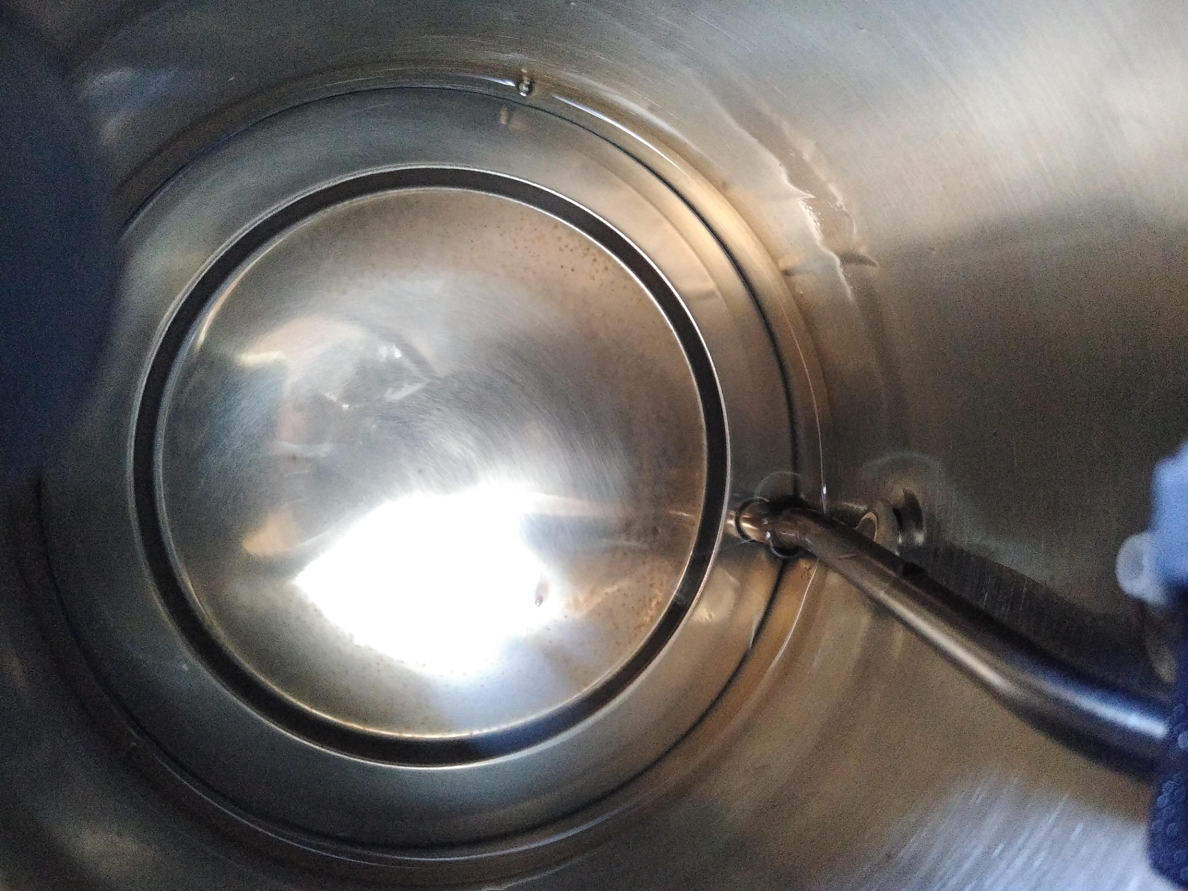

SteamyTea Posted March 31, 2022 Share Posted March 31, 2022 8 minutes ago, Nelliekins said: might just get it tested, though, to be on the safe side! What is the inside of your kettle like. 1 Link to comment Share on other sites More sharing options...
Radian Posted March 31, 2022 Share Posted March 31, 2022 37 minutes ago, SteamyTea said: What is the inside of your kettle like. 'Slaps forehead' 👆 Pure Genius. Link to comment Share on other sites More sharing options...
SteamyTea Posted March 31, 2022 Share Posted March 31, 2022 10 minutes ago, Radian said: 'Slaps forehead' 👆 Pure Genius. What they should look like. Link to comment Share on other sites More sharing options...
Gone West Posted March 31, 2022 Share Posted March 31, 2022 44 minutes ago, SteamyTea said: What they should look like. That's what ours looks like. I like living in Cornwall. Link to comment Share on other sites More sharing options...
