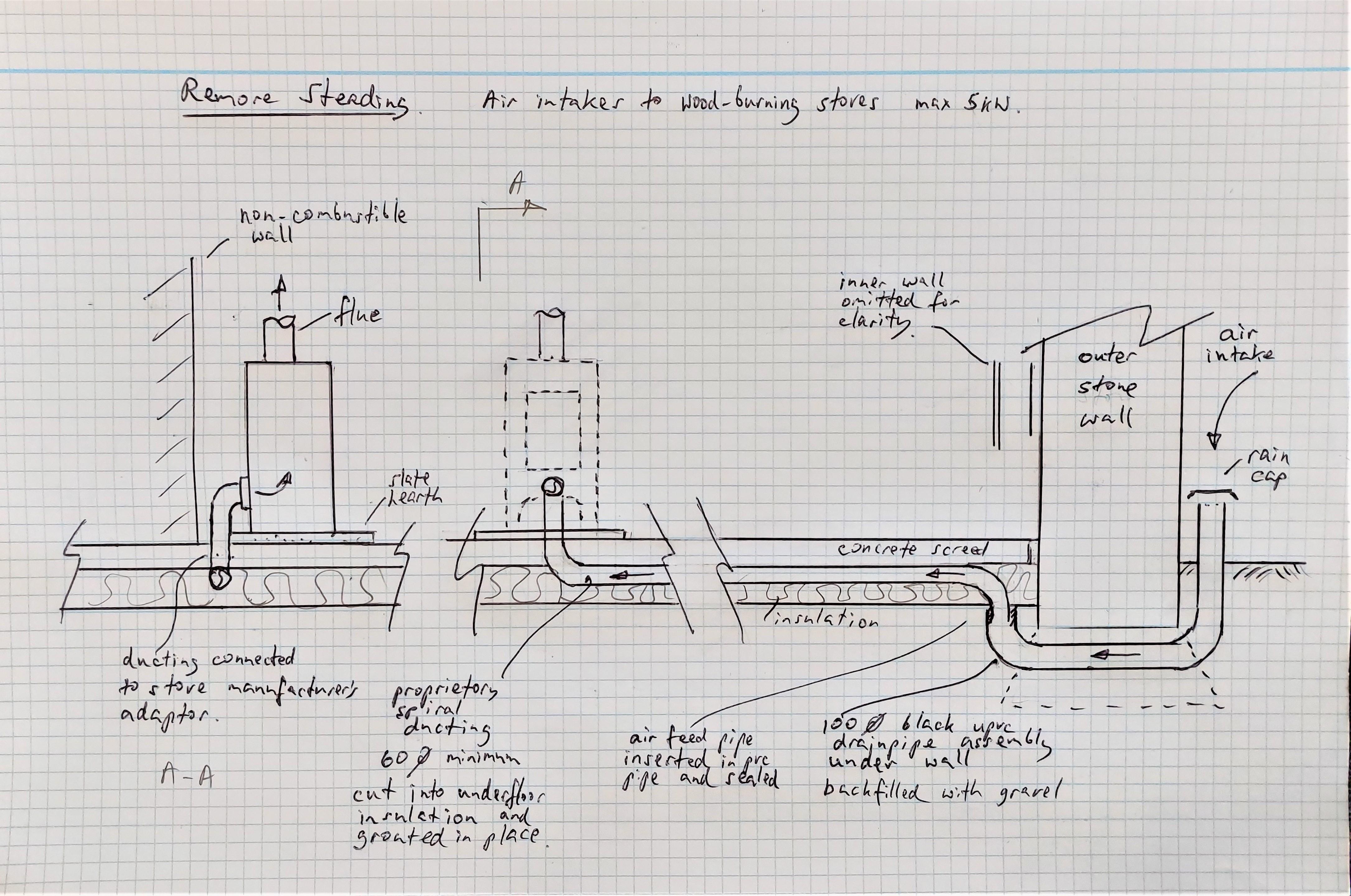

saveasteading Posted March 21, 2022 Share Posted March 21, 2022 Log burners: Building inspector has asked for more detail, so for anyone who doesn't know, as I have just learnt.... As earlier discussion, the air intake is needed and mandatory for a modern (airtight) house. It can be an inlet placed near the stove, but I have gone off that idea, as most stoves now seem to have rear inlets for direct air. A 5kW burner needs a 60mm piped supply. There is no mention of length of pipe, and any friction losses along the way. The manufacturers seem to only provide an adaptor to the back, where I had expected an optional kit for appearances and strength. The utilitarian spiral bendy pipe seems to be the standard solution but will look horrible behind the stove, and I wonder about cleaning damage. I have come up with a solution for our circumstances. The feed needs to be brought in early so have allowed for pvc drain solution under the wall, and then the slinky pipe can go in, just in time. Needs something better at the back of the stove but this will do for now. Not a pvc pipe obviously, but perhaps keep our eyes open for something sturdy to replace or enclose it. For example if KeeKlamp made 60mm or greater id (their biggest is 60od). My sketch is attached.....I am no draughtsman. Not looking for comments although they are welcome of course. This is simply for the greater good. 1 Link to comment Share on other sites More sharing options...

Nickfromwales Posted March 21, 2022 Share Posted March 21, 2022 (edited) 28 minutes ago, saveasteading said: My sketch is attached.....I am no draughtsman. Not looking for comments although they are welcome of course. This is simply for the greater good. Thanks for this. A consideration for one new client so was going to be asking about this in due course. No time like the present lol. So, my question is around the risk from fire / flames going back down the air intake? Are there regs for this? Is it even a problem / consideration? If the air intake is this piddly flexi hose, how is it that this can be connected directly to the WBS and there not be a certain length of more robust flue-like pipe connected immediately? All thoughts / wisdom welcome. For my client it will be a double-sided appliance, shared between two rooms, so assume a bottom connection vs rear entry. Better maybe? Edited March 21, 2022 by Nickfromwales Link to comment Share on other sites More sharing options...
saveasteading Posted March 21, 2022 Share Posted March 21, 2022 1 minute ago, Nickfromwales said: risk from fire / flames going back down the air intake It sounds like a possibility but I don't think so. The theory of stack ventilation should apply here, as well as 'hot air rises'. To burn back down the intake, the flames would have to go down through the grate which seems unlikely (have you noticed that under a bonfire there can still be some unburnt material, protected by the ash? Plus the wind across a flue causes upward movement of air, so in the summer this will act as a permanent air flow. Yes, I get smoke and even some flame coming out of the door when ours is just lit, so that is working in reverse, but when burning well it all goes up. And even if all that theory was wrong, and there was occasional backfiring, it is an aluminium pipe, several metres long.....no harm will be done. I showed a pvc drain-pipe at the wall because this can go in early and not get damaged. we don't have the possibility of going through the wall as it is 600 th granite. I haven't given any thought to doing it through a nice easy timber wall. Link to comment Share on other sites More sharing options...

ProDave Posted March 21, 2022 Share Posted March 21, 2022 Our stove is ducted air intake. IIRC it was an 80mm diameter inlet connector and I just bought 80mm flexible aluminium pipe, not the really flimsy one but quite solid. That connects to my adaptor in the wall that leads down to under the ventilated suspended floor. The pipe connecting to the stove must be non combustible. I really can't see any risk of flames going down the intake. The intake is well below the firebox underneath the ash pan. I cannot imagine what sort of backdraught situation would send flames down there. If you touch the vent pipe when the stove is running it is cold, because it is drawing in cold outside air. Take care when buying a stove that it takes both primary and secondary air from the ducted intake, not all do. BC didn't seem bothered that the stove I fitted was different to what was on the building warrant, they just wanted to see the manual and check the "distance to combustible materials" stated in the manual had been met. Link to comment Share on other sites More sharing options...
saveasteading Posted March 21, 2022 Share Posted March 21, 2022 32 minutes ago, ProDave said: secondary air from the ducted intake That being the air that comes out of nozzles in the fire bricks and burns the fumes? Are there any rules on that? I am thinking that if any air can get in other than through the duct, then that might become the primary source if the pressures allow. Link to comment Share on other sites More sharing options...
Nickfromwales Posted March 21, 2022 Share Posted March 21, 2022 48 minutes ago, ProDave said: Take care when buying a stove that it takes both primary and secondary air from the ducted intake, not all do. What are the definitions of primary and secondary? Link to comment Share on other sites More sharing options...
ProDave Posted March 21, 2022 Share Posted March 21, 2022 1 hour ago, Nickfromwales said: What are the definitions of primary and secondary? Primary is air in at the bottom of the firebox, for coal. Secondary is air in at the top of the firebox for wood. Some stoves only take the bottom primary air from the duct and simply open vents on the door to take the top secondary air from the room. 1 Link to comment Share on other sites More sharing options...
saveasteading Posted March 21, 2022 Share Posted March 21, 2022 My stoves have sliding openings at the bottom front, into the ash pan. No fancy sliders or pivots, just air in at the hole in the front. This then comes up through the grille unless covered in ash, and round the back of the fire bricks and out of numerous holes into the fire box. Works fine as long as the ash pan is not full. Wood needs to sit on ash (or a solid bottom) but mine seems to work when air comes from under just as well. I noticed that some modern fires don't have ash pans, yet some do. 1 Link to comment Share on other sites More sharing options...
Gus Potter Posted March 21, 2022 Share Posted March 21, 2022 6 hours ago, saveasteading said: My sketch is attached.....I am no draughtsman. Not looking for comments although they are welcome of course. This is simply for the greater good. Good sketch. Can you drop the duct so you get some insulation over the top of it to mitigate the cold bridge? In parts of Scotland it regularly gets down to minus 15 -18 deg C. We have a 5.0kW stove with a bottom intake that can be ducted. I do have a duct from the solum space to hearth level and it pops up just under the intake but is not actually connected to it. When the stove is on you can really feel the air flow if you put your hand under the stove, but the cold air is drawn directly into the stove rather than over your feet / under the door. The rest of the room is reasonably sealed so when the stove is not on the room is ventilated.. it's not a passive house. One day I may connect the duct to the stove intake and see what happens. Link to comment Share on other sites More sharing options...
