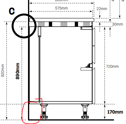

MortarThePoint Posted March 20, 2022 Share Posted March 20, 2022 Every time I discuss the kitchen with my wife she has a different idea. I asked her to do a design, which she did but it still doesn't seem to have finalised things in her mind. The main difficulty for me is how to manage the services (water and electric). Water is easier as I presume it can get routed through when the units layout is finalised (?). The walls are blockwork so the pipes would need to be wall mounted. Is there normally a gap behind units for this? I'm clearly not an experience kitchen fitter. There are no water connections downstream of the kitchen, so it doesn't affect anything else. The electrics are more complicated as they get chased into the wall. We are tiling the whole floor (inc. under units) and is it normal to plaster behind kitchen units? Either way, as there needs to be plastered wall above the units, any cable drops need to be finalised before plastering. Under counter sockets are pretty easy, but the countertop ones are more difficult. since they need to be the correct distances from things like the sink and cooker. I don't know what tiles we'll be using for the kitchen splashback so hard to get the height of the sockets spot on for that. Any tips? Link to comment Share on other sites More sharing options...

MikeSharp01 Posted March 20, 2022 Share Posted March 20, 2022 Best thing is to start at the outside and work in with some questions: What appliances are we contemplating. Which way do you (or you for that matter) want to be looking when preparing food. Are we having an Island and if so what might you want on it. In the end you only need to chase out the above worktop sockets, from below the worktop, as everything else can be run in the service void behind the cabinets (not IKEA as they don't have much of one.) The real crunchers are getting the triangle right and the orientation. 1 Link to comment Share on other sites More sharing options...
Bonner Posted March 21, 2022 Share Posted March 21, 2022 9 hours ago, MortarThePoint said: The main difficulty for me is how to manage the services (water and electric). Don’t forget the drainage, this can be more difficult than water and electric. Again, pipe work can run behind units but you need to make sure there is enough fall. If you are having an island, run all the services to it, whether you think you need it or not ... 1 Link to comment Share on other sites More sharing options...
MortarThePoint Posted March 21, 2022 Author Share Posted March 21, 2022 Howdens have a pretty generous service void behind (some with 72mm) so routing pipes etc should be easy there. Some others have little or no service void (Ikea have none). I might plan to have the electrics go down in the permitted zone in the corner of the room and then go along in the red circled area then popping up in chases where needed. That can all be done when the kitchen is finalised (scoff) and about to be installed. Link to comment Share on other sites More sharing options...
